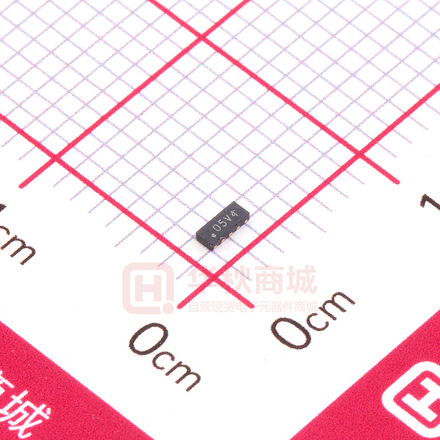

www.msksemi.com ESD5304D-MS Semiconductor Compiance Features  Solid-state silicon-avalanche technology  Low operating and clamping voltage  Up to four I/O Lines of Protection  Ultra low capacitance: 0.5pF typical(I/O to I/O)  Low Leakage  Low operating voltage:5V  Flow-Through design IEC COMPATIBILITY (EN61000-4)  IEC 61000-4-2 (ESD) ±15kV (air), ±8kV (contact)  IEC 61000-4-4 (EFT) 40A (5/50ns)  IEC 61000-4-5 (Lightning) 5A (8/20μs) Mechanical Characteristics  DFN2510-10  Molding compound flammability rating: UL 94V-0  Marking: Marking Code  Packaging: Tape and Reel  RoHS/WEEE Compliant Applications  Digital Visual Interface(DVI)  MDDI Ports  DisplayPortTM Interface  PCI Express  High Definition Multi-Media Interface(HDMI)  eSATA Interfaces Schematic & PIN Configuration 10 9 8 7 6 1 2 3 4 5 Pin Identificaion 1,2,4,5 Input Lines 6,7,9,10 Output Lines (No Internal Connection) 3,8 Ground Circuit Diagram Pin 1 Pin 2 Pin 4 Pin 5 3 ,8 4-Line Protection www.msksemi.com ESD5304D-MS Semiconductor Compiance Absolute Maximum Rating Rating Symbol Value Units Peak Pulse Power ( tp =8/20μs ) PPP 150 Watts Peak Pulse Current ( tp =8/20μs ) Ipp 5 A ESD per IEC 61000-4-2(Air) +/-17 VESD ESD per IEC 61000-4-2(contact) Operating Temperature Storage Temperature kV +/-12 TJ -55 to + 125 °C TSTG -55 to +150 °C Electrical Parameters (T=25°C ) Symbol I Parameter IPP Maximum Reverse Peak Pulse Current VC Clamping Voltage @ IPP VRWM IR VBR IF Working Peak Reverse Voltage Maximum Reverse Leakage Current @ VRWM VCVBRVRWM Breakdown Voltage @ IT IT Test Current IF Forward Current VF Forward Voltage @ IF V IR V F IT IPP Electrical Characteristics Parameter Reverse Stand-Off Voltage Symbol Conditions Minimum Typical Maximum Units 5.0 V VRWM Any I/O pin to ground VBR It = 1mA Any I/O pin to ground Reverse Leakage Current IR VRWM = 5V, T=25°C Any I/O pin to ground 1 µA Clamping Voltage Vc Ipp=5A, tp=8/20µs Any I/O pin to ground 15 V VR = 0V, f = 1MHz I/O pin to GND 0.8 pF Reverse Breakdown Voltage Junction Capacitance Cj VR = 0V, f = 1MHz Between I/O pins 6.0 V 0.3 pF www.msksemi.com ESD5304D-MS Semiconductor Compiance PACKAGE MECHANICAL DATA A A b1xN bbb 1 E/2 C A1 R0.125 E C A B 2 DIMENSI LxN DIM 2X R0.075 PLACES 7 N bxN e B SEATING PLANE aaa C A2 D bbb D/2 C A B Dimensions in millimeters A A1 A2 b b1 D E e L N aaa bbb ONS INCHES MIN MILLIMETERS NOM MAX .020 .023 0.00 .001 (.005) .006 .008 .014 .016 .094 .098 .035 .039 .020 BSC .012 .015 8 .003 .004 .026 .002 .010 .018 .102 .043 .017 MIN NOM MAX 0.50 0.58 0.00 0.03 (0.13) 0.15 0.20 0.35 0.40 2.40 2.50 0.90 1.00 0.50 BSC 0.30 0.38 8 0.08 0.10 0.65 0.05 0.25 0.45 2.60 1.10 0.425 DIMENSIONS P1 P Y Z (C) (Y1) G X X1 DIM INCHES MILLIMETERS C (.034) (0.875) G .008 0.20 P .020 0.50 P1 .039 1.00 X .008 0.20 X1 .016 0.40 Y .027 0.675 Y1 (.061) (1.55) Z .061 1.55 NOTES: CONTROLLING DIMENSIONS ARE IN MILLIMETERS (ANGLES IN DEGREES). THIS LAND PATTERN IS FOR REFERENCE PURPOSES ONLY. CONSULT YOUR MANUFACTURING GROUP TO ENSURE YOUR COMPANY'S MANUFACTURING GUIDELINES ARE MET. REEL SPECIFICATION P/N PKG QTY ESD5304D-MS DFN2510-10 3000 www.msksemi.com ESD5304D-MS Semiconductor Compiance Attention ■ Any and all MSKSEMI Semiconductor products described or contained herein do not have specifications that can handle applications that require extremely high levels of reliability, such as life-support systems, aircraft's control systems, or other applications whose failure can be reasonably expected to result in serious physical and/or material damage. Consult with your MSKSEMI Semiconductor representative nearest you before using any MSKSEMI Semiconductor products described or contained herein in such applications. ■ MSKSEMI Semiconductor assumes no responsibility for equipment failures that result from using products at values that exceed, even momentarily, rated values (such as maximum ratings, operating condition ranges, or other parameters) listed in products specificationsof any andall MSKSEMI Semiconductor products described orcontained herein. ■ Specifications of any and all MSKSEMI Semiconductor products described or contained herein stipulate the performance, characteristics, and functions of the described products in the independent state, and are not guarantees of the performance, characteristics, and functions of the described products as mounted in the customer’s products or equipment. To verify symptoms and states that cannot be evaluated in an independent device, the customer should always evaluate and test devices mounted in the customer’sproducts orequipment. ■ MSKSEMI Semiconductor. strives to supply high-quality high-reliability products. However, any and all semiconductor products fail with someprobability. It is possiblethat these probabilistic failures could give rise to accidents or events that could endanger human lives, that could give rise to smoke or fire, or that could cause damage to other property. When designing equipment, adopt safety measures so that these kinds of accidents or events cannot occur. Such measures include but are not limited to protective circuits anderror prevention circuitsfor safedesign, redundant design, and structural design. ■ In the event that any or all MSKSEMI Semiconductor products(including technical data, services) described or contained herein are controlled under any of applicable local export control laws and regulations, such products must not be exported without obtaining the export license from theauthorities concerned in accordance with the above law. ■ No part of this publication may be reproduced or transmitted in any form or by any means, electronic or mechanical, including photocopying and recording, or any information storage or retrieval system, or otherwise, without the prior written permission of MSKSEMI Semiconductor. ■ Information (including circuit diagrams and circuit parameters) herein is for example only ; it is not guaranteed for volume production. MSKSEMI Semiconductor believes information herein is accurate and reliable, but no guarantees are made or implied regarding its use or any infringementsof intellectual property rights or other rightsof third parties. ■ Any and all information described or contained herein are subject to change without notice due to product/technology improvement, etc. Whendesigning equipment, referto the "Delivery Specification" for the MSKSEMI Semiconductor productthat you intend to use. www.msksemi.com

物料型号:ESD5304D-MS
器件简介: - 采用固态硅雪崩技术。 - 低工作电压和钳位电压。 - 可保护多达四条I/O线。 - 超低电容:典型值0.5pF(I/O到I/O)。 - 低漏电。 - 工作电压为5V。 - 流线型设计。
引脚分配: - 1,2,4,5为输入线。 - 6,7,9,10为输出线(无内部连接)。 - 3,8为地线。
参数特性: - 符合IEC 61000-4标准的ESD和EFT测试。 - 封装类型为DFN2510-10。 - 阻燃等级为UL 94V-0。 - 标记代码。
功能详解: - 电路图显示了4线保护的配置。
应用信息: - 应用于数字视觉接口(DVI)、移动显示数字接口(MDDI)、显示端口(DisplayPort)、PCI Express、高清多媒体接口(HDMI)、eSATA接口等。
封装信息: - 包装方式为带式卷装。 - 符合RoHS/WEEE环保指令。
绝对最大额定值和电气参数提供了详细的操作条件和性能指标,包括峰值脉冲功率、峰值脉冲电流、ESD电压、工作温度范围等。
