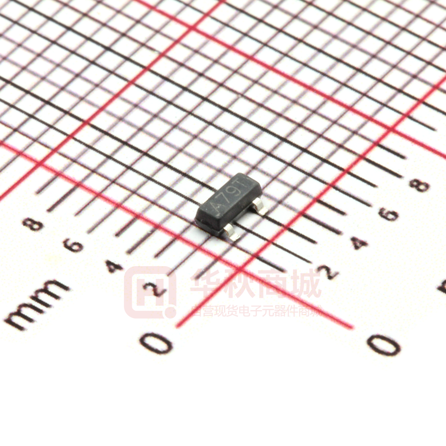

www.msksemi.com WPM3407-MS Semiconductor Compiance P-Channel Enhancement Mode Power MOSFET D General Features G VDS = -30V,ID = -4.1A RDS(ON) < 95mΩ @ VGS=-4.5V S RDS(ON) < 65mΩ @ VGS=-10V Schematic diagram High power and current handing capability Lead free product is acquired Surface mount package D Application PWM applications Load switch S Power management G Absolute Maximum Ratings (TA=25℃unless otherwise noted) Parameter Symbol Limit Unit Drain-Source Voltage V DS -30 V Gate-Source Voltage V GS ±20 V Drain Current-Continuous ID -4.1 A Drain Current-Pulsed (Note 1) IDM -20 A Maximum Power Dissipation PD 1.4 W TJ,TSTG -55 To 150 ℃ RθJA 90 ℃/W Operating Junction and Storage Temperature Range Thermal Characteristic Thermal Resistance,Junction-to-Ambient (Note 2) Electrical Characteristics (TA=25℃unless otherwise noted) Parameter Symbol Condition Min Typ Max Unit Drain-Source Breakdown Voltage BVDSS VGS=0V ID=-250μA -30 -33 - V Zero Gate Voltage Drain Current IDSS VDS=-24V,VGS=0V - - -1 μA Off Characteristics www.msksemi.com WPM3407-MS Semiconductor Parameter Compiance Symbol Condition Min Typ Max Unit IGSS VGS=±20V,VDS=0V - - ±100 nA Gate Threshold Voltage VGS(th) VDS=VGS,ID=-250μA -1 -1.5 -3 V Drain-Source On-State Resistance RDS(ON) VGS=-10V, ID=-4.1A - 48 65 mΩ VGS=-4.5V, ID=-4A - 60 95 mΩ VDS=-5V,ID=-4.1A 5.5 - - S - 650 - PF - 105 - PF - 65 - PF - 8.5 - nS Gate-Body Leakage Current On Characteristics (Note 3) gFS Forward Transconductance Dynamic Characteristics (Note4) Input Capacitance Clss Output Capacitance Coss Reverse Transfer Capacitance Switching Characteristics Crss VDS=-15V,VGS=0V, F=1.0MHz (Note 4) Turn-on Delay Time td(on) Turn-on Rise Time tr VDD=-15V,RL=3.6Ω - 4.5 - nS td(off) VGS =-10V,RGEN =3Ω - 26 - nS Turn-Off Delay Time Turn-Off Fall Time tf - 12.5 - nS Total Gate Charge Qg - 12.5 - nC Gate-Source Charge Qgs - 2.8 - nC Gate-Drain Charge Qgd - 2.7 - nC - - -1.2 V VDS=-15V,ID=-4A,VGS=-10V Drain-Source Diode Characteristics Diode Forward Voltage (Note 3) VSD VGS=0V,IS=-4.1A Notes: 1. 2. 3. 4. Repetitive Rating: Pulse width limited by maximum junction temperature. Surface Mounted on FR4 Board, t ≤ 10 sec. Pulse Test: Pulse Width ≤ 300μs, Duty Cycle ≤ 2%. Guaranteed by design, not subject to production www.msksemi.com WPM3407-MS Semiconductor Compiance PACKAGE MECHANICAL DATA Symbol A A1 A2 b c D E1 E e e1 L 0 Dimensions In Millimeters Min. Max. 1.050 1.250 0.000 0.100 1.050 1.150 0.300 0.500 0.100 0.200 2.820 3.020 1.500 1.700 2.650 2.950 0.950(BSC) 1.800 2.000 0.300 0.600 0° 8° Dimensions In Inches Min. Max. 0.041 0.049 0.000 0.004 0.041 0.045 0.012 0.020 0.004 0.008 0.111 0.119 0.059 0.067 0.104 0.116 0.037(BSC) 0.071 0.079 0.012 0.024 0° 8° REEL SPECIFICATION P/N WPM3407-MS PKG SOT-23 QTY 3000 www.msksemi.com WPM3407-MS Semiconductor Compiance Attention ■ Any and all MSKSEMI Semiconductor products described or contained herein do not have specifications that can handle applications that require extremely high levels of reliability, such as life-support systems, aircraft's control systems, or other applications whose failure can be reasonably expected to result in serious physical and/or material damage. Consult with your MSKSEMI Semiconductor representative nearest you before using any MSKSEMI Semiconductor products described or contained herein in such applications. ■ MSKSEMI Semiconductor assumes no responsibility for equipment failures that result from using products at values that exceed, even momentarily, rated values (such as maximum ratings, operating condition ranges, or other parameters) listed in products specificationsof any andall MSKSEMI Semiconductor products described orcontained herein. ■ Specifications of any and all MSKSEMI Semiconductor products described or contained herein stipulate the performance, characteristics, and functions of the described products in the independent state, and are not guarantees of the performance, characteristics, and functions of the described products as mounted in the customer’s products or equipment. To verify symptoms and states that cannot be evaluated in an independent device, the customer should always evaluate and test devices mounted in the customer’sproducts orequipment. ■ MSKSEMI Semiconductor. strives to supply high-quality high-reliability products. However, any and all semiconductor products fail with someprobability. It is possiblethat these probabilistic failures could give rise to accidents or events that could endanger human lives, that could give rise to smoke or fire, or that could cause damage to other property. When designing equipment, adopt safety measures so that these kinds of accidents or events cannot occur. Such measures include but are not limited to protective circuits anderror prevention circuitsfor safedesign, redundant design, and structural design. ■ In the event that any or all MSKSEMI Semiconductor products(including technical data, services) described or contained herein are controlled under any of applicable local export control laws and regulations, such products must not be exported without obtaining the export license from theauthorities concerned in accordance with the above law. ■ No part of this publication may be reproduced or transmitted in any form or by any means, electronic or mechanical, including photocopying and recording, or any information storage or retrieval system, or otherwise, without the prior written permission of MSKSEMI Semiconductor. ■ Information (including circuit diagrams and circuit parameters) herein is for example only ; it is not guaranteed for volume production. MSKSEMI Semiconductor believes information herein is accurate and reliable, but no guarantees are made or implied regarding its use or any infringementsof intellectual property rights or other rightsof third parties. ■ Any and all information described or contained herein are subject to change without notice due to product/technology improvement, etc. Whendesigning equipment, referto the "Delivery Specification" for the MSKSEMI Semiconductor productthat you intend to use. www.msksemi.com
