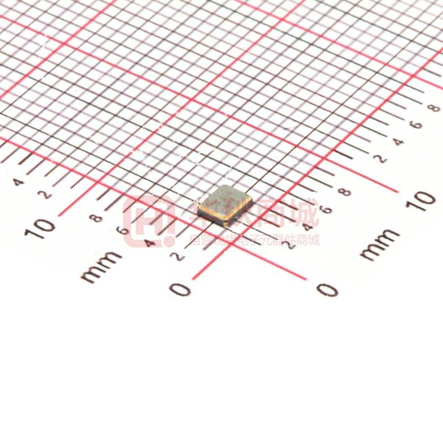

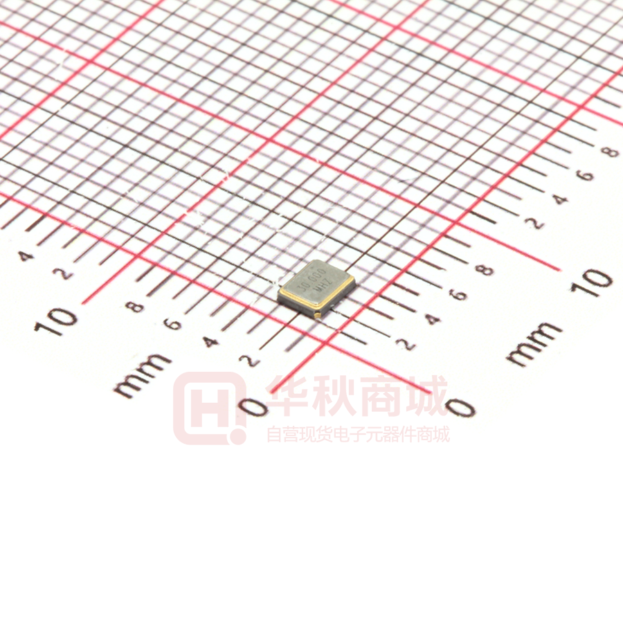

    无源晶振 20pF 30MHz 30Ω ±10ppm -30℃~+85℃ SMD3225_4P
TAXM30M4RLBDDT2T 数据手册
雅晶鑫電子 ● TAXM30M4RLBDDT2T ELECTRICAL PARAMETERS 谐振器产品技术指标 1.Holder Type(型号规格) 2.Mode of Oscillation(振动模式) 3.Frequency(标称频率) 4.Load Capacitance (CL)(负载电容) 5.Drive Level(激励功率) 6.Equivalent Resistance(谐振电阻) 7.Shunt Capacitance (Co)(静态电容) 8.Motional Capacitance (C1) (动态电容) 9.Frequency Tolerance at 25℃(调整频差) 10.Stability over operation temperance(温度频差) 11.Insulation Resistance (at DC 100V)(绝缘电阻) 12.Operating Temperature Range(工作温度范围) 13.Storage Temperature Range(储存温度范围) 14.Aging(老化率) 15.DLD2 16.FLD2 N/A 17.RLD2 18.SPDB N/A 19.Other(其它) Min Max Units SEAM 3.2*2.5 Fundamental MHZ 30.000000 pF 20 uw 100 Ω 30 pF 0 5 fF N/A ppm -10 10 ppm ± 20 MΩ ≥500at DC 100V -30 85 ℃ -45 85 ℃ ±5 ppm/year N/A Ω N/A ppm N/A Ω N/A db N/A OUTLINE DIMENSIONS(UNIT:mm)外形尺寸(单位:mm)
