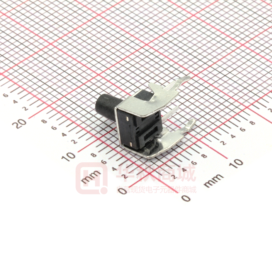

    弯插,6x6mm
    轻触开关 6*6*9mm 弯插
TC-1102N-C-DS-B 数据手册
XKB Connectivity Doc. No. TC-A0108-41 Page No. 1/10 Date Issued 2015-04-06 Prepared by Josephine Date revised 2018-11-23 checked by Jay Rev. No. 01 Approved by Mei Chen Product Specification Title:TACT SWITCHES 轻触开关 1. SCOPE(适用范围) This specification covers the performance, tests and quality requirements for the single key switches which have no key top(TACT SWITCHES:MECHANICAL CONTACT)本规范涵盖了盖单推柄和无推柄的轻触开关的性能、测试和质量要求。 XKB Connectivity) 2. PRODUCT DESCRIPTION( 产品描述) XKB-DESCRIPTION(描述) Part Number(料号) 轻触开关,6x6x9.0,带支架侧插,260gf TC-1102N-C-DS-B 3. APPLICABLE DOCUMENT (适用文件) The following documents form a part of this specification to the extent specified herein. In the event of conflict between the requirements of this specification and the product drawing, the product drawing shall take precedence. In the event of conflict between the requirements of this specification and the referenced documents, this specification shall take precedence.(下列文件构成本规范的一部分,在此规定的范围内。本规范要求与产品图纸有冲突 时,以产品图纸为准。如果本规范的要求与参考文件发生冲突,应以本规范为准。)     MIL-STD-105 EIA-364 QQ-N-290 ISO/IEC- 7816 4. REQUIREMENTS (要求) 4.1. Design and Structure (设计和结构) Product shall be of the design, structure and physical dimensions specified on the applicable product drawing.( XKB Connectivity产品的设计、结构和物理尺寸参考所适用的产品图纸) 参考附件图档 4.2. Materials/ Finish (材料/表面处理) XKB Connectivity Product Specification Doc. No. TC-A0108-41 Page No. 2/10 Date Issued 2015-04-06 Prepared by Josephine Date revised 2018-11-23 checked by Jay Rev. No. 01 Approved by Mei Chen Title:TACT SWITCHES 轻触开关 Materials used in the structure of product shall be as specified on the applicable product drawing. (产品结构中使用的材料参考所适用的产品图纸) 4.3. Ratings (额定功率) Item(项目) Standard(标准) Rated Voltage (Maximum)额定电压 12V Rated Current (Maximum)额定电流 50mA Operating temperature range工作温度范围 Storage Temperature Range储存温度范围 DC -30℃~+85℃ From -30 to +85℃ degree centigrade -30℃~+80℃ From -30 to +80 degree centigrade 5.0 TEST STANDARD (测试条件) Unless otherwise specified, the standard range of atmospheric conditions for making measurements and tests are as follows (除另有说明外,用以进行测量和测试的标准环境 条件范围如下) 5.1 Ambient temperature(环境温度): 5℃ to 35℃ 5.2 Normal humidity (正常湿度): 45% to 85% 5.3 Air pressure (气压): 86Kpa to 106Kpa 5.4 Temperature (温度):40±2℃ 5.5 Relative humidity (相对湿度):65±5% 6.0 TYPE OF ACTUATION 动作类型 Tactile feedback (轻触返回) 7.0 CONTACT ARRANGEMENT 1POLES 1THROWS (接触形式1 接点 1 回路) Details of contact arrangement are given in the assembly drawings. (详细接点形式见装配图) 8.0 PERFORMANCE AND TEST DESCRIPTION ( XKB Connectivity性能和测试类型) 8.1 APPEARANCE (外观) ITEM DESCRIPTION(类型) TEST CONDITION(测试条件) REQUIREMENT(要求) XKB Connectivity Product Specification Doc. No. TC-A0108-41 Page No. 3/10 Date Issued 2015-04-06 Prepared by Josephine Date revised 2018-11-23 checked by Jay Rev. No. 01 Approved by Mei Chen Title:TACT SWITCHES 轻触开关 1 Appearance (外观) Visual.(目视) Should not have any flaw Scratch discoloration and crushed(无任何裂痕、刮伤 、污染和变形) 8.2 ELECTRICAL (电气) ITEM DESCRIPTION(类型) 2 3 4 5 TEST CONDITION (测试条件) Applying static load twice the actuating force to the center of the stem.measurements shall be made with a 1 kHz small-current contact Low level contact resistance. (接触电阻) resistance meter.(用两倍的动作力作静负载施加于 按钮的中心,并用 1千赫小电流接触电阻仪测量) REQUIREMENT(要求) 100 mΩ Max. Insulation Resistance. (绝缘电阻) Measurements shall be made following application of DC100V potential between terminals and between individual terminals and frame for one minute. (在端子与端子之间,端子与外壳之间施加 DC100V,一分钟,测量相邻两端的绝缘电阻) 100 mΩ min. Dielectric strength. (耐电压) AC 250 V (50Hz or60Hz) shall be applied between terminals and between individual terminals and frame for one minute.(在端子与端子之间,端子与外壳之 间施加 AC250V(50HZ-60HZ)) There shall be no breakdown. (无击穿、闪烁现象) Lightly striking the center of the stem at a rate encountered in normal use ( 3 to 4 operations per sec). Bounce shall be tested when “ON” and “OFF”.(在正常使用中(以每秒 3-4 次周 期)轻 轻地 在手 柄中 心加 力,在 通与 断瞬 间测 试抖 动) 10mS Max. Bounce (抖动) 8.3 MECHANICAL (机械) ITEM DESCRIPTION(类型) TEST CONDITION (测试条件) REQUIREMENT(要求) XKB Connectivity Product Specification Doc. No. TC-A0108-41 Page No. 4/10 Date Issued 2015-04-06 Prepared by Josephine Date revised 2018-11-23 checked by Jay Rev. No. 01 Approved by Mei Chen Title:TACT SWITCHES 轻触开关 6 7 8 9 10 Actuating (动作力) Place the switch such that the direction of switch operation is vertical and then gradually increase the load applied to the center of the stem, the maximum Force load required for the stem to come to a 260 ± 30 stop shall be measured. (开关的动作方向为垂直放置开关向推柄中心 逐渐地增加负荷直到推柄停止时所测量的最大 负荷) Travel(行程) Return Force (返回力) Static Strength (静止强度) Stem Strength(推柄强度 ) gf Place the switch such that the direction of switch operation is vertical and then apply a static load twice the actuating force to the center of the stem, the travel distance for the stem to come to a 0.25 stop shall be measured. (开关的动作方向为垂直放置开关,并以双倍 动作力的静负荷作用推柄中心,测量推柄从开 始到停止的行程距离) The sample switch is installed such that the direction of switch operation is vertical and, upon depression of the stem in its center the whole travel distance, the force of the stem to 10gf return to its free position shall be measured. (开关的动作方向为垂直放置开关,在已有 行程的推柄中心向上减小压力,推柄回到自 由位置时所测量到的力) min. Placing the switch such that the There shall be no sign direction of switch operation is vertical, of damage a static load of 3 kg shall be applied in mechanically and the direction of stem operation for a electrically. period of 60 seconds. (无机械的和电气的损伤迹象 (开关的动作方向为垂直放置开关,在推柄动 ) 作方向施加 3Kg 的静负荷,60 秒时间) Placing the switch such that the direction of switch operation is vertical,the maxitrnm force to withstarxt a pull applied opposite to the direction 1Kgf of stem operation shall be measured.(固定开关,使开关与操作方向垂 直,以推柄动作方向反方向施加拉力所测量到 的最大承受力) XKB Connectivity Product Specification Doc. No. TC-A0108-41 Page No. 5/10 Date Issued 2015-04-06 Prepared by Josephine Date revised 2018-11-23 checked by Jay Rev. No. 01 Approved by Mei Chen Title:TACT SWITCHES 轻触开关 11 Operating Life(动作寿命) Measurements shall be made following the test set forth below: 按下列条件进行寿命试验 (1) DC 5V 5mA resistive load. DC 5V 5mA 阻性负载 (2) Rate of operation: 2 to 3 operations per second动作频率: 2-3 次/每秒 (3) Depression: 260 gf 减压力 (4) Cycles of operation动作次数: 30×104cycles Contact resistance接触电阻: 100 mΩ Max. Insulation resistance绝缘电阻 : 100mΩ Min. Actuating force: 动作力 + 30 %or- 30%of initial force. ±30%初始动作力 Item 8.2.2 Item 8. 3.7 Measurements shall be made following the test set forth below: 按下列条件进行抗振动试验 (1)Range of oscillation:10 to 55Hz 频率范围 Vibration Resistance (振动) 12 (2)Amplitude,pk-to-pk:1.5mm 振幅:峰-峰 1.5mm Item 8.2.5 Item 8.3.6、8.3.7 (3)Cycle of sweep: 10-55-10Hz in one minute, approx.扫描周期: 10-55-10Hz 约一分钟内 (4)Mode of sweep: Logarithmically sweep or uniform sweep. 扫描方式: 对数扫描式恒定扫描 (5)Direction of oscillation振动方向: Three mutually perpendicular directions, including the direction of stem travel. 3 个相互垂直方向,包括推柄行程方向 (6)2 hours each, for a total of 6hours. 每方向 2 小时.共 6 小时 13 Impact Shock Resistance(抗冲 击) Measurements shall be made following the test set forth below: 按下列条件进行冲击试验 (1)Acceleration: 80g 加速度 (2)Cycles of test : 3 cycles each in 6directions, for a total of 18cycles 试验次数: 每个方向 3 次,6 个方向共 18 次 Item 8.2.2 Item 8.3.6、8.3.7 XKB Connectivity Product Specification Doc. No. TC-A0108-41 Page No. 6/10 Date Issued 2015-04-06 Prepared by Josephine Date revised 2018-11-23 checked by Jay Rev. No. 01 Approved by Mei Chen Title:TACT SWITCHES 轻触开关 8.4 ENVIRONMENTAL (环境 XKB Connectivity) ITEM 14 15 DESCRIPTION(类型) Solder ability (可焊性 ) Moisture Resistance (耐潮湿) TEST CONDITION(测试条件) Test temperature:245±5℃ Test time :5sec During test,the stick detect temperature in the oven.Then switch terminal soak in the oven.It put 2min under normal temperature after testing. 试验温度:245±5℃ 试验时间:5s;试验时以测温棒侦测锡炉 温度;开关端子浸入与焊锡接触,在时间 内f 取出;测试后再常温下测试后再常温下静 止 2 分钟 Following the test set forth below the sample shall be left in normal temperature and humidity conditions for one hour before measurements are made: 样品按下列条件进行耐潮湿试验,试验后 在正常温度和湿度条件下放置 1 小时后测定 (1)Temperature温度: 60±2℃ (2)Relative humidity相对湿度: 90 to 95% (3)Time时间: 96hours Water drops shall be removed.擦除水珠 16 TLow Temperature Resistance 耐低温 Following the test set forth below the sample shall be left in normal temperature and humidity conditions for one hour before measurements are made: 样品按下列条件进行耐低温试验,试验后在 正常温度和湿度条件下放置 1 小时后测定 (1)Temperature温度:-40±2℃ (2)Time时间: 96 hours Water drops shall be removed.擦除水珠 REQUIREMENT(要求) The area must be reach 90% on the surface of switch terminal 开关端子上锡面积应达 到 90%以上 Contact resistance: 100 mΩ Max. 接触电阻Insulation resistance : 100 MΩ Min. 绝缘电阻 Item 8.2.4、8.2.5 Item8.3.6~8.3.8 Contact resistance: 100 mΩ Max. 接触电阻Insulation resistance : 100 MΩ Min. 绝缘电阻 Item 8.2.4、8.2.5 Item 8.3.6~8.3.8 XKB Connectivity Product Specification Doc. No. TC-A0108-41 Page No. 7/10 Date Issued 2015-04-06 Prepared by Josephine Date revised 2018-11-23 checked by Jay Rev. No. 01 Approved by Mei Chen Title:TACT SWITCHES 轻触开关 17 Heat Resistance 耐热 Following the test set forth below the sample shall be left in normal temperature and humidity conditions for one hour before measurements are made: 样品按下列条件进行耐热试验,试验后在正 常温度和湿度条件下放置 1 小时后测定 (1)Temperature温度: 85±2℃ (2) Time时间: 96 hours 18 Change of Temperature 温度循环 Following ten cycles of high temperature test .The Sample shall be Placed in Normal temperature and humidity Conditions for one hour before measurements are made. During this test, water drops shall be removed.样品按下列条件进行高低温循环 试验,试验后在正常温度和温度条件下放置 1 小时后测定 A:+85±2 ℃ B:40±2℃ C:2 小时 D:1 小时 E:2 小时 F:1 小时 Cycling:5 cycles 19 20 Salt Spray Test 盐雾试验 Hand Soldering 手工焊接 The salt spray test shall be conducted at the following conditions : 样品按下列条件进行盐雾试验 (1) Density(浓度): 溶液(5±1)% Nacl (质量百分比) (2)Temperature温度: 35±2℃ Time时间: 24hours Please practice according to bellow conditions: (请按以下条件进行焊接) (1) Soldering temperature焊锡温度 : ≤350℃ (2) Continuous soldering time连续焊接时间: ≤3 S (3) Capacity of soldering iron电铬铁的功率: ≤60 W Contact resistance: 100 mΩ Max. 接触电阻Insulation resistance : 100 MΩ Min. 绝缘电阻 Item 8.2.4、8.2.5 Item 8.3.6~8.3.8 Contact resistance: 100 mΩ Max. 接触电阻Insulation resistance : 100 MΩ Min. 绝缘电阻 Item 8.2.4、8.2.5 Item 8.3.6~8.3.8 E : Appearance shall no2rust, oxidation, corrosion and other undesirable 小 phenomena.(外观须无生锈 时 E 、氧化、腐蚀等不良现象) : 2 小 时 Should not have any flaw scratch and crack. (无任何裂痕、刮伤和破裂) XKB Connectivity Product Specification Doc. No. TC-A0108-41 Page No. 8/10 Date Issued 2015-04-06 Prepared by Josephine Date revised 2018-11-23 checked by Jay Rev. No. 01 Approved by Mei Chen Title:TACT SWITCHES 轻触开关 For the product of SMT , type solder according to the following conditions 对于 SMT 产品,请按以下条件进行焊接 21 Automatic Flow Soldering (自动焊接) Caution: the condition mentioned above is a temperature on the PWB surface on which parts are mounted. There are cases where PWB temperature greatly differs from switch's surface temperature depending on PWB material, size, thickness, etc. The switch's surface temperature shall not allowed to exceed 260℃ 注意:以上提及的条件是零部件上 PWB 表面的温度,由于 PWB 的材料、尺寸、厚度等不同,PWB 从开关表面获得的温度也会有很大产不同 ,因此,千万小心不要让开关表面温度超 Should not have any flaw scratch and crack (无任何裂痕、刮伤和破裂) No visual damage to insulator. (绝缘体不得有严重变形) 过 260℃ 9.0 XKB CONNECTIVITY OTHER PRECAUTIONS 其他注意事项: 9.1. Following the soldering process, do not try to clean the switch with a solvent or the like. 进行焊接过程中,不可以用溶剂或类似品清洗开关 9.2. Safeguard the switch assembly against flux penetration from its topside. 防止助焊剂从开关的顶端渗入 XKB Connectivity Product Specification Doc. No. TC-A0108-41 Page No. 9/10 Date Issued 2015-04-06 Prepared by Josephine Date revised 2018-11-23 checked by Jay Rev. No. 01 Approved by Mei Chen Title:TACT SWITCHES 轻触开关 9.3. Please have the products keep in close status and the storage time is 90 days guaranty after delivering the goods at most. 交货后保证开关处于封密状态并库存时间 90 天以下 10. REEL PACKAGING 盘装 10.1. Scope 范围: This specification covers the requirements of the reel packaging for SMT standard type of tact switches. 该规范包含 SMT 标准型拨动开关的绕带封装的要求 10.2. Packaging Material 包装材料 ITEM 项目 DESCRIPTION 说明 Package 包装 Cartons 卡通箱 Reel 转轴 Delete Cartons 可降解箱 Carrier Tape 载带 Polypropylene 聚丙烯 10.3. XKB Connectivity Packaging Quantity 封装数量 Please refer to the packing drawing. 请参考产品包装图纸 Rev. Description Date revised Created/ Revised by 01 New Release 2021/09/09 Josephine Lin
TC-1102N-C-DS-B
1. 物料型号:文档中提到的轻触开关型号为TC-1102N-C-DS-B,尺寸为6x6x9.0mm,带支架侧插,具有260gf的动作力。
2. 器件简介:轻触开关是一种机械接触式开关,适用于单键开关,无键帽设计。
3. 引脚分配:文档中提到了接触形式为1接点1回路,具体接点形式详见装配图。
4. 参数特性: - 额定电压:12V DC - 额定电流:50mA - 工作温度范围:-30°C至+85°C - 储存温度范围:-30°C至+80°C
5. 功能详解:包括动作类型(轻触返回)、电气性能测试(接触电阻、绝缘电阻、耐电压、抖动)、机械性能测试(动作力、行程、返回力、静止强度、推柄强度)、环境测试(可焊性、耐潮湿、耐低温、耐热、温度循环、盐雾试验、手工焊接)等。
6. 应用信息:文档中未明确列出应用信息,但根据轻触开关的描述,它们通常用于电子设备中需要轻触操作的场合。
7. 封装信息:文档提到了SMT标准型轻触开关的绕带封装要求,包括包装材料和封装数量,具体细节请参考产品包装图纸。
