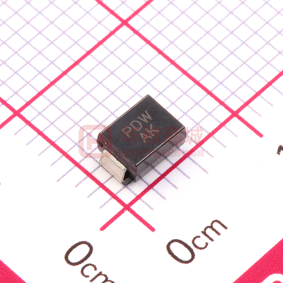

SMBJ6.5CA
SMBJ6.5CA
    PDW(江苏芯格诺)
    SMB(DO-214AA)
    性:双向 反向截止电压(Vrwm):6.5V 击穿电压(最小值):7.22V 击穿电压(最大值):7.98V
SMBJ6.5CA 数据手册
Transient Voltage Suppressor SMBJ SERIES Description SMBJ Series transient voltage suppressors are excellent overvoltage protective devices. The Series is designed specifically to protect sensitive electronic equipment from voltage transients induced by lightning and other transient voltage events. SMB (DO-214AA) Features Mechanical Characteristics                Excellent clamping capability Low leakage current High surge capability Glass passivated chip Epoxy resin package Built-in strain relief Will not fatigue RoHS Compliant Fast response time: typically less than 1.0ps from 0 Volts to VBR min Package: SMB plastic package. Lead Finish: Matte Tin Case Material: Epoxy Molding Compound. UL Flammability Classification Rating 94V-0 Moisture Sensitivity: Level 1 per J-STD-020 Applications  Telecom  Computer  Industrial electronic  Consumer electronic Electrical Parameters Parameter Definition +I CJ Junction Capacitance - typical capacitance measured with 0V or VR bias IPP Peak Pulse Current - maximum rated peak impulse current VC Clamping Voltage - Peak voltage measured across the suppressor at a specified Ippm (peak impulse current) VBR Breakdown Voltage - Maximum voltage that flows though the TVS at a specified test current (IT) IR Leakage Current - maximum peak off-state current measured at VR VR Peak Off-state Voltage - maximum voltage that can be applied while maintaining off state VF Ipp Uni Bi IT IR VR www.pdwsemi.com 1 -7 VBR VC +V © 2022 PDW, Inc. Specifications are subject to change without notice. Revised: 2022/04/08 Transient Voltage Suppressor SMBJ SERIES Absolute Maximum Ratings (TA=25℃ unless otherwise noted) Parameter Symbol Value Units Remarks PPPM 600 W (Note1)(Note2) Steady State Power Dissipation PD 5 W (Note3) Peak Forward Surge Current IFSM 100 A (Note4) Maximum Instantaneous Forward Voltage at 50A VFM 3.5/5 V (Note5) Typical Thermal Resistance Junction to Lead RθJL 20 ℃/W Typical Thermal Resistance Junction to Ambient RθJA 100 ℃/W TJ -55 to 150 ℃ TSTG -55 to 150 ℃ Peak Pulse Power Dissipation Operating Temperature Range Storage Temperature Range Notes1: Non-repetitive current pulse , 10/1000us Waveform. Notes2: Mounted on copper pad area of 5×5mm to each terminal. Notes3: Infinite HeatS ink at TL=50°C Notes4: Measured on 8.3ms single half sine wave or equivalent square wave, duty cycle=4 per minute maximum. Notes5: For UnidirectionalOnly, VFM
