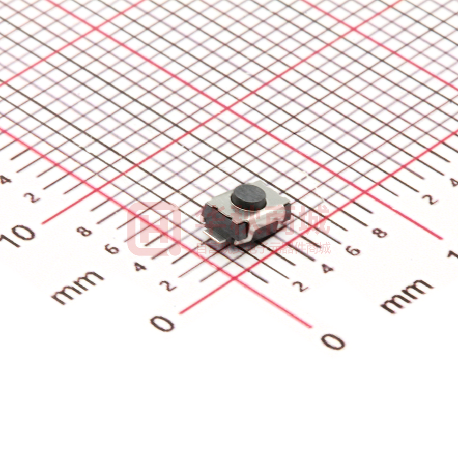

    SMD,4x3mm
    轻触开关 4*3*2mm 立贴
TS-1185-B-A-A-A 数据手册
H(mm) 1.5[0.06] Ø1.8[0.07] A:With B:Without 0.6[0.02] 0.4[0.02] 1.7[0.07] PCB MOUNTING PATTERN DIMENSION The following soldering patterns are recommended for reflow soldering 1 2 SPECIFICATION Contact Rating: Contact Resistance: Insulation Resistance: Dielectric Strength: Travel: Operating Temp: Storage Temp: 50mA,12V DC 100mΩ max 100mΩ min.500V DC 250V AC/1minute 0.13mm -30℃~+85℃ -30℃~+80℃ 5.4[0.2] PAPT NO 3[0.12] Operating Force 1.7[0.07] 1.3[0.05] 2.9[0.11] Height Fixed column Keystake TS-1185-X-X-X-A A:100gf B:160gf C:260gf H:A:2.0 B:2.5 A:With B:Without A:PA46 B:Silica gel 4[0.16] 2-Ø0.7[0.03] 5[0.2] Terminal 5 Contact 4 Base 3 Cover 2 Keystake 1 ITEM PAPT NAMF TER‚NO CIRCUIT DIAGRAM 2 1 X X X MARK DATE DESCRIPTION REVISIONS www.xk-dg.cn www.helloxkb.com REVISED APPROVED units: tolerance: X.X X.XX X.XXX QTY Brass(0.30t) Plating silvering F.ag/Sus Natural LCP Brass Plating Nickel LCP MATERIAL FINISHING REMARK DSND DATE SCALE: N/A MODEL TYPE: mm DWN DATE VIEW: ±0.2mm ±0.1mm ±0.05mm CHKD DATE UNIT: mm/in APPD DATE UNSPECIFIED TOLERANCES www.helloxkb.cn 2 1 1 1 1 TACT SWITCH PART NO.: DWG NO.: SIZE: A4 XKB INDUSTRIAL PRECISION CO.,LIMITED TS-1185-X-X-X-A WEIGHT 1.0g SHEET 1/1 REVISION A0
