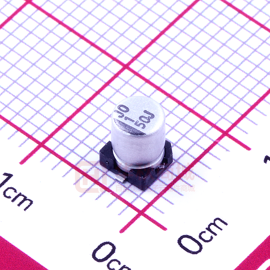

    贴片铝电解电容 SMD,D4xL5.3mm 1µF ±20% 50V 2000Hrs@105℃
VEJ010M1HTR-0405 数据手册
SMD Aluminum Electrolytic Capacitors VEJ Features ‧ 4 ~ 18φ, 105℃, 2,000 hours assured ‧ Designed for surface mounting on high density PC board ‧ RoHS Compliance Marking color: Black SPECIFICATIONS Items Category Temperature Range Performance 6.3 ~ 100V -55℃ ~ +105℃ 160 ~ 450V -40℃ ~ +105℃ (at 120Hz, 20℃) ±20% Capacitance Tolerance Rated voltage Time Case size Leakage Current (at 20℃) 6.3 ~ 100V after 2 minutes 160 ~ 450V after 5 minutes 4 ~ 10φ 12.5 ~ 18φ 12.5 ~ 18φ I = 0.01CV or 3µA, I = 0.03CV or 4µA, I = 0.04CV + 100µA whichever is greater whichever is greater Where, C = rated capacitance in µF V = rated DC working voltage in V Leakage Current Dissipation Factor (Tanδ at 120Hz, 20℃) Rated Voltage 6.3 10 16 25 35 50 63 100 160 ~ 250 400 ~ 450 0.45 0.35 0.28 0.18 0.16 0.14 0.12 0.12 4 ~ 10φ 0.20 0.25 12.5 ~ 18φ 0.40 0.38 0.34 0.26 0.22 0.18 0.14 0.10 When the capacitance exceeds 1,000µF, 0.02 shall be added every 1,000µF increase. Impedance ratio shall not exceed the values given in the table below. Rated Voltage 6.3 10 16 25 35 50 63 100 160 ~ 250 400 ~ 450 Z(-25℃) φD<12.5 4 4 3 2 2 2 2 3 Impedance /Z(+20℃) φD≧12.5 5 4 3 2 2 2 2 2 3 6 Z(-55/-40℃ ) φD<12.5 12 Ratio 8 6 4 3 3 3 4 /Z(+20℃) φD≧12.5 10 8 6 4 3 3 3 3 6 10 Low Temperature Characteristics (at 120Hz) Test Time 2,000 Hrs Within ±25% of initial value for φD ≦ 6.3mm; Capacitance Change Within ±20% of initial value for φD ≧ 8mm Less than 300% of specified value for φD ≦ 6.3mm; Dissipation Factor Less than 200% of specified value for φD ≧ 8mm Leakage Current Within specified value * The above specifications shall be satisfied when the capacitors are restored to 20℃ after the rated voltage applied for 2,000 hours at 105℃. Test time: 1,000 hours; other items are the same as those for the Endurance. The rated voltage shall be applied to the capacitors before the measurements for 160 ~ 450V (Refer to JIS C 5101-4 4.1). Endurance Shelf Life Test Freq. (Hz) Cap. ( μF) Under 1,000 1,000 < C ≦ 4,700 Ripple Current & Frequency Multipliers 50 120 1k 10k up 0.80 0.85 1.00 1.00 1.25 1.15 1.40 1.25 DIAGRAM OF DIMENSIONS Fig. 1 φD±0.5 Vent≧8φ×10L LEAD SPACING AND DIAMETER B± 0.2 W L 0.3 Max A±0.2 0.4 max P C±0.2 Fig. 2 φD±0.5 Vent B±0.2 W 0.4 Max L A±0.2 1.0 Max φD 4 5 6.3 6.3 8 10 10 10 12.5 12.5 16 18 L 5.7 ± 0.3 5.7 ± 0.3 5.7 ± 0.3 7.7 ± 0.3 10 ± 0.5 7.7 ± 0.3 10 ± 0.5 10.3 ± 0.5 13.5 ± 0.5 16 ± 0.5 16.5 ± 0.5 16.5 ± 0.5 A 4.3 5.3 6.6 6.6 8.4 10.4 10.4 10.4 13.0 13.0 17.0 19.0 B 4.3 5.3 6.6 6.6 8.4 10.4 10.4 10.4 13.0 13.0 17.0 19.0 C 5.1 6.1 7.4 7.4 9.2 11.2 11.2 11.2 15.0 15.0 19.0 21.0 Unit: mm P ± 0.2 Fig. No. W 0.5 ~ 0.8 1.0 1 0.5 ~ 0.8 1.5 1 0.5 ~ 0.8 2.0 1 0.5 ~ 0.8 2.0 1 0.7 ~ 1.1 3.1 1 0.7 ~ 1.1 4.7 1 0.7 ~ 1.1 4.7 1 0.7 ~ 1.1 4.7 1 1.1 ~ 1.4 4.4 2 1.1 ~ 1.4 4.4 2 1.1 ~ 1.4 6.4 2 1.1 ~ 1.4 6.4 2 P C±0.2 2011 Verison SMD Aluminum Electrolytic Capacitors VEJ MARKING φD ≦ 6.3mm Negative polarity φD = 8 ~ 10 mm Date code a1 10 16J a1 VEJ 470 6.3V Negative polarity Rated cap. φD ≧ 12.5mm Rated voltage & Series code Date code Series name a1 VEJ 2200 6.3V Negative polarity Rated cap. Rated voltage Dimension: φD × L(mm) Ripple Current: mA/rms at 120 Hz, 105°C DIMENSION & PERMISSIBLE RIPPLE CURRENT V. DC 6.3V (0J) 10V (1A) 63V (1J) 100V (2A) R33 4×5.7 4 0.47 R47 4×5.7 5 4×5.7 1 010 4×5.7 8 4×5.7 8 2.2 2R2 4×5.7 12 4×5.7 12 3.3 3R3 4.7 4R7 10 100 22 220 4×5.7 22 4×5.7 33 330 5×5.7 34 47 470 5×5.7 100 101 220 221 330 331 mA mA mA mA φD×L mA 5 φD×L mA 3 4×5.7 14 5×5.7 17 4×5.7 17 4×5.7 17 5×5.7 20 6.3×5.7 22 32 4×5.7 20 4×5.7 20 5×5.7 27 6.3×5.7 32 6.3×5.7 22 5×5.7 30 5×5.7 30 6.3×5.7 44 6.3×5.7 38 6.3×7.7 58 8×10 100 5×5.7 34 5×5.7 34 6.3×5.7 46 6.3×5.7 46 6.3×7.7 65 8×10 140 10×10 150 38 5×5.7 38 6.3×5.7 48 6.3×5.7 48 6.3×7.7 80 6.3×7.7 70 8×10 170 12.5×13.5 250 6.3×5.7 69 6.3×5.7 69 6.3×5.7 69 240 8×10 210 10×10.3 310 12.5×13.5 380 120 6.3×7.7 120 6.3×7.7 120 100 270 270 8×10 6.3×7.7 6.3×7.7 8×10 10×7.7 8×10 270 10×10.3 330 12.5×13.5 470 16×16.5 450 8×10 290 8×10 10×7.7 290 290 8×10 290 10×10 370 12.5×13.5 490 16×16.5 650 18×16.5 590 320 320 410 10×10 380 10×10 380 12.5×13.5 520 12.5×16 550 16×16.5 700 12.5×13.5 550 12.5×16 550 16×16.5 800 18×16.5 990 18×16.5 1,050 8×10 290 470 471 8×10 320 1,000 102 10×10 410 8×10 10×7.7 10×10.3 2,200 222 12.5×13.5 680 12.5×13.5 680 16×16.5 900 16×16.5 900 3,300 332 12.5×16 850 16×16.5 950 16×16.5 950 18×16.5 1,150 4,700 472 16×16.5 1,000 16×16.5 1,000 18×16.5 1,225 6,800 682 18×16.5 1,290 18×16.5 1,290 V. DC µF Contents 3.3 3R3 φD×L 50V (1H) 0.33 mA φD×L 35V (1V) R22 mA φD×L 25V (1E) 0.22 Contents φD×L 16V (1C) φD×L 4×5.7 µF φD×L Date code Series name Rated cap. Rated voltage 160V (2C) φD×L mA 200V (2D) φD×L mA 250V (2E) 400V (2G) 450V (2W) φD×L 12.5×13.5 mA 60 φD×L mA φD×L 12.5×13.5 mA 40 4.7 4R7 12.5×13.5 65 12.5×13.5 45 12.5×13.5 45 10 100 12.5×13.5 80 12.5×13.5 70 12.5×13.5 50 12.5×16 75 22 220 12.5×16 110 12.5×13.5 105 16×16.5 85 16×16.5 85 33 330 18×16.5 100 18×16.5 100 47 100 12.5×13.5 95 12.5×16 120 16×16.5 180 470 16×16 240 16×16.5 220 16×16.5 220 101 16×16.5 250 18×16.5 280 18×16.5 260 2011 Version
