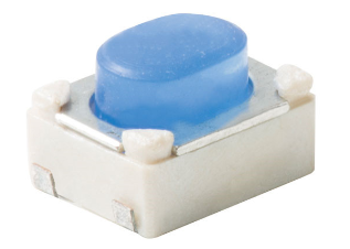

TS-1145-C-B
TS-1145-C-B
    XKB(中国星坤)
    SMD-4P,4.2x3.2mm
    轻触开关 4.2*3.2*2.5mm 立贴
TS-1145-C-B 数据手册
4[0.16] Ø1.5[0.06] 2[0.08] 3 4 5.5[0.22] 2 t0.4[0.02] 12[0.47] 1 2.15[0.08]±0.2 0.9[0.04] 2.2[0.09]±0.2 3.7[0.15]±0.2 SPECIFICATION Contact Rating: Contact Resistance: Insulation Resistance: Dielectric Strength: Travel: Operating Temp: Storage Temp: PCB MOUNTING HOLES CIRCUIT DIAGRAM 2.5[0.1]±0.2 5.2[0.2] 3 2 4 3.3[0.13] 1.6[0.06] 2.6[0.1] 1 3[0.12]±0.2 0.3[0.01]MAX PAPT NO Operating Force A:PA46 B:Silica gel 3[0.12] Ø330[13] 0.6 [0.024]±0.1 4.6[0.18]±0.2 TS-1145-X-B A:100gf B:160gf C:260gf H:2.5 Height Keystake 12.3[0.48] 0.6[0.02] PACKING PEEL TYPE 3000/1REEL(EA) X X X MARK 50mA,12V DC 100mΩ max 100mΩ min.500V DC 250V AC/1minute 0.20mm -30℃~+85℃ -30℃~+80℃ 1[0.04] 3.2[0.13]±0.2 8.0[0.31] 1.75[0.07] 0.55[0.02] 4.2[0.17]±0.2 DATE DESCRIPTION REVISIONS www.xk-dg.cn www.helloxkb.com REVISED APPROVED units: tolerance: X.X X.XX X.XXX Terminal 5 Contact 4 Base 3 Cover 2 Keystake 1 ITEM PAPT NAMF TER‚NO QTY Brass(0.30t) Plating silvering F.ag/Sus Natural LCP Brass Plating Nickel Silica gel MATERIAL FINISHING REMARK DSND DATE SCALE: N/A MODEL TYPE: mm DWN DATE VIEW: ±0.2mm ±0.1mm ±0.05mm CHKD DATE UNIT: mm/in APPD DATE UNSPECIFIED TOLERANCES www.helloxkb.cn 4 1 1 1 1 TACT SWITCH PART NO.: DWG NO.: SIZE: A4 XKB INDUSTRIAL PRECISION CO.,LIMITED WEIGHT 1.0g TS-1145-X-B SHEET 1/1 REVISION A0
