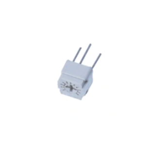

    可调电阻/电位器 200KΩ ±10% 500mW 插件-3P ±100ppm/℃
FT-63EP204 数据手册
SINGLE TURN CERMET TRIMMERS RoHS compliant FT-63 INTERNAL STRUCTURE 2 1 3 4 5 9 6 8 Part name ■ FEATURES ● RoHS compliant ● Resistance tolerance ± 10 % ●“O”ring sealed (Washable: Refer to 698) ● Suitable for automatic insertion and automatic adjust­ment ● Increase in the level of characteristics in the highfrequency field (In house comparison) 1 Housing 2 Rotor 3 Wiper 4 “O” ring 5 Resistive element 6 Terminal pin 7 Adhesive 8 Base element 9 Electrode 7 Material Flammability Polybutyleneterephthalate UL94V-0 Nickel silver — Silicone rubber UL94HB RuO2 cermet Copper, Tin-plated — Epoxy UL94V-0 Ceramic Ag-Pd cermet ■ PART NUMBER DESIGNATION FT-63 E T V 5kΩ (502) Series name Resistance code Terminal pin Resistance value E:Sn (Lead-free) Form of packaging T:Taping (Ammo pack type) Blank:Bulk in plastic bag Product shape P:Top adjustment V:Top adjustment ※ Please refer to the LIST OF PART NUMBERS when placing orders. S:Side adjustment X:Side adjustment H:Side adjustment N:Side adjustment — FT-63 CERMET TRIMMERS ■ LIST OF PART NUMBERS Form of packaging Adjustment position Top adjustment Side adjustment 〈Nominal resistance values〉 A 10 Ω Taping (Ammo pack type) Plastic bag FT-63ETP FT-63EP FT-63ETV FT-63EV FT-63ETS FT-63ES FT-63EX FT-63ETH FT-63EH FT-63EN Fig. 1 A 20 Ω 50 Ω 100 Ω 200 Ω 300 Ω 500 Ω 1 k Ω 2 k Ω 3 k Ω 5 k Ω 10 k Ω 20 k Ω 30 k Ω 50 k Ω 100 k Ω 200 k Ω 300 k Ω 500 k Ω 1 M Ω 2MΩ ※ The above part numbers are all available with the respective com­bi­na­tion of (Fig. 1). ※ Verify the above part numbers when placing orders. ※ Taping specification is not sold separately and must be purchased in tap­ing unit. The products indicated by A mark are manufactured upon receipt of order basis. :Not manufactured ■ ELECTRICAL CHARACTERISTICS Nominal resistance range Resistance tolerance ■ MECHANICAL CHARACTERISTICS 10 Ω ~ 2 MΩ Mechanical angle 260 ° (1 turn) ± 10 % Operating torque 20 mN·m {204 gf·cm} maximum Power ratings 0.5 W (70 °C) 0 W (125 °C) Stop strength 50 mN·m {510 gf·cm} minimum Resistance law (B)  Linear law Rotational life 100 cycles [ Δ R/R ≦ ± (2 Ω +3 %)] Terminal strength 10 N {1.02 kgf} minimum (Tensile strength) Power ratings Thrust to rotor 10 N {1.02 kgf} minimum 220 ° (1 turn) Solderability Maximum input voltage DC200 V or power rating, whichever is smaller Maximum wiper current Effective electrical angle End resistance 1 % or 2 Ω , whichever is greater C.R.V. 2 % or 3 Ω , whichever is greater Operating temp. range Temp. coefficient Insulation resistance Dielectric strength Net weight − 55 ~ 125 °C 10 Ω ~ 20 Ω : ± 150 10-6/°C maximum 50 Ω ~ 2 MΩ : ± 100 10-6/°C maximum 1000 M Ω minimum (DC500 V) AC900 V, 60 s Approx. 0.52 g (FT-63EP, EV) Approx. 0.66 g (FT-63ES, EH, EX, EN) 245 ± 3 °C, 2 ~ 3 s { }:Reference only FT-63 CERMET TRIMMERS ■ ENVIRONMENTAL CHARACTERISTICS Test item Test conditions Specifications − 65 ~ 125 °C (0.5 h), 5 cycles − 10 ~ 65 °C (80 ~ 98 %), 10 cycles, 240 h 981 m/s2, 6 ms 6 directions for 3 times each [ Δ R/R ≦ 1 %] [S.S. ≦ 1 %] Vibration (Amplitude) 1.52 mm or (Acceleration) 196 m/s2, 10 ~ 2000 Hz, 3 directions, 12 times each [ Δ R/R ≦ 1 %] [S.S. ≦ 1 %] Load life 70 °C, 0.5 W 1000 h Low temp. operation − 55 °C, 2 h High temp. exposure 125 °C, 250 h [ Δ R/R ≦ 3 %] [S.S. ≦ 1 %] [ Δ R/R ≦ 2 %] [S.S. ≦ 2 %] [ Δ R/R ≦ 3 %] [S.S. ≦ 2 %] Immersion seal 85 °C, 60 s No leaks (No continuous bubbles) Soldering heat Flow 260 ± 3 °C, 5 ~ 6 s, two times maximum Manual soldering 380 ± 10 °C, 3 ~ 4 s [ Δ R/R ≦ 1 %] Thermal shock Humidity Shock [ Δ R/R ≦ 2 %] Δ R/R:Change in total resistance S.S. :Setting stability ■ MAXIMUM INPUT RATINGS Nominal resistance Resistance code Maximum input Maximum wiper values (Ω) voltage (V) current (mA) A 10 A 20 50 100 200 300 500 100 200 500 101 201 301 501 2.24 3.16 5.00 7.07 10.0 12.2 15.8 223 158 100 70.7 50.0 40.8 31.6 1 k 2 k 3 k 5 k 10 k 20 k 30 k 50 k 102 202 302 502 103 203 303 503 22.4 31.6 38.7 50.0 70.7 100 122 158 22.4 15.8 12.9 10.0 7.07 5.00 4.08 3.16 100 k 200 k 300 k 500 k 1 M 2 M 104 204 304 504 105 205 200 200 200 200 200 200 2.00 1.00 0.66 0.40 0.20 0.10 The products indicated by A mark are manufactured upon receipt of order basis. FT-63 CERMET TRIMMERS ■ OUTLINE DIMENSIONS Unless otherwise specified, tolerance: ± 0.3 (Unit: mm) ● FT-63EP Top adjustment 1 3 CW rotation 260°Nom. 2 Lead-free Identification mark 3 – φ 0.45 2 7 2.5 0.7W × 3L × 1.6D 3 7 7±2 5.8 1 2.5 2.5 Resistance code & Production date code ● FT-63ES Side adjustment Lead-free Identification mark 260°Nom. 0.7W × 3L × 1.6D Resistance code & Production date code +0.4 7 –0.2 Adjustment 8.2 1 3 4.6 2.5 2 3.5 7 +0.4 0 2.5 7.5 ± 2 2.5 3 –φ 0.45 ● FT-63EX Side adjustment Resistance code & Production date code 7 +0.4 0 7 +0.4 –0.2 Adjustment 0.7W × 3L × 1.6D 3.5 2.5 8.2 4.6 260°Nom. 2 3 10 ± 2 Lead-free Identification mark 3 –φ 0.45 1 2.5 2.5 FT-63 CERMET TRIMMERS ■ OUTLINE DIMENSIONS Unless otherwise specified, tolerance: ± 0.3 (Unit: mm) ● FT-63EV Top adjustment 1 3 CW rotation 260°Nom. Lead-free Identification mark 2 1 7 0.7W × 3L × 1.6D 2 3 3 – φ 0.45 7 Resistance code & Production date code 13.5 ± 2 2.5 16 ± 2 5.8 2.5 ● FT-63EH Side adjustment 0.7W × 3L × 1.6D Lead-free Identification mark 7 +0.4 0 260°Nom. Resistance code & Production date code 7 +0.4 –0.2 Adjustment 3 2.5 9.5 ± 2 7±2 4.6 8.2 1 3.5 2 2.5 3 – φ 0.45 ● FT-63EN Side adjustment +0.4 7 –0.2 Adjustment 3.5 2 2.5 8.2 260°Nom. 0.7W × 3L × 1.6D Resistance code & Production date code 4.6 Lead-free Identification mark +0.4 0 1 7.5 ± 2 7 2.5 2.5 3 3 – φ 0.45 ★ Terminals 1 & 3 position in N type is different from X type. FT-63 CERMET TRIMMERS FT-6TP ■ OUTLINE DIMENSIONS Unless otherwise specified, tolerance: ± 0.3 (Unit: mm) 1 3 CW rotation 2 ● FT-63ETP Top adjustment 0.7W × 3L × 1.6D 260° Nom. Resistance code & Production date code Lead-free Identification mark 0.7W × 3L × 1.6D 260° Nom. 12.7 ± 1 Δ 2 max. 7 12.7 ± 1 Δ 2 max. Δ 2 max. 7 2.5 9 +0.7 –0.5 18 ± 0.5 0.5 max. 3 min. 6 ± 0.5 0.9 3 φ 4 ± 0.2 12.7 ± 0.3 0.45 ± 0.02 ● FT-63ETS Side adjustment 1 2.5 8.2 4.6 18 ± 0.5 2.5 3 φ 4 ± 0.2 6.35 ± 0.5 12.7 ± 0.3 0.45 ± 0.02 Δ 2 max. 2.5 +0.7 9 –0.5 0.5 max. 6 ± 0.5 3 min. 3.5 0.9 φ 4 ± 0.2 0.45 ± 0.02 16 ± 1 27.2 ± 1 8.2 3 Δ 2 max. 0.7W × 3L × 1.6D 4.6 18 ± 0.5 2.5 6.35 ± 0.5 7 +0.4 0 260° Nom. Resistance code & Production date code 3.5 +0.7 9 –0.5 0.5 max. 6 ± 0.5 3 min. 19 ± 0.75 Lead-free Identification mark Δ 2 max. 3 ± 0.5 Δ 2 max. 0.7W × 3L × 1.6D Resistance code & Production date code 7 +0.4 –0.2 12.7 ± 1 +0.4 7 –0.2 0 7 +0.4 260° Nom. 12.7 ± 0.3 16 ± 1 0.45 ± 0.02 Lead-free Identification mark 2.5 2.5 2.5 6.35 ± 0.5 12.7 ± 1 27.2 ± 1 2.5 1 ● FT-63ETH Side adjustment 1 Δ 2 max. 5.8 0.9 3 φ 4 ± 0.2 12.7 ± 0.3 19 ± 0.75 24.8 ± 1 2.5 6.35 ± 0.5 19 ± 0.75 1 18 ± 0.5 9 +0.7 –0.5 0.5 max. 6 ± 0.5 3 min. 19 ± 0.75 24.8 ± 1 5.8 7 Resistance code & Production date code Lead-free Identification mark 7 3 ± 0.5 ● FT-63ETV Top adjustment 0.9 FT-63 CERMET TRIMMERS CT-6 梱包仕様 ■ PACKAGING SPECIFICATIONS ● Taping version is packaged in 1000 pcs. per reel. Orders will be accepted for units of 1000 pcs., i.e., 1000, 2000, 3000 pcs., etc. ● Tape & reel version contains 1000 pcs. in one box. ● Unit of bulk pack in a plastic bag is 100 pcs. per pack. ● Boxing of bulk in a plastic bag is performed with 1000 pcs. per box. #1 terminal Direction of feed 1 3 ● Package size: 330 mm × 330 mm × 45 mm ● The leader and end of the tape have an empty par t of minimum 300 mm respectively. ● There are two tape outlets on the package for different terminal alignment directions, for which details refer to the sketch above. (e.g.) When the tape is fed from the right outlet marked 3, #3 terminal comes out first. ● Gross weight of the boxing version ETV : Approx. 850 g ETH : Approx. 940 g ETP : Approx. 820 g ETS : Approx. 940 g 45 Ammo Pack Ammo pack type Direction of feed 33 0 0 33 #3 terminal
