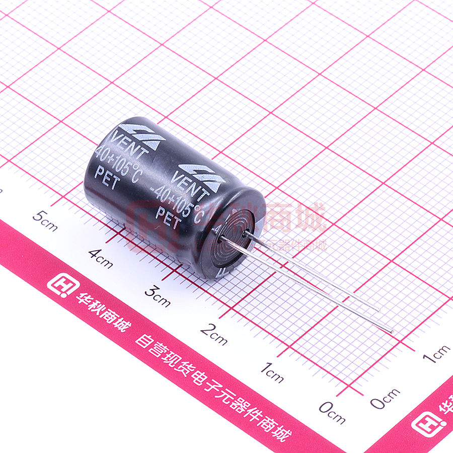

    直插铝电解电容 插件,D13xL21mm 33µF ±20% Ф13.00 x 21.00mm 400V 211mA 2000Hrs@105℃
CD1102G330M 数据手册
物料承认书 RoHS APPROVAL SHEET 档案编号: 客户名称: Customer Name: 华秋 供应商 东莞市创慧电子有限公司 公司地址 东莞市谢岗镇金川工业区 物料名称 铝电解电容器 物料名称 铝电解电容器 物料编码 CD1102G330M 物料品牌 CH 物料规格 400V33uF 供方电话 0769-87633398 物料尺寸 D13X21L 供方传真 0769-87633399 物料规格书 : N Y ROHS检测报告: N Y 样品测试报告: N Y IQC样品: N Y 附件 新机型物料 物料变更 增加/变更供应商 其它: 备注 客户确认栏 批准 Approver 审核 Checker 制作 Engineer 盖章 日期: 供应商确认栏 批准 Approver 审核 Checker 制作 Engineer 刘劲松 魏小容 邓瑶玲 日期: 1 of 5 盖章 2022/6/28 CH-QC-JL-019 B/0 CD110 Series Aluminum Electrolytic Capacitors Item Name Rating CD1102G330M 400V33uF 1. Operating Temp. Range Case size D13X21L -40+105℃ 2. Electrical Characteristics See Table 1. 【Table 1】 Rated Voltage VDC Surge Voltage VDC Nominal Static Capacitance (μF) Tolerance on Capacitance (%) 20℃ 120Hz Dissipation Factor (tanδ) max 20℃ 120Hz Leakage Current 2min. 20 ℃(μA) 400 450 33 ±20% 0.20 279 Permissible Impedance Ripple (Ω) Current 100KHz (mArms) 20℃ 105℃120Hz 211 / 3. Dimensions Insulating Sleeve P±0.5 ΦD+α max. φd±0.05 Tinned copper-ply wire L±β 15min. 4min. Safety vent (Φ8up) Rubber Bung Φ6.3 is available by Request Unit(mm) ΦD 13 α 0.5 L 21.0 β 2.0 Φd 0.6 P 5.0 4. Marking Following items are printed with white colour on black colour sleeve Example of Marking 33μF ① 400V ① Rated Voltage & Nominal Capacitance ② Polarity (negative) ③ Trade Mark of CH ② ④ Product Series ③ VENT PET ⑤ Operating Temp. Range ④⑤ -40+105℃ 5. MULTIPLIER FOR RIPPLE CURRENT ①. Frequency Coefficient Freq.(Hz) Cap(μF) 50Hz 120Hz 300Hz 1KHz 10KHz 1 1.35 1.55 2 40 60 70 85 105 2.4 2.1 1.78 1.65 1 33 0.75 ②. Temperature Coefficient Ambient Temperature(℃) Coefficient 2 of 5 CH-QC-JL-019 B/0 6. Characteristics No. Item 1 Leakage Current 2 Static Capacitance 3 Dissipation Factor (tanδ) 4 Load Life Leakage Current Cap. Change Dissipation Factor Appearance ≤the value specified in Table 1 ≤±20% of initial value ≤200% of value specified in Table 1 No remarkable abnormality Test condition: 105±2℃ 120Hz Applied voltage: Rated voltage Applied Ripple Current: 211mArms Test Time: 2000 +72, -0 hours 5 Shelf Life Leakage Current Cap. Change Dissipation Factor Appearance ≤the value specified in Table 1 ≤±20% of initial value ≤200% of value specified in Table 1 No remarkable abnormality Test Temp. : 105±2℃ No voltage applied Test Time : 1000 hours +24, -0 hours 6 Terminal Strength Tensile Strength Bending Strength 7 Impedance Ratio 8 Temperature Characteristics Performance Test Method I≤ 279μA Protection Resistor: 1000±10Ω Applied Volt: Rated Voltage Measuring time: 2 minutes ±20% Measured Frequency: 120Hz±20% Measured Voltage: ≤ 0.5Vrms, 1.5 ~ 2.0VDC 0.20 and Under Same as condition of Capacitors 45N {4.5kg} 25N {2.5kg} Z(-25℃)/Z(+20℃) Z(-40℃)/Z(+20℃) 6 Stage Item 2,3 Impedance Ratio 5 Cap. Change Performance 0 less than the value mentioned in 6-7 ≤±25% against value in stage 4 After the capacitor is held at temperature of each stage and reaches temperature stability, measure performance. 9 Surge Voltage 10 Vibration Resistance 11 Solderbility Keeping time Tensile: 1~5 sec Bending: 30±5 sec Stage Test Temp(℃) 1 20±2 2 -25±3; 3 -40±3; 4 20±2 5 105±2 6 20±2 Item Leakage Current Cap, Change Dissipation Factor Appearance Performance ≤ the initial specified value ≤ ±15% against value before test ≤ the initial specified value No remarkable abnormality Test Temp.: 15~35℃ Test volt.: Surge Volt. Specified in 2 Capacitance Cap. Change Appearance Stability required ≤±5% of the initial specified value No remarkable abnormality Frequency: 10~55Hz Width of vibration: 1.5mm Direction and duration: 3/4 area of surrounding directions of surface should be covered with new solder. Voltage apply 1,000 times of charge for 30±5 sec, under frequency of 6±0.5 sec, and discharge for 5min 30sec. X,Y and Z directions, each for 2 hours Solder: Sn-Ag, Sn-Cu Type Soldering Temp: 240±5℃ Dipping degree: 2~2.5mm Flux: Ethanol solution (JIS K8101) or Isopropylalchol (JIS K8839) solution of Rosin (JIS K5902) 12 Resistance to Soldering Leakage Current Cap, Change Dissipation Factor Appearance ≤ the initial specified value ≤ ±15% against value before test ≤ the initial specified value No remarkable abnormality 3 of 5 Soldering Temp. 280±5℃ Soldering Time . 10±1sec. CH-QC-JL-019 B/0 6-2. Characteristics No. Item Performance 13 Resistance to Humidity Leakage Current Cap. Change Dissipation Factor Appearance 14 Pressure valve moment characteristics 7. ≤ Initial specified value ≤±15% of initial value ≤ Initial specified value No remarkable abnormality Pressure valve open safely. There must be nothing ignition or scattering from product. Test Temp. : 40±2℃ Humidity 90~95% Test Time : 500 ± 8 hours After the above condition, restored to normal temp, and then measured. DC method: Apply an reverse current of 1A to impress the reverse voltage until pressure valve open. Packing method Packaging shape, size, quantity H W 8 9 Test Method D13X21L PCS Y-2 480 320 320 Component size Quantity per case Symbol of box L H W L Related Standards: JIS C 5141 Marking on packing box ① Item name ② Series name ③ Rated Voltage ④ Nominal Static Capacitance ⑤ Case size ⑥ Lot No. ⑦ Quantity 10 Soldering 10-1 Soldering by soldering iron Temperature of iron top : 270~350℃ Operating time : within 3 sec. 10-2 Flow soldering. Preheat : PCB surface temperature 120℃±5℃ Solder temp.: 260℃±5℃ Solder dipping time: 2~4sec. 11 Cleaning of PC board after soldering Some solvents is acceptable but make sure following condition: Solvent: IPA or Alcoholic agent like Pinealpha ST-100S, Cleanthrough 750H, 750L, 710M, 750K, or Technocare FRW-14~17 ① Cleaning should be made by ultrasonic within 5min, at the temperature less then 60℃. ② Control of pollution is necessary. ③ Keep away from cleaning agent. Please do not store in air-tight container. Dry it by hot air, keep the temperature of air less than maximum operating temp. 4 of 5 CH-QC-JL-019 B/0 东莞市创慧电子有限公司 DongGuan ChuangHui electronics Co.,Ltd. TEST DATA SHEET OF ELECTROLYTIC CAPACITORS (检测数据表) DATE 2022/6/28 (日期): CUSTOMER (客户): RATINGS Item (数 400V33uF CASE SIZE (尺 5.0 ±0.5mm LEAD DIA. (引 线 直 径): (规格): 10 PCS 量): BRAND/SERIES (商标 / 系列): 华秋 LEAD PITCH (脚距): QUANTITY 寸): CH CD110 D13X21L 0.6 ±0.05mm Capacitance Max. Tanδ Max. Leakage Max. Max. Ripple Working Tolerance at at 120Hz Current (μA) Impedance (Ω) Current (mArms) Temp. (℃) 120Hz 20℃ 20℃ after 2 min. at 100KHz 20℃ at 120Hz 105 ℃ Spec ±20% 20% 279.0 / No. Capcitance (μF) Tanδ (%) Leakage Current(μA) Impedance (Ω) 1 28.8 3.6 22.4 2 28.5 3.7 22.1 3 28.6 3.9 23.1 4 28.7 3.8 23.1 5 28.8 3.9 25.1 6 28.7 3.7 24.0 7 28.6 3.9 20.0 8 28.5 3.8 19.2 9 28.5 3.6 21.5 10 28.7 3.7 23.4 MIN. 28.5 3.6 19.2 MAX. 28.8 3.9 25.1 AVE. 28.7 3.8 22.4 核准 刘劲松 审核 魏小容 5 of 5 211 -40+105℃ Surge Volt. (V) 450 Remarks 制作 邓瑶玲 CH-QC-JL-019 B/0
