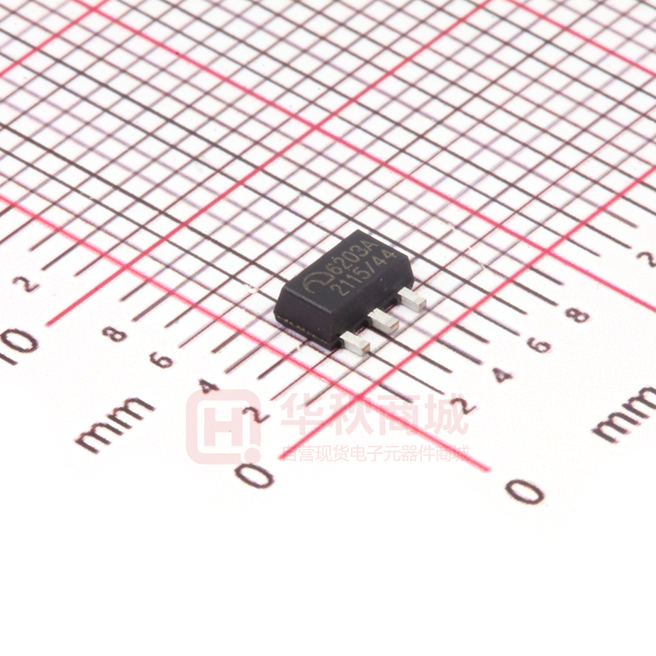

ME6203A44PG
ME6203A44PG
    MICRONE(南京微盟)
    SOT89-3
    100 mA、高输入电压LDO线性稳压器
ME6203A44PG 数据手册
ME6203 100 mA, High Input Voltage LDO Linear Regulators ME6203 Series General Description Features ME6203 series are low-dropout linear  High output accuracy:± 2% voltage regulators with a built-in voltage  Input voltage:up to 40 V reference module, error correction module  Output voltage:1.8V ~ 12V and phase compensation module. ME6203  Ultra-low quiescent current (Typ.= 3 µ A) series are based on the CMOS process and  Output Current:IOUT = 100mA (When VIN = 5.5V and VOUT =3.3V) allow high voltage input with low quiescent current. This series can deliver 100mA  Short-circuit Current:(Typ.= 20mA) output current and allow an input voltage as  Low temperature coefficient high as 40V.This series has the function of  Ceramic capacitor can be used internal feedback resistor setting from 1.8V to 12V. The output accuracy is ± 2%. Package Typical Application  Electronic weighbridge  SCM  Phones, cordless phones  Security Products  Water meters, power meters  3-pin SOT89-3 、SOT23-3 、TO92 Typical Application Suggesting : The circuit uses the electrolytic capacitors or tantalum capacitors in the best ,when it is applied in the high input voltage. V08 www.microne.com.cn Page 1 of 12 ME6203 Selection Guide ME 6203X X X X X G Environment mark Package: M3--SOT23-3 P--SOT89-3 T--TO92 Output Voltage Function Product Type Product Series Microne product series product description ME6203A18M3G VOUT =1.8V; Package:M3,P,T ME6203A25M3G VOUT =2.5V; Package:M3,P,T ME6203A30M3G VOUT =3.0V; Package:M3,P,T ME6203A33M3G VOUT =3.3V; Package::M3,P,T ME6203A36M3G VOUT =3.6V; Package:M3,P,T ME6203A44M3G VOUT =4.4V; Package:M3,P,T ME6203A50M3G VOUT =5.0V; Package:M3,P,T NOTE: If you need other voltage and package, please contact our sales staff。 V08 www.microne.com.cn Page 2 of 12 ME6203 Pin Configuration Pin Assignment Pin Number Pin Name Functions 1 VSS Ground 2 3 VIN Power Input 3 2 VOUT Output SOT89-3 / TO92 SOT23-3 1 Block Diagram V08 www.microne.com.cn Page 3 of 12 ME6203 Absolute Maximum Ratings Parameter Symbol Ratings Units Input Voltage VIN 40 V Output Current IOUT 150 mA Output Voltage VOUT Vss-0.3~VIN +0.3 V SOT89-3 Power Dissipation 500 TO92 PD 500 SOT23-3 mW 300 Operating Junction Temperature Range TJ -45~+150 ℃ Storage Temperature Range TSTG -55~+150 ℃ Lead Temperature 260℃,10sec Electrical Characteristics ME6203A18 (VIN= VOUT+2.0V,CIN=CL=10uF,Ta=25OC, unless otherwise noted) Parameter Symbol Conditions Min. Typ. Max. Units Output Voltage VOUT(E) (Note 2) IOUT=10mA X 0.98 VOUT (T) (Note 1) X 1.02 V Input Voltage VIN 40 V Maximum Output Current IOUT _max VIN= VOUT+3.7V 100 ∆VOUT VIN= VOUT +3.7V, 1mA≤IOUT≤100mA 30 Dropout Voltage (Note 3) VDIF IOUT =100mA 3.7 Supply Current ISS VIN= VOUT +2V 2.0 4 μ A Line Regulations ∆VOUT ∆VIN ×VOUT IOUT =1mA VOUT +1V ≤VIN≤40V 0.03 0.1 %/V Short-circuit Current ISHORT VOUT=0V 20 40 mA Temperature Coefficient ∆VOUT VOUT×∆Ta IOUT =10mA -40℃≤Ta≤85℃ 80 Load Regulation V08 3.0 www.microne.com.cn mA 60 mV V ppm/℃ Page 4 of 12 ME6203 ME6203A25 (VIN= VOUT+2.0V,CIN=CL=10uF,Ta=25OC, unless otherwise noted) Parameter Symbol Conditions Min. Typ. Max. Units Output Voltage VOUT(E) (Note 2) IOUT=10mA X 0.98 VOUT (T) (Note 1) X 1.02 V Input Voltage VIN 40 V Maximum Output Current IOUT _max VIN= VOUT+3.0V 100 ∆VOUT VIN= VOUT +3.0V, 1mA≤IOUT≤100mA 32 Dropout Voltage (Note 3) VDIF IOUT =100mA 3.0 Supply Current ISS VIN= VOUT +2V 2.5 4 μ A Line Regulations ∆VOUT ∆VIN ×VOUT IOUT =1mA VOUT +1V ≤VIN≤40V 0.02 0.1 %/V Short-circuit Current ISHORT VOUT=0V 20 40 mA Temperature Coefficient ∆VOUT VOUT×∆Ta IOUT =10mA -40℃≤Ta≤85℃ 80 Load Regulation 3.0 mA 60 mV V ppm/℃ ME6203A30 (VIN= VOUT+2.0V,CIN=CL=10uF,Ta=25OC, unless otherwise noted) Parameter Symbol Conditions Min. Typ. Max. Units Output Voltage VOUT(E) (Note 2) IOUT=10mA X 0.98 VOUT (T) (Note 1) X 1.02 V Input Voltage VIN 40 V Maximum Output Current IOUT _max VIN= VOUT+2.5V 100 ∆VOUT VIN= VOUT +2.5V, 1mA≤IOUT≤100mA 30 IOUT =10mA 0.25 V IOUT =50mA 1.2 V Load Regulation 3.0 mA 60 mV Dropout Voltage (Note 3) VDIF Supply Current ISS VIN= VOUT +2V 3 4 μ A Line Regulations ∆VOUT ∆VIN ×VOUT IOUT =1mA VOUT +1V ≤VIN≤40V 0.02 0.1 %/V Short-circuit Current ISHORT VOUT=0V 20 40 mA Temperature Coefficient ∆VOUT VOUT×∆Ta IOUT =10mA -40℃≤Ta≤85℃ 80 V08 www.microne.com.cn ppm/℃ Page 5 of 12 ME6203 ME6203A33 (VIN= VOUT+2.0V,CIN=CL=10uF,Ta=25OC, unless otherwise noted) Parameter Symbol Conditions Min. Typ. Max. Units Output Voltage VOUT(E) (Note 2) IOUT=10mA X 0.98 VOUT (T) (Note 1) X 1.02 V Input Voltage VIN 40 V Maximum Output Current IOUT _max VIN= VOUT+2.2V 100 ∆VOUT VIN= VOUT +2.2V, 1mA≤IOUT≤100mA 30 IOUT =10mA 0.22 V IOUT =50mA 1.1 V Load Regulation 3.3 mA 60 mV Dropout Voltage (Note 3) VDIF Supply Current ISS VIN= VOUT +2V 3 4 μ A Line Regulations ∆VOUT ∆VIN ×VOUT IOUT =1mA VOUT +1V ≤VIN≤40V 0.04 0.1 %/V Short-circuit Current ISHORT VOUT=0V 20 40 mA Temperature Coefficient ∆VOUT VOUT×∆Ta IOUT =10mA -40℃≤Ta≤85℃ 80 ppm/℃ ME6203A36 (VIN= VOUT+2.0V,CIN=CL=10uF,Ta=25OC, unless otherwise noted) Parameter Symbol Conditions Min. Typ. Max. Units Output Voltage VOUT(E) (Note 2) IOUT=10mA X 0.98 VOUT (T) (Note 1) X 1.02 V Input Voltage VIN 40 V Maximum Output Current IOUT _max VIN= VOUT+2.2V 100 ∆VOUT VIN= VOUT +2.2V, 1mA≤IOUT≤100mA 30 IOUT =10mA 0.20 V IOUT =50mA 1.0 V Load Regulation 3.6 mA 60 mV Dropout Voltage (Note 3) VDIF Supply Current ISS VIN= VOUT +2V 3 4 μ A Line Regulations ∆VOUT ∆VIN ×VOUT IOUT =1mA VOUT +1V ≤VIN≤40V 0.02 0.1 %/V Short-circuit Current ISHORT VOUT=0V 20 40 mA Temperature Coefficient ∆VOUT VOUT×∆Ta IOUT =10mA -40℃≤Ta≤85℃ 80 V08 www.microne.com.cn ppm/℃ Page 6 of 12 ME6203 ME6203A44 (VIN= VOUT+2.0V,CIN=CL=10uF,Ta=25OC, unless otherwise noted) Parameter Symbol Conditions Min. Typ. Max. Units Output Voltage VOUT(E) (Note 2) IOUT=10mA X 0.98 VOUT (T) (Note 1) X 1.02 V Input Voltage VIN 40 V Maximum Output Current IOUT _max VIN= VOUT+2.0V 100 ∆VOUT VIN= VOUT +2.0V, 1mA≤IOUT≤100mA 31 IOUT =10mA 0.17 V IOUT =50mA 0.82 V Load Regulation 4.4 mA 60 mV Dropout Voltage (Note 3) VDIF Supply Current ISS VIN= VOUT +2V 3 4 μ A Line Regulations ∆VOUT ∆VIN ×VOUT IOUT =1mA VOUT +1V ≤VIN≤40V 0.02 0.1 %/V Short-circuit Current ISHORT VOUT=0V 20 40 mA Temperature Coefficient ∆VOUT VOUT×∆Ta IOUT =10mA -40℃≤Ta≤85℃ 80 ppm/℃ ME6203A50 (VIN= VOUT+2.0V,CIN=CL=10uF,Ta=25OC, unless otherwise noted) Parameter Symbol Conditions Min. Typ. Max. Units Output Voltage VOUT(E) (Note 2) IOUT=10mA X 0.98 VOUT (T) (Note 1) X 1.02 V Input Voltage VIN 40 V Maximum Output Current IOUT _max VIN= VOUT+2.0V 100 ∆VOUT VIN= VOUT +2.0V, 1mA≤IOUT≤100mA 33 IOUT =10mA 0.13 V IOUT =50mA 0.68 V Load Regulation 5.0 mA 60 mV Dropout Voltage (Note 3) VDIF Supply Current ISS VIN= VOUT +2V 3.3 4.5 μ A Line Regulations ∆VOUT ∆VIN ×VOUT IOUT =1mA VOUT +1V ≤VIN≤40V 0.03 0.1 %/V Short-circuit Current ISHORT VOUT=0V 25 40 mA Temperature Coefficient ∆VOUT VOUT×∆Ta IOUT =10mA -40℃≤Ta≤85℃ 80 ppm/℃ Note : 1. VOUT (T) :Specified Output Voltage 2.VOUT (E) :Effective Output Voltage ( ie. The output voltage when “VOUT (T)+ 2.0V”is provided at the VIN pin while maintaining a certain IOUT value.) 3.VDIF:VIN1 –VOUT (E)’ V08 www.microne.com.cn Page 7 of 12 ME6203 VIN1 :The input voltage when VOUT(E)’ appears as input voltage is gradually decreased. VOUT (E)’=A voltage equal to 98% of the output voltage whenever an amply stabilized IOUT and {VOUT (T)+2.2V} is input. Type Characteristics (1)Output Voltage VS. Output Current ( Ta = 25 °C) (2)Output Voltage VS. Input Voltage( Ta = 25 °C) ME6203A33(VIN=VOUT+2.2V) ME6203A33 Output Voltage VS.Input Voltage 3.4 3.4 3.35 3.35 3.3 Output Voltage(V) Output Voltage(V) Output Voltage VS.Output Current 3.25 3.2 3.15 3.1 3.3 3.25 3.2 3.15 IOUT=1mA IOUT=20mA 3.1 3.05 3.05 3 3 0 10 20 30 40 50 60 70 80 90 100 5 10 15 Output Current(mA) 20 25 30 35 40 Input Voltage(V) (3)Dropout Voltage VS. Output Current( Ta = 25 °C) (4)Quiescent Current VS. Input Voltage(Ta = 25 °C) ME6203A33 ME6203A33 Quiescent Current VS.Input Voltage Dropout Voltage VS.Output Current 5.00 Quiescent Current(uA) Dropout Voltage(V) 2.50 2.00 1.50 1.00 0.50 0.00 10 20 30 40 50 60 70 80 90 4.00 3.00 2.00 1.00 0.00 5 100 10 15 25 30 35 Input Voltage(V) Output Current(mA) (5) Output Voltage VS.Temperature ME6203A33 (IOUT=10mA) (6)Quiescent Current VS. Temperature ME6203A33 (VIN=VOUT+2.2V) Quiescent Current VS.Temperature Output Voltage VS.Temperature 3.35 Quiescent Current(uA) 4 3.3 Output Voltage(V) 20 3.25 3.2 3.15 3.5 3 2.5 2 1.5 1 3.1 -45 -40 -30 -20 -10 0 10 20 30 40 50 60 70 80 90 100 110 120 130 140 150 V08 -45 -40 -30 -25 -20 -10 0 10 20 30 40 50 60 70 80 85 90 100 110 120 130 140 150 Temperature(℃) Temperature(℃) www.microne.com.cn Page 8 of 12 40 ME6203 Packaging Information ● Packaging Type: SOT89-3 DIM A b b1 c D D1 D2 e1 E E1 E2 e L θ V08 Millimeters Min 1.4 0.32 0.4 0.35 4.4 Inches Max 1.6 0.52 0.58 0.45 4.6 Min 0.0551 0.0126 0.0157 0.0138 0.1732 1.55(TYP) 1.75(TYP) 3.0(TYP) 2.3 3.94 0.061(TYP) 0.0689(TYP) 0.1181(TYP) 2.6 4.4 0.0906 0.1551 1.9(TYP) 1.5(TYP) 0.8 Max 0.0630 0.0205 0.0228 0.0177 0.1811 0.1023 0.1732 0.0748(TYP) 0.0591(TYP) 1.2 45° www.microne.com.cn 0.0315 0.0472 45° Page 9 of 12 ME6203 ● Packaging Type: TO92 DIM A A1 b c D D1 E e e1 L h Φ V08 Millimeters Min 3.3 1.1 0.38 0.36 4.3 3.43 4.3 Inches Max 3.7 1.4 0.55 0.51 4.7 一 4.7 Min 0.1299 0.0433 0.015 0.0142 0.1693 0.135 0.1693 1.27TYP 2.44 14.1 0 一 Max 0.1457 0.0551 0.0217 0.0201 0.185 一 0.185 0.05TYP 2.64 14.5 0.38 1.6 www.microne.com.cn 0.0961 0.5551 0 一 0.1039 0.5709 0.015 0.063 Page 10 of 12 ME6203 ● Packaging Type: SOT23-3 DIM A A1 A2 A3 b c D E E1 e L L1 θ c1 L1 θ c1 V08 Millimeters Min 1 0 0.9 0.6 0.25 0.1 2.8 2.6 1.5 Inches Max 1.5 0.15 1.3 0.7 0.5 0.25 3.1 3.1 1.8 Min 0.0394 0.0000 0.0354 0.0236 0.0098 0.0039 0.1102 0.1023 0.0591 0.95(TYP) 0.25 0.0374(TYP) 0.6 0.0098 0.59(TYP) 0 0.0236 0.0232(TYP) 8° 0.0000 0.2(TYP) 0.59(TYP) 0 Max 0.0591 0.0059 0.0512 0.0276 0.0197 0.0098 0.1220 0.1220 0.0709 8° 0.0079(TYP) 0.0232(TYP) 8° 0.2(TYP) www.microne.com.cn 0.0000 8° 0.0079(TYP) Page 11 of 12 ME6203      The information described herein is subject to change without notice. Nanjing Micro One Electronics Inc is not responsible for any problems caused by circuits or diagrams described herein whose related industrial properties, patents, or other rights belong to third parties. The application circuit examples explain typical applications of the products, and do not guarantee the success of any specific mass-production design. Use of the information described herein for other purposes and/or reproduction or copying without the express permission of Nanjing Micro One Electronics Inc is strictly prohibited. The products described herein cannot be used as part of any device or equipment affecting the human body, such as exercise equipment, medical equipment, security systems, gas equipment, or any apparatus installed in airplanes and other vehicles, without prior written permission of Nanjing Micro One Electronics Inc. Although Nanjing Micro One Electronics Inc exerts the greatest possible effort to ensure high quality and reliability, the failure or malfunction of semiconductor products may occur. The user of these products should therefore give thorough consideration to safety design, including redundancy, fire-prevention measures, and malfunction prevention, to prevent any accidents, fires, or community damage that may ensue. V08 www.microne.com.cn Page 12 of 12
