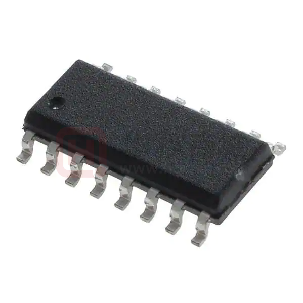

SA6880-S - 3.5 A / 1200 V IGBT Driver Preliminary Datasheet – DPD1181 SA6880-S - Isolated 3.5 A / 1200 V IGBT Driver 1 Features 3 - Single-channel 1200 V isolated driver optimized for industrial and automotive applications - 3.5 A peak output current - 3.75 kVrms input to output isolated voltage - High common-mode transient immunity: higher than 50 kV/µs - Less than 115 ns propagation delay - Less than ±20 ns pulse width distortion - Integrated IGBT protection functions: o IGBT soft turn-off o Desaturation detection (DESAT) o Active Miller-Current clamp o High Side undervoltage lockout (UVLO) protection with feedback o Fault sensing/reporting to system controller (DESAT & UVLO) - TTL compatible inputs - Automotive temperate range - Bipolar or unipolar supply operation - Wide 30 V output supply range - UL1577 certified to VISO = 3750 VRMS for 60 seconds. - IEC60747-17 and VDE 0884-10 compliant 2 Applications - AC/DC motor drives Air-conditioning inverters Welding/plasma equipment Uninterruptible power supplies Battery charging systems Automotive OBC and traction inverters Auxiliary inverters for HEV and EV PV solar inverters and optimizers Description The SA6880-S is a full-featured, galvanically isolated, 3.5 A / 1200 V-rated gate driver IC. This single-chip solution integrates features that improve performance and ensure long-life in harsh environments. It can be used for fast-switching drive and protection of power IGBT’s, Si and SiC MOSFETs. The driver incorporates Solantro’s onchip coreless transformer technology to enable 3.75 kVrms input to output isolated voltage and high transient immunity (>50 kV/µs) as required in industrial and automotive applications. The driver is suitable for motor control, switch mode power supply (SMPS), PFC, UPS, EV-OBC, industrial pumps, and traction inverter applications. Its short propagation delay and small timing-skew help achieve optimum performance at higher switching speeds when compared with other driver solutions available in the market. All logic pins are TTL compatible for easy interface to standard controllers and MCUs. The SA6880-S architecture includes several control features protecting the device in harsh industrial and automotive environments. These integrated features include over-current (desaturation) sensing with soft-shutdown protection, high-side undervoltage lockout, active Miller-Current clamping and fault reporting. The driver supports bipolar and unipolar supply voltage configurations. In a bipolar configuration, the driver is typically supplied with voltages of +18 V and -5 V. For unipolar configuration, the driver is typically supplied with a positive 18 V (max 32 V). To meet UL isolation, creepage and clearance requirements the SA6880-S is available in a standard SOIC-16W (wide-body) package. © 2019 Solantro® The mark “Solantro” is a registered trademark of Solantro Semiconductor Corp. Page 1 of 20 DPD1181 – v1.6 SA6880-S - 3.5 A / 1200 V IGBT Driver Preliminary Datasheet – DPD1181 12 V 3 VCCL C1 VNEG 1&4 +5 V VDDH GNDL VE 18 V 12 9&16 C2 -5V 13 GNDL C5 5 R3 R4 µC C4 C3 6 7 8 UVLOB FAULTB IP IN DESAT OUT 14 GATE 10 11 GNDH D2 R1 D1 R2 GNDH Figure 1- Typical application configuration Content 1 Features ................................................................................................................................................... 1 2 Applications .............................................................................................................................................. 1 3 Description ............................................................................................................................................... 1 4 Pin Configuration and Functional Diagram ................................................................................................ 3 5 Specifications ............................................................................................................................................ 4 5.1 Absolute maximum rating ..................................................................................................................... 4 5.2 Recommended operating conditions .................................................................................................... 5 5.3 Electrical characteristics ........................................................................................................................ 5 5.3.1 Power supply ............................................................................................................................ 5 5.3.2 Logic inputs and outputs .......................................................................................................... 6 5.3.3 Gate Driver output characteristics ........................................................................................... 6 5.3.4 Active Miller clamp .................................................................................................................. 7 5.3.5 Desaturation protection ........................................................................................................... 7 5.3.6 Package characteristics ............................................................................................................ 8 5.4 Insulation characteristics ....................................................................................................................... 8 5.4.1 Compliance with UL1577 ......................................................................................................... 8 6 Detailed Description ................................................................................................................................. 9 6.1 Power Supplies ...................................................................................................................................... 9 6.2 Input & Output ...................................................................................................................................... 9 6.2.1 Non-Inverting and Inverting Inputs .......................................................................................... 9 6.2.2 Rise and fall and propagation delay ....................................................................................... 10 6.2.3 FAULTB and UVLOB outputs .................................................................................................. 10 6.2.4 Driver output .......................................................................................................................... 10 6.3 Internal protection function ................................................................................................................ 10 6.3.1 Undervoltage lockout (UVLO) ................................................................................................ 10 6.4 External Protection .............................................................................................................................. 12 6.4.1 Desaturation Protection (DESAT) ........................................................................................... 12 6.4.2 Active Miller clamping ............................................................................................................ 14 7 Isolation ....................................................................................................................................................... 15 8 Common mode transient immunity .............................................................................................................. 15 4 SA6880-S - 3.5 A / 1200 V IGBT Driver Preliminary Datasheet – DPD1181 Pin Configuration and Functional Diagram Figure 2- Functional block diagram PIN Name Description 1 GNDL Low side (LS) ground 2 NC No connect – (note: connecting to GND or other signals can result in damage to the IC) 3 VCCL Low side (LS) power supply 4 GNDL Low side (LS) ground 5 UVLOB Undervoltage lockout, open drain active LOW output 6 FAULTB Desaturation (Over-current protection) Fault, open Drain active LOW output 1 7 IP Non-inverting driver input. 2 8 IN Inverting driver input. 9 VNEG High side (HS) negative supply voltage (Ref. VNEG) 10 GATE IGBT Gate connection for Miller current clamp and SSD (soft-shutdown) pull-down 11 OUT Driver output 12 VDDH High side (HS) positive supply 13 VE Connected to IGBT emitter 14 DESAT Desaturation (overcurrent) sensing input 15 NC No connect, for factory test only 16 VNEG High side negative supply voltage (Ref. VNEG) Note: 1) IP input controls signal for the driver output while IN is set to low. The IGBT is turned on if IP is set to high and IN is set to low, otherwise is turned off. A minimum pulse width is required to suppress glitches while controlling the IGBT. An internal pull-down resistor ensures that the IGBT is kept in off-state if terminal IP is left unconnected. 2) IN input control signals for the driver output while IP is set to high. The IGBT is turned on if IN- is set to low, and is turned off if IN- is set to high, while IN is kept high. © 2019 Solantro® The mark “Solantro” is a registered trademark of Solantro Semiconductor Corp. Page 3 of 20 DPD1181 – v1.6 5 SA6880-S - 3.5 A / 1200 V IGBT Driver Preliminary Datasheet – DPD1181 Specifications 5.1 Absolute maximum rating Absolute maximum ratings are defined as ratings, which when being exceeded may lead to destruction of the integrated circuit. Unless otherwise specified, all voltages at input IC reference to GNDL, all voltages at output IC reference to VE. Parameter Symbol Min Max Unit Low side power supply VCCL -0.3 18 V Positive power supply of high side VDDH -0.3 30 V Negative power supply of high side VNEG -15 0.3 V Maximum power supply voltage high side VMAX_OUT 36 V (VDDH-VNEG) Gate driver output voltage VOUT VNEG-0.3 VDDH+0.3 V 1 Peak source output current IOUT_SOURCE / 3.5 A 2 Peak sink output current IOUT_SINK 3.5 A 3 Gate clamping sinking current ICLAMP_SINK / 1.2 A Logic interface at input side (pins UVLOB, VLOGIC -0.3 6.5 V FAULTB, IN and IP) Pin DESAT voltage VDESAT -0.3 VDDH+0.3 V Pin GATE voltage VCLAMP -0.3 VDDH+0.3 V Driver junction temperature T J -40 150 Storage temperature T S -40 150 Operating temperature T A -40 125 4 Max switching frequency fMAX 400 kHz Low side power dissipation PD_IN 150 mW High side power dissipation PD_OUT 580 mW VESD_HBM / 2.5 kV ESD capability (Human Body Model) VESD_HBM / 200 V ESD capability (Machine model) ESD capability (charged device model) VESD_CDM / 500 V Isolation voltage RMS (1 s testing time) VISO_RMS 4.5 kV Note: 1) The peak output current is measured at maximum pulse width equal to 2.5 µs, maximum duty cycle 1% 2) The sink output current is measured at maximum OFF time equal to 2.5 µs, maximum duty cycle 99% 3) The gate clamp sink current is measured at Maximum OFF time equal to 2.5 µs, maximum duty cycle 99% and voltage between GATE and VNEG equal to 2 V. 4) The load is 1 nF and a 10 Ω resistor. 5) The LS pins are shorted and HS pins are shorted and VIO = 500 V © 2019 Solantro® The mark “Solantro” is a registered trademark of Solantro Semiconductor Corp. Page 4 of 20 DPD1181 – v1.6 SA6880-S - 3.5 A / 1200 V IGBT Driver Preliminary Datasheet – DPD1181 5.2 Recommended operating conditions Parameter Low side power supply High side positive power supply High side negative power supply High side bipolar power supply 1 Inputs witching frequency Operating temperature Input voltage (ON) Input voltage (OFF) 1 Input minimum pulse width Symbol Min TYP Max Unit VCCL VDDH-VE VNEG-VE VDDH-VNEG fSW T A 8 12 -12 - -40 12 - - - 18 24 0 28 150 125 V V V V kHz Vin_ON Vin_OFF 3.3 0 5.5 0.5 V V tON 250 ns ℃ Note: 1) Tested with a load of 10 nF capacitor and a 10 Ω resistor. 5.3 Electrical characteristics Unless otherwise specified, all Min/Max specification parameters are at recommended operating conditions, all voltages at input IC are referenced to GNDL, all voltages at output IC referenced to VNEG. All typical values at TA = 25 °C, VCCL = 12 V, VDDH-VNEG = 20 V, VE-VNEG = 0 V 5.3.1 Power supply Parameters Symbol MIN TYP Low side quiescent current driver set IQ_LS_OFF 8 to OFF Low side quiescent current driver set IQ_LS_ON 13.5 to ON High side quiescent current driver set IQ_HS_OFF 16 to OFF High side quiescent current driver set IQ_HS_ON 16.5 to ON UVLO threshold high (rising) VUVLO_H 11.8 11.9 UVLO threshold low (falling) VUVLO_L 11.1 11.4 UVLO hysteresis VUVLO_HYS 0.5 1 Minimum duration for UVLO report tMIN_UVLO_REPORT 1 VDDH UVLO to OUT go low delay tUVLO_ON 5 1 VDDH UVLO to OUT go high delay tUVLO_OFF 5 OUT to UVLOB high low tHL_UVLO_COM_DEL 1 communication delay OUT to UVLOB low high tLH_UVLO_COM_DEL 1 communication delay Note: 1) Guaranteed by design. (see Figure 6 thru Figure 8 for definition of the times.) © 2019 Solantro® The mark “Solantro” is a registered trademark of Solantro Semiconductor Corp. Page 5 of 20 MAX Unit 9 mA 14.5 mA 17 mA 18 mA 12.2 11.7 100 V V V µs µs µs 5 µs 5 µs DPD1181 – v1.6 SA6880-S - 3.5 A / 1200 V IGBT Driver Preliminary Datasheet – DPD1181 5.3.2 Logic inputs and outputs VCCL-GNDL= 12 V; VDDH-VE= 20 V; VNEG-VE= 0 V; -40°
