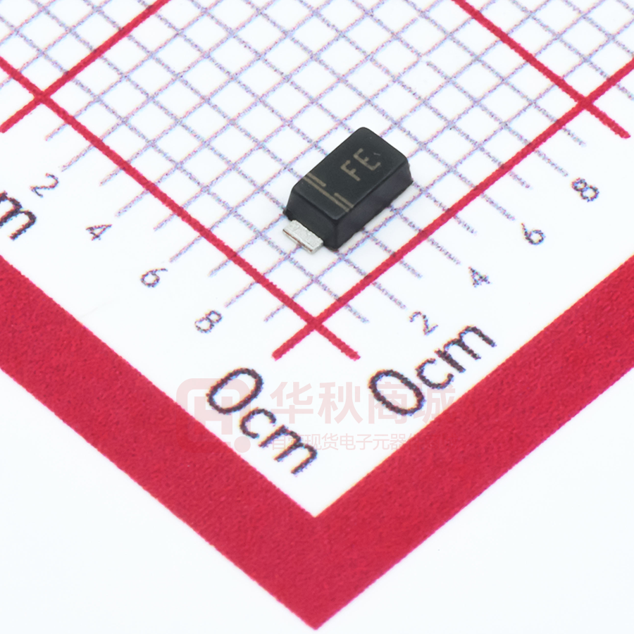

    ESD抑制器/TVS二极管 单向 5V 21.7A 1KW SOD-123FL
SMF5.0A 数据手册
UMW R UMW SMF5.0A(CA) THRU SMF170A(CA) 5.0V-170V 175-200W FEATURES * Stand-off voltage ; 5 - 170 Volts * Peak Power ; - 200 Watts @ 1 ms (SMF5.0A - SMF58A) - 175 Watts @ 1 ms (SMF60A - SMF170A) * Maximum clamp voltage @ Peak pulse current * Low leakage * Pb Free / RoHS Compliant Mechanical Data * Case: JEDEC SOD-123FL, molded plastic over passivated chip * Terminals: Solder Plated, solderable per MIL-STD-750, Method 2026 * Polarity: Color band denotes cathode end * Mounting position : Any * Weight: 0.006 ounces, 0.02 gram MAXIMUM RATINGS AND ELECTRICAL CHARACTERISTICS Rating at 25 °C ambient temperature unless otherwise specified. Parameter Symbol Maximum P PK Dissipation (PW - 10/1000 μs) SMF60A - SMF170A (Note 1) SMF5.0A - SMF58A Value Unit 175 W 200 W PPK Maximum P PK Dissipation @ Ta = 25 °C (PW - 8/10 μs) (Note 2) PPK 1000 W DC Power Dissipation @ Ta = 25 °C PD 385 mW 4.0 mW/ °C (Note 3) Derate above 25 °C Thermal Resistance, Junction to Ambient (Note 3) RӨJA 325 °C/W Thermal Resistance, Junction to Lead (Note 3) RӨJL 26 °C/W TJ, TSTG -55 to +150 °C Operating Junction and Storage Temperature Range Notes : (1) Non−repetitive current pulse at Ta = 25°C, per waveform of Fig. 2. (2) Non−repetitive current pulse at Ta = 25°C, per waveform of Fig. 5. (3) Mounted with recommended minimum pad size, DC board FR −4. www.umw-ic.com 1 友台半导体有限公司 UMW R UMW SMF5.0A(CA) THRU SMF170A(CA) 5.0V-170V 175-200W ELECTRICAL CHARACTERISTICS Type No. Marking Working Peak Reverse Voltage(1) VRWM (V) 5.0 6.0 6.5 7.0 7.5 8.0 8.5 9.0 10 11 12 13 14 15 16 17 18 20 22 24 26 28 30 33 36 40 43 45 48 51 54 58 60 64 70 75 78 85 90 100 110 120 130 150 160 170 ( TL = 30 °C unless otherwise noted, VF = 1.25 Volts @ 200 mA) Breakdown Voltage @ TI Test Current Max. Reverse Leakage Current Max. Clamping Voltage at IPP VBR @ IT Nom 6.70 7.02 7.60 8.20 8.77 9.36 9.92 10.55 11.70 12.85 14.00 15.15 16.40 17.60 18.75 19.90 21.00 23.35 25.60 28.10 30.40 32.80 35.10 38.70 42.10 46.80 50.30 52.65 56.10 59.70 63.15 67.80 70.20 74.85 81.90 87.70 91.25 99.20 105.50 117.00 128.50 140.00 151.50 176.00 187.50 199.00 IT (mA) 10 10 10 10 1.0 1.0 1.0 1.0 1.0 1.0 1.0 1.0 1.0 1.0 1.0 1.0 1.0 1.0 1.0 1.0 1.0 1.0 1.0 1.0 1.0 1.0 1.0 1.0 1.0 1.0 1.0 1.0 1.0 1.0 1.0 1.0 1.0 1.0 1.0 1.0 1.0 1.0 1.0 1.0 1.0 1.0 IR @ VRWM (A) 400 400 250 100 50 25 10 5.0 2.5 2.5 2.5 1.0 1.0 1.0 1.0 1.0 1.0 1.0 1.0 1.0 1.0 1.0 1.0 1.0 1.0 1.0 1.0 1.0 1.0 1.0 1.0 1.0 1.0 1.0 1.0 1.0 1.0 1.0 1.0 1.0 1.0 1.0 1.0 1.0 1.0 1.0 VC (V) 9.2 10.3 11.2 12.0 12.9 13.6 14.4 15.4 17.0 18.2 19.9 21.5 23.2 24.4 26.0 27.6 29.2 32.4 35.5 38.9 42.1 45.4 48.4 53.3 58.1 64.5 69.4 72.7 77.4 82.4 87.1 93.6 96.8 103 113 121 126 137 146 162 177 193 209 243 259 275 Min 6.40 6.67 7.22 7.78 8.33 8.89 9.44 10.0 11.1 12.2 13.3 14.4 15.6 16.7 17.8 18.9 20.0 22.2 24.4 26.7 28.9 31.1 33.3 36.7 40.0 44.4 47.8 50.0 53.3 56.7 60.0 64.4 66.7 71.1 77.8 83.3 86.7 94.4 100 111 122 133 144 167 178 189 Max. 7.00 7.37 7.98 8.60 9.21 9.83 10.4 11.1 12.3 13.5 14.7 15.9 17.2 18.5 19.7 20.9 22.1 24.5 26.9 29.5 31.9 34.4 36.8 40.6 44.2 49.1 52.8 55.3 58.9 62.7 66.3 71.2 73.7 78.6 86.0 92.1 95.8 104 111 123 135 147 159 185 197 209 Max. Reverse Peak Pulse Current (3) IPP (mA) 21.7 19.4 17.9 16.7 15.5 14.7 13.9 13.0 11.8 11.0 10.1 9.3 8.6 8.2 7.7 7.2 6.8 6.2 5.6 5.1 4..8 4.4 4.1 3.8 3.4 3.1 2.9 2.8 2.6 2.4 2.3 2.1 1.8 1.7 1.5 1.4 1.4 1.3 1.2 1.1 1.0 0.9 0.8 0.7 0.7 0.6 AE SMF5.0A(CA) AG SMF6.0A(CA) SMF6.5A(CA) AK AM SMF7.0A(CA) SMF7.5A(CA) AP SMF8.0A(CA) AR SMF8.5A(CA) AT AV SMF9.0A(CA) SMF10A(CA) AX SMF11A(CA) AZ BE SMF12A(CA) SMF13A(CA) BG SMF14A(CA) BK BM SMF15A(CA) SMF16A(CA) BP SMF17A(CA) BR BT SMF18A(CA) SMF20A(CA) BV SMF22A(CA) BX BZ SMF24A(CA) SMF26A(CA) CE SMF28A(CA) CG CK SMF30A(CA) SMF33A(CA) CM SMF36A(CA) CP CR SMF40A(CA) SMF43A(CA) CT SMF45A(CA) CV CX SMF48A(CA) CZ SMF51A(CA) SMF54A(CA) RE RG SMF58A(CA) RK SMF60A(CA) SMF64A(CA) RM RP SMF70A(CA) RR SMF75A(CA) SMF78A(CA) RT SMF85A(CA) RV RX SMF90A(CA) RZ SMF100A(CA) SMF110A(CA) SE VG SMF120A(CA) VK SMF130A(CA) SMF150A(CA) VM SP SMF160A(CA) SR SMF170A(CA) Notes : (1) A transient suppressor is normally selected according to the Working Peak Reverse Voltage (VRWM ) which should be equal to or greater than the DC or continuous peak operating voltage level. (2) VBR measured at pulse test current TI at ambient temperature of 25 °C. www.umw-ic.com 2 友台半导体有限公司 R UMW UMW SMF5.0A(CA) THRU SMF170A(CA) 5.0V-170V 175-200W FIG.2 - 10 x 1000 μs PULSE WAVEFORM 120 Pulse Width (tp) is defined as that point where the peak current decays to 50% of IRSM tr 100 100 tr ≤ 10 μs 80 VALUE (%) PEAK PULSE DERATING IN % OF PEAK POWER OR CURRENT FIG.1 - PULSE DERATING CURVE 60 40 Peak Value - I RSM 50 Half Value - IRSM 2 Ta = 25 °C tp 20 0 0 0 25 50 100 75 125 150 0 1 Ta, AMBIENT TEMPERATURE, ( °C) FIG.3 - STEADY STATE POWER DERATING 3 4 FIG.4 - PULSE RATING CURVE 4.0 10000 Pp,PEAK POWER (W) PD, STEADY STATE POWER DISSIPATION (W) 2 t, TIME (ms) 3.0 2.0 1.0 1000 100 10 0.1μs 1.0μs 10μs 100μs 1.0ms 10ms 0 25 50 75 125 100 150 tp, PULSE WIDTH 175 TL, LEAD TEMPERATURE (°C) FIG.5 - 8 x 20 μs PULSE WAVEFORM FIG. 6 - CAPACITANCE VS. WORKING PEAK REVERSE VOLTAGE 100 Measured @ Zero Bias C, CAPACITANCE (pF) % OF PEAK PULSE CURRENT 1000 Pulse Width (tp) is defined as that point where the peak current decays = 8 μs tr Peak Value I RSM @ 8 μs Half Value I RSM/ 2 @ 20 μs 50 tp 0 0 20 40 60 80 t, TIME (μs) www.umw-ic.com 100 Measured @ 50 %VRWM 10 1 1 10 100 200 WORKING PEAK REVERSE VOLTAGE (V) 3 友台半导体有限公司 UMW R UMW SMF5.0A(CA) THRU SMF170A(CA) 5.0V-170V 175-200W ORDERING INFORMATION Order Code Package Baseqty Deliverymode UMW SMFxxA SOD-123FL 3000 Tape and reel UMW SMFxxCA SOD-123FL 3000 Tape and reel www.umw-ic.com 4 友台半导体有限公司
