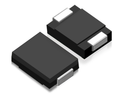

    TVS二极管 VRWM=5V VBR(Min)=6.4V VC=9.2V IPP=163A Ppp=1.5KW SMC
SMCJ5.0CA 数据手册
UMW R UMW SMCJ5.0A(CA) THRU SMCJ188A(CA) 5V-188V 1500W SMC(DO-214AB) FEATURES Cathode Band * 1500W surge capability at 1ms * Excellent clamping capability * Low zener impedance * Fast response time : typically less then 1.0 ps from 0 volt to VBR(min.) * Typical IR less then 1µA above 10V 0.155(3.94) 0.246(6.22) 0.130(3.30) 0.220(5.59) 0.280(7.11) 0.260(6.60) 0.012(0.305) 0.006(0.152) 0.103(2.62) 0.079(2.06) MECHANICAL DATA 0.060(1.52) 0.030(0.76) 0.008(0.2) * Case : SMC Molded plastic * Epoxy : UL94V-O rate flame retardant * Lead : Lead Formed for Surface Mount * Polarity : Color band denotes cathode end except Bipolar. * Mounting position : Any * Weight : 0.21 gram 0(0) 0.320(8.13) 0.305(7.75) Dimensions in inches and (millimeters) MAXIMUM RATINGS AND ELECTRICAL CHARACTERISTICS Rating at 25°C ambient temperature unless otherwise specified. Rating Symbol Value Unit Peak Pulse Power Dissipation (1) (2) PPPM Minimum 1500 W Peak Forward Surge Current per Fig. 5 (2) IFSM 200 A Maximum Instantaneous Forward Voltage at 50.0A for Unidirectional Only VF 3.5 Volts Typical Thermal Resistance , Junction to Ambient (3) RθJA 75 °C/W Operating Junction and Storage Temperature Range TJ, TSTG - 55 to + 150 °C Notes : (1) Non-repetitive Current pulse, per Fig. 3 and derated above Ta = 25 °C per Fig. 1 (2) Mounted on 0.31x 0.31" (8.0 x 8.0mm) copper pads to each terminal. (3) Mounted on minimum recommended pad layout www.umw-ic.com 1 友台半导体有限公司 UMW R UMW SMCJ5.0A(CA) THRU SMCJ188A(CA) 5V-188V 1500W ELECTRICAL CHARACTERISTICS (Rating at 25°C ambient temperature unless otherwise specified) DEVICE MARKING CODE IT (mA) VWM (V) Maximum Reverse Leakage @ VWM ID (µA) 10 10 10 10 1.0 1.0 1.0 1.0 1.0 1.0 1.0 1.0 1.0 1.0 1.0 1.0 1.0 1.0 1.0 1.0 1.0 1.0 1.0 1.0 1.0 1.0 1.0 1.0 1.0 1.0 1.0 1.0 1.0 1.0 1.0 1.0 1.0 1.0 1.0 1.0 1.0 1.0 1.0 1.0 1.0 1.0 1.0 5.0 6.0 6.5 7.0 7.5 8.0 8.5 9.0 10 11 12 13 14 15 16 17 18 20 22 24 26 28 30 33 36 40 43 45 48 51 54 58 60 64 70 75 78 85 90 100 110 120 130 150 160 170 188 1000 1000 500 200 100 50 20 10 5.0 5.0 5.0 5.0 5.0 5.0 5.0 5.0 5.0 5.0 5.0 5.0 5.0 5.0 5.0 5.0 5.0 5.0 5.0 5.0 5.0 5.0 5.0 5.0 5.0 5.0 5.0 5.0 5.0 5.0 5.0 5.0 5.0 5.0 5.0 5.0 5.0 5.0 5.0 Breakdown Voltage @ IT (1) DEVICE TYPE SMCJ5.0A(CA) SMCJ6.0A(CA) SMCJ6.5A(CA) SMCJ7.0A(CA) SMCJ7.5A(CA) SMCJ8.0A(CA) SMCJ8.5A(CA) SMCJ9.0A(CA) SMCJ10A(CA) SMCJ11A(CA) SMCJ12A(CA) SMCJ13A(CA) SMCJ14A(CA) SMCJ15A(CA) SMCJ16A(CA) SMCJ17A(CA) SMCJ18A(CA) SMCJ20A(CA) SMCJ22A(CA) SMCJ24A(CA) SMCJ26A(CA) SMCJ28A(CA) SMCJ30A(CA) SMCJ33A(CA) SMCJ36A(CA) SMCJ40A(CA) SMCJ43A(CA) SMCJ45A(CA) SMCJ48A(CA) SMCJ51A(CA) SMCJ54A(CA) SMCJ58A(CA) SMCJ60A(CA) SMCJ64A(CA) SMCJ70A(CA) SMCJ75A(CA) SMCJ78A(CA) SMCJ85A(CA) SMCJ90A(CA) SMCJ100A(CA) SMCJ110A(CA) SMCJ120A(CA) SMCJ130A(CA) SMCJ150A(CA) SMCJ160A(CA) SMCJ170A(CA) SMCJ188A(CA) UNI BI GDE G GDG GDK GDM GDP GDR GDT GDV GDX GDZ GEE GEG GEK GDE GDG BDK GDM BDP BDR BDT BDV BDX GDZ BEE GEG BEK BEM GEP GER BET BEV BEX BEZ BFE BFG BFK BFM BFP BFR BFT GFV GFX GFZ GGE GGG GGK GGM GGP GGR GGT GGV GGX GGZ GHE GHG GHK GHM GHP GHR GHS GEM GEP GER GET GEV GEX GEZ GFE GFG GFK GFM GFP GFR GFT GFV GFX GFZ GGE GGG GGK GGM GGP GGR GGT GGV GGX GGZ GHE GHG GHK GHM GHP GHR GHS VBR (V) Min. Max. 6.40 6.67 7.22 7.78 8.33 8.89 9.44 10.0 11.1 12.2 13.3 14.4 15.6 16.7 17.8 18.9 20.0 22.2 24.4 26.7 28.9 31.1 33.3 36.7 40.0 44.4 47.8 50.0 53.3 56.7 60.0 64.4 66.7 71.1 77.8 83.3 86.7 94.4 100 111 122 133 144 167 178 189 209 7.07 7.37 7.98 8.6 9.21 9.83 10.4 11.1 12.3 13.5 14.7 15.9 17.2 18.5 19.7 20.9 22.1 24.5 26.9 29.5 31.9 34.4 36.8 40.6 44.2 49.1 52.8 55.3 58.9 62.7 66.3 71.2 73.7 78.6 86 92.1 95.8 104 111 123 135 147 159 185 197 209 231 Working Peak Reverse Voltage Maximum Peak Pulse Surge Current Maximum Clamping Voltage @ IPPM IPPM (A) VC (V) 163.0 145.6 133.9 125.0 116.3 110.3 104.2 97.4 88.2 82.4 75.4 69.8 64.7 61.5 57.7 54.3 51.4 46.3 42.3 38.6 35.6 33.0 31.0 28.1 25.8 23.3 21.6 20.6 19.4 18.2 17.2 16.0 15.5 14.6 13.3 12.4 11.9 10.9 10.3 9.3 8.5 7.8 7.2 6.2 5.8 5.50 4.60 9.2 10.3 11.2 12.0 12.9 13.6 14.4 15.4 17.0 18.2 19.9 21.5 23.2 24.4 26.0 27.6 29.2 32.4 35.5 38.9 42.1 45.4 48.4 53.3 58.1 64.5 69.4 72.7 77.4 82.4 87.1 93.6 96 103 113 121 126 137 146 162 177 193 209 243 259 275 328 Notes : (1) Pulse test : tp < 50ms. (2) Surge Current Waveform per Figure 5 and Derate per Figure 1 (3) For bi-directional types have VWM of 10 Volts and less , the ID limit is doubled (4) For the bi-directional SMBJ5.0CA, the maximum VBR is 7.25V (5) "SMCJ" will be omitted in marking on the diode. www.umw-ic.com 2 友台半导体有限公司 UMW R UMW SMCJ5.0A(CA) THRU SMCJ188A(CA) 5V-188V 1500W FIG.1 - PULSE DERATING CURVE FIG.2 - TYPICAL JUNCTION CAPACITANCE PEAK PULSE POWER OR CURRENT DERATING IN PERCENTAGE 6,000 CJ, CAPACITANCE, pF 120 100 80 60 40 TJ = 25°C f = 1.0 MHz Vsig = 50 mVP-P 100 20 0 0 25 50 75 100 125 150 10 175 1 Ta, AMBIENT TEMPERATURE, ( °C) Peak Value IPPM Half Value - IPPM 2 50 100 20 400 100 PPPM,PEAK POWER (kW) 100 10 FIG.4 - PEAK PULSE POWER RATING CURVE Ta=25 °C Pulse Width (td) is defined as that point where the peak current decays to 50% of IPPM tr = 10µs 2 VWM, REVERSE STAND-OFF VOLTAGE, (V) FIG.3 - PULSE WAVEFORM IPPM, PEAK PULSE CURRENT, % Measured at Stand-off Voltage Voltage VWM 1,000 10/1000 µs. Waveform as defined by R.E.A. 10 1.0 td 0 0 1.0 2.0 3.0 0.1 0.1µs 4.0 t, TIME(ms) 1.0µs 10µs 100µs 1.0ms 10ms td, PULSE WIDTH, SEC PEAK FORWARD CURRENT, AMPERES FIG.5 - MAXIMUM NON-REPETITIVE PEAK FORWARD SURGE CURRENT 400 TJ = TJ max 8.3 ms Single half sine-wave JEDEC Method 100 10 1 5 10 50 100 NUMBER OF CYCLES AT 60 Hz www.umw-ic.com 3 友台半导体有限公司 UMW R UMW SMCJ5.0A(CA) THRU SMCJ188A(CA) 5V-188V 1500W ORDERING INFORMATION Order Code Package Baseqty Deliverymode UMW SMCJxxA SMC 850 Tape and reel UMW SMCJxxCA SMC 850 Tape and reel www.umw-ic.com 4 友台半导体有限公司
