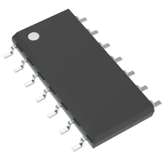

LM324-SR
LM324-SR
    3PEAK(思瑞浦)
    SOP14_150MIL
    通用放大器 SOP14_150MIL 4Channel 1.2MHz 0.55V/μs
LM324-SR 数据手册
3PEAK LM321/LM358/LM324 1.2MHz, Low-Power 36V Op Amps Features Description  Internal Frequency Compensation for Unity Gain  High DC Voltage Gain: 110dB(Typ)  Wide Bandwidth at Unity Gain: 1.2MHz(Typ)  Wide Power Supply Range: 3V to 36V  Dual Supplies: ±1.5V to ±18V  EMIRR IN+: 71dB(Under 1GHz)  Low Supply Current: 100μA(Typ)  Offset Voltage Temperature Drift: 1uV/°C  Input Bias Current: 60pA Typical  Input Common-Mode Voltage Range Includes Ground  Rail-to-Rail Output  No Phase Reversal for Overdriven Inputs  –40°C to 125°C Operation Range  ESD Rating: Robust 2KV – HBM, 2KV – CDM  High Performance Drop-In Compatible With 321, 358, 324 Series Product LM321/358/324 types consist of single/dual/quad channel independent, high gain, internally frequency compensated operational amplifiers which are designed specifically to operate from a single power supply over a wide range of voltages. They may also be operated from split power supplies. The supply current is basically independent of the supply voltage over the recommended voltage range. These devices are particularly useful in interface circuits with digital systems and can be operated from the single common 5VDC power supply. They are also intended for transducer amplifiers, DC gain blocks and many other conventional op amp circuits which can benefit from the single power supply capability. In the linear mode, the input common-mode voltage range includes ground and the output voltage can also swing to both ground and power rail, even though operated from a single power supply. The LM321 is single channel version available in 5-pin SOT23 packages. The LM358 is dual channel version available in 8-pin SOP and MSOP packages. The LM324 is quad channel version available in 14-pin SOP and TSSOP packages. Applications  Walkie-Talkie  Battery Management Solution  Transducer Amplifiers  Summing Amplifiers  Multivibrators  Oscillators  DC Gain Blocks 3PEAK and the 3PEAK logo are registered trademarks of 3PEAK INCORPORATED. All other trademarks are the property of their respective owners. Pin Configuration (Top View) LM321 5-Pin SOT23 (-T Suffix) +In 1 -VS 2 LM358 8-Pin SOIC/MSOP (-S and -V Suffixes) 5 +VS Out A 1 -In A 2 A LM324 14-Pin SOIC/TSSOP (-S and -T Suffixes) 8 +VS 7 Out B Out A 1 -In A 2 A -In 3 4 Out +In A 3 -VS 4 B 6 5 Out D 13 -In D D -In B +In A 3 12 +In D +In B +VS 4 11 -VS +In B 5 10 +In C B www.3peakic.com.cn 14 C -In B 6 9 -In C Out B 7 8 Out C Rev. B 1 LM321 / LM358 / LM324 1.2MHz, Low-Power 36V Op Amps Order Information Model Name Order Number LM321 LM358 LM324 Package Marking Information Transport Media, Quantity LM321-TR 5-Pin SOT23 Tape and Reel, 3,000 H21 LM358-SR 8-Pin SOP Tape and Reel, 4,000 LM358 LM358-VR 8-Pin MSOP Tape and Reel, 3,000 LM358 LM324-SR 14-Pin SOP Tape and Reel, 2,500 LM324 LM324-TR 14-Pin TSSOP Tape and Reel, 3,000 LM324 Absolute Maximum Ratings Note 1 + Supply Voltage: V – V – Note 2 ................................. 42V – Current at Supply Pins……………............... ±60mA + Input Voltage................................ V – 0.3 to V + 0.3 Operating Temperature Range........–40°C to 125°C Input Current: +IN, –IN Maximum Junction Temperature................... 150°C Note 3............................ ±20mA Differential Input Voltage..................................... ±42V Storage Temperature Range.......... –65°C to 150°C Output Short-Circuit Duration Note 4…............... Infinite Lead Temperature (Soldering, 10 sec) ......... 260°C Note 1: Stresses beyond those listed under Absolute Maximum Ratings may cause permanent damage to the device. Exposure to any Absolute Maximum Rating condition for extended periods may affect device reliability and lifetime. Note 2: The op amp supplies must be established simultaneously, with, or before, the application of any input signals. Note 3: The inputs are protected by ESD protection diodes to each power supply. If the input extends more than 500mV beyond the power supply, the input current should be limited to less than 10mA. Note 4: A heat sink may be required to keep the junction temperature below the absolute maximum. This depends on the power supply voltage and how many amplifiers are shorted. Thermal resistance varies with the amount of PC board metal connected to the package. The specified values are for short traces connected to the leads. ESD, Electrostatic Discharge Protection Symbol Parameter Condition Minimum Level Unit HBM Human Body Model ESD MIL-STD-883H Method 3015.8 2 kV CDM Charged Device Model ESD JEDEC-EIA/JESD22-C101E 2 kV Thermal Resistance 2 Package Type θJA θJC Unit 5-Pin SOT23 250 81 ° C/W 8-Pin SOP 158 43 ° C/W 8-Pin MSOP 210 45 ° C/W 14-Pin SOP 120 36 ° C/W 14-Pin TSSOP 180 35 ° C/W Rev. B www.3peakic.com.cn LM321/LM358/ LM324 1.2MHz, Low-Power 36V Op Amps Electrical Characteristics The specifications are at TA = 27° C. VS = 5V, VCM = VOUT =2.5V, RL = 2kΩ, CL =100pF.Unless otherwise noted. SYMBOL VOS VOS TC PARAMETER Input Offset Voltage Input Offset Voltage Drift CONDITIONS MIN TYP MAX UNITS VS = 5 V, VCM = 2.5V and VCM = 0V -3 ±1 3 mV VS = 30 V, VCM = 15V and VCM = 0V -3 ±1 3 mV -40° C to 125° C 1 μV/° C TA = 27 ° C 60 pA TA = 85 ° C 200 pA 0.001 pA IB Input Bias Current IOS Input Offset Current Vn Input Voltage Noise f = 0.1Hz to 10Hz 10 μVPP en in Input Voltage Noise Density Input Current Noise 48 nV/√Hz fA/√Hz CIN Input Capacitance f = 1kHz f = 1kHz Differential Common Mode DC, VCM=0V to 28V 80 VS = 5 V to 30V V– VS = 5 V to 30V 90 120 dB VS = 15 V, VO = 1 V to 11 V, RL = 2 kΩ 98 110 dB RLOAD = 10kΩ, VS = ± 15 V 14.70 14.75 V RLOAD = 2kΩ, VS = ± 15 V 13.70 13.90 V CMRR PSRR Common Mode Rejection Ratio Common-mode Input Voltage Range Power Supply Rejection Ratio AVOL Open-Loop Large Signal Gain VOH Output Swing from Supply Rail VCM VOL Output Swing from Supply Rail 2 2.5 5 120 pF dB V+-2 V RLOAD = 10kΩ , VS = ± 15 V -14.85 -14.70 V RLOAD = 2kΩ, VS = ± 15 V -14.25 -14.10 V RLOAD ≥ 10 kΩ, VS = 15 V 5 mV 0.002 Ω 120 Ω 35 mA ROUT Closed-Loop Output Impedance G = 1, f =1kHz, IOUT = 0 RO Open-Loop Output Impedance f = 1kHz, IOUT = 0 ISC Output Short-Circuit Current Sink or source current, VS = 30V VS Supply Voltage IQ Quiescent Current per Amplifier 20 3 36 V VS = 5V, No load 100 150 μA VS = 30V, No load 110 200 μA PM Phase Margin RLOAD = 1kΩ, CLOAD = 100pF 62 ° GM Gain Margin RLOAD = 1kΩ, CLOAD = 60pF 18 dB GBWP Gain-Bandwidth Product 1.2 MHz SR Slew Rate at unity gain f = 1kHz AV = 1, VOUT = -10V to 10V, CLOAD =60pF, RLOAD = 10kΩ, VS = ± 15V 0.55 V/μs 17.5 2.8 3.1 kHz 0.001 % 80 dB FPBW tS THD+N Xtalk Full Power Bandwidth Note 1 Settling Time, 0.1% Settling Time, 0.01% Total Harmonic Distortion and Noise Channel Separation AV = 1.5V to 3.5V Step f = 1kHz, AV =1, RL = 2kΩ, VOUT = 1Vp-p f = 1 kHz to 20 kHz μs Note 1: Full power bandwidth is calculated from the slew rate FPBW = SR/π • VP-P www.3peakic.com.cn Rev. B 3 LM321 / LM358 / LM324 1.2MHz, Low-Power 36V Op Amps Typical Performance Characteristics VS = ±15V, VCM = 0V, RL = Open, unless otherwise specified. Offset Voltage Production Distribution Unity Gain Bandwidth vs. Temperature 2 1200 1.8 Number = 15200pcs 1.6 1.4 800 GBW(MHz) Population 1000 600 400 1.2 1 0.8 0.6 0.4 200 0.2 0 3 2.6 2.2 1.8 1 1.4 0.6 0.2 -0.2 -1 -0.6 -1.4 -1.8 -2.2 -3 -2.6 0 -40 -25 -10 5 20 35 50 Open-Loop Gain and Phase 200 1000 VS= +5V RL= 1MΩ CL = 30pF 50 0 Phase (°) 100 50 0 -50 Noise(nV/√Hz) 150 100 Gain(dB) 95 110 125 Input Voltage Noise Spectral Density 150 100 10 -50 -100 1 -100 0.01 1 100 10k 1 1M 10 100 1k 10k 100k 1M Frequency(Hz) Frequency (Hz) Input Bias Current vs. Temperature Input Bias Current vs. Input Common Mode Voltage 1000 Input Bias Current(A) 10000 Input Bias Current(pA) 80 Temperature(℃) Offset Voltage(mV) 1000 100 10 VS= +36V RL= 1MΩ CL = 30pF 100 10 1 -40 -20 0 20 40 60 Temperature(℃) 4 65 Rev. B 80 100 120 8 12 16 20 24 28 Common Mode Voltage(V) www.3peakic.com.cn LM321/LM358/ LM324 1.2MHz, Low-Power 36V Op Amps Typical Performance Characteristics VS = ±15V, VCM = 0V, RL = Open, unless otherwise specified. (Continued) Common Mode Rejection Ratio CMRR vs. Frequency 140 140 120 120 100 CMRR(dB) CMRR(dB) 100 80 60 40 80 60 40 20 20 0 0 -20 0 5 10 15 20 25 1 100 Common-mode voltage(V) 10k 1M Frequency(Hz) Quiescent Current vs. Temperature Short Circuit Current vs. Temperature 35 30 ISINK 120 25 Ishort(mA) Supply Current(uA) 140 100 80 20 ISOURCE 15 10 60 5 40 -40 -25 -10 5 20 35 50 65 80 0 95 110 125 -40 -25 -10 5 Temperature(℃) 20 35 50 65 80 95 110 125 Temperature(℃) Power-Supply Rejection Ratio Quiescent Current vs. Supply Voltage 160 120 PSRR+ 140 120 Supply Current(uA) PSRRPSRR(dB) 100 80 60 40 20 100 80 60 40 20 0 -20 0 0.01 1 100 10k Frequency(Hz) www.3peakic.com.cn 1M 3 6 9 12 15 18 21 24 27 30 Supply Voltage(V) Rev. B 5 LM321 / LM358 / LM324 1.2MHz, Low-Power 36V Op Amps Typical Performance Characteristics VS = ±15V, VCM = 0V, RL = Open, unless otherwise specified. (Continued) CMRR vs. Temperature 160 160 140 140 120 120 CMRR(dB) PSRR(dB) Power-Supply Rejection Ratio vs. Temperature 100 80 60 100 60 40 40 20 20 0 0 -40 -25 -10 5 20 35 50 65 80 -40 -25 -10 95 110 125 5 20 35 50 65 80 95 110 125 Temperature(℃) Temperature(℃) EMIRR IN+ vs. Frequency Small-Scale Step Response 100mV/div 140 120 100 Gain= +1 ±V= ±15V CL=30pF, RL=1M 80 60 100mV/div EMIRR IN+(dB) 80 40 20 0 1 10 100 1000 Frequency(MHz) Time (5μs/div) Negative Over-Voltage Recovery 1V/div Time (50μs/div) 6 5V/div Gain= +10 + V= + 30V 1V/div 5V/div Gain= +10 + V= + 30V Positive Over-Voltage Recovery Rev. B Time (50μs/div) www.3peakic.com.cn LM321/LM358/ LM324 1.2MHz, Low-Power 36V Op Amps Typical Performance Characteristics VS = ±15V, VCM = 0V, RL = Open, unless otherwise specified. (Continued) 0.1 Hz TO 10 Hz Input Voltage Noise Offset Voltage vs Common-Mode Voltage 1.4 5μV/div Offset voltage(mV) 1.2 1 0.8 0.6 0.4 0.2 0 0 Time (1s/div) 5 10 15 20 25 Common-mode voltage(V) Large-Scale Step Response Positive Output Swing vs. Load Current 6 Gain= +1 ±V= ±15V CL=30pF, RL=1M T=-40℃ T=25℃ T=130℃ 2V/div 5 Vdrop(V) 4 3 2V/div 2 1 0 0 Time (20μs/div) 10 20 30 I source(mA) Negative Output Swing vs. Load Current 6 T=-40℃ T=25℃ T=130℃ 5 Vdrop(V) 4 3 2 1 0 0 10 20 30 40 I sink (mA) www.3peakic.com.cn Rev. B 7 LM321 / LM358 / LM324 1.2MHz, Low-Power 36V Op Amps Pin Functions -IN: Inverting Input of the Amplifier. possible should be used between power supply pins or +IN: Non-Inverting Input of Amplifier. between supply pins and ground. OUT: Amplifier Output. The voltage range extends to V- or -Vs: Negative Power Supply. It is normally tied to within mV of each supply rail. ground. It can also be tied to a voltage other than V+ or +Vs: Positive Power Supply. Typically the voltage ground as long as the voltage between V+ and V– is from is from 3V to 36V. Split supplies are possible as long 3V to 36V. If it is not connected to ground, bypass it as the voltage between V+ and V– is between 3V and with a capacitor of 0.1μF as close to the part as possible. 36V. A bypass capacitor of 0.1μF as close to the part as Operation The LM321/358/324 output signal range extends beyond the negative and positive power supplies. The intput can even extend all the way to the negative supply. The Class-AB control buffer and output bias stage uses a proprietary compensation technique to take full advantage of the process technology to drive very high capacitive loads. This is evident from the transient over shoot measurement plots in the Typical Performance Characteristics. Applications Information High Supply Voltage and Low Power Consumption The LM321/358/324 of operational amplifiers can operate with power supply voltages from 3V to 36V. Each amplifier draws only 100μA quiescent current. The low supply voltage capability and low supply current are ideal for portable applications demanding HIGH CAPACITIVE LOAD DRIVING CAPABILITY and WIDE BANDWIDTH. The LM321/358/324 is optimized for wide bandwidth low power applications. They have an industry leading high GBWP to power ratio and are unity gain stable for 10nf CAPACITIVE load. When the load capacitance increases, the increased capacitance at the output pushed the non-dominant pole to lower frequency in the open loop frequency response, lowering the phase and gain margin. Higher gain configurations tend to have better capacitive drive capability than lower gain configurations due to lower closed loop bandwidth and hence higher phase margin. Low Input Referred Noise The LM321/358/324 provides a low input referred noise density of 48nV/√Hz at 1kHz. The voltage noise will grow slowly with the frequency in wideband range, and the input voltage noise is typically 10μVP-P at the frequency of 0.1Hz to 10Hz. Low Input Offset Voltage The LM321/358/324 has a low offset voltage tolerance of 3mV maximum which is essential for precision applications. The offset voltage is trimmed with a proprietary trim algorithm to ensure low offset voltage for precision signal processing requirement. Low Input Bias Current The LM321/358/324 is a CMOS OPA family and features very low input bias current in pA range. The low input bias current allows the amplifiers to be used in applications with high resistance sources. Care must be taken to minimize PCB Surface Leakage. See below section on “PCB Surface Leakage” for more details. PCB Surface Leakage 8 Rev. B www.3peakic.com.cn LM321/LM358/ LM324 1.2MHz, Low-Power 36V Op Amps In applications where low input bias current is critical, Printed Circuit Board (PCB) surface leakage effects need to be considered. Surface leakage is caused by humidity, dust or other contamination on the board. Under low humidity 12 conditions, a typical resistance between nearby traces is 10 Ω. A 5V difference would cause 5pA of current to flow, which is greater than the LM321/358/324 OPA‟s input bias current at +27°C (±1pA, typical). It is recommended to use multi-layer PCB layout and route the OPA‟s -IN and +IN signal under the PCB surface. The effective way to reduce surface leakage is to use a guard ring around sensitive pins (or traces). The guard ring is biased at the same voltage as the sensitive pin. An example of this type of layout is shown in Figure 1 for Inverting Gain application. 1. For Non-Inverting Gain and Unity-Gain Buffer: a) Connect the non-inverting pin (VIN+) to the input with a wire that does not touch the PCB surface. b) Connect the guard ring to the inverting input pin (VIN–). This biases the guard ring to the Common Mode input voltage. 2. For Inverting Gain and Trans-impedance Gain Amplifiers (convert current to voltage, such as photo detectors): a) Connect the guard ring to the non-inverting input pin (VIN+). This biases the guard ring to the same reference voltage as the op-amp (e.g., VS/2 or ground). b) Connect the inverting pin (VIN–) to the input with a wire that does not touch the PCB surface. Guard Ring VIN+ VIN- +VS Figure 1 Ground Sensing and Rail to Rail Output The LM321/358/324 has excellent output drive capability, delivering over 35mA of output drive current. The output stage is a rail-to-rail topology that is capable of swinging to within 5mV of either rail. Since the inputs can go 100mV beyond either rail, the op-amp can easily perform „True Ground Sensing‟. The maximum output current is a function of total supply voltage. As the supply voltage to the amplifier increases, the output current capability also increases. Attention must be paid to keep the junction temperature of the IC below 150°C when the output is in continuous short-circuit. The output of the amplifier has reverse-biased ESD diodes connected to each supply. The output should not be forced more than 0.5V beyond either supply, otherwise current will flow through these diodes. ESD The LM321/358/324 has reverse-biased ESD protection diodes on all inputs and output. Input and out pins cannot be biased more than 200mV beyond either supply rail. Feedback Components and Suppression of Ringing Care should be taken to ensure that the pole formed by the feedback resistors and the parasitic capacitance at the inverting input does not degrade stability. For example, in a gain of +2 configuration with gain and feedback resistors of 10k, a poorly designed circuit board layout with parasitic capacitance of 5pF (part +PC board) at the amplifier‟s inverting input will cause the amplifier to ring due to a pole formed at 1.2MHz. An additional capacitor of 5pF across the feedback resistor as shown in Figure 2 will eliminate any ringing. Careful layout is extremely important because low power signal conditioning applications demand high-impedance circuits. The layout should also minimize stray capacitance at the OPA‟s inputs. However some stray capacitance may be unavoidable and it may be necessary to add a 2pF to 10pF capacitor across the feedback resistor. Select the smallest capacitor value that ensures stability. www.3peakic.com.cn Rev. B 9 LM321 / LM358 / LM324 1.2MHz, Low-Power 36V Op Amps 5pF 10kΩ VOUT 10kΩ CPAR VIN Figure 2 Driving Large Capacitive Load The LM321/358/324 of OPA is designed to drive large capacitive loads. Refer to Typical Performance Characteristics for “Phase Margin vs. Load Capacitance”. As always, larger load capacitance decreases overall phase margin in a feedback system where internal frequency compensation is utilized. As the load capacitance increases, the feedback loop‟s phase margin decreases, and the closed-loop bandwidth is reduced. This produces gain peaking in the frequency response, with overshoot and ringing in output step response. The unity-gain buffer (G = +1V/V) is the most sensitive to large capacitive loads. When driving large capacitive loads with the LM321/358/324 (e.g., > 200 pF when G = +1V/V), a small series resistor at the output (RISO in Figure 3) improves the feedback loop‟s phase margin and stability by making the output load resistive at higher frequencies. RISO VOUT VIN CLOAD Figure 3 Power Supply Layout and Bypass The LM321/358/324 OPA‟s power supply pin should have a local bypass capacitor (i.e., 0.01μF to 0.1μF) within 2mm for good high frequency performance. It can also use a bulk capacitor (i.e., 1μF or larger) within 100mm to provide large, slow currents. This bulk capacitor can be shared with other analog parts. Ground layout improves performance by decreasing the amount of stray capacitance and noise at the OPA‟s inputs and outputs. To decrease stray capacitance, minimize PC board lengths and resistor leads, and place external components as close to the op amps‟ pins as possible. Proper Board Layout To ensure optimum performance at the PCB level, care must be taken in the design of the board layout. To avoid leakage currents, the surface of the board should be kept clean and free of moisture. Coating the surface creates a barrier to moisture accumulation and helps reduce parasitic resistance on the board. Keeping supply traces short and properly bypassing the power supplies minimizes power supply disturbances due to output current variation, such as when driving an ac signal into a heavy load. Bypass capacitors should be connected as closely as possible to the device supply pins. Stray capacitances are a concern at the outputs and the inputs of the amplifier. It is recommended that signal traces be kept at least 5mm from supply lines to minimize coupling. A variation in temperature across the PCB can cause a mismatch in the Seebeck voltages at solder joints and other points where dissimilar metals are in contact, resulting in thermal voltage errors. To minimize these thermocouple effects, orient resistors so heat sources warm both ends equally. Input signal paths should contain matching numbers 10 Rev. B www.3peakic.com.cn LM321/LM358/ LM324 1.2MHz, Low-Power 36V Op Amps and types of components, where possible to match the number and type of thermocouple junctions. For example, dummy components such as zero value resistors can be used to match real resistors in the opposite input path. Matching components should be located in close proximity and should be oriented in the same manner. Ensure leads are of equal length so that thermal conduction is in equilibrium. Keep heat sources on the PCB as far away from amplifier input circuitry as is practical. The use of a ground plane is highly recommended. A ground plane reduces EMI noise and also helps to maintain a constant temperature across the circuit board. Instrumentation Amplifier The LM321/358/324 OPA is well suited for conditioning sensor signals in battery-powered applications. Figure 4 shows a two op-amp instrumentation amplifier, using the LM321/358/324 OPA. The circuit works well for applications requiring rejection of Common Mode noise at higher gains. The reference voltage (VREF) is supplied by a low-impedance source. In single voltage supply applications, VREF is typically VS/2. RG R1 VREF R2 R2 R1 VOUT V2 V1 VOUT =(V1  V2 )(1  R1 2 R1  )  VREF R2 RG Figure 4 Two-Pole Micro-power Sallen-Key Low-Pass Filter Figure 5 shows a micro-power two-pole Sallen-Key Low-Pass Filter with 400Hz cut-off frequency. For best results, the filter‟s cut-off frequency should be 8 to 10 times lower than the OPA‟s crossover frequency. Additional OPA‟s phase margin shift can be avoided if the OPA‟s bandwidth-to-signal ratio is greater than 8. The design equations for the 2-pole Sallen-Key low-pass filter are given below with component values selected to set a 400Hz low-pass filter cutoff frequency: C1 400pF VIN VOUT R1 1MΩ C2 400pF R2 1MΩ R1 = R 2 = R = 1M C1 = C2 = C = 400pF Q = Filter Peaking Factor = 1 R3 2MΩ f -3dB = 1/(2  RC ) = 400Hz R4 2MΩ R 3 = R 4 /(2-1/Q) ; with Q = 1, R 3 =R 4 Figure 5 www.3peakic.com.cn Rev. B 11 LM321 / LM358 / LM324 1.2MHz, Low-Power 36V Op Amps Package Outline Dimensions SC70-5 /SOT-353 Dimensions Dimensions In Millimeters In Inches Min Max Min Max A 0.900 1.100 0.035 0.043 A1 0.000 0.100 0.000 0.004 A2 0.900 1.000 0.035 0.039 b 0.150 0.350 0.006 0.014 C 0.080 0.150 0.003 0.006 D 2.000 2.200 0.079 0.087 E 1.150 1.350 0.045 0.053 E1 2.150 2.450 0.085 0.096 e 0.650TYP 0.026TYP e1 1.200 0.047 L 0.525REF 0.021REF L1 0.260 0.460 0.010 0.018 θ 0° 8° 0° 8° Symbol 1.400 0.055 SOT23-5 Dimensions Dimensions In Millimeters In Inches Min Max Min Max A 1.050 1.250 0.041 0.049 A1 0.000 0.100 0.000 0.004 A2 1.050 1.150 0.041 0.045 b 0.300 0.400 0.012 0.016 C 0.100 0.200 0.004 0.008 D 2.820 3.020 0.111 0.119 E 1.500 1.700 0.059 0.067 E1 2.650 2.950 0.104 0.116 e 0.950TYP 0.037TYP e1 1.800 0.071 L 0.700REF 0.028REF L1 0.300 0.460 0.012 0.024 θ 0° 8° 0° 8° Symbol 12 Rev. B 2.000 0.079 www.3peakic.com.cn LM321/LM358/ LM324 1.2MHz, Low-Power 36V Op Amps Package Outline Dimensions SOP-8 A2 C θ L1 A1 e E D Symbol E1 b www.3peakic.com.cn Dimensions Dimensions In In Millimeters Inches Min Max Min Max A1 0.100 0.250 0.004 0.010 A2 1.350 1.550 0.053 0.061 b 0.330 0.510 0.013 0.020 C 0.190 0.250 0.007 0.010 D 4.780 5.000 0.188 0.197 E 3.800 4.000 0.150 0.157 E1 5.800 6.300 0.228 0.248 e 1.270 TYP 0.050 TYP L1 0.400 1.270 0.016 0.050 θ 0° 8° 0° 8° Rev. B 13 LM321 / LM358 / LM324 1.2MHz, Low-Power 36V Op Amps Package Outline Dimensions MSOP-8 Dimensions Dimensions In In Millimeters Inches Min Max Min Max A 0.800 1.200 0.031 0.047 A1 0.000 0.200 0.000 0.008 A2 0.760 0.970 0.030 0.038 b 0.30 TYP 0.012 TYP C 0.15 TYP 0.006 TYP D 2.900 e 0.65 TYP E 2.900 3.100 0.114 0.122 E1 4.700 5.100 0.185 0.201 L1 0.410 0.650 0.016 0.026 θ 0° 6° 0° 6° Symbol E E1 A A2 e b D 3.100 0.114 0.122 0.026 A1 R1 R θ L1 14 Rev. B L L2 www.3peakic.com.cn LM321/LM358/ LM324 1.2MHz, Low-Power 36V Op Amps Package Outline Dimensions TSSOP-14 Dimensions E1 E A A2 e c D In Millimeters Symbol MIN TYP MAX A - - 1.20 A1 0.05 - 0.15 A2 0.90 1.00 1.05 b 0.20 - 0.28 c 0.10 - 0.19 D 4.86 4.96 5.06 E 6.20 6.40 6.60 E1 4.30 4.40 4.50 e L A1 R1 R 0.65 BSC 0.45 0.60 L1 1.00 REF L2 0.25 BSC 0.75 R 0.09 - - θ 0° - 8° θ L1 www.3peakic.com.cn L L2 Rev. B 15 LM321 / LM358 / LM324 1.2MHz, Low-Power 36V Op Amps Package Outline Dimensions SOP-14 D E1 Dimensions E In Millimeters Symbol e b A A2 A1 MIN TYP MAX A 1.35 1.60 1.75 A1 0.10 0.15 0.25 A2 1.25 1.45 1.65 b 0.36 D 8.53 8.63 8.73 E 5.80 6.00 6.20 E1 3.80 3.90 4.00 e L 16 Rev. B 1.27 BSC 0.45 0.60 L1 1.04 REF L2 0.25 BSC θ L L1 0.49 0° 0.80 8° θ L2 www.3peakic.com.cn
