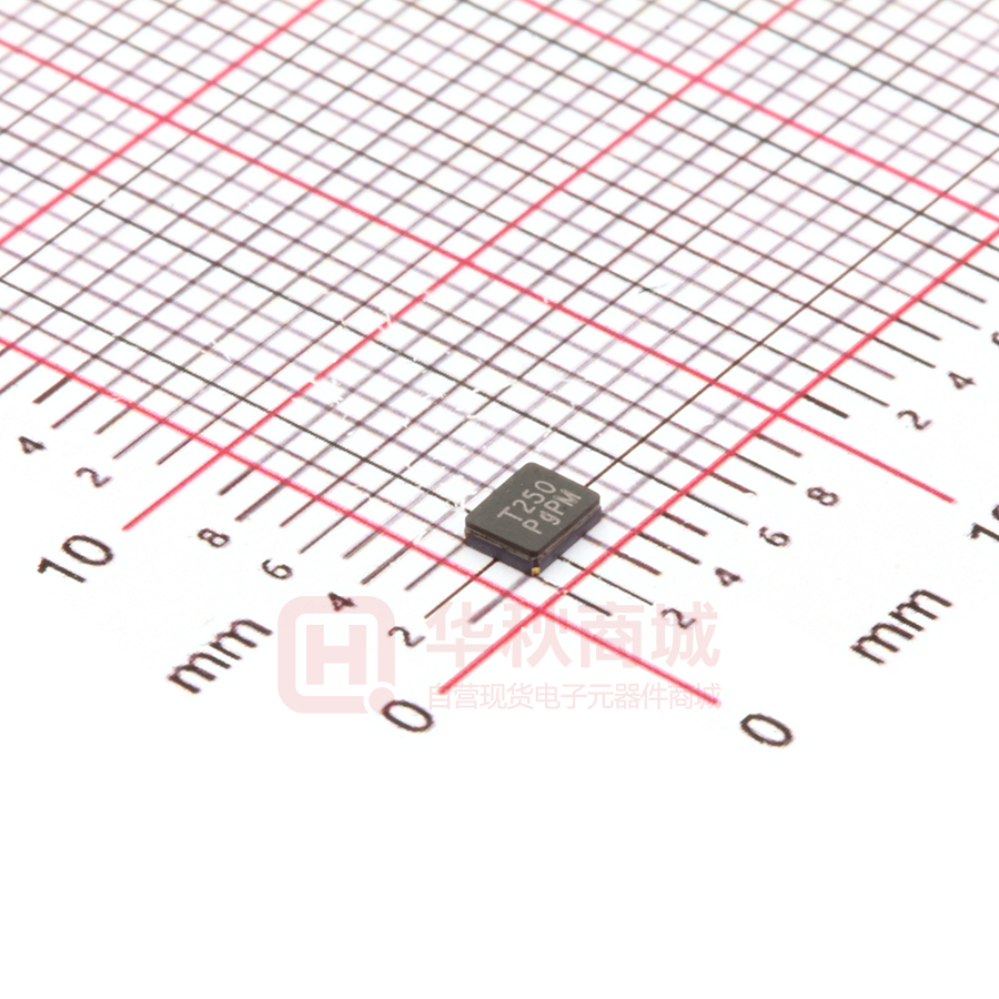

■ MARKING
T□□□
TXC Logo
Frequency Code
Ex.: 25.000000 MHz = 250
Lot Code
Date Code
Line Code
