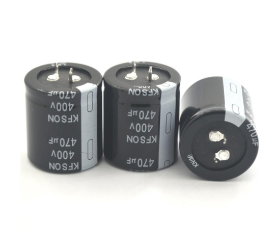

KFSON ALUMINUM ELECTROLYTIC CAPACITORS KN ◆ ◆ series Load life 2000 Hrs at 105℃ RoHS Compliant Specifications 規格表 Ltem 項目 Operating Temperature Range 工作溫度範圍 Rated Voltage Range 額定電壓範圍 Capacitance Range 容量範圍 Performance Characteristics -40 to +105℃ -25 to +105℃ 16 to 100 VDC 160 to 500 VDC 68 to 56000 μF Capacitance Tolerance 靜電容量偏差 Leakage Current 漏電流 ±20%(120Hz,+20℃) After 5 minutes at 20°C application of rated voltage, leakage current is not more than 0.01CV or 1.5mA, whichever is smaller C: Nominal Capacitance(μF) V: Rated Voltage(V) rated voltage(V) 16 Dissipation Factor tanδ(Max) 50 損耗角正切值 tanδ(%) Low Temperature Characteristics 低溫特性 Load Life 使用壽命 特性參數 25 40 35 40 50 30 63 100 160-400 450-500 20 20 15 20 impedance ratio max 電容器最大阻抗比值 rated voltage(V) 16 25 35 50 63 100 160-400 450-500 Z(-25℃)/Z(+20℃) 4 4 4 4 4 4 4 8 Z(-40℃)/Z(+20℃) 15 15 15 15 15 15 105℃施加額定工作電壓2000小時,經恢復後,產品性能應滿足以下要求 The following specifications shall be satisfied when the capacitors are restored to 20℃ after subjected to DC voltage with the rated ripple current is applied for 2000H at 105℃ Capacitance change ≦±20% of the initial value D.F.(tanδ) ≦200% of the specified value Leakage current ≦The specified value 105℃放置1000小時,經恢復後20℃后,產品性能應滿足以下要求 The following specifications shall be satisfied when the capacitors are restored Shelf Life 存儲特性 to 20℃ after exposing them for 1000 hours at 105℃ without voltage applied. Capacitance change D.F.(tanδ) Leakage current Diagram of Dimensions 外形尺寸圖 (mm) ≦±20% of the initial value ≦150% of the specified value ≦The specified value KFSON ALUMINUM ELECTROLYTIC CAPACITORS KN series Frequency Coefficient Frequency Voltage(v) ≤100V 160-250V ≥350 50/60 120 300 1K 10K ≥50K Hz Hz Hz Hz Hz Hz 0.95 0.87 0.80 1.00 1.00 1.00 1.07 1.17 1.16 1.13 1.32 1.30 1.19 1.45 1.41 1.20 1.50 1.43 Rated Voltage Rated Capacity V μF Standard Ratings Rated Voltage V Rated Capacity Size Rated ripple φD*L current μF mm A 3300 22*26 22*26 25*26 22*31 25*26 30*26 22*31 22*31 25*26 30*26 22*36 30*26 22*41 25*36 30*26 35*32 22*51 25*46 30*36 35*32 25*51 30*36 35*32 25*51 30*41 35*32 30*46 35*37 30*51 35*42 35*45 35*47 1.17 1.53 1.55 2.02 2.02 2.02 2.20 2.79 2.79 2.81 3.06 3.06 3.24 3.24 3.24 3.24 3.54 3.51 3.51 3.54 4.25 4.08 4.08 4.30 4.30 4.30 4.83 4.83 5.78 5.78 6.32 6.48 4700 6800 8200 10000 12000 15000 16V 18000 22000 27000 33000 39000 47000 56000 3300 4700 6800 8200 10000 25V 12000 15000 18000 22000 27000 33000 39000 47000 Size Rated ripple φD*L current mm A 22*26 25*26 22*26 25*26 22*31 25*26 30*26 22*36 25*31 30*26 22*41 25*36 30*31 35*27 22*46 25*41 30*31 35*27 25*46 30*36 35*32 25*51 30*41 35*32 30*46 35*37 35*42 35*52 35*52 35*52 1.48 1.48 1.88 1.90 2.60 2.60 2.60 3.14 3.14 3.14 3.50 3.50 3.50 3.50 4.02 4.02 4.02 4.02 4.58 4.58 4.58 4.82 4.82 4.79 5.12 5.12 5.30 6.09 6.20 6.30 Rated ripple current(A,rms)at 105℃,120Hz KFSON ALUMINUM ELECTROLYTIC CAPACITORS KN series Standard Ratings Rated Voltage V Rated Capacity Size Rated ripple φD*L current μF mm A 1500 22*26 22*26 25*26 22*26 25*26 22*26 25*26 22*36 25*26 30*26 22*41 25*36 30*26 35*27 25*46 30*36 35*27 25*51 30*41 35*32 30*46 35*37 35*52 35*52 35*45 35*52 1.26 1.35 1.45 1.55 1.65 1.80 1.90 2.42 2.30 2.54 3.24 3.24 3.21 3.24 3.96 3.96 3.75 4.21 4.21 4.21 4.69 4.69 5.50 5.80 5.60 5.90 2200 2700 3300 4700 6800 35V 10000 12000 15000 22000 27000 33000 Rated ripple current(A,rms)at 105℃,120Hz Rated Voltage Rated Capacity V μF 1500 2200 2700 3300 4700 50V 6800 8200 10000 15000 18000 22000 Size Rated ripple φD*L current mm A 22*26 25*26 22*31 25*26 22*31 25*26 30*26 22*36 25*31 30*26 22*46 25*36 30*31 35*27 25*46 30*41 35*32 30*46 35*37 30*51 30*45 35*42 30*40 25*50 35*30 35*52 35*52 35*60 1.10 1.02 1.65 1.65 1.85 1.85 1.95 2.24 2.24 2.24 2.95 2.80 2.95 2.95 3.23 3.20 3.26 3.58 3.58 4.11 4.01 4.11 4.00 3.90 3.86 5.05 5.30 5.50 KFSON ALUMINUM ELECTROLYTIC CAPACITORS KN series Standard Ratings Rated Voltage Rated Capacity V μF mm A 820 22*26 22*26 25*26 22*26 25*26 30*26 22*31 25*26 22*36 25*31 30*26 22*41 25*36 30*26 22*46 25*36 30*31 35*27 25*41 30*36 35*27 25*51 30*41 35*32 30*46 35*37 30*51 35*42 35*47 35*52 30*60 30*50 35*52 35*60 0.75 0.85 0.85 1.10 1.12 1.14 1.40 1.40 1.65 1.65 1.65 2.07 2.07 2.07 2.46 2.40 2.48 2.48 2.92 3.05 3.05 3.43 3.43 3.43 3.86 3.86 4.64 4.64 5.05 5.75 5.65 5.35 5.40 5.56 1000 1500 1800 2200 2700 3300 63V 3900 4700 5600 6800 8200 10000 15000 Size Rated ripple φD*L current Rated ripple current(A,rms)at 105℃,120Hz Rated Voltage Rated Capacity V μF mm A 330 22*26 22*26 25*26 22*26 25*26 22*31 25*26 30*26 22*31 25*26 30*26 22*36 25*31 30*26 22*41 25*36 30*31 22*46 25*41 30*31 35*27 25*41 30*36 35*32 25*51 30*41 35*32 30*46 35*37 30*56 35*47 35*47 35*52 35*40 30*50 35*60 35*52 35*60 0.54 0.79 0.81 0.90 0.95 1.02 1.02 1.14 1.26 1.26 1.32 1.38 1.38 1.38 1.65 1.65 1.65 1.83 1.83 1.83 1.83 2.52 2.52 2.52 3.03 3.03 3.03 4.10 4.10 4.59 4.59 4.98 5.03 4.80 4.65 5.10 5.09 5.20 470 560 680 820 1000 1200 100V 1500 1800 2200 2700 3300 3900 4700 5600 5600 6800 Size Rated ripple φD*L current KFSON ALUMINUM ELECTROLYTIC CAPACITORS KN series Standard Ratings Rated Voltage Rated Capacity V μF mm A 220 22*26 22*31 25*26 30*26 22*36 25*31 30*26 22*31 22*41 25*36 30*31 35*27 22*46 25*36 30*31 35*27 22*36 25*41 30*36 35*32 25*51 30*41 35*32 25*56 30*46 35*37 30*51 35*42 30*51 35*42 35*52 35*42 35*52 35*45 22*26 25*26 22*31 25*26 30*26 22*31 25*26 30*26 0.42 0.98 0.98 1.00 1.21 1.21 1.21 1.15 1.40 1.40 1.40 1.40 1.64 1.58 1.65 1.71 1.49 1.76 1.85 1.85 2.15 2.15 2.15 2.46 2.46 2.46 2.80 2.80 3.13 3.13 3.26 3.18 3.50 3.35 0.54 0.54 0.92 0.92 0.92 1.03 1.03 1.05 330 470 560 680 160V 820 1000 1200 1500 1800 2200 3300 150 200V 220 270 Size Rated ripple φD*L current Rated Voltage Rated Capacity V μF 330 390 470 560 680 200V 820 1000 1200 1500 1800 2200 2700 100 250V 120 150 Rated ripple current(A,rms)at 105℃,120Hz Size Rated ripple φD*L current mm A 22*36 25*31 30*26 22*36 25*31 30*31 22*41 25*36 30*31 35*27 22*30 22*46 25*41 30*31 35*27 22*51 25*46 30*31 35*32 25*51 30*36 35*37 30*40 35*37 25*45 25*40 35*30 25*50 30*30 30*50 35*42 35*47 35*52 35*52 30*50 35*52 35*45 22*31 25*26 22*25 22*31 25*26 22*31 25*26 30*26 1.21 1.21 1.21 1.33 1.34 1.45 1.57 1.59 1.65 1.65 1.55 1.81 1.85 1.85 1.85 2.04 2.07 2.04 2.17 2.30 2.30 2.31 2.62 2.62 2.55 2.51 2.50 2.55 2.45 3.00 3.00 3.28 4.01 4.10 3.85 4.10 3.80 0.44 0.44 0.42 0.50 0.50 0.60 0.60 0.60 KFSON ALUMINUM ELECTROLYTIC CAPACITORS KN series Standard Ratings Rated Voltage Rated Capacity V μF 220 270 330 390 470 250V 560 680 820 1000 Size φD*L Rated ripple current mm A 1.00 1.00 1.00 0.95 1.16 1.16 1.16 1.28 1.28 1.28 1.28 1.48 1.48 1.48 1.76 1.76 1.76 1.56 1.60 1.56 1.68 1.68 1.93 1.93 1.93 2.15 2.22 2.22 2.48 2.15 2.46 2.43 2.48 2.48 2.74 2.65 2.80 2.70 3.00 3.00 3.50 3.50 5.00 5.10 5.10 22*36 25*31 30*26 22*30 22*41 25*36 30*31 22*46 25*36 30*31 35*27 22*46 30*31 35*27 25*41 30*36 35*32 25*30 25*35 22*36 30*30 22*40 25*51 30*41 35*32 25*40 30*46 35*37 30*51 22*45 25*45 30*35 30*51 35*42 30*50 30*40 35*47 30*45 1200 1500 2200 35*50 35*55 35*50 35*55 35*55 35*60 35*70 Rated Voltage Rated Capacity V μF 100 120 150 180 220 400V 270 330 390 470 Size φD*L Rated ripple current mm A 0.82 0.82 0.70 0.80 0.90 0.90 0.80 0.85 0.98 0.98 0.95 0.95 0.90 0.90 1.05 1.21 1.21 1.21 1.21 1.21 1.10 1.10 1.10 1.40 1.30 1.30 1.57 1.57 1.50 1.50 1.50 1.60 1.68 1.71 1.94 1.80 1.80 1.80 1.85 1.85 1.85 1.98 22*36 25*31 22*25 25*25 22*36 25*31 22*25 25*25 22*41 25*36 30*31 35*27 22*30 25*25 25*36 30*30 30*41 25*40 25*35 35*32 22*40 25*30 30*25 30*40 25*40 30*35 30*40 35*30 22*45 25*40 30*35 35*35 30*40 35*42 35*45 25*50 30*40 35*35 30*50 30*45 35*40 35*50 Rated ripple current(A,rms)at 105℃,120Hz KFSON ALUMINUM ELECTROLYTIC CAPACITORS KN series Standard Ratings Rated Voltage Rated Capacity V μF 560 680 400V 820 1000 1200 82 100 450V 120 150 Size φD*L Rated ripple current mm A 2.23 2.23 2.40 2.40 2.85 2.83 2.80 2.70 2.65 2.90 2.83 2.85 3.20 3.15 3.15 3.10 3.30 3.30 3.30 0.64 0.64 0.64 0.74 0.74 0.74 0.70 0.72 0.72 0.82 0.82 0.82 0.80 0.80 0.80 0.80 0.96 0.96 0.96 0.96 0.90 35*50 30*45 35*45 35*40 35*62 35*50 35*45 30*50 35*40 35*62 35*45 35*50 35*70 35*65 35*60 35*50 35*70 35*65 35*60 22*36 25*31 30*26 22*41 25*31 30*31 22*25 22*35 25*25 22*46 25*36 30*31 22*30 25*25 25*30 30*25 22*51 25*41 30*36 35*27 22*30 Rated ripple current(A,rms)at 105℃,120Hz Rated Voltage Rated Capacity V μF 150 180 220 270 Size φD*L Rated ripple current mm A 0.90 0.90 0.95 0.95 0.95 1.14 1.10 1.14 1.24 1.24 1.20 1.20 1.20 1.20 1.48 1.48 1.60 1.64 1.60 1.60 1.60 1.80 1.86 1.65 1.90 1.90 1.90 1.90 2.40 2.40 2.40 2.40 2.90 2.85 2.80 2.80 3.20 3.20 3.20 3.30 3.30 3.60 22*35 25*30 25*35 30*25 30*30 25*46 30*36 35*32 30*41 35*37 22*40 25*40 25*50 30*30 30*51 35*42 30*40 330 450V 390 470 560 680 820 1000 1200 30*50 25*50 30*35 35*30 35*40 35*52 35*35 35*50 35*45 30*50 30*60 35*50 35*45 35*40 30*50 35*60 35*50 35*45 30*55 35*70 35*65 35*60 35*70 35*65 35*80 ALUMINUM ELECTROLYTIC CAPACITORS KN series Standard Ratings Rated Voltage Rated Capacity V μF 100 120 150 180 500V 220 270 330 390 470 680 820 1000 Size φD*L Rated ripple current mm A 0.90 0.94 0.94 0.94 0.94 0.94 0.94 1.10 1.13 1.13 1.39 1.40 1.50 1.60 1.60 1.60 1.70 1.70 2.10 2.10 2.10 2.50 2.47 2.60 2.65 3.10 3.80 3.80 4.70 22*40 22*45 25*40 30*30 25*40 30*30 35*25 25*40 30*35 35*30 25*50 30*40 30*40 30*45 35*35 35*40 30*50 35*40 30*55 30*60 35*50 35*55 35*50 35*55 35*60 35*70 35*80 40*70 40*80 Rated ripple current(A,rms)at 105℃,120Hz KFSON

物料型号:KN系列
器件简介:KN系列是一系列铝电解电容器,符合RoHS标准,设计用于在105℃下具有2000小时的负载寿命。
引脚分配:标准端子类型包括S(中等22~中等35),套筒通风,负标记PC板引脚分配
参数特性: - 工作温度范围:-40至+105°C - 额定电压范围:16至500VDC - 电容范围:68至56000μF - 电容公差:±20%(在120Hz,+20°C) - 漏电流:在20°C下,额定电压应用5分钟后,漏电流不超过0.01CV或1.5mA(以较小者为准) - 损耗角正切值(tanδ):随额定电压不同而变化,最大值在16V时为50%,在450-500V时为20%
功能详解: - 低温特性:在不同额定电压下,-25°C和-40°C时的阻抗比值(Z(-25°C)/Z(+20°C) 和 Z(-40°C)/Z(+20°C))有所不同。 - 使用寿命:在105°C下施加额定工作电压2000小时后,恢复至20°C,电容变化不超过初始值的20%,DF(tanδ)至少为规定值的200%。 - 存储特性:在105°C下放置1000小时后,恢复至20°C,电容变化不超过初始值的+20%,DF(tanδ)至少为规定值的150%。
应用信息:KN系列适用于一般用途,特别是在需要较长寿命和高温下稳定运行的应用中。
