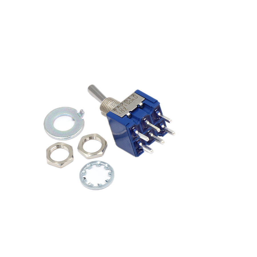

8 Series
Toggle Switches
■Introduction
The 8 Series Toggles is Copal Electronics' high-reliability miniature switch product offering. This product line meets
and exceeds all basic international switch standards.
With 8 toggle options, PC and solder lug terminals, power and logic level current ratings, 1-4 pole and many circuit
offerings these switches can be used in many industries and various applications within these industries.
Four of the 8 Series lines are washable. Specifically designed for PC applications with automated solder and
cleaning methods.
The 8 Series is available with UL Recognition and CSA Certification upon request from the customer.

■Features of 8 Series Toggles
1. Terminal style :
Solder, Straight, Right angle and vertical mount PC terminals.
2. Contacts :
Silver or gold.
3. Epoxy resin case :
UL94V-0 self-extinguishing epoxy.
4. Actuator styles :
Over 30 actuator variations.
5. Insulation between terminal and ground :
4 mm minimum.
6. Prevention of flux entry
The epoxy resin seal on bottom of the switch helps prevent the entry of solder and flux.
7. Insulation barrier :
Insulation barrier design between poles helps prevent short-circuiting between poles ensuring high reliability.
8. UL Recognized product
File No.E43275
9. CSA Certified product
File No.LR38341
10. For the UL Recognized and CSA Certified products please see page 409.

8A
Standard Bat Toggle Switch
RoHS Compliant
■Features
The 8A series has a 10.5mm bat toggle.
