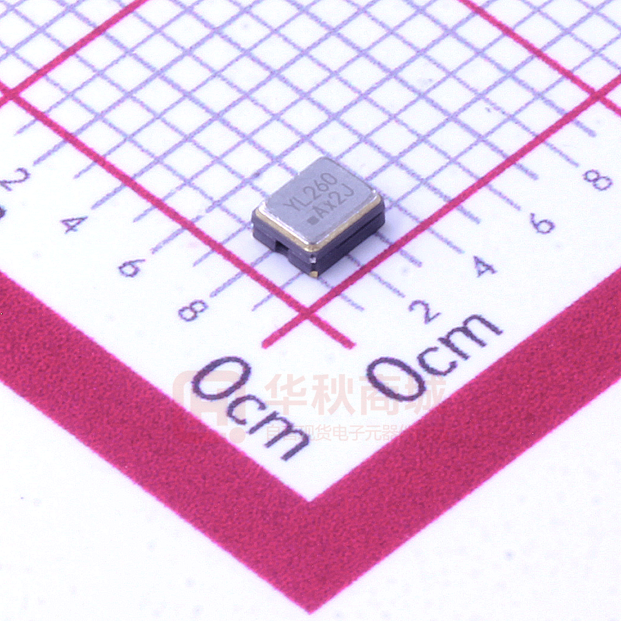

    有源晶振 26MHz ±0.5ppm SMD2520_6P 1.7V~3.3V
2TG2600001 数据手册
SMD TCXO 2.5 x 2.0 PN: 2TG2600001 Ver. S3 2. Electrical Specifications 2.1 Operation conditions # Parameters 1 Nominal frequency 2 Supply voltage (Vcc) 3 Current consumption 4 Operating temperature range 5 Storage temperature range 2.2 Output characteristics # Parameters 1 Output type 2 3 4 5 Standard output Load Output level Duty cycle Harmonics 6 7 Min. Max. 1.68 -40 -40 Typ. 26.000000 2.8 - Remark 3.63 1.5 +85 +85 Unit MHz V mA °C °C Min. Typ. Max. Unit Remark Decoupling capacitor is required in external circuit Clipped sine wave - 10 KΩ//10 pF 0.8 - - 45 50 55 - - -5 Vpp % dBc Start-up time vs. frequency - - 2.0 ms Within ±0.5 ppm Start-up time vs. output level - - 2.0 ms ≥90% of Vpp Min. Typ. 26.000000 Max. Unit MHz 2.3 Frequency characteristics # Parameters C Nominal frequency Ground level Remark 2 Frequency tolerance after reflow -2.0 - +2.0 ppm At 25±2℃ after 2 times reflow, refer to nominal frequency 3 Frequency stability vs. temperature 1 -3.0 - +3.0 ppm Within -40 to -30°C, refer to frequency at 25°C 4 Frequency stability vs. temperature 2 -0.5 - +0.5 ppm Within -30 to +85°C, refer to frequency at 25°C 5 6 7 8 9 10 11 12 Frequency slope vs. temperature 1 Frequency slope vs. temperature 2 Frequency slope vs. temperature 3 Frequency stability vs. supply voltage Frequency stability vs. load variation Aging over 1st year ESD MSL -0.05 -0.1 -0.35 -0.2 -0.2 -1.0 HBM>2000V Level 1 +0.05 +0.1 +0.35 +0.2 +0.2 +1.0 ppm/℃ ppm/℃ ppm/℃ ppm ppm ppm/yr - FAITH LONG CRYSTAL Proprietary and Confidential Information From -20 to -65℃. From -30 to +85℃. From -40 to +30℃. ±5% Vcc variation ±10% load variation At room temperature JESD22-A114-B IPC/JEDEC J-STD-033C Page 1 of 2 SMD TCXO 2.5 x 2.0 PN: 2TG2600001 Ver. S3 2. Electrical Specifications (Cont.) 2.4 Phase noise characteristics # Parameters 1 Phase noise at 1kHz offset Min. - FAITH LONG CRYSTAL Proprietary and Confidential Information Typ. -130 Max. - Unit dBc/Hz Remark Page 2 of 2
