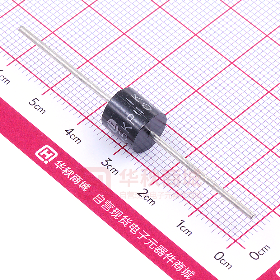

    TVS二极管 Vr=40V Vc=65.8V
15KP40CA 数据手册
TVS Diodes 15KP Series Description The 15KP series is designed specifically to protect sensitive electronic equipment from voltage transients induced by lightning and other transient voltage events. Features             Halogen free and RoHS compliant Glass passivated junction Low incremental surge resistance Excellent clamping capability 15000W peak pulse power capability at 10/1000μs waveform, repetition rate (duty cycle): 0.05% Fast response time Typical IR less than 2μA above 30V devices High Temperature soldering guaranteed: 265℃/10 seconds/.375″, (9.5mm) lead length, 5lbs (2.3kg) tension Plastic package has underwriters laboratory flammability 94V-0 Meet MSL level1, per J-STD-020 IEC-61000-4-2 ESD 30kV(Air), 30kV (Contact) Unit Weight: 2.3g Applications TVS components are ideal for the protection of I/O Interfaces, VCC bus and other vulnerable circuits used in telecom, computer, Industrial and consumer electronic applications. Maximum Ratings and Characteristics (TA=25℃) Rating Symbol Value Peak pulse power dissipation at 10/1000μs waveform (Note1, Fig.1) PPPM 15000W Peak pulse current of at 10/1000μs waveform (Note 1, Fig.3) IPPM See Table(A) PM(AV) 8.0W IFSM 400A TJ,TSTG -55℃ to +150℃ Typical thermal resistance junction to lead RθJL 8℃/W Typical thermal resistance junction to ambient RθJA 40℃/W Steady state power dissipation at TL=75℃ (Fig.5) Peak forward surge current, 8.3ms single half sine-wave superimposed on rated load, (JEDEC Method) (Note2, Fig.6) Operating junction and Storage Temperature Ranges Notes:1. Non-repetitive current pulse, per Fig.3 and derating above TA=25℃ per Fig.2. 2. 8.3ms single half sine-wave or equivalent square wave, duty cycle=4 pulses per minutes maximum. www.liownsemi.com 掌握芯技术Core Technology (V3) TVS Diodes 15KP Series Electrical Characteristics (TA=25℃) Reverse Stand-Off Voltage Part Number Breakdown Voltage @IT Test Current Maximum Clamping Voltage @IPP Peak Pulse Current Reverse Leakage @VR Uni. Bi. VR(V) VB MIn.(V) VB Max.(V) IT(mA) VC(V) IPP(A) IR(μA) 15KP17A 15KP17CA 17.0 18.99 21.22 50 29.3 515.4 2500 15KP18A 15KP18CA 18.0 20.11 22.65 50 30.9 488.7 1500 15KP20A 15KP20CA 20.0 22.34 24.96 20 34.3 440.2 1000 15KP22A 15KP22CA 22.0 24.57 27.46 10 37.1 407.0 500 15KP24A 15KP24CA 24.0 26.81 29.95 5 40.7 371.0 150 15KP26A 15KP26CA 26.0 29.04 32.45 5 44.0 343.2 50 15KP28A 15KP28CA 28.0 31.28 34.95 5 47.5 317.9 25 15KP30A 15KP30CA 30.0 33.51 37.44 5 50.7 297.8 10 15KP33A 15KP33CA 33.0 36.90 41.19 5 54.7 276.1 2 15KP36A 15KP36CA 36.0 40.20 44.93 5 59.8 252.5 2 15KP40A 15KP40CA 40.0 44.70 49.92 5 65.8 229.5 2 15KP43A 15KP43CA 43.0 48.00 53.67 5 69.8 216.3 2 15KP45A 15KP45CA 45.0 50.30 56.16 5 72.8 207.4 2 15KP48A 15KP48CA 48.0 53.60 59.91 5 77.7 194.3 2 15KP51A 15KP51CA 51.0 57.00 63.65 5 82.9 182.1 2 15KP54A 15KP54CA 54.0 60.30 67.39 5 87.7 172.2 2 15KP58A 15KP58CA 58.0 64.80 72.39 5 93.8 161.0 2 15KP60A 15KP60CA 60.0 67.00 74.88 5 97.4 155.0 2 15KP64A 15KP64CA 64.0 71.50 79.87 5 104.2 144.9 2 15KP70A 15KP70CA 70.0 78.20 87.36 5 113.6 132.9 2 15KP75A 15KP75CA 75.0 83.80 93.60 5 122.0 123.8 2 15KP78A 15KP78CA 78.0 87.10 97.35 5 126.1 119.7 2 15KP85A 15KP85CA 85.0 94.90 106.08 5 137.6 109.7 2 15KP90A 15KP90CA 90.0 100.50 112.32 5 145.6 103.7 2 15KP100A 15KP100CA 100.0 111.70 124.80 5 161.3 93.6 2 www.liownsemi.com 掌握芯技术Core Technology (V3) TVS Diodes 15KP Series Electrical Characteristics (TA=25℃) Reverse Stand-Off Voltage Part Number Breakdown Voltage @IT Test Current Maximum Clamping Voltage @IPP Peak Pulse Current Reverse Leakage @VR Uni. Bi. VR(V) VB MIn.(V) VB Max.(V) IT(mA) VC(V) IPP(A) IR(μA) 15KP110A 15KP110CA 110.0 122.90 137.28 5 178.6 84.5 2 15KP120A 15KP120CA 120.0 134.00 149.76 5 192.3 78.5 2 15KP130A 15KP130CA 130.0 145.20 162.25 5 208.3 72.5 2 15KP150A 15KP150CA 150.0 167.60 187.21 5 241.9 62.4 2 15KP160A 15KP160CA 160.0 178.70 199.69 5 258.6 58.4 2 15KP170A 15KP170CA 170.0 189.90 212.17 5 272.7 55.4 2 15KP180A 15KP180CA 180.0 201.10 224.65 5 288.5 52.3 2 15KP200A 15KP200CA 200.0 223.40 249.61 5 319.1 47.3 2 15KP220A 15KP220CA 220.0 245.70 274.57 5 352.5 42.8 2 15KP240A 15KP240CA 240.0 268.10 299.53 5 384.6 39.3 2 15KP260A 15KP260CA 260.0 290.40 324.49 5 416.7 36.2 2 15KP280A 15KP280CA 280.0 312.80 349.45 5 454.5 33.2 2 www.liownsemi.com 掌握芯技术Core Technology (V3) TVS Diodes 15KP Series Ratings and Characteristic Curves (TA=25℃) Figure 2. Pulse Derating Curve PPPM - Peak Pulse Power (kW) Figure 1. Peak Pulse Power Rating Curve Figure 3. Pulse Waveform 150 Figure 4. Typical Junction Capacitance tr=10µs TJ=25℃ Pulse Width(td) is defined as the point where the peak current decays to 50% of IPPM Bi-directional V=0V 10000 Uni-directional V=0V Peak Value IPPM 100 1000 Half Value IPPM (IPPM/2) 50 0 100000 100 10/1000µs Waveform as defined by R.E.A 10 td 0 1 1.0 2.0 3.0 0 4.0 50 100 150 200 250 300 350 VBR-Reverse Breakdown Voltage (V) Time (ms) Figure 5. Steady State Power Dissipation Derating Curve www.liownsemi.com TJ=25℃ f=1.0MHz Vsig=50mVp-p Figure 6. Maximum Non-Repetitive Forward Surge Current Uni-Directional Only 掌握芯技术Core Technology (V3) TVS Diodes 15KP Series Wave Soldering 300 Preheating Maximum Wave 265℃ Soldering Cooling 250 200 150 100 Peak Temperature: 265℃ Dipping Time: 10 seconds (max.) Soldering: 1 time 50 0 0 0.5 1 1.5 2 2.5 3 3.5 4 Time (minutes) Part Number Code and Marking Code Dimensions (P600) Symbol www.liownsemi.com Millimeters Inches Min. Max. Min. Max. A 25.40 - 1.000 - B 8.60 9.10 0.340 0.360 C 8.60 9.10 0.340 0.360 d 1.19 1.35 0.047 0.053 掌握芯技术Core Technology (V3) TVS Diodes 15KP Series Packaging Specification Tape Quantity: 800pcs/reel Box Quantity:300pcs/box www.liownsemi.com 掌握芯技术Core Technology (V3)
