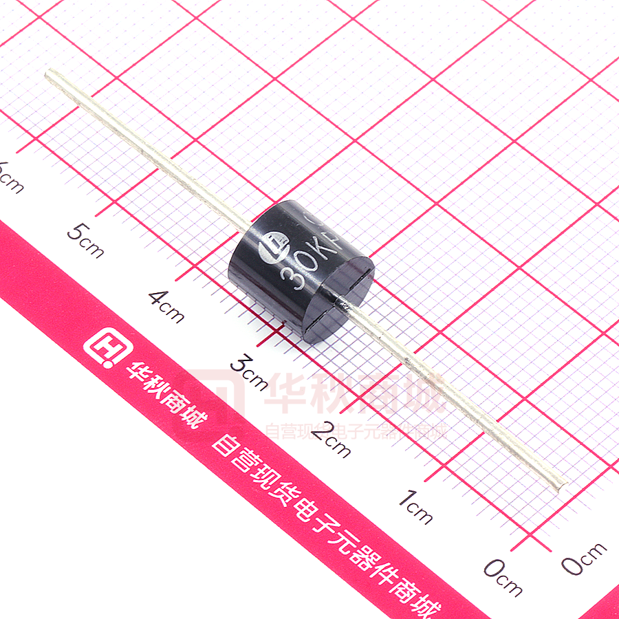

    TVS二极管 Vr=36V Vc=61.8V
30KP36CA 数据手册
TVS Diodes 30KP Series Description The 30KP series is designed specifically to protect sensitive electronic equipment from voltage transients induced by lightning and other transient voltage events. Features             Halogen free and RoHS compliant Glass passivated junction Low incremental surge resistance Excellent clamping capability 30000W peak pulse power capability at 10/1000μs waveform, repetition rate (duty cycle): 0.05% Fast response time Typical IR less than 2μA above 64V devices High Temperature soldering guaranteed: 265℃/10 seconds/.375″, (9.5mm) lead length, 5lbs (2.3kg) tension Plastic package has underwriters laboratory flammability 94V-0 Meet MSL level1, per J-STD-020 IEC-61000-4-2 ESD 30kV(Air), 30kV (Contact) Unit Weight: 2.46g Applications TVS components are ideal for the protection of I/O Interfaces, VCC bus and other vulnerable circuits used in telecom, computer, Industrial and consumer electronic applications. Maximum Ratings and Characteristics (TA=25℃) Rating Symbol Value Peak pulse power dissipation at 10/1000μs waveform (Note1, Fig.1) PPPM 30000W Peak pulse current of at 10/1000μs waveform (Note 1, Fig.3) IPPM See Table(A) PM(AV) 8.0W IFSM 400A TJ,TSTG -55℃ to +150℃ Typical thermal resistance junction to lead RθJL 8℃/W Typical thermal resistance junction to ambient RθJA 40℃/W Steady state power dissipation at TL=75℃ (Fig.5) Peak forward surge current, 8.3ms single half sine-wave superimposed on rated load, (JEDEC Method) (Note2, Fig.6) Operating junction and Storage Temperature Ranges Notes:1. Non-repetitive current pulse, per Fig.3 and derating above TA=25℃ per Fig.2. 2. 8.3ms single half sine-wave or equivalent square wave, duty cycle=4 pulses per minutes maximum. www.liownsemi.com 掌握芯技术Core Technology (V3) TVS Diodes 30KP Series Electrical Characteristics (TA=25℃) Reverse Stand-Off Voltage Part Number Breakdown Voltage @IT Test Current Maximum Clamping Voltage @IPP Peak Pulse Current Reverse Leakage @VR Uni. Bi. VR(V) VB MIn.(V) VB Max.(V) IT(mA) VC(V) IPP(A) IR(μA) 30KP28A 30KP28CA 28.0 31.28 34.57 50 50.0 606.0 2500 30KP30A 30KP30CA 30.0 33.51 37.04 50 55.2 548.9 2000 30KP33A 30KP33CA 33.0 36.90 40.78 50 58.5 517.9 1500 30KP36A 30KP36CA 36.0 40.20 44.43 50 61.8 490.3 1000 30KP39A 30KP39CA 39.0 43.60 48.19 20 67.2 450.9 800 30KP42A 30KP42CA 42.0 46.90 51.84 10 72.0 420.8 200 30KP43A 30KP43CA 43.0 48.00 53.05 10 73.0 415.1 150 30KP45A 30KP45CA 45.0 50.30 55.59 5 77.4 391.5 30 30KP48A 30KP48CA 48.0 53.60 59.24 5 81.6 371.3 15 30KP51A 30KP51CA 51.0 57.00 63.00 5 86.4 350.7 10 30KP54A 30KP54CA 54.0 60.30 66.65 5 91.4 331.5 5 30KP58A 30KP58CA 58.0 64.80 71.62 5 92.4 327.9 5 30KP60A 30KP60CA 60.0 67.00 74.05 5 102.0 297.1 5 30KP64A 30KP64CA 64.0 71.50 79.03 5 104.0 291.3 5 30KP66A 30KP66CA 66.0 73.70 81.46 5 107.0 283.2 2 30KP70A 30KP70CA 70.0 78.20 86.43 5 109.0 278.0 2 30KP71A 30KP71CA 71.0 79.30 87.65 5 111.5 271.7 2 30KP72A 30KP72CA 72.0 80.40 88.86 5 114.0 265.8 2 30KP75A 30KP75CA 75.0 83.80 92.62 5 119.4 253.8 2 30KP78A 30KP78CA 78.0 87.10 96.27 5 129.0 234.9 2 30KP84A 30KP84CA 84.0 93.80 103.67 5 139.2 217.7 2 30KP90A 30KP90CA 90.0 100.50 111.08 5 146.4 207.0 2 30KP96A 30KP96CA 96.0 107.20 118.48 5 156.0 194.2 2 30KP102A 30KP102CA 102.0 113.90 125.89 5 165.6 183.0 2 30KP108A 30KP108CA 108.0 120.60 133.29 5 175.2 172.9 2 www.liownsemi.com 掌握芯技术Core Technology (V3) TVS Diodes 30KP Series Electrical Characteristics (TA=25℃) Reverse Stand-Off Voltage Part Number Breakdown Voltage @IT Test Current Maximum Clamping Voltage @IPP Peak Pulse Current Reverse Leakage @VR Uni. Bi. VR(V) VB MIn.(V) VB Max.(V) IT(mA) VC(V) IPP(A) IR(μA) 30KP120A 30KP120CA 120.0 134.00 148.11 5 194.4 155.9 2 30KP132A 30KP132CA 132.0 147.40 162.92 5 213.0 142.3 2 30KP144A 30KP144CA 144.0 160.80 177.73 5 223.2 135.8 2 30KP150A 30KP150CA 150.0 167.60 185.24 5 233.4 129.8 2 30KP156A 30KP156CA 156.0 174.30 192.65 5 245.0 123.7 2 30KP160A 30KP160CA 160.0 178.70 197.51 5 252.6 120.0 2 30KP168A 30KP168CA 168.0 187.70 207.46 5 272.4 111.2 2 30KP170A 30KP170CA 170.0 189.90 209.89 5 275.0 110.2 2 30KP180A 30KP180CA 180.0 201.10 222.27 5 290.4 104.3 2 30KP198A 30KP198CA 198.0 221.20 244.48 5 319.8 94.7 2 30KP216A 30KP216CA 216.0 241.30 266.70 5 348.6 86.9 2 30KP240A 30KP240CA 240.0 268.10 296.32 5 387.0 78.3 2 30KP258A 30KP258CA 258.0 288.20 318.54 5 416.4 72.8 2 30KP260A 30KP260CA 260.0 290.40 320.97 5 416.0 72.8 2 30KP270A 30KP270CA 270.0 301.60 333.35 5 436.2 69.5 2 30KP280A 30KP280CA 280.0 312.80 345.73 5 464.0 65.3 2 30KP288A 30KP288CA 288.0 321.70 355.56 5 469.9 64.5 2 30KP300A 30KP300CA 300.0 334.00 367.40 5 484.0 62.0 2 30KP320A 30KP320CA 320.0 357.40 391.40 5 530.0 57.2 2 30KP350A 30KP350CA 350.0 391.00 428.10 5 567.0 53.4 2 30KP360A 30KP360CA 360.0 402.10 440.30 5 640.0 47.3 2 www.liownsemi.com 掌握芯技术Core Technology (V3) TVS Diodes 30KP Series Ratings and Characteristic Curves (TA=25℃) Figure 2. Pulse Derating Curve PPPM - Peak Pulse Power (kW) Figure 1. Peak Pulse Power Rating Curve Figure 3. Pulse Waveform 150 Figure 4. Typical Junction Capacitance tr=10µs TJ=25℃ Pulse Width(td) is defined as the point where the peak current decays to 50% of IPPM Cj (pF) Peak Value IPPM 100 Half Value IPPM (IPPM/2) 50 0 10/1000µs Waveform as defined by R.E.A td 0 1.0 2.0 3.0 4.0 Time (ms) Figure 5. Steady State Power Dissipation Derating Curve www.liownsemi.com Figure 6. Maximum Non-Repetitive Forward Surge Current Uni-Directional Only 掌握芯技术Core Technology (V3) TVS Diodes 30KP Series Wave Soldering 300 Preheating Maximum Wave 265℃ Soldering Cooling 250 200 150 100 Peak Temperature: 265℃ Dipping Time: 10 seconds (max.) Soldering: 1 time 50 0 0 0.5 1 1.5 2 2.5 3 3.5 4 Time (minutes) Part Number Code and Marking Code Dimensions (P600) Symbol www.liownsemi.com Millimeters Inches Min. Max. Min. Max. A 25.40 - 1.000 - B 8.60 9.10 0.340 0.360 C 8.60 9.10 0.340 0.360 d 1.19 1.35 0.047 0.053 掌握芯技术Core Technology (V3) TVS Diodes 30KP Series Packaging Specification Tape Quantity: 800pcs/reel Box Quantity:300pcs/box www.liownsemi.com 掌握芯技术Core Technology (V3)
