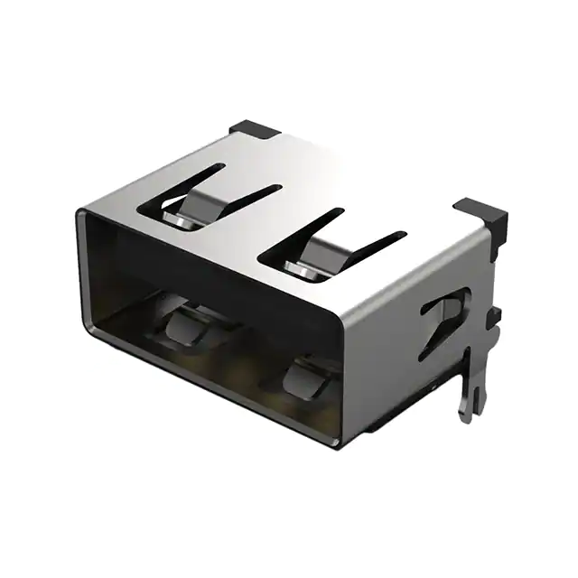

    USB连接器 Type-A 4P 弯插 端口数:1 额定电流:3A 额定电压:30V 工作温度:-30℃~+85℃
USB1125-GF-B 数据手册
12.80 H 1.20 7.00 G 2.00 4x Ø0.92 2x 1.60 8.55 2x 0.60 Specifications 13.10 12.50±0.10 11.10±0.10 7.00 ref. E Stand off=0.50 5.72 ref. 2.00 ref. 4x 0.85±0.05 4x 0.65+0.10 +0.15 5.12±0.10 1.84±0.05 D 6.48±0.15 2x 8.70±0.25 0.20 A 6.00±0.25 2x 0.30±0.10 4x 0.60±0.05 4x 0.50 Max. 2x1.60+0.05 -0.10 Electrical Current Rating: 3.0 Amp Voltage Rating: 30V rms max. Contact Resistance: 30 mΩ max. Insulation Resistance: 1000 MΩ min. Dielectric Withstand Voltage: 500 V AC 4x 0.25±0.05 Mechanical & Environmental Operating Temperature: -30°C to +85°C Mating Force: 35N max. Unmating Force: 10N min. Durability: 5000 cycles 4x 1.20+0.20 -0.10 0.15 B C Material Insulator: PA9T, Black, UL94V-0 Contact: Copper Alloy Shell: SK7 Plating Contact: Contact Area: Gold Flash Solder Tails: 100u" min. Tin Underplating: 50u" min. Nickel Shell: 50u" min. Nickel Plating Overall PCB Edge 4x 2.53±0.25 A Recommended PCB Layout Tolerance:±0.05mm CH=3.62 F 2.00 ref. 2.85 Min. 12.80 8.0 Max. 7.00 ref. B B Ordering Grid USB1125 10.00 Mating View A (100 per tray) USB1125 USB 2.0 Receptacle, Type A,Through Hole, Horizontal, Top Mount, Without Flange By 4 Packing Options B = Tray Product Description Detail 3 Request Samples and Quotation Part Number 12th June 2020 2 B Contact Plating GF = Gold Flash Drawing Date 1 GF Revision Date 5 CC Drawing Release A1 08/01/21 Tolerances (Except as Noted) Length Angle X.X ± 0.50 X.XX ± 0.30 X.XXX ± 0.20 ± 2° Units: Metric (mm) C 3rd Angle Projection 6 7 This drawing is confidential and copyright of Global Connector Technology, Ltd (GCT). This drawing must not be copied or disclosed without written consent. E & OE www.gct.co Not to Scale Drawn By CC 8 Sheet No. 1/2 210 210 H G QC Label F Cover Tray E Desiccant 280mm Use stretch film winding Carboard D 25 Trays/Stack 452m m C 225 mm PCS/Tray Trays/Carton PCS/Carton B 100 25 Part Number Product Description USB1125 USB 2.0 Receptacle, Type A,Through Hole, Horizontal, Top Mount, Without Flange Drawing Date A 12th June 2020 By Detail Revision Date 1 2 3 4 5000 5 CC Drawing Release A1 08/01/21 Tolerances (Except as Noted) Length X.X ± 0.50 X.XX ± 0.30 X.XXX ± 0.20 Angle Units: Metric (mm) ± 2° C 3rd Angle Projection 6 7 This drawing is confidential and copyright of Global Connector Technology, Ltd (GCT). This drawing must not be copied or disclosed without written consent. E & OE www.gct.co Not to Scale Drawn By CC 8 Sheet No. 2/2
