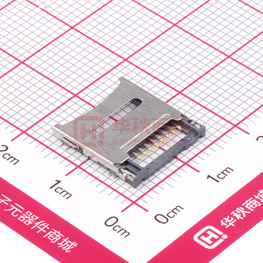

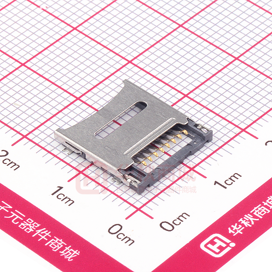

    SD/SIM/TF卡插座 表面贴装 8Pin 翻盖式
MEM2067-02-180-00-A 数据手册
13.89 13.60 6.00 1.10 8x 0.80 Specifications 8.20 4x 2.00 8x 1.20 3.85 8.20 F 6.15 10.00 4.15 G 6.80 1.65 9.00 3.85 14.60 2.80 1.40 H Material Plastic Housing: LCP UL94V-0, Black Contact Terminal: Copper Alloy Metallic Shell: Stainless Steel SMT Hold-Down: Stainless Steel 8 76 54 3 21 4x 1.20 0.15 4.475 Section A-A 7.70 13.60 Plating Contact Terminal: Underplating: 50µ" Nickel all over Contact Area: Gold Flash Soldering Area: Tin SMT Hold-Down: Tin over Nickel 4x 1.50 Recommended PCB Layout 0.80 1.80 4.475 7.70 1.10 0.75 E General Tolerance: ±0.05 Solder Area Keep Out Area Component Outline Electrical Voltage Rating: 100 V DC Current Rating: 0.5 A max. Contact Resistance: 100 mΩ max. Card Detection Switch Contact Resistance: 500 mΩ max. Insulation Resistance: 1000 MΩ min Dielectric Withstanding Voltage: 500V AC for 1 min. D 0.1Max Micro SD Card Pin Out Name Pin 13.40 14.45 1.05 C B Description P1 DAT2 Data Bit 2 P2 CD/DAT3 Card Detect/Data Bit 3 P3 CMD Command Line Supply Voltage 2.7v/3.6v Mechanical & Environmental Operating Temperature: -40°C to +85°C Durability: 5000 Cycles P4 VDD P5 CLK Clock Ordering Grid P6 VSS Ground MEM2067 P7 DAT0 Data Bit 0 P8 DAT1 Data Bit 1 02 Switch 02 = Without Switch 180 00 Locating Post 00 = Without A Request Samples and Quotation Packing Options A = Tape & Reel (Quantity per Reel: 1000 pcs) 0.40 A Part Number Product Description MEM2067 Micro SD Memory Card Connector SMT, Hinged, 1.80mm Profile Drawing Date 0.70 10th January 2014 By Detail 1 2 3 4 Revision Date 5 CC Tolerances (Except as Noted) MEM2067 B PCN B4 30/03/18 X. ± 0.35 X.° ± 5° X.X° ± 4° X.X ± 0.25 X.XX ± 0.15 X.XX° ± 3° X.XXX ± 0.10 X.XXX° ± 2° Length Angle 6 Units: Metric (mm) C 3rd Angle Projection 7 This drawing is confidential and copyright of Global Connector Technology, Ltd (GCT). This drawing must not be copied or disclosed without written consent. E & OE www.gct.co Not to Scale Drawn By AJO 8 Sheet No. 1/3 H G 2 1 Insert Card 2 Close Lid 3 Slide Lid To Lock 3 0.80 R0 .80 135 9.70 7.90 20 0. 6.40 R Micro SD Card E 4.93 0.40 0.70 F 1 15.00 ° 1.30 Step 1 D 135° Push The Shell 0.60 Step 2 C 11.00 Finish 1.00 Micro SD Card Step 3 (Tolerance:±0.05) 0.7 B All drawings for illustrative purposes only. Not representative of actual parts. Part Number Product Description MEM2067 Micro SD Memory Card Connector SMT, Hinged, 1.80mm Profile Drawing Date 10th January 2014 A By Detail Revision Date 1 2 3 4 5 CC Tolerances (Except as Noted) MEM2067 B PCN B4 30/03/18 X.° ± 1° X.X ± 0.35 X.XX ± 0.25 X.X° ± 0.5° X.XXX ± 0.150 X.XX° ± 0.25° Length Angle 6 Units: Metric (mm) C 3rd Angle Projection 7 This drawing is confidential and copyright of Global Connector Technology, Ltd (GCT). This drawing must not be copied or disclosed without written consent. E & OE www.gct.co Not to Scale Drawn By AJO 8 Sheet No. 2/3 Cover Tape 2+0.05 -0.00 H Product no. PCS/Reel MEM2067 Reels/Carton PCS/Carton 10 10000 1000 Pull Out Direction ø80 ø330±0.05 G Tape Reel F Product Labels 24+2 -0 Triangular Pad E 1000 pieces 200mm 1. 50 + 0 -0 .1 .0 0 0 D 2.00±0.10 20.00±0.10 B A L= 35 0m m 14.9±0.10 Pull Out Direction Notes: 1. Primary Packing: 1K pcs/reel 2. Secondary Packing: 10 reel/carton 3. Net Weight/carton:9.30Kg 4. Gross Weight/carton: 10.50Kg Product Description MEM2067 Micro SD Memory Card Connector SMT, Hinged, 1.80mm Profile Drawing Date 10th January 2014 By Revision Date 2 3 4 m 0m 35 W= Part Number Detail 1 H=325mm 13.90±0.10 11.50±0.10 C 1.76±0.10 24.00±0.30 Ø 4.00±0.10 350mm 5 CC Tolerances (Except as Noted) MEM2067 B PCN B4 30/03/18 X. ± 0.35 X.° ± 5° X.X° ± 4° X.X ± 0.25 X.XX ± 0.15 X.XX° ± 3° X.XXX ± 0.10 X.XXX° ± 2° Length Angle 6 Units: Metric (mm) C 3rd Angle Projection 7 This drawing is confidential and copyright of Global Connector Technology, Ltd (GCT). This drawing must not be copied or disclosed without written consent. E & OE www.gct.co Not to Scale Drawn By AJO 8 Sheet No. 3/3
