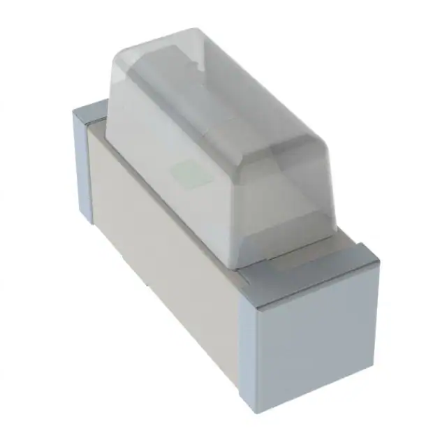

    发光二极管/LED 蓝色 侧面发光,0603封装,0.6mm PCB型贴片
IN-S63AS5B 数据手册
IN-S63AS series Side View SMD LED 0603 0.6mm PCB Type Features • 0603 0.6 mm side view SMD LED • High Brightness • AlInGaP / InGaN Technology • Small package • High reliability • Clear Lens Description The IN-S63AS series is a popular low profile 0603 package with versatile design capabilities. It is a PCB type molding style LED which can be used in various applications. Recommended Solder Pattern Applications • Consumer Electronics • Wearable • Automobile After Market • Industrial Equipment Figure 1. IN-S63AS Solder Pattern Package Dimensions in mm Figure 2. IN-S63AS Package Dimensions Inolux Corporation Proprietary & Confidential March 16, 2017 Page 1 www.inolux-corp.com IN-S63AS series Side View SMD LED 0603 0.6mm PCB Type Absolute Maximum Rating at 25oC (Note 1) Product Emission Color Pd (mW) IF (mA) IN-S63AS5YG Yellow Green 75 25 IN-S63AS5Y Yellow 75 25 IFP* (mA) VR (V) TOP (oC) TST (oC) 5 -30 C~+85 C 70 IN-S63AS5A Amber 75 25 IN-S63ASR Red 75 25 IN-S63AS5B Blue 75 25 IN-S63ASG Green 75 25 IN-S63AS5UW White 75 25 o o o o -40 C~+90 C 100 Notes 1. Condition for IFP is pulse of 1/10 duty and 0.1msec width ESD Precaution ATTENTION: Electrostatic Discharge (ESD) protection The symbol above denotes that ESD precaution is needed. ESD protection for GaP and AlGaAs based chips is necessary even though they are relatively safe in the presence of low static-electric discharge. Parts built with AlInGaP, GaN, or/and InGaN based chips are STATIC SENSITIVE devices. ESD precaution must be taken during design and assembly. If manual work or processing is needed, please ensure the device is adequately protected from ESD during the process. Please be advised that normal static precautions should be taken in the handling and assembly of this device to prevent damage or degradation which may be induced by electrostatic discharge (ESD). Inolux Corporation Proprietary & Confidential March 16, 2017 Page 2 www.inolux-corp.com IN-S63AS series Side View SMD LED 0603 0.6mm PCB Type Electrical Characteristics T A = 25°C (Note 1) VF(V) Product Emission Color IN-S63AS5YG Yellow Green Viewing λ(nm) Angle IF(mA) I*V(mcd) min max λD λP △λ 2θ1/2 typ. 5 1.8 2.6 573 576 15 120 11.5 IN-S63AS5Y Yellow 5 1.8 2.6 588 590 20 120 30 IN-S63AS5A Amber 5 1.8 2.2 605 608 17 120 45 IN-S63ASR Red 20 1.8 2.6 622 630 20 120 150 IN-S63AS5B Blue 5 2.7 3.1 467 468 30 120 80 IN-S63ASG Green 20 2.8 3.6 522 527 35 120 450 IN-S63AS5UW White 5 2.7 3.1 X=0.29 Y=0.29 - - 120 285 Notes 1. Performance guaranteed only under conditions listed in above tables. Inolux Corporation Proprietary & Confidential March 16, 2017 Page 3 www.inolux-corp.com IN-S63AS series Side View SMD LED 0603 0.6mm PCB Type Chromaticity Bin (for White only) Inolux Corporation Proprietary & Confidential March 16, 2017 Page 4 www.inolux-corp.com IN-S63AS series Side View SMD LED 0603 0.6mm PCB Type Inolux Corporation Proprietary & Confidential March 16, 2017 Page 5 www.inolux-corp.com IN-S63AS series Side View SMD LED 0603 0.6mm PCB Type Typical Characteristic Curves – YG, Y, A, R Inolux Corporation Proprietary & Confidential March 16, 2017 Page 6 www.inolux-corp.com IN-S63AS series Side View SMD LED 0603 0.6mm PCB Type Typical Characteristic Curves – B, G, W Inolux Corporation Proprietary & Confidential March 16, 2017 Page 7 www.inolux-corp.com IN-S63AS series Side View SMD LED 0603 0.6mm PCB Type Typical Characteristic Curves – Radiation Pattern Ordering Information Product Technolog Test Current Emission Color y IF (mA) IN-S63AS5YG Yellow Green Forward Luminous Intensity Voltage IV (mcd) VF (V) (Typ.) (Typ.) Orderable Part Number AllnGaP 5 11.5 2.0 IN-S63AS5YG IN-S63AS5Y Yellow AllnGaP 5 30 2.0 IN-S63AS5Y IN-S63AS5A Amber AllnGaP 5 45 2.0 IN-S63AS5A IN-S63ASR Red AllnGaP 20 150 2.2 IN-S63ASR IN-S63AS5B Blue InGaN 5 80 2.9 IN-S63AS5B IN-S63ASG Green InGaN 20 450 3.2 IN-S63ASG IN-S63AS5UW White InGaN 5 285 2.9 IN-S63AS5UW Inolux Corporation Proprietary & Confidential March 16, 2017 Page 8 www.inolux-corp.com IN-S63AS series Side View SMD LED 0603 0.6mm PCB Type Label Specifications Inolux P/N: I N - P Material Inolux SMD S = PCB Type 3 2 Package A T Variation Orientation 63A = 1.7 x 1.1 x 0.6 mm X S = Side Mount Current (Blank) = 20mA Lens Color (Blank) = Clear U = Diffused R=630nm A=608nm Y=592nm YG=576nm G=527nm B=468nm W=White 5=5mA - X X X X Customized Stamp-off Lot No.: Z Internal Tracker Inolux Corporation Proprietary & Confidential 2 0 1 7 Year (2017, 2018, …..) 01 24 001 Month Date Serial March 16, 2017 Page 9 www.inolux-corp.com IN-S63AS series Side View SMD LED 0603 0.6mm PCB Type Packaging Information: 4000pcs Per Reel Tape Dimension Reel Dimension Inolux Corporation Proprietary & Confidential March 16, 2017 Page 10 www.inolux-corp.com IN-S63AS series Side View SMD LED 0603 0.6mm PCB Type Packing Dimension 5 boxes per carton are available depending on shipment quantity. Specification Material Quantity Carrier tape Per EIA 481-1A specs Conductive black tape 4000pcs per reel Reel Per EIA 481-1A specs Conductive black Label IN standard Paper Packing bag 220x240mm Aluminum laminated bag/ no-zipper One reel per bag Carton IN standard Paper Non-specified Others: Each immediate box consists of 5 reels. The 5 reels may not necessarily have the same lot number or the same bin combinations of Iv, λD and Vf. Each reel has a label identifying its specification; the immediate box consists of a product label as well. Inolux Corporation Proprietary & Confidential March 16, 2017 Page 11 www.inolux-corp.com IN-S63AS series Side View SMD LED 0603 0.6mm PCB Type Dry Pack All SMD optical devices are MOISTURE SENSITIVE. Avoid exposure to moisture at all times during transportation or storage. Every reel is packaged in a moisture protected anti-static bag. Each bag is properly sealed prior to shipment. Upon request, a humidity indicator will be included in the moisture protected anti-static bag prior to shipment. The packaging sequence is as follows: Reflow Soldering • Recommended tin glue specifications: melting temperature in the range of 178~192 OC • The recommended reflow soldering profile is as follows (temperatures indicated are as measured on the surface of the LED resin): Lead-free Solder Profile Inolux Corporation Proprietary & Confidential March 16, 2017 Page 12 www.inolux-corp.com IN-S63AS series Side View SMD LED 0603 0.6mm PCB Type Precautions • • • • • • Avoid exposure to moisture at all times during transportation or storage. Anti-Static precaution must be taken when handling GaN, InGaN, and AlInGaP products. It is suggested to connect the unit with a current limiting resistor of the proper size. Avoid applying a reverse voltage. Avoid operation beyond the limits as specified by the absolute maximum ratings. Avoid direct contact with the surface through which the LED emits light. If possible, assemble the unit in a clean room or dust-free environment. Reworking • • • Rework should be completed within 5 seconds under 260 OC. The iron tip must not come in contact with the copper foil. Twin-head type is preferred. Cleaning Following are cleaning procedures after soldering: • An alcohol-based solvent such as isopropyl alcohol (IPA) is recommended. • Temperature x Time should be 50oC x 30sec. or
IN-S63AS5B
物料型号:IN-S63AS系列
器件简介:IN-S63AS系列是Inolux公司生产的侧视SMD LED,采用0603 0.6mm封装,具有高亮度、小尺寸、高可靠性等特点,适用于多种应用场景。
引脚分配:文档中提供了推荐的焊接图案,但具体的引脚分配未详细说明。
参数特性: - 发光颜色:包括黄绿色、黄色、琥珀色、红色、蓝色、绿色和白色。 - 绝对最大额定值:如工作温度范围-30°C至+85°C,存储温度范围-40°C至+90°C。 - 电气特性:包括正向电流(IF)、正向电压(VF)、波长(λp)、视场角度等。
功能详解:文档提供了详细的电气特性表和典型特性曲线,展示了不同颜色LED的亮度、波长、正向电压等参数。
应用信息:适用于消费电子、可穿戴设备、汽车后市场和工业设备。
封装信息:0603 0.6mm PCB类型封装,具有清晰的透镜,小尺寸设计。
