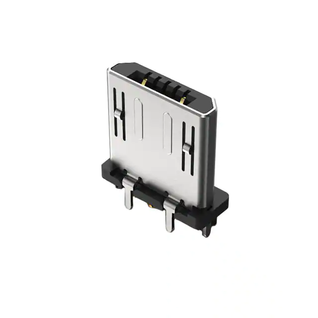

    USB连接器 Micro-B 5P 直插 端口数:1 额定电流:1A,1.8A 额定电压:30V 工作温度:-30℃~+85℃
USB3150-30-130-A 数据手册
4x Ø 5x 0.55 Ø0 . 2xØ 45 0.80 F Pin 1 3.65 2 70 0. Ø x Pin 5 6.85 GND (Shell) 2.60 1.30 0.42 0.65 2.80 0.85 6x R0 .4 0 1.80 G 2.50 1.03 5.30 5.60 3.00 6.65 Pin 5 Pin 1 Pin 2 GND (Shell) Component Outline 2.75 0.20 2x0.46 5x0.20 3.00 5x0.25 5.60 0.65 4 Pin Signal 1 VBUS 7.93±0.10 7.13±0.10 6.38±0.10 S (1.30mm shown) 2x0.20 4x0.40 0.42 2 D- 3 D+ 4 ID 5 GND Shell Shield 6.65 Ordering Grid USB3150 2.60 0.65 1.30 Request Samples and Quotation Packing A = Tape and Reel (1,500 per reel) Shell Stake & Lead Length "S" 075 = 0.75mm (recommended for PCB thickness 0.4mm) 130 = 1.30mm (recommended for PCB thickness 0.8mm) Product Description USB3150 Micro USB Plug - Type B, Through-Hole Vertical, with Shell Stakes and Locating Pegs 30th April 2015 By 4 A XXX Contact Plating 30 = 30µ" Gold Drawing Date 3 30 Part Number Detail 2 Electrical: Voltage Rating: 30 V AC Current Rating: Signal (Pins 2,3,4):1.0 A. Power (Pins1,5):1.8A. Operating Temperature: -30°C to +85°C. Contact Resistance: 30 mΩ max. Insulating Resistance: 1000 MΩ min. Dielectric Withstand Voltage: 500V AC/Minute Mechanical: Mating Force: 35N max. Unmating Force: 8N min. Durability: 10,000 cycles 2.50 .40 xR0 Plating: Underplating: 50µ" Nickel min. Finish:Contact Area: 30µ" Gold plating Solder Tails: Matte Tin Metallic Shell: Nickel Ø0.66 Designed to comply with physical, electrical and environmental requirements of Micro USB Standard (USB2.0) 1 Specifications Materials: Plastic Housing: LCP, UL94V-0, Black Contact Terminal: Copper Alloy Metallic Shell: Stainless Steel Pin Assignments Ø0.72 (base) B A Pin 4 GND (Shell) 0.20 E C Pin 5 PCB Pin Number Description Tolerance: ±0.05mm D Pin 3 Pin 1 Recommended PCB Layout 4.75 GND (Shell) 2.00 7.35 0.96 H Revision Date 5 CC USB3150 B PCN B 23/05/19 Tolerances (Except as Noted) Length Angle X.X ± 0.10 X.XX ± 0.05 X.° ± 2.0° X.X° ± 1.0° 6 Units: Metric (mm) C 3rd Angle Projection 7 This drawing is confidential and copyright of Global Connector Technology, Ltd (GCT). This drawing must not be copied or disclosed without written consent. E & OE www.gct.co Not to Scale Drawn By AJO 8 Sheet No. 1/2 120mm 1800mm 300mm 100mm H The carrier tape is 4.00±0.10 2.00±0.10 The cover tape is empty empty for 25 cavities 12.00±0.10 0 .1 +0 .00 Round Sprocket Hole 0 -0 .5 Ø1 16.0mm The carrier tape loaded with 1500 pieces of product empty for 10 cavities 13.3mm 1.75±0.10 7.50±0.10 The carrier tape is G F 16.5mm Carrier Tape Packing Direction Reel Ø330mm E Input Material Direction Cover Tape Eco Label Label GP D Part Number Specification Q'ty Carrier Tape 16.0mm (W) x 18.42m (L) 10 Cover Tape 13.3mm (W) 185.2m Reel 330 x 21mm 10 Bag 400 x 400 x 400mm, PE 1 Cardboard Triangles 430 x 215 x 3mm 4 Carton 350 x 350 x 230mm 1 Desiccant 3.5g 2 PE Bag Cardboard Triangles Reels Tape 230mm C Carton 35 B Part Number Pcs./Reel Reels/Carton 0m m 3 Pcs./Carton mm 50 Part Number Product Description USB3150 Micro USB Plug - Type B, Through-Hole Vertical, with Shell Stakes and Locating Pegs Drawing Date A 1500 USB3150 10 15000 30th April 2015 By Detail Revision Date 1 2 3 4 5 CC USB3150 B PCN B 23/05/19 Tolerances (Except as Noted) Length Angle X.X ± 0.10 X.XX ± 0.05 X.° ± 2.0° X.X° ± 1.0° Units: Metric (mm) C 3rd Angle Projection 6 7 This drawing is confidential and copyright of Global Connector Technology, Ltd (GCT). This drawing must not be copied or disclosed without written consent. E & OE www.gct.co Not to Scale Drawn By AJO 8 Sheet No. 2/2
