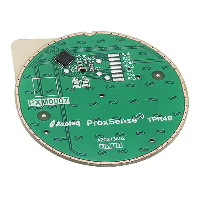

TPR48-P201-S 数据手册
IQ Switch® ProxSense® Series Azoteq PROXSENSE® TRACKPAD MODULE DATASHEET Capacitive Trackpads with Gesture Recognition for Headphones & Audio Equipment with Direct Connection to Bluetooth SoCs. The ProxSense® series of capacitive trackpads offers best in class sensitivity, signal to noise ratio and power consumption. Automatic tuning for sense electrodes guarantees optimal operation over production and environmental change. > > > > Swipe Down x Swipe Backwards x Swipe Forwards x Swipe Up & Hold x Swipe Down & Hold x Swipe Backwards & Hold x Swipe Forwards & Hold x Tap x Tap & Hold Low Power, suitable for battery applications Supply voltage: 1.65V to 3.6V > > > > Bluetooth Headphones Bluetooth Speakers Mechanical Push Button Replacement Portable Electronics Wearable Electronics Copyright © Azoteq (Pty) Ltd 2017. All Rights Reserved. Trackpad Module Datasheet V1.09 Page 1 of 23 March 2021 54mm 48mm 48mm x 60mm Trackpad with on chip XY coordinate calculation 1792 x 1792 resolution 170Hz scan rate for gesture recognition Adjustable Sensitivity Active high or low output Proximity wake up from low power Automatic drift compensation Gestures mapped to I/O pins for Audio Adjustment x Swipe Up 48mm > > > > > > > > 40mm Main Features Azoteq IQ Switch® ProxSense® Series Contents 1 HARDWARE DESCRIPTION .................................................................................................................... 3 2 TPR40 ................................................................................................................................................... 7 3 TPR40-V ............................................................................................................................................... 8 4 TPR48 ................................................................................................................................................... 9 5 TPR54 ................................................................................................................................................. 10 6 TPE48 ................................................................................................................................................. 11 7 TPE60 ................................................................................................................................................. 12 8 TPS48 ................................................................................................................................................. 13 9 GESTURE IMPLEMENTATION............................................................................................................... 15 10 SPECIFICATIONS ................................................................................................................................. 19 11 ORDERING INFORMATION .................................................................................................................. 20 Datasheet Revision History Version Description Date 1.00 Preliminary Draft May 2015 1.01 First Release June 2015 1.02 Updated ordering Information for Value Line August 2015 1.03 Update Illustrations Sept 2015 1.04 Update TPR54 design Nov 2015 1.05 Add TPR40-V Nov 2016 1.06 Update output tables Jan 2017 1.07 Output type correction April 2017 1.08 Update available version in order info May 2017 1.09 Template update March 2021 Copyright © Azoteq (Pty) Ltd 2017. All Rights Reserved. Trackpad Module Datasheet V1.09 Page 2 of 23 March 2021 Azoteq IQ Switch® ProxSense® Series 1 Hardware Description All trackpad modules are available on RoHS2 and REACH compliant FR4 PCB material. The module PCBs are 1mm thick and have an OSP finish, with tinned pads for the user required solder points. The standard modules are not Halogen free. The trackpad sensing is done with IQS572, connected to an 8x8 diamond grid for 1792 pixel resolution in the X and Y directions. The modules are supplied with 3M double sided adhesive tape (PSA). Only certain modules include a connector, please consult Section 11. Table 1-1: Summary of Trackpad Offerings Module Name Shape Size TPR40 Round Ø40mm TPR48 Round Ø48mm TPR54 Round Ø54mm TPE60 Ellipse 60mm x 46mm TPE48 Ellipse 48mm x 38mm TPS48 Rectangle 48mm x 38mm The TPR40 is also available in the Value Line series. The value line uses the IQS525 in place of the IQS572, with maximum resolution of 1024 x 1024. 1.1 PCB Specification - Material: 2-layer, FR4 PCB (non-HF material) &RQGXFWRUȝP&RSSHU R]&X Finish: OSP (tinned) Size: Module Specific PCB Final Thickness = 1.0mm +/- 10% Outline: Precision DIE-CUT Profile Copyright © Azoteq (Pty) Ltd 2017. All Rights Reserved. Trackpad Module Datasheet V1.09 Page 3 of 23 March 2021 IQ Switch® ProxSense® Series Azoteq 1.2 Module Orientation All the modules have a cut in the PCB indicating the top of the module, which could also be used to align the module on the application overlay. This Notch can be seen in Figure 1.1 Tip: An overlay must be secured to the module with double sided adhesive tape without air gaps for performance evaluation. Figure 1-1: Top Notch Illustrating Module Orientation. 1.3 Adhesive (PSA) Specification All 6 modules offered are supplied with double sided adhesive applied on the trackpad for ease of integration. The adhesive is kept with the liner kept in place, with a pull tab for easy removal without tearing: - Type: 3M 468 200MP Thickness = 0.13mm Liner = Polycoated Kraft Paper Liner w/ Pull-Tab (No glue on Pull-Tab) Adhesive sized to fit entire tracking area (module specific) 1.4 Total Thickness The total thickness given in Figure 1.2 does not include the protective liner on the adhesive. The liner needs to be removed when the module is assembled into the application. The highest part (thickest part of the module) of the assembly is a 0603 capacitor – C2. Copyright © Azoteq (Pty) Ltd 2017. All Rights Reserved. Trackpad Module Datasheet V1.09 Page 4 of 23 March 2021 Azoteq IQ Switch® ProxSense® Series 2.03mm ± 10% Components Adhesive PCB Figure 1-2: Maximum Module Thickness. 1.5 Compatible Overlay Thickness The compatible overlay thicknesses are shown in Table 1.2 below. The modules have a solder link, S1, which can select one of two sensitivity settings tuned for different overlay thicknesses. Table 1-2: Module Overlay Compatibility . Solder link S1 Overlay Range Open 1mm – 2mm Closed 2mm – 3mm For non-uniform overlays, the maximum curve in the overlay is limited to a 1mm height difference over the trackpad surface as shown in Figure 1.3. Maximum Height variation of 1mm Overlay Adhesive PCB PCB Figure 1-3: Maximum height variation in the overlay. Copyright © Azoteq (Pty) Ltd 2017. All Rights Reserved. Trackpad Module Datasheet V1.09 Page 5 of 23 March 2021 IQ Switch® ProxSense® Series Azoteq 1.6 Output Level The active level of the output pins can be changed from active high (default) to active low. Connect a solder link on S2 to select active low. The active level is applicable to all 5 output pins. Table 1-3: Module Output Pin Level. Solder link S2 Output Level Open Active High Closed Active Low 1.7 Finger Sizes The modules have the same number of rows and columns which results in different trackpad pitches. The smallest finger sizes for valid gestures on each module are shown in Table 1.4 below. Table 1-4: Suggested Minimum Finger Sizes Module Min Finger Diameter TPR40 6.7 mm TPR40-V 10.4mm TPR48 8.0 mm TPR54 9.0 mm TPE60 9.0 mm TPE48 7.2 mm TPS48 7.2 mm Copyright © Azoteq (Pty) Ltd 2017. All Rights Reserved. Trackpad Module Datasheet V1.09 Page 6 of 23 March 2021 Azoteq IQ Switch® ProxSense® Series 2 TPR40 40.00mm ±0.2mm 39.74mm ±0.2mm Figure 2-1 : TPR40 – Front and Back View. 2.1 Outputs of TPR40 The pin mapping for the TPR40 gesture outputs are shown in below. Table 2-1-1: Module Gesture Output Pin Mapping. Gesture Output Pin Output Type Typical Feature Swipe Upward I/O_1 Single Pulse Volume Increase Swipe Upward & Hold I/O_1 Continuous Pulse Continuous Volume Increase Swipe Downward I/O_3 Single Pulse Volume Decrease Swipe Downward & Hold I/O_3 Continuous Pulse Continuous Volume Decrease Swipe Forward I/O_5 Single Pulse Skip / Next Track Swipe Forward & Hold I/O_5 Continuous Pulse Fast Forward Swipe Backward I/O_4 Single Pulse Skip / Previous Track Swipe Backward & Hold I/O_4 Continuous Pulse Reverse/Rewind Tap I/O_2 Single Pulse Play/Pause (Call Answer) Tap & Hold I/O_2 Continuous Pulse Start/STOP Copyright © Azoteq (Pty) Ltd 2017. All Rights Reserved. Trackpad Module Datasheet V1.09 Page 7 of 23 March 2021 Azoteq IQ Switch® ProxSense® Series 3 TPR40-V Figure 3-1: TPR40-V Front and Back View. 3.1 Outputs of TPR40-V The pin mapping for the TPR40-V gesture outputs are shown in below. Table 3-1: Module Gesture Output Pin Mapping. Gesture Output Pin Output Type Typical Feature Swipe Upward I/O_3 Single Pulse Volume Increase Swipe Upward & Hold I/O_3 Continuous Pulse Continuous Volume Increase Swipe Downward I/O_1 Single Pulse Volume Decrease Swipe Downward & Hold I/O_1 Continuous Pulse Continuous Volume Decrease Swipe Forward I/O_5 Single Pulse Skip / Next Track Swipe Forward & Hold I/O_5 Continuous Pulse Fast Forward Swipe Backward I/O_4 Single Pulse Skip / Previous Track Swipe Backward & Hold I/O_4 Continuous Pulse Reverse/Rewind Tap I/O_2 Single Pulse Play/Pause (Call Answer) Tap & Hold I/O_2 Continuous Pulse Start/STOP Copyright © Azoteq (Pty) Ltd 2017. All Rights Reserved. Trackpad Module Datasheet V1.09 Page 8 of 23 March 2021 IQ Switch® ProxSense® Series Azoteq 4 TPR48 Figure 4-1 TPR48 – Front and Back View.: 4.1 Outputs of TPR48 The pin mapping for the TR48 gesture outputs are shown in below. Table 4-1: Module Gesture Output Pin Mapping. Gesture Output Pin Output Type Typical Feature Swipe Upward I/O_1 Single Pulse Volume Increase Swipe Upward & Hold I/O_1 Continuous Pulse Continuous Volume Increase Swipe Downward I/O_3 Single Pulse Volume Decrease Swipe Downward & Hold I/O_3 Continuous Pulse Continuous Volume Decrease Swipe Forward I/O_5 Single Pulse Skip / Next Track Swipe Forward & Hold I/O_5 Continuous Pulse Fast Forward Swipe Backward I/O_4 Single Pulse Skip / Previous Track Swipe Backward & Hold I/O_4 Continuous Pulse Reverse/Rewind Tap I/O_2 Single Pulse Play/Pause (Call Answer) Tap & Hold I/O_2 Continuous Pulse Start/STOP Copyright © Azoteq (Pty) Ltd 2017. All Rights Reserved. Trackpad Module Datasheet V1.09 Page 9 of 23 March 2021 IQ Switch® ProxSense® Series Azoteq 5 TPR54 54.00mm ±0.2mm 53.77mm ±0.2mm Figure 5-1: TPR54 – Front and Back View. 5.1 Outputs of TPR54 The pin mapping for the TPR54 gesture outputs are shown in below. Table 5-1: Module Gesture Output Pin Mapping. Gesture Output Pin Output Type Typical Feature Swipe Upward I/O_1 Single Pulse Volume Increase Swipe Upward & Hold I/O_1 Continuous Pulse Continuous Volume Increase Swipe Downward I/O_3 Single Pulse Volume Decrease Swipe Downward & Hold I/O_3 Continuous Pulse Continuous Volume Decrease Swipe Forward I/O_5 Single Pulse Skip / Next Track Swipe Forward & Hold I/O_5 Continuous Pulse Fast Forward Swipe Backward I/O_4 Single Pulse Skip / Previous Track Swipe Backward & Hold I/O_4 Continuous Pulse Reverse/Rewind Tap I/O_2 Single Pulse Play/Pause (Call Answer) Tap & Hold I/O_2 Continuous Pulse Start/STOP Copyright © Azoteq (Pty) Ltd 2017. All Rights Reserved. Trackpad Module Datasheet V1.09 Page 10 of 23 March 2021 Azoteq IQ Switch® ProxSense® Series Table 5-2: FPC connector pin out. J1 Connection 1 NRST 2 RDY 3 GND 4 VDDHI 5 SCL 6 SDA 6 TPE48 Figure 6-1: TPE48 – Front and Back View. 6.1 Outputs of TPE48 The pin mapping for the TPE48 gesture outputs are shown in below. Table 6-1: Module Gesture Output Pin Mapping. Gesture Output Pin Output Type Typical Feature Swipe Upward I/O_1 Single Pulse Volume Increase Swipe Upward & Hold I/O_1 Continuous Pulse Continuous Volume Increase Copyright © Azoteq (Pty) Ltd 2017. All Rights Reserved. Trackpad Module Datasheet V1.09 Page 11 of 23 March 2021 IQ Switch® ProxSense® Series Azoteq Swipe Downward I/O_3 Single Pulse Volume Decrease Swipe Downward & Hold I/O_3 Continuous Pulse Continuous Volume Decrease Swipe Forward I/O_5 Single Pulse Skip / Next Track Swipe Forward & Hold I/O_5 Continuous Pulse Fast Forward Swipe Backward I/O_4 Single Pulse Skip / Previous Track Swipe Backward & Hold I/O_4 Continuous Pulse Reverse/Rewind Tap I/O_2 Single Pulse Play/Pause (Call Answer) Tap & Hold I/O_2 Continuous Pulse Start/STOP 7 TPE60 Figure 7-1: TPE60 – Front and Back View. Copyright © Azoteq (Pty) Ltd 2017. All Rights Reserved. Trackpad Module Datasheet V1.09 Page 12 of 23 March 2021 IQ Switch® ProxSense® Series Azoteq 7.1 Outputs of TPE60 The pin mapping for the TPE60 gesture outputs are shown in below. Table 7-1: Module Gesture Output Pin Mapping. Gesture Output Pin Output Type Typical Feature Swipe Upward I/O_1 Single Pulse Volume Increase Swipe Upward & Hold I/O_1 Continuous Pulse Continuous Volume Increase Swipe Downward I/O_3 Single Pulse Volume Decrease Swipe Downward & Hold I/O_3 Continuous Pulse Continuous Volume Decrease Swipe Forward I/O_5 Single Pulse Skip / Next Track Swipe Forward & Hold I/O_5 Continuous Pulse Fast Forward Swipe Backward I/O_4 Single Pulse Skip / Previous Track Swipe Backward & Hold I/O_4 Continuous Pulse Reverse/Rewind Tap I/O_2 Single Pulse Play/Pause (Call Answer) Tap & Hold I/O_2 Continuous Pulse Start/STOP 8 TPS48 Figure 8-1: TPS48 – Front and Back View. Copyright © Azoteq (Pty) Ltd 2017. All Rights Reserved. Trackpad Module Datasheet V1.09 Page 13 of 23 March 2021 IQ Switch® ProxSense® Series Azoteq 8.1 Outputs of TPS48 The pin mapping for the TPS48 gesture outputs are shown in below. Table 8-1: Module Gesture Output Pin Mapping. Gesture Output Pin Output Type Typical Feature Swipe Upward I/O_1 Single Pulse Volume Increase Swipe Upward & Hold I/O_1 Continuous Pulse Continuous Volume Increase Swipe Downward I/O_3 Single Pulse Volume Decrease Swipe Downward & Hold I/O_3 Continuous Pulse Continuous Volume Decrease Swipe Forward I/O_5 Single Pulse Skip / Next Track Swipe Forward & Hold I/O_5 Continuous Pulse Fast Forward Swipe Backward I/O_4 Single Pulse Skip / Previous Track Swipe Backward & Hold I/O_4 Continuous Pulse Reverse/Rewind Tap I/O_2 Single Pulse Play/Pause (Call Answer) Tap & Hold I/O_2 Continuous Pulse Start/STOP Copyright © Azoteq (Pty) Ltd 2017. All Rights Reserved. Trackpad Module Datasheet V1.09 Page 14 of 23 March 2021 Azoteq IQ Switch® ProxSense® Series 9 Gesture Implementation 9.1 Swipe Gestures There are four swipe gestures that can be detected by the trackpad modules, as shown in Figure 9.1 below. Figure 9-1: Illustrations off the 4 swipe gestures that can be detected by the trackpad modules. Each time any of the swipe gestures are performed correctly (correct finger action within a 18ms to 1 second window), the corresponding I/O pin of the trackpad will output a single 200ms (100ms TPR54-P203 > TPR54-P203-S > TPR48-P201 > TPR48-P201-S > TPR54-P303 > TPR54-P303-S > Elliptical Modules: > TPE48-P201 > TPE48-P201-S > TPE60-P201 > TPE60-P201-S > TPE48-P203 > TPE48-P203-S > TPE60-P203 > TPE60-P203-S > Square/Rectangular Modules: > TPS48-P201 > TPS48-P201-S > TPS48-P203 > TPS48-P203 1 Note: For non-standard versions or version not listed above please contact Azoteq direct. Copyright © Azoteq (Pty) Ltd 2017. All Rights Reserved. Trackpad Module Datasheet V1.09 Page 22 of 23 March 2021 IQ Switch® ProxSense® Series Azoteq USA Asia South Africa Physical Address 11940 Jollyville Suite 120-S Austin TX 78750 USA Room 501A, Block A, T-Share International Centre, Taoyuan Road, Nanshan District, Shenzhen, Guangdong, PRC 1 Bergsig Avenue Paarl 7646 South Africa Postal Address 11940 Jollyville Suite 120-S Austin TX 78750 USA Room 501A, Block A, T-Share International Centre, Taoyuan Road, Nanshan District, Shenzhen, Guangdong, PRC PO Box 3534 Paarl 7620 South Africa Tel +1 512 538 1995 +86 755 8303 5294 ext 808 +27 21 863 0033 Email info@azoteq.com info@azoteq.com info@azoteq.com Visit www.azoteq.com for a list of distributors and worldwide representation. Patents as listed on www.azoteq.com/patents-trademarks/ may relate to the device or usage of the device. Azoteq®, Crystal Driver , IQ Switch®, ProxSense®, ProxFusion®, LightSense™, SwipeSwitch™, and the logo are trademarks of Azoteq. The information in this Datasheet is believed to be accurate at the time of publication. Azoteq uses reasonable effort to maintain the information up-to-date and accurate, but does not warrant the accuracy, completeness or reliability of the information contained herein. All content and information are provided on an “as is” basis only, without any representations or warranties, express or implied, of any kind, including representations about the suitability of these products or informat ion for any purpose. Azoteq disclaims all warranties and conditions with regard to these products and information, including but not limited to all implied warranties and conditions of merchantability, fitness for a particular purpose, title and non-infringement of any third party intellectual property rights. Azoteq assumes no liability for any damages or injury arising from any use of the information or the product o r caused by, without limitation, failure of performance, error, omission, interruption, defect, delay in operation or transmiss ion, even if Azoteq has been advised of the possibility of such damages. The applications mentioned herein are used solely for the purpose of illustration and Azoteq makes no warranty or representation that such applications will be suitable without further modification, nor recommends the use of its products for application that may present a risk to human life due to malfunction o r otherwise. Azoteq products are not authorized for use as critical components in life support devices or systems. No licenses to patents are granted, implicitly, express or implied, by estoppel or otherwise, under any intellectual property rights. In the event that any of the abovementioned limitations or exclusions does not apply , it is agreed that Azoteq’s total liability for all losses, damages and causes of action (in contract, tort (including without limitation, negligence) or otherwise) will not exceed the amount already paid by the customer for the products. Azoteq reserves the right to alter its products, to make corrections, deletions, modifications, enhancements, improvements and other changes to the content and information, its products, programs and services at any time or to move or discontinue any contents, products, programs or services without pr ior notification. For the most up-to-date information and binding Terms and Conditions please refer to www.azoteq.com. Copyright © Azoteq (Pty) Ltd 2019. All Rights Reserved. info@azoteq.com IQS5xx-B000 Datasheet Revision 2.1 Page 1 of 1 March 2021
