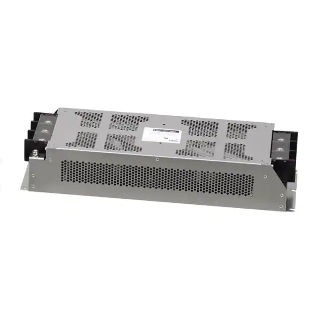

TBC-50-683 数据手册
Ordering information Three phase input type(2-stage filter) TBC series(50,60,80,100,150A) TBC -50 -683 1 2 3 *Link to www.cosel co.jp/en for the latest product information. R 1 Model Name 2 Rated Current 3 Line to ground capacitor code:See table 1.1. table1.1 Line to ground capacitor code Code 223 683 104 Line to ground Leakage Current capacitor (Input 250/500V 60Hz) (nominal value) 1.0mA/2.0mA max 22,000pF 2.5mA/5.0mA max 68,000pF 3.5mA/7.0mA max 100,000pF *When the line to ground capacitor code is different, the attenuation characteristic is different. Features of TBC series High-attenuation type of common mode noise from 150kHz to 1MHz (2-stage filter) - Three phase rated voltage 500 VAC (voltage range:528V max) - Selectable leakage current value Specifications No. 1 Items TBC-50-683 Rated Voltage[V] AC Three Phase 500 (voltage range:528 max) 50/60Hz TBC-60-683 TBC-80-683 TBC-100-683 TBC-150-683 100 150 2 Rated Current[A] 50 3 Test Voltage (Terminal-Mounting Plate) 2,500 VAC (Cutoff Current = 100mA), 1minute at room temperature and humidity 60 80 4 Isolation Resistance (Terminal-Mounting Plate) 500 VDC 100MW min at room temperature and humidity 5 Leakage current 250/500V 60Hz 2.5mA/5.0mA max 6 DC resistance 14mW max 7 Safety agency approval temperatures -25 to +85C (Refer to Derating Curve) 8 Operating temperature -40 to +85C (Refer to Derating Curve) 9 Operating humidity 20 to 95%RH (Non condensing) 10 Storage temperature/humidity -40 to +85C/20 to 95%RH (Non condensing) 11 Vibration 10 to 55Hz, 19.6m/s2 (2G), 3min. Period, 1hour each X, Y and Z axis 12 Impact 196.1m/s2 (20G), 11ms Once each X, Y and Z axis 13 Safety agency approvals UL1283, CSA C22.2 No.8 (C-UL) , DIN EN60939 VDE0565 Teil3-1, ENEC 14 Case size (without projection) 15 Weight 10mW max 8mW max 6mW max 140X80X374 mm (WXHXD) 150X92X456 mm (WXHXD) [5.51X3.15X14.72 inches] [5.91X3.62X17.95 inches] [7.48X3.62X18.98 inches] 4.3kg max 7.7kg max 9.6kg max 190X92X482 mm (WXHXD) Derating Curve LOAD LINE Case 4 1 2 3 5 6 CY CY 100 Load Factor [%] Circuit Diagram CY : Line to ground capacitor 10mW max 80 60 40 20 0 -40 -30 -20 40 50 60 70 80 Ambient Temperature [C] : Mounting Plate *Keep free ventilation holes for cooling. TBC-1 July 08, 2020 90 TBC series (50,60,80,100,150A) External view TBC-50- OOO / TBC-60- OOO 80 374 [3.15] [14.72] 6.5 [12.72] [2.28] 6-M5 Name Plate Input Terminal Output Terminal 6.5 2-f6.5 359 ±0.5 [0.26] Mounting Hole [0.67] Output Terminal 17 Output Terminal Input Terminal [0.26] 21.5 [0.85] [5.51] 90 ±0.5 [3.54] 140 Input Terminal 58 M4 Protection Earth [0.26] 323 Mounting Plate Terminal cover [14.13] ¶ Can not be mounted upside-down. (mounted the top surface) ¶ Tolerance : ±1 [±0.04] ¶ Weight : 4.3kg max ¶ Chassis Material : Stainless steel t=1.0 [0.04] ¶ Dimensions in mm, [ ]=inches ¶ Terminal block screw tightening torque M5:3.0N-m (30.7kgf-cm) max ¶ Protection Earth screw tightening torque M4:1.6N-m (16.9kgf-cm) max TBC-80- OOO / TBC-100- OOO 92 [3.62] 456 [17.95] 6.5 Protection Earth Input Terminal Input Terminal Output Terminal 6-M8 Output Terminal 6.5 2-f6.5 441 ±0.5 [0.26] Mounting Hole [17.36] ¶ Can not be mounted upside-down. (mounted the top surface) [0.26] 24 Output Terminal [0.94] [1.1] Name Plate 28 [4.17] 106 ±0.5 150 [5.91] Input Terminal 61 [2.4] [0.26] 409 [16.1] 65.5 [2.58] M6 Terminal cover Mounting Plate ¶ Tolerance : ±1 [±0.04] ¶ Weight : 7.7kg max ¶ Chassis Material : Stainless steel t=1.0 [0.04] ¶ Dimensions in mm, [ ]=inches ¶ Terminal block screw tightening torque M8:9.2N-m (93.9kgf-cm) max ¶ Protection Earth screw tightening torque M6:5.8N-m (59.2kgf-cm) max July 08, 2020 TBC-2 TBC series (50,60,80,100,150A) External view TBC-150- OOO 92 [3.62] 482 65.5 [18.98] 435 M6 6.5 Protection Earth Name Plate Output Terminal 24 6.5 2-f6.5 [0.94] Output Terminal Output Terminal Input Terminal Input Terminal [0.26] 28 6-M8 [1.1] [5.59] 190 142 ±0.5 Input Terminal [7.48] 61 [2.4] [0.26] [17.13] [2.58] Terminal cover [0.26] Mounting Hole 467 ±0.5 Mounting Plate [18.39] ¶ Tolerance : ±1 [±0.04] ¶ Weight : 9.6kg max ¶ Chassis Material : Stainless steel t=1.0 [0.04] ¶ Dimensions in mm, [ ]=inches ¶ Terminal block screw tightening torque M8:9.2N-m (93.9kgf-cm) max ¶ Protection Earth screw tightening torque M6:5.8N-m (59.2kgf-cm) max ¶ Can not be mounted upside-down. (mounted the top surface) TBC-3 July 08, 2020
