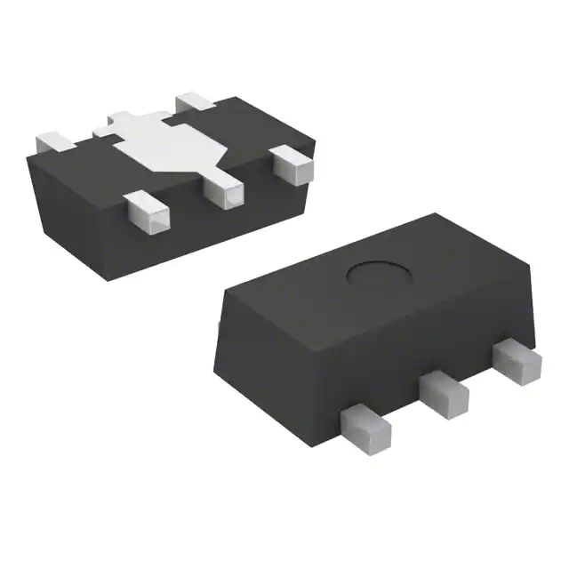

S-1155 Series www.ablic.com www.ablicinc.com HIGH RIPPLE-REJECTION LOW DROPOUT HIGH OUTPUT CURRENT CMOS VOLTAGE REGULATOR Rev.2.1_03 © ABLIC Inc., 2007-2015 The S-1155 Series, developed by using CMOS technology, is a positive voltage regulator with a super low dropout voltage, high-accuracy output voltage and low current consumption. The S-1155 Series provides the very low dropout voltage and the large output current due to the built-in transistor with low on-resistance. The S-1155 Series includes an overcurrent protection circuit that prevents the load current from exceeding the current capacitance of the output transistor, a thermal shutdown circuit that prevents damage due to overheating, and an inrush current limit circuit to limit the excessive inrush current generated at power-on. The ON/OFF circuit ensures longer battery life. Compared with the voltage regulators using the conventional CMOS technology, a large variety of capacitors are available, including small ceramic capacitors The small package SOT-89-5 realizes high-density mounting.  Features  Output voltage:  Input voltage:  Output voltage accuracy:  Dropout voltage:  Current consumption:  Output current:  Input and output capacitors:  Ripple rejection:  Built-in overcurrent protection circuit:  Built-in thermal shutdown circuit:  Built-in inrush current limit circuit:  Built-in ON/OFF circuit:  Operation temperature range:  Lead-free, Sn 100%, halogen-free*2 1.0 V to 5.0 V, selectable in 0.05 V step 1.5 V to 5.5 V 1.0% (1.0 V to 1.45 V output product: 15 mV) 70 mV typ. (3.0 V output product, IOUT = 200 mA) During operation: 70 A typ., 90 A max. (3.0 V output product) During power-off: 0.1 A typ., 1.0 A max. Possible to output 500 mA (3.0 V output product, VIN  VOUT(S)  1.0 V)*1 A ceramic capacitor of 4.7 F or more can be used. 70 dB typ. (1.0 V output product, f = 1.0 kHz) Limits overcurrent of output transistor. Prevents damage caused by heat. Limits excessive inrush current at power-on. Ensures long battery life. Ta = 40°C to 85°C *1. Attention should be paid to the power dissipation of the package when the output current is large. *2. Refer to “ Product Name Structure” for details.  Applications  Constant-voltage power supply for battery-powered device  Constant-voltage power supply for TV, notebook PC and home electric appliance  Constant-voltage power supply for portable equipment  Package  SOT-89-5 1 HIGH RIPPLE-REJECTION LOW DROPOUT HIGH OUTPUT CURRENT CMOS VOLTAGE REGULATOR S-1155 Series Rev.2.1_03 ■ Block Diagram *1 VIN VOUT Overcurrent protection circuit Thermal shutdown circuit  ON/OFF ON/OFF circuit  Reference voltage circuit VSS *1. Parasitic diode Figure 1 2 HIGH RIPPLE-REJECTION LOW DROPOUT HIGH OUTPUT CURRENT CMOS VOLTAGE REGULATOR S-1155 Series Rev.2.1_03  Product Name Structure Users can select the product type, output voltage, and package type for the S-1155 Series. Refer to “1. name” regarding the contents of product name, “2. Package” regarding the package drawings and “3. name list” regarding details of product name. 1. Product Product Product name S-1155 x xx - U5T1 x Environmental code U: Lead-free (Sn 100%), halogen-free G: Lead-free (for details, please contact our sales office) Package abbreviation and packing specifications *1 U5T1: SOT-89-5, Tape Output voltage *2 10 to 50 (e.g., when the output voltage is 1.0 V, it is expressed as 10.) Product type *3 A: ON/OFF pin negative logic B: ON/OFF pin positive logic *1. *2. *3. 2. Refer to the tape drawing. If you request the product which has 0.05 step, contact our sales office. Refer to “3. ON/OFF pin” in “ Operation”. Package Package Name SOT-89-5 Package UP005-A-P-SD Drawing Code Tape UP005-A-C-SD Reel UP005-A-R-SD 3 HIGH RIPPLE-REJECTION LOW DROPOUT HIGH OUTPUT CURRENT CMOS VOLTAGE REGULATOR S-1155 Series 3. Product name list Table 1 Output Voltage 1.0 V 15 mV 1.1 V 15 mV 1.2 V 15 mV 1.3 V 15 mV 1.4 V 15 mV 1.5 V 1.0% 1.6 V 1.0% 1.7 V 1.0% 1.8 V 1.0% 1.85 V 1.0% 1.9 V 1.0% 2.0 V 1.0% 2.1 V 1.0% 2.2 V 1.0% 2.3 V 1.0% 2.4 V 1.0% 2.5 V 1.0% 2.6 V 1.0% 2.7 V 1.0% 2.8 V 1.0% 2.85 V 1.0% 2.9 V 1.0% 3.0 V 1.0% 3.1 V 1.0% 3.2 V 1.0% 3.3 V 1.0% 3.4 V 1.0% 3.5 V 1.0% 3.6 V 1.0% 3.7 V 1.0% 3.8 V 1.0% 3.9 V 1.0% 4.0 V 1.0% 4.1 V 1.0% 4.2 V 1.0% 4.3 V 1.0% 4.4 V 1.0% 4.5 V 1.0% 4.6 V 1.0% 4.7 V 1.0% 4.8 V 1.0% 4.9 V 1.0% 5.0 V 1.0% SOT-89-5 S-1155B10-U5T1x S-1155B11-U5T1x S-1155B12-U5T1x S-1155B13-U5T1x S-1155B14-U5T1x S-1155B15-U5T1x S-1155B16-U5T1x S-1155B17-U5T1x S-1155B18-U5T1x S-1155B1J-U5T1x S-1155B19-U5T1x S-1155B20-U5T1x S-1155B21-U5T1x S-1155B22-U5T1x S-1155B23-U5T1x S-1155B24-U5T1x S-1155B25-U5T1x S-1155B26-U5T1x S-1155B27-U5T1x S-1155B28-U5T1x S-1155B2J-U5T1x S-1155B29-U5T1x S-1155B30-U5T1x S-1155B31-U5T1x S-1155B32-U5T1x S-1155B33-U5T1x S-1155B34-U5T1x S-1155B35-U5T1x S-1155B36-U5T1x S-1155B37-U5T1x S-1155B38-U5T1x S-1155B39-U5T1x S-1155B40-U5T1x S-1155B41-U5T1x S-1155B42-U5T1x S-1155B43-U5T1x S-1155B44-U5T1x S-1155B45-U5T1x S-1155B46-U5T1x S-1155B47-U5T1x S-1155B48-U5T1x S-1155B49-U5T1x S-1155B50-U5T1x Remark 1. Please contact our sales office for products with an output voltage other than those specified above or type A products. 2. x: G or U 3. Please select products of environmental code = U for Sn 100%, halogen-free products. 4 Rev.2.1_03 HIGH RIPPLE-REJECTION LOW DROPOUT HIGH OUTPUT CURRENT CMOS VOLTAGE REGULATOR S-1155 Series Rev.2.1_03  Pin Configuration Table 2 SOT-89-5 Top view 5 4 Pin No. Symbol 1 ON/OFF Description ON/OFF pin 2 VSS GND pin 3 NC*1 No connection 4 VIN Input voltage pin 5 VOUT Output voltage pin *1. The NC pin is electrically open. The NC pin can be connected to VIN pin or VSS pin. 1 2 3 Figure 2 5 HIGH RIPPLE-REJECTION LOW DROPOUT HIGH OUTPUT CURRENT CMOS VOLTAGE REGULATOR S-1155 Series Rev.2.1_03  Absolute Maximum Ratings Table 3 Item Symbol Input voltage Output voltage Power dissipation Operation ambient temperature Storage temperature *1. VIN VON/OFF VOUT PD Topr Tstg (Ta  25C unless otherwise specified) Absolute Maximum Rating Unit VSS  0.3 to VSS + 6 V VSS  0.3 to VIN + 0.3 V VSS  0.3 to VIN + 0.3 V 1000*1 mW 40 to +85 °C 40 to +125 °C When mounted on board [Mounted board] (1) Board size : (2) Name : Caution 114.3 mm  76.2 mm  t1.6 mm JEDEC STANDARD51-7 The absolute maximum ratings are rated values exceeding which the product could suffer physical damage. These values must therefore not be exceeded under any conditions. Power dissipation (PD) [mW] 1200 1000 800 600 400 200 0 Figure 3 0 150 100 50 Ambient temperature (Ta) [C] Power Dissipation of Package (When Mounted on Board) Table 4 Condition SOT-89-5 (When mounted on board) 6 Power Dissipation 1000 mW Thermal Resistance Value (ja) 100°C/W Rev.2.1_03 HIGH RIPPLE-REJECTION LOW DROPOUT HIGH OUTPUT CURRENT CMOS VOLTAGE REGULATOR S-1155 Series  Electrical Characteristics Table 5 (1 / 2) Item Output voltage*1 Symbol VOUT(E) Output current*2 IOUT Dropout voltage*3 Vdrop Line regulation Load regulation Output voltage temperature *4 coefficient Current consumption during operation Current consumption during power-off Input voltage VOUT1 VIN  VOUT VOUT2 VOUT Ta  VOUT ISS1 ISS2 VIN Condition VIN = VOUT(S) + 1.0 V, IOUT = 100 mA VIN = 5.5 V, IOUT = 100 mA VIN  VOUT(S) + 1.0 V VIN = 5.5 V IOUT = 200 mA 1.0 V  VOUT(S) < 1.5 V 1.5 V  VOUT(S)  4.5 V 4.5 V < VOUT(S)  5.0 V 1.0 V  VOUT(S)  4.5 V 4.5 V < VOUT(S)  5.0 V 1.0 V  VOUT(S) < 1.1 V 1.1 V  VOUT(S) < 1.2 V 1.2 V  VOUT(S) < 1.3 V 1.3 V  VOUT(S) < 1.4 V 1.4 V  VOUT(S) < 1.5 V 1.5 V  VOUT(S) < 2.6 V 2.6 V  VOUT(S)  5.0 V VOUT(S) + 0.5 V  VIN 1.0 V  VOUT(S) < 3.6 V  5.5 V, 3.6 V  VOUT(S)  4.8 V IOUT = 100 mA 5.3 V  VIN  5.5 V, 4.8 V < VOUT(S)  5.0 V IOUT = 100 mA VIN = VOUT(S) + 1.0 V, 1.0 V  VOUT(S)  4.5 V 1 mA  IOUT  200 mA VIN = 5.5 V, 4.5 V < VOUT(S)  5.0 V 1 mA  IOUT  200 mA VIN = VOUT(S) + 1.0 V, 1.0 V  VOUT(S)  4.5 V IOUT = 100 mA, 40°C  Ta  85°C VIN = 5.5 V, 4.5 V < VOUT(S)  5.0 V IOUT = 100 mA, 40°C  Ta  85°C VIN  VOUT(S)  1.0 V, ON/OFF pin  ON, no load, 1.0 V  VOUT(S) < 1.8 V VIN  VOUT(S)  1.0 V, ON/OFF pin  ON, no load, 1.8 V  VOUT(S)  4.5 V VIN  5.5 V, ON/OFF pin  ON, no load, 4.5 V < VOUT(S)  5.0 V VIN  VOUT(S)  1.0 V, ON/OFF pin  OFF, 1.0 V  VOUT(S)  4.5 V no load VIN  5.5 V, ON/OFF pin  OFF, 4.5 V < VOUT(S)  5.0 V no load  (Ta  25C unless otherwise specified) Test Min. Typ. Max. Unit Circuit VOUT(S) VOUT(S) VOUT(S) V 1  0.015 + 0.015 VOUT(S) VOUT(S) VOUT(S) V 1  0.99  1.01 VOUT(S) VOUT(S) VOUT(S) V 1  0.99  1.01 *5 500   mA 3 500*5   mA 3 0.5 0.54 0.58 V 1  0.44 0.48 V 1  0.34 0.38 V 1  0.24 0.28 V 1  0.14 0.18 V 1  0.10 0.15 V 1  0.07 0.10 V 1  0.05 0.2 %/V 1  2.5 10 mV 1  2.5 10 mV 1  15 30 mV 1  15 30 mV 1  130  ppm/C 1  130  ppm/C 1  90 110 A 2  70 90 A 2  70 90 A 2  0.1 1.0 A 2  0.1 1.0 A 2 1.5  5.5 V  7 HIGH RIPPLE-REJECTION LOW DROPOUT HIGH OUTPUT CURRENT CMOS VOLTAGE REGULATOR S-1155 Series Rev.2.1_03 Table 5 (2 / 2) Item ON/OFF pin input voltage “H” ON/OFF pin input voltage “L” ON/OFF pin input current “H” ON/OFF pin input current “L” Ripple rejection Short-circuit current Symbol VSH VSL Condition VIN = VOUT(S) + 1.0 V, RL = 1.0 k, determined by VOUT output level VIN = 5.5 V, RL = 1.0 k, determined by VOUT output level VIN = VOUT(S) + 1.0 V, RL = 1.0 k, determined by VOUT output level VIN = 5.5 V, RL = 1.0 k, determined by VOUT output level (Ta  25C unless otherwise specified) Test Min. Typ. Max. Unit Circuit 1.0 V  VOUT(S)  4.5 V 1.0   V 4 4.5 V < VOUT(S)  5.0 V 1.0   V 4 1.0 V  VOUT(S)  4.5 V   0.3 V 4 4.5 V < VOUT(S)  5.0 V   0.3 V 4 ISH VIN = 5.5 V, VON/OFF = 5.5 V 0.1  0.1 A 4 ISL VIN = 5.5 V, VON/OFF = 0 V 0.1  0.1 A 4 1.0 V  VOUT(S) < 1.2 V  70  dB 5 1.2 V  VOUT(S)  3.0 V  65  dB 5 3.0 V < VOUT(S)  4.5 V  60  dB 5 4.5 V < VOUT(S)  5.0 V  60  dB 5 1.0 V  VOUT(S)  4.5 V  200  mA 3 4.5 V < VOUT(S)  5.0 V  200  mA 3 RR ISHORT VIN = VOUT(S) + 1.0 V, f = 1 kHz, Vrip = 0.5 Vrms, IOUT = 100 mA VIN = 5.5 V, f = 1 kHz, Vrip = 0.5 Vrms, IOUT = 100 mA VIN  VOUT(S)  1.0 V, ON/OFF pin  ON, VOUT  0 V VIN  5.5 V, ON/OFF pin  ON, VOUT  0 V Thermal shutdown detection temperature TSD Junction temperature  150  C  Thermal shutdown release temperature TSR Junction temperature  120  C  *1. *2. *3. *4. *5. VOUT(S) : Set output voltage VOUT(E) : Actual output voltage Output voltage when fixing IOUT ( 100 mA) and inputting VOUT(S)  1.0 V or 5.5 V The output current at which the output voltage becomes 95% of VOUT(E) after gradually increasing the output current. Vdrop  VIN1  (VOUT3  0.98) VOUT3 is the output voltage when VIN  VOUT(S)  1.0 V or 5.5 V, and IOUT  200 mA. VIN1 is the input voltage at which the output voltage becomes 98% of VOUT3 after gradually decreasing the input voltage. A change in the temperature of the output voltage [mV/°C] is calculated using the following equation. VOUT VOUT [mV/°C]*1 = VOUT(S) [V]*2  TaV [ppm/°C]*3  1000 Ta OUT *1. Change in temperature of output voltage *2. Set output voltage *3. Output voltage temperature coefficient The output current can be at least this value. Due to restrictions on the package power dissipation, this value may not be satisfied. the power dissipation of the package when the output current is large. This specification is guaranteed by design. 8 Attention should be paid to HIGH RIPPLE-REJECTION LOW DROPOUT HIGH OUTPUT CURRENT CMOS VOLTAGE REGULATOR S-1155 Series Rev.2.1_03  Test Circuits 1. VIN + VOUT ON/OFF V VSS A + Set to ON Figure 4 2. + A VIN VOUT ON/OFF VSS Set to VIN or GND Figure 5 3. VIN VOUT ON/OFF VSS  A V  Set to ON Figure 6 4. VIN  A VOUT ON/OFF VSS V  RL Figure 7 5. VIN VOUT ON/OFF VSS V  RL Set to ON Figure 8 9 HIGH RIPPLE-REJECTION LOW DROPOUT HIGH OUTPUT CURRENT CMOS VOLTAGE REGULATOR S-1155 Series Rev.2.1_03  Standard Circuit Input Output VOUT VIN CIN *1 ON/OFF VSS Single GND *1. *2. CL *2 GND CIN is a capacitor for stabilizing the input. A ceramic capacitor of 4.7 F or more can be used as CL. Figure 9 Caution The above connection diagram and constant will not guarantee successful operation. Perform thorough evaluation using the actual application to set the constant.  Condition of Application Input capacitor (CIN) : 4.7 F or more Output capacitor (CL) : 4.7 F or more Caution 1. Set input capacitor (CIN) and output capacitor (CL) as CIN = CL. 2. Generally a series regulator may cause oscillation, depending on the selection of external parts. Confirm that no oscillation occurs in the application for which the above capacitors are used.  Selection of Input and Output Capacitors (CIN, CL) The S-1155 Series requires an output capacitor between the VOUT pin and the VSS pin for phase compensation. Operation is stabilized by a ceramic capacitor with an output capacitance of 4.7 F or more over the entire temperature range. When using an OS capacitor, a tantalum capacitor, or an aluminum electrolytic capacitor, the capacitance must be 4.7 F or more. The values of output overshoot and undershoot, which are transient response characteristics, vary depending on the value of output capacitor. The required value of capacitance for the input capacitor differs depending on the application. Set the value for input capacitor (CIN) and output capacitor (CL) as follows. CIN  4.7 F CL  4.7 F CIN = CL Caution The S-1155 Series may oscillate if setting the value as CIN  4.7 F, CL  4.7 F, CIN  CL. Define the values by sufficient evaluation including the temperature characteristics under the usage condition. 10 Rev.2.1_03 HIGH RIPPLE-REJECTION LOW DROPOUT HIGH OUTPUT CURRENT CMOS VOLTAGE REGULATOR S-1155 Series  Explanation of Terms 1. Low dropout voltage regulator This voltage regulator has the low dropout voltage due to its built-in low on-resistance transistor. 2. Output voltage (VOUT) The accuracy of the output voltage is ensured at 1.0% or 15 mV*2 under the specified conditions of fixed input voltage*1, fixed output current, and fixed temperature. *1. *2. Differs depending on the product. When VOUT < 1.5 V : 15 mV, when 1.5 V  VOUT : 1.0% Caution If the above conditions change, the output voltage value may vary and exceed the accuracy range of the output voltage. Refer to “ Electrical Characteristics” and “ Characteristics (Typical Data)” for details. 3. VOUT1  Line regulation  VINVOUT  Indicates the dependency of the output voltage against the input voltage. That is, the value shows how much the output voltage changes due to a change in the input voltage after fixing output current constant. 4. Load regulation (VOUT2) Indicates the dependency of the output voltage against the output current. That is, the value shows how much the output voltage changes due to a change in the output current after fixing output current constant. 5. Dropout voltage (Vdrop) Indicates the difference between input voltage (VIN1) and the output voltage when; decreasing input voltage (VIN) gradually until the output voltage has dropped out to the value of 98% of output voltage (VOUT3), which is at VIN =VOUT(S)  1.0 V or 5.5 V. Vdrop = VIN1  (VOUT3  0.98) 11 HIGH RIPPLE-REJECTION LOW DROPOUT HIGH OUTPUT CURRENT CMOS VOLTAGE REGULATOR S-1155 Series 6. Rev.2.1_03 VOUT  Output voltage temperature coefficient  TaVOUT  The shaded area in Figure 10 is the range where VOUT varies in the operation temperature range when the output voltage temperature coefficient is 130 ppm/C. Example of S-1155B30 typ. product VOUT [V] 0.39 mV/C VOUT(E) *1 0.39 mV/C 40 25 85 Ta [C] *1. VOUT(E) is the value of the output voltage measured at Ta = 25C. Figure 10 A change in the temperature of the output voltage [mV/°C] is calculated using the following equation. VOUT VOUT [mV/°C]*1 = VOUT(S) [V]*2  TaV [ppm/°C]*3  1000 Ta OUT 12 *1. Change in temperature of output voltage *2. Set output voltage *3. Output voltage temperature coefficient HIGH RIPPLE-REJECTION LOW DROPOUT HIGH OUTPUT CURRENT CMOS VOLTAGE REGULATOR S-1155 Series Rev.2.1_03  Operation 1. Basic operation Figure 11 shows the block diagram of the S-1155 Series. The error amplifier compares the reference voltage (Vref) with feedback voltage (Vfb), which is the output voltage resistance-divided by feedback resistors (Rs and Rf). It supplies the gate voltage necessary to maintain the constant output voltage which is not influenced by the input voltage and temperature change, to the output transistor. VIN *1 Current supply Error amplifier Vref VOUT  Rf  Vfb Reference voltage circuit Rs VSS *1. Parasitic diode Figure 11 2. Output transistor In the S-1155 Series, a low on-resistance P-channel MOS FET is used as the output transistor. Be sure that VOUT does not exceed VIN  0.3 V to prevent the voltage regulator from being damaged due to reverse current flowing from the VOUT pin through a parasitic diode to the VIN pin, when the potential of VOUT became higher than VIN. 13 HIGH RIPPLE-REJECTION LOW DROPOUT HIGH OUTPUT CURRENT CMOS VOLTAGE REGULATOR S-1155 Series 3. Rev.2.1_03 ON/OFF pin This pin starts and stops the regulator. When the ON/OFF pin is set to OFF level, the entire internal circuit stops operating, and the built-in P-channel MOS FET output transistor between the VIN pin and the VOUT pin is turned off, reducing current consumption significantly. The VOUT pin is set to the VSS level by the internal dividing resistor of several hundred k between the VOUT pin and the VSS pin. Note that the current consumption increases when a voltage of 0.3 V to 1.0 V is applied to the ON/OFF pin. The ON/OFF pin is configured as shown in Figure 12. Since the ON/OFF pin is neither pulled down nor pulled up internally, do not use it in the floating status. When not using the ON/OFF pin, connect it to the VSS pin in the product A type, and connect it to the VIN pin in B type. Table 6 Product Type A A B B ON/OFF Pin Internal Circuit VOUT Pin Voltage Current Consumption “L”: ON “H”: OFF “L”: OFF “H”: ON Operate Stop Stop Operate Set value VSS level VSS level Set value ISS1 ISS2 ISS2 ISS1 VIN ON/OFF VSS Figure 12 4. Overcurrent protection circuit The S-1155 Series includes an overcurrent protection circuit having the characteristics shown in “1. Output Voltage vs. Output Current (When load current increases) (Ta = 25C)” in “ Characteristics (Typical Data)”, in order to protect the output transistor against an excessive output current and short circuiting between the VOUT pin and the VSS pin. The current when the output pin is short-circuited (ISHORT) is internally set at approx. 200 mA typ., and the normal value is restored for the output voltage, if releasing a short circuit once. Caution This overcurrent protection circuit does not work as for thermal protection. If this IC long keeps short circuiting inside, pay attention to the conditions of input voltage and the load current so that, under the usage conditions including short circuit, the loss of the IC will not exceed power dissipation of the package. 14 HIGH RIPPLE-REJECTION LOW DROPOUT HIGH OUTPUT CURRENT CMOS VOLTAGE REGULATOR S-1155 Series Rev.2.1_03 5. Thermal shutdown circuit The S-1155 Series has a thermal shutdown circuit to protect the device from damage due to overheat. When the junction temperature rises to 150C typ., the thermal shutdown circuit operates to stop regulating. When the junction temperature drops to 120C typ., the thermal shutdown circuit is released to restart regulating. Due to self-heating of the S-1155 Series, if the thermal shutdown circuit starts operating, it stops regulating so that the output voltage drops. When regulation stops, the S-1155 Series does not itself generate heat so that the IC’s temperature drops. When the temperature drops, the thermal shutdown circuit is released to restart regulating, thus the S-1155 Series generates heat again. Repeating this procedure makes waveform of the output voltage pulse-like form. Stop or restart of regulation continues unless decreasing either or both of the input voltage and the output current in order to reduce the internal power consumption, or decreasing the ambient temperature. Table 7 Thermal Shutdown Circuit Operation: 150C typ. Release: 120C typ. *1. 6. *1 *1 VOUT Pin Voltage VSS level Set value Junction temperature Inrush current limit circuit The S-1155 Series has a built-in inrush current limit circuit to limit the inrush current generated at power-on or at the time when the ON/OFF pin is set to ON. This circuit limits the inrush current (400 mA, typ.) immediately after power-on or from the time when the ON/OFF pin is set to ON until the specified time (100 s min.) which is set internally. Caution The junction temperature drops to 120C typ. by the operation of thermal shutdown circuit, after stopping regulation, the circuit is released to restart regulation; in this case, note that the period to limit inrush current may become shorter (10 s min.). 15 HIGH RIPPLE-REJECTION LOW DROPOUT HIGH OUTPUT CURRENT CMOS VOLTAGE REGULATOR S-1155 Series Rev.2.1_03  Precautions  Wiring patterns for the VIN pin, the VOUT pin and GND should be designed so that the impedance is low. When mounting an output capacitor between the VOUT pin and the VSS pin (CL) and a capacitor for stabilizing the input between the VIN pin and the VSS pin (CIN), the distance from the capacitors to these pins should be as short as possible.  Note that generally the output voltage may increase when a series regulator is used at low load current (1.0 mA or less).  Note that generally the output voltage may increase due to the leakage current from an output driver when a series regulator is used at high temperature.  Note that the output voltage may increase due to the leakage current from an output driver even if the ON/OFF pin is at OFF level when a series regulator is used at high temperature.  Generally a series regulator may cause oscillation, depending on the selection of external parts. The following conditions are recommended for the S-1155 Series. However, be sure to perform sufficient evaluation under the actual usage conditions for selection, including evaluation of temperature characteristics. Refer to “5. Example of Equivalent Series Resistance vs. Output Current Characteristics (Ta = 25°C)” in “ Reference Data” for the equivalent series resistance (RESR) of the output capacitor. Input capacitor (CIN): 4.7 F or more Output capacitor (CL): 4.7 F or more  The voltage regulator may oscillate when the impedance of the power supply is high and the input capacitance is small or an input capacitor is not connected. Note that the voltage regulator may oscillate when the value of the output capacitor is greater than that of the input capacitor.  Ringing may occur when these three conditions below are satisfied. Before selecting an input capacitor, be sure to evaluate sufficiently under the actual usage conditions, including the temperature characteristics. The power supply inductance is high. The load current is 100 mA or more. The difference between the input voltage and the output voltage is close to the value of dropout voltage.  If the output capacitance is small, power supply’s fluctuation and the characteristics of load fluctuation become worse. Sufficiently evaluate the output voltage’s fluctuation with the actual device.  Overshoot may occur in the output voltage momentarily if the voltage is rapidly raised at power-on or when the power supply fluctuates. Sufficiently evaluate the output voltage at power-on with the actual device.  The application conditions for the input voltage, the output voltage, and the load current should not exceed the package power dissipation.  Do not apply an electrostatic discharge to this IC that exceeds the performance ratings of the built-in electrostatic protection circuit.  In determining the output current, attention should be paid to the output current value specified in Table 5 in “ Electrical Characteristics” and footnote *5 of the table.  ABLIC Inc. claims no responsibility for any disputes arising out of or in connection with any infringement by products including this IC of patents owned by a third party. 16 HIGH RIPPLE-REJECTION LOW DROPOUT HIGH OUTPUT CURRENT CMOS VOLTAGE REGULATOR S-1155 Series Rev.2.1_03  Characteristics (Typical Data) Output Voltage vs. Output Current (When load current increases) (Ta = 25C) S-1155B10 1.2 VOUT [V] 1.0 0.8 5.5 V 3.0 V 2.0 V VIN = 1.5 V 0.6 0.4 0.2 0 0 200 400 600 IOUT [mA] 800 S-1155B30 3.5 3.0 2.5 2.0 1.5 1.0 0.5 VIN = 3.5 V VOUT [V] 1. 0 1000 5.0 V 5.5 V 4.0 V 0 200 400 600 IOUT [mA] 800 1000 S-1155B50 6 VOUT [V] 5 Remark VIN = 5.3 V 5.5 V 4 3 1. The minimum output current value and footnote *5 of Table 5 in “ Electrical Characteristics” 2. Power dissipation of the package 2 1 0 2. 0 200 400 600 IOUT [mA] 800 In determining the output current, attention should be paid to the following. 1000 Output Voltage vs. Input Voltage (Ta = 25°C) 1.0 3.0 0.9 VOUT [V] S-1155B30 3.1 VOUT [V] S-1155B10 1.1 IOUT = 1 mA 50 mA 100 mA 0.8 0.7 IOUT = 1 mA 50 mA 100 mA 2.9 2.8 2.7 2.6 0.6 0.5 0.5 1.0 1.5 2.0 VIN [V] 2.5 3.0 5.3 5.5 2.5 2.5 3.0 3.5 4.0 VIN [V] 4.5 5.0 S-1155B50 5.1 VOUT [V] 5.0 IOUT = 1 mA 4.9 50 mA 100 mA 4.8 4.7 4.6 4.5 4.5 4.7 4.9 5.1 VIN [V] 17 HIGH RIPPLE-REJECTION LOW DROPOUT HIGH OUTPUT CURRENT CMOS VOLTAGE REGULATOR S-1155 Series 3. Dropout Voltage vs. Output Current S-1155B30 -°   °                 S-1155B10                ° ° - ° Vdrop [V] Dropout Voltage vs. Set Output Voltage IOUT = 500 mA 300 mA 10 mA 0 18      0.40 0.35 0.30 0.25 0.20 0.15 0.10 0.05 0 1 2 3 4 VOUT(S) [V]    ° ° - ° °  S-1155B50 4. Rev.2.1_03 5 6      HIGH RIPPLE-REJECTION LOW DROPOUT HIGH OUTPUT CURRENT CMOS VOLTAGE REGULATOR S-1155 Series Rev.2.1_03 Output Voltage vs. Ambient Temperature VOUT [V] S-1155B10 1.100 1.075 1.050 1.025 1.000 0.975 0.950 0.925 0.900 40 25 S-1155B30 3.20 3.15 3.10 3.05 3.00 2.95 2.90 2.85 2.80 40 25 VOUT [V] 5. 0 25 Ta [C] 50 75 85 0 25 Ta [C] 50 75 85 0 25 Ta [C] 50 75 85 S-1155B50 5.30 VOUT [V] 5.20 5.10 5.00 4.90 4.80 4.70 40 25 Current Consumption vs. Input Voltage S-1155B10 120 S-1155B30 Ta = 85 C ISS1 [A] 100 80 25 C 60 40 C 40 20 0 0 0.5 1.0 1.5 2.0 2.5 3.0 3.5 4.0 4.5 5.0 5.5 VIN [V]  m 6.           ° ° - °              m S-1155B50           ° ° - °             19 HIGH RIPPLE-REJECTION LOW DROPOUT HIGH OUTPUT CURRENT CMOS VOLTAGE REGULATOR S-1155 Series 7. Ripple Rejection (Ta = 25C) S-1155B30 S-1155B10 100 IOUT = 1 mA 30 mA 100 mA 80 60 40 20 0 10 100 1K 10K 100K Frequency [Hz] 1M S-1155B50 Ripple Rejection [dB] VIN = 5.5 V, COUT = 4.7 F 100 IOUT = 1 mA 30 mA 100 mA 80 60 40 20 0 10 100 1K 10K 100K Frequency [Hz] VIN = 4.0 V, COUT = 4.7 F Ripple Rejection [dB] Ripple Rejection [dB] VIN = 2.0 V, COUT = 4.7 F 20 Rev.2.1_03 1M 100 IOUT = 1 mA 30 mA 100 mA 80 60 40 20 0 10 100 1K 10K 100K Frequency [Hz] 1M HIGH RIPPLE-REJECTION LOW DROPOUT HIGH OUTPUT CURRENT CMOS VOLTAGE REGULATOR S-1155 Series Rev.2.1_03  Reference Data Characteristics of Input Transient Response (Ta = 25°C) VIN 3.15 3 2 1.05 VOUT VIN [V] VOUT [V] 1.10 S-1155B30 IOUT = 100 mA, tr = tf = 5.0 s, COUT = 4.7 F, CIN = 4.7 F 6 3.20 1 1.00 0.95 200 0 3.10 4 VOUT 3.05 3 3.00 2 2.95 1 2.90 200 0 200 400 600 800 1000 1200 t [μs] 5 VIN 0 VIN [V] S-1155B10 IOUT = 100 mA, tr = tf = 5.0 s, COUT = 4.7 F, CIN = 4.7 F 1.15 4 VOUT [V] 1. 0 200 400 600 800 1000 1200 t [μs] VIN [V] VOUT [V] S-1155B50 IOUT = 100 mA, tr = tf = 5.0 s, COUT = 4.7 F, CIN = 4.7 F 5.25 7 5.20 VIN 6 5 5.15 5.10 4 3 5.05 VOUT 2 5.00 1 4.95 4.90 200 0 200 400 600 800 1000 1200 t [μs] Characteristics of Load Transient Response (Ta = 25C) 1.10 1.05 1.00 IOUT VOUT 100 3.15 50 3.10 0 50 IOUT [mA] VOUT [V] 1.15 100 0.95 0.90 200 0 S-1155B30 VIN = 4.0 V, COUT = 4.7 F, CIN = 4.7 F, IOUT = 50 mA  100 mA 3.20 150 3.05 3.00 IOUT VOUT 2.90 200 50 0 50 100 2.95 150 200 400 600 800 1000 1200 t [μs] 100 IOUT [mA] S-1155B10 VIN = 2.0 V, COUT = 4.7 F, CIN = 4.7 F, IOUT = 50 mA  100 mA 150 1.20 VOUT [V] 2. 0 0 150 200 400 600 800 1000 1200 t [μs] S-1155B50 VIN = 5.5 V, COUT = 4.7 F, CIN = 4.7 F, IOUT = 50 mA  100 mA 150 5.20 5.05 5.00 100 IOUT 50 VOUT 100 4.95 4.90 200 0 50 IOUT [mA] VOUT [V] 5.15 5.10 0 150 200 400 600 800 1000 1200 t [μs] 21 HIGH RIPPLE-REJECTION LOW DROPOUT HIGH OUTPUT CURRENT CMOS VOLTAGE REGULATOR S-1155 Series Transient Response Characteristics of ON/OFF Pin (Ta = 25°C) 2 1 VON/OFF 2 0 1 1 VOUT 0 2 1 500 0 500 1000 t [μs] 1500 4 8 VON/OFF [V] VOUT [V] 4 3 S-1155B30 VIN = 4.0 V, COUT = 4.7 F, CIN = 4.7 F, IOUT = 100 mA VON / OFF = 0 V  4.0 V, tr = 1.0 s 6 10 6 4 2 0 3 2000 2 VON/OFF 0 2 VOUT 2 500 VON/OFF [V] S-1155B10 VIN = 2.0 V, COUT = 4.7 F, CIN = 4.7 F, IOUT = 100 mA VON / OFF = 0 V  2.0 V, tr = 1.0 s 3 5 VOUT [V] 3. Rev.2.1_03 4 0 500 1000 t [μs] 1500 6 2000 12 8 4 0 0 3 VOUT 6 4 500 0 500 1000 t [μs] 1500 9 2000 Characteristics of Inrush Current (Ta = 25C) 0.8 0.6 VOUT 2 0.4 IOUT 4 50 0 0.2 50 100 t [μs] 150 0 200 22 0.8 2 VOUT 0 2 4 6 50 0.6 0.4 IOUT 0.2 0 0 50 100 t [μs] 150 200 0 2 4 0.8 0.6 VOUT 0.4 IOUT 6 100 0.2 0 100 200 t [μs] 300 400 0 500 VIN = 4.0 V, COUT = 4.7 F, CIN = 4.7 F, IOUT = 500 mA 6 1.2 VON/OFF 4 1.0 IOUT [A] VON/OFF [V] / VOUT [V] S-1155B30 VIN = 4.0 V, COUT = 4.7 F, CIN = 4.7 F, IOUT = 100 mA 6 1.2 VON/OFF 4 1.0 2 1.0 VON/OFF IOUT [A] 0 4 0.8 2 0 2 4 6 100 0.6 VOUT 0.4 IOUT 0 0.2 100 200 t [μs] 300 400 0 500 IOUT [A] 2 6 1.0 VON/OFF VON/OFF [V] / VOUT [V] 4 VIN = 2.0 V, COUT = 4.7 F, CIN = 4.7 F, IOUT = 500 mA 6 1.2 IOUT [A] VON/OFF [V] / VOUT [V] S-1155B10 VIN = 2.0 V, COUT = 4.7 F, CIN = 4.7 F, IOUT = 100 mA 6 1.2 VON/OFF [V] / VOUT [V] 4. 3 VON/OFF VON/OFF [V] VOUT [V] S-1155B50 VIN = 5.5 V, COUT = 4.7 F, CIN = 4.7 F, IOUT = 100 mA VON / OFF = 0 V  5.5 V, tr = 1.0 s 9 20 6 16 HIGH RIPPLE-REJECTION LOW DROPOUT HIGH OUTPUT CURRENT CMOS VOLTAGE REGULATOR S-1155 Series 0.8 VOUT 0 2 0.6 0.4 IOUT 4 6 100 0 0.2 100 200 t [μs] 300 400 0 500 0.8 2 VOUT 0 2 0.6 0.4 IOUT 4 6 100 0 IOUT [A] 1.0 VON/OFF 2 0.2 100 200 t [μs] 300 400 0 500 Example of Equivalent Series Resistance vs. Output Current Characteristics (Ta = 25°C) CIN = CL = 4.7 F 100 VIN RESR [] 5. 4 VIN = 5.5 V, COUT = 4.7 F, CIN = 4.7 F, IOUT = 500 mA 6 1.2 V ON/OFF 4 1.0 IOUT [A] VON/OFF [V] / VOUT [V] S-1155B50 VIN = 5.5 V, COUT = 4.7 F, CIN = 4.7 F, IOUT = 100 mA 6 1.2 VON/OFF [V] / VOUT [V] Rev.2.1_03 CIN Stable S-1155 Series CL ON/OFF 0 0.1 500 VOUT VSS *1 RESR IOUT [mA] *1. CL: TAIYO YUDEN Co., Ltd. LMK316BJ475ML (4.7 F) 23 HIGH RIPPLE-REJECTION LOW DROPOUT HIGH OUTPUT CURRENT CMOS VOLTAGE REGULATOR S-1155 Series Rev.2.1_03  Marking Specification 1. SOT-89-5 Top view 1 (1) to (3) : (4) to (6) : Product abbreviation (refer to Product Name vs. Product Code) Lot number (4) (5) (6) 4 (1) (2) (3) 5 2 3 Product Name vs. Product Code Product Name S-1155B10-U5T1x S-1155B11-U5T1x S-1155B12-U5T1x S-1155B13-U5T1x S-1155B14-U5T1x S-1155B15-U5T1x S-1155B16-U5T1x S-1155B17-U5T1x S-1155B18-U5T1x S-1155B1J-U5T1x S-1155B19-U5T1x S-1155B20-U5T1x S-1155B21-U5T1x S-1155B22-U5T1x S-1155B23-U5T1x S-1155B24-U5T1x S-1155B25-U5T1x S-1155B26-U5T1x S-1155B27-U5T1x S-1155B28-U5T1x S-1155B2J-U5T1x S-1155B29-U5T1x Product Code (1) (2) (3) S K A S K B S K C S K D S K E S K F S K G S K H S K I S K J S K K S K L S K M S K N S K O S K P S K Q S K R S K S S K T S K U S K V Product Name S-1155B30-U5T1x S-1155B31-U5T1x S-1155B32-U5T1x S-1155B33-U5T1x S-1155B34-U5T1x S-1155B35-U5T1x S-1155B36-U5T1x S-1155B37-U5T1x S-1155B38-U5T1x S-1155B39-U5T1x S-1155B40-U5T1x S-1155B41-U5T1x S-1155B42-U5T1x S-1155B43-U5T1x S-1155B44-U5T1x S-1155B45-U5T1x S-1155B46-U5T1x S-1155B47-U5T1x S-1155B48-U5T1x S-1155B49-U5T1x S-1155B50-U5T1x Product Code (1) (2) (3) S K W S K X S K Y S K Z S L A S L B S L C S L D S L E S L F S L G S L H S L I S L J S L K S L L S L M S L N S L O S L P S L Q Remark 1. x: G or U 2. Please select products of environmental code = U for Sn 100%, halogen-free products. 24 4.5±0.1 1.5±0.1 1.6±0.2 5 4 0.3 45° 1 2 3 1.5±0.1 1.5±0.1 0.4±0.05 0.4±0.1 0.4±0.1 0.45±0.1 No. UP005-A-P-SD-2.0 TITLE SOT895-A-PKG Dimensions No. UP005-A-P-SD-2.0 ANGLE UNIT mm ABLIC Inc. 4.0±0.1(10 pitches : 40.0±0.2) ø1.5 +0.1 -0 2.0±0.05 +0.1 ø1.5 -0 0.3±0.05 8.0±0.1 2.0±0.1 4.75±0.1 3 2 1 4 5 Feed direction No. UP005-A-C-SD-2.0 TITLE SOT895-A-Carrier Tape UP005-A-C-SD-2.0 No. ANGLE UNIT mm ABLIC Inc. 16.5max. 13.0±0.3 Enlarged drawing in the central part (60°) (60°) No. UP005-A-R-SD-1.1 TITLE SOT895-A-Reel No. UP005-A-R-SD-1.1 ANGLE UNIT QTY. mm ABLIC Inc. 1,000 Disclaimers (Handling Precautions) 1. All the information described herein (product data, specifications, figures, tables, programs, algorithms and application circuit examples, etc.) is current as of publishing date of this document and is subject to change without notice. 2. The circuit examples and the usages described herein are for reference only, and do not guarantee the success of any specific mass-production design. ABLIC Inc. is not liable for any losses, damages, claims or demands caused by the reasons other than the products described herein (hereinafter "the products") or infringement of third-party intellectual property right and any other right due to the use of the information described herein. 3. ABLIC Inc. is not liable for any losses, damages, claims or demands caused by the incorrect information described herein. 4. Be careful to use the products within their ranges described herein. Pay special attention for use to the absolute maximum ratings, operation voltage range and electrical characteristics, etc. ABLIC Inc. is not liable for any losses, damages, claims or demands caused by failures and / or accidents, etc. due to the use of the products outside their specified ranges. 5. Before using the products, confirm their applications, and the laws and regulations of the region or country where they are used and verify suitability, safety and other factors for the intended use. 6. When exporting the products, comply with the Foreign Exchange and Foreign Trade Act and all other export-related laws, and follow the required procedures. 7. The products are strictly prohibited from using, providing or exporting for the purposes of the development of weapons of mass destruction or military use. ABLIC Inc. is not liable for any losses, damages, claims or demands caused by any provision or export to the person or entity who intends to develop, manufacture, use or store nuclear, biological or chemical weapons or missiles, or use any other military purposes. 8. The products are not designed to be used as part of any device or equipment that may affect the human body, human life, or assets (such as medical equipment, disaster prevention systems, security systems, combustion control systems, infrastructure control systems, vehicle equipment, traffic systems, in-vehicle equipment, aviation equipment, aerospace equipment, and nuclear-related equipment), excluding when specified for in-vehicle use or other uses by ABLIC, Inc. Do not apply the products to the above listed devices and equipments. ABLIC Inc. is not liable for any losses, damages, claims or demands caused by unauthorized or unspecified use of the products. 9. In general, semiconductor products may fail or malfunction with some probability. The user of the products should therefore take responsibility to give thorough consideration to safety design including redundancy, fire spread prevention measures, and malfunction prevention to prevent accidents causing injury or death, fires and social damage, etc. that may ensue from the products' failure or malfunction. The entire system in which the products are used must be sufficiently evaluated and judged whether the products are allowed to apply for the system on customer's own responsibility. 10. The products are not designed to be radiation-proof. The necessary radiation measures should be taken in the product design by the customer depending on the intended use. 11. The products do not affect human health under normal use. However, they contain chemical substances and heavy metals and should therefore not be put in the mouth. The fracture surfaces of wafers and chips may be sharp. Be careful when handling these with the bare hands to prevent injuries, etc. 12. When disposing of the products, comply with the laws and ordinances of the country or region where they are used. 13. The information described herein contains copyright information and know-how of ABLIC Inc. The information described herein does not convey any license under any intellectual property rights or any other rights belonging to ABLIC Inc. or a third party. Reproduction or copying of the information from this document or any part of this document described herein for the purpose of disclosing it to a third-party is strictly prohibited without the express permission of ABLIC Inc. 14. For more details on the information described herein or any other questions, please contact ABLIC Inc.'s sales representative. 15. This Disclaimers have been delivered in a text using the Japanese language, which text, despite any translations into the English language and the Chinese language, shall be controlling. 2.4-2019.07 www.ablic.com

物料型号:S-1155系列
器件简介: S-1155系列是一款采用CMOS技术开发的正电压调节器,具有超低的 dropout 电压、高精度的输出电压和低电流消耗。该系列提供了由于内置低导通电阻晶体管而产生的极低dropout电压和大输出电流。它包括过流保护电路、热关断电路和开机时限制过大的突波电流的电路。
引脚分配: - 1号引脚:ON/OFF控制引脚 - 2号引脚:VSS,地引脚 - 3号引脚:NC1,无连接 - 4号引脚:VIN,输入电压引脚 - 5号引脚:VOUT,输出电压引脚
参数特性: - 输出电压:1.0 V至5.0 V,以0.05 V步进选择 - 输入电压:1.5 V至5.5 V - 输出电压精度:±1.0%(1.0 V至1.45 V输出产品:±15 mV) - Dropout电压:典型值70 mV - 工作电流:典型值70 μA,最大90 μA - 关闭时电流:典型值0.1 μA,最大1.0 μA - 输出电流:最大500 mA - 封装:SOT-89-5
功能详解: - 过流保护:限制输出晶体管的过电流。 - 热关断:防止过热造成的损坏。 - 突波电流限制:限制开机时产生的过大突波电流。 - ON/OFF电路:确保电池寿命更长。
应用信息: - 电池供电设备的恒压电源 - 电视、笔记本电脑和家用电器的恒压电源 - 便携设备的恒压电源
封装信息: - SOT-89-5封装,支持高密度安装。
