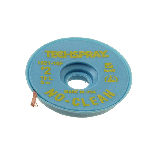

Rev. B (9/21) Page 1 of 1 No-Clean Desoldering Braid Product# 1814-1825 Product Description Techspray® No-Clean wick does not leave behind ionic flux residues that can collect and form branches called “dendrites”. Other fluxes, if not cleaned properly, can cause dendrites that grow over time and eventually cause short circuits between traces or leads. Latent failures lead to costly returns and lower the quality perception of your products. Available in anti-static spools (marked with "AS" below) to prevent static build-up from damaging sensitive components. Specifications: Meets or Exceeds MIL-F-14256; NASA NHB 5300, 4 (34-1); NASA NPC 200-4; NASA SP5002; 1821:HP 8690-0588; 1823: HP 86900577; IPC Standard-J-STD-004 Size chart: Braid # #1 #2 #3 #4 #5 #6 Color Code White Yellow Green Blue Brown Red Width (in) 0.035 0.055 0.075 0.098 0.130 0.193 Width (mm) 0.9 1.4 1.9 2.5 3.3 4.9 Features / Benefits • No-clean flux coated braid • Cleanest wick - clear, non-reactive residues • Will not leave ionic residue -- avoid dendrite failure • Exceeds MIL-F-14256 Environmental Policy Techspray® is committed to developing products to ensure a safer and cleaner environment. We will continue to meet and sustain the regulations of all federal, state and local government agencies. Resources Techspray® products are supported by global sales, technical and customer services resources. For additional technical information on this product or other Techspray® products in the United States, call the technical sales department at 800-8584043, email tsales@techspray.com or visit our web site at: www.techspray.com. Packaging and Availability Part# 1820-5F 1820-10F 1820-50F 1814-100F Size# #1 #1 #1 #1 Size Color White White White White Length ESD-safe Bobbin 5ft (1.5M) Yes 10ft (3M) Yes 50ft (15.2M) Yes 100ft (30.5M) No 1821-5F 1821-10F 1821-25F 1821-50F 1815-100F #2 #2 #2 #2 #2 Yellow Yellow Yellow Yellow Yellow 5ft (1.5M) 10ft (3M) 25ft (7.6M) 50ft (15.2M) 100ft (30.5M) Yes Yes Yes Yes No 1822-5F 1822-10F 1822-50F 1822-100F #3 #3 #3 #3 Green Green Green Green 5ft (1.5M) 10ft (3M) 50ft (15.2M) 100ft (30.5M) Yes Yes Yes Yes 1823-5F 1823-10F 1823-25F 1823-100F #4 #4 #4 #4 Blue Blue Blue Blue 5ft (1.5M) 10ft (3M) 25ft (7.6M) 100ft (30.5M) Yes Yes Yes Yes 1824-5F 1824-25F #5 #5 Brown Brown 5ft (1.5M) 25ft (7.6M) Yes Yes 1825-5F #6 Red 5ft (1.5M) Yes Important Notice to Purchaser/User: The information in this publication is based on tests that we believe are reliable. The results may vary due to differences in tests type and conditions. We recommend that each user evaluate the product to determine its suitability for the intended application. Conditions of use are outside our control and vary widely. Techspray’s only obligation and your only solution is replacement of product that is shown to be defective when you receive it. In no case will Techspray® be liable for any special, incidental, or consequential damages based on breach of warranty, negligence or any other theory. North America Techspray® 8125 Cobb Center Drive Kennesaw, GA 30152 800-858-4043 tsales@techspray.com Europe ITW Contamination Control BV Saffierlaan 5, 2132 VZ Hoofddorp The Netherlands +31 88 1307 400 info@itw-cc.com Countries outside the US Call to locate a distributor in your country
