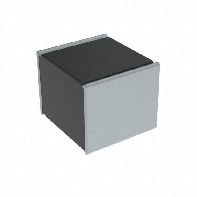

D WIMA SMD-PET Metallized Polyester (PET) SMD Film Capacitors with Box Encapsulation. Capacitances from 0.01 mF to 6.8 mF. Rated Voltages from 63 VDC to 1000 VDC. Size Codes from 1812 to 6054. Special Features Electrical Data ˜ Size codes 1812, 2220, 2824, 4030, 5040 and 6054 with PET and encapsulated ˜ Operating temperature up to 125° C ˜ Self-healing ˜ Suitable for lead-free soldering ˜ According to RoHS 2011/65/EU Typical Applications For general DC-applications e.g. ˜ By-pass ˜ Blocking ˜ Coupling and decoupling ˜ Timing Construction Capacitance range: 0.01 mF to 6.8 mF Rated voltages: 63 VDC, 100 VDC, 250 VDC, 400 VDC, 630 VDC, 1000 VDC Capacitance tolerances: ±20%, ±10% (±5% available subject to special enquiry) Operating temperature range: –55+ C to +125+ C Climatic test category: 55/100/21 according to IEC for size codes 1812 to 2824 55/100/56 according to IEC for size codes 4030 to 6054 Insulation resistance at +20+ C: Test voltage: 1.6 Ur, 2 sec. Voltage derating: A voltage derating factor of 1.25 % per K must be applied from +85) C for DC voltages and from +75) C for AC voltages Reliability: Operational life  300 000 hours (+125° C permitted for 1000 hours max. distributed over the entire operating life) Failure rate  2 fit (0.5 x U r and 40+ C) U r Utest C  0.33 mF 0.33 mF < C T 6.8 mF Dielectric: Polyethylene-terephthalate (PET) film Capacitor electrodes: Vacuum-deposited Internal construction:   63 VDC   50 V 100 VDC 100 V  3.75 x 103 M¸  1250 sec (M¸ x mF) U 250 VDC 100 V  1 x 10 4 M¸  3000 sec (M¸ x mF) Measuring time: 1 min. Dissipation factors at +20) C: tan d Plastic film Vacuum-deposited electrode Metal contact layer (schoopage) Terminating plate Encapsulation: Solvent-resistant, flame-retardant plastic case, UL 94 V-0 Terminations: Tinned plates. Marking: Box colour: Black. at f   1 kHz   10 kHz 100 kHz C  0.1 mF 0.1 mF < C T 1.0 mF C > 1.0 mF    8 x 10 -3    8 x 10 -3  10 x 10 -3  15 x 10 -3  15 x 10 -3 –  30 x 10 -3 – – Maximum pulse rise time: Capacitance max. pulse rise time V/ msec mF 63 VDC 100 VDC 250 VDC 400 VDC 630 VDC 1000 VDC 0.01  ... 0.022 30 35 40 35 40 50 0.033 ... 0.068 20 20 40 21 25 32 0.1   ... 0.22  10 10 12 14 17 – 0.33  ... 0.68  8 6 9 10 – – 1.0   ... 2.2   3.5 4 7 – – – 3.3   ... 6.8   3 3 – – – – Dip Solder Test/Processing Available taped and reeled in blister pack. Detailed taping information and graphs at the end of the catalogue. For further details and graphs please refer to Technical Information. 06.21 Resistance to soldering heat: Test Tb in accordance with DIN IEC 60068-2-58/DIN EN 60384-19. Soldering bath temperature max. 260+ C. Soldering duration max. 5 sec. Change in capacitance DC/C  5 %. Soldering process: Re-flow soldering (see temperature/time graphs page 13). Packing 17 D WIMA SMD-PET Continuation General Data 63 VDC/40 VAC* 100 VDC/63 VAC* Capacitance Size H Size H Part number Part number code ± 0.3 code ± 0.3 0.01  mF 1812 3.0 SMDTC02100KA00_ _ _ _ 1812 3.0 SMDTD02100KA00_ _ _ _ 2220 3.5 SMDTC02100QA00_ _ _ _ 2220 3.5 SMDTD02100QA00_ _ _ _ 2824 3.0 SMDTC02100TA00_ _ _ _ 2824 3.0 SMDTD02100TA00_ _ _ _ 0.015 „ 1812 3.0 SMDTC02150KA00_ _ _ _ 1812 3.0 SMDTD02150KA00_ _ _ _ 2220 3.5 SMDTC02150QA00_ _ _ _ 2220 3.5 SMDTD02150QA00_ _ _ _ 2824 3.0 SMDTC02150TA00_ _ _ _ 2824 3.0 SMDTD02150TA00_ _ _ _ 0.022 „ 1812 3.0 SMDTC02220KA00_ _ _ _ 1812 3.0 SMDTD02220KA00_ _ _ _ 2220 3.5 SMDTC02220QA00_ _ _ _ 2220 3.5 SMDTD02220QA00_ _ _ _ 2824 3.0 SMDTC02220TA00_ _ _ _ 2824 3.0 SMDTD02220TA00_ _ _ _ 0.033 „ 1812 3.0 SMDTC02330KA00_ _ _ _ 1812 3.0 SMDTD02330KA00_ _ _ _ 2220 3.5 SMDTC02330QA00_ _ _ _ 2220 3.5 SMDTD02330QA00_ _ _ _ 2824 3.0 SMDTC02330TA00_ _ _ _ 2824 3.0 SMDTD02330TA00_ _ _ _ 0.047 „ 1812 3.0 SMDTC02470KA00_ _ _ _ 1812 3.0 SMDTD02470KA00_ _ _ _ 2220 3.5 SMDTC02470QA00_ _ _ _ 2220 3.5 SMDTD02470QA00_ _ _ _ 2824 3.0 SMDTC02470TA00_ _ _ _ 2824 3.0 SMDTD02470TA00_ _ _ _ 0.068 „ 1812 3.0 SMDTC02680KA00_ _ _ _ 1812 3.0 SMDTD02680KA00_ _ _ _ 2220 3.5 SMDTC02680QA00_ _ _ _ 2220 3.5 SMDTD02680QA00_ _ _ _ 2824 3.0 SMDTC02680TA00_ _ _ _ 2824 3.0 SMDTD02680TA00_ _ _ _ 0.1   mF 1812  4.0* SMDTC03100KB00_ _ _ _ 1812   4.0* SMDTD03100KB00_ _ _ _ 2220 3.5 SMDTC03100QA00_ _ _ _ 2220 3.5 SMDTD03100QA00_ _ _ _ 2824 3.0 SMDTC03100TA00_ _ _ _ 2824 3.0 SMDTD03100TA00_ _ _ _ 0.15  „ 1812  4.0* SMDTC03150KB00_ _ _ _ 1812 4.0 SMDTD03150KB00_ _ _ _ 2220 3.5 SMDTC03150QA00_ _ _ _ 2220 3.5 SMDTD03150QA00_ _ _ _ 2824 3.0 SMDTC03150TA00_ _ _ _ 2824 3.0 SMDTD03150TA00_ _ _ _ 0.22  „ 1812  4.0* SMDTC03220KB00_ _ _ _ 1812 4.0 SMDTD03220KB00_ _ _ _ 2220 3.5 SMDTC03220QA00_ _ _ _ 2220 3.5 SMDTD03220QA00_ _ _ _ 2824 3.0 SMDTC03220TA00_ _ _ _ 2824 3.0 SMDTD03220TA00_ _ _ _ 0.33  „ 1812 4.0 SMDTC03330KB00_ _ _ _ 2220 4.5 SMDTD03330QB00_ _ _ _ 2220  4.5* SMDTC03330QB00_ _ _ _ 2824 5.0 SMDTD03330TB00_ _ _ _ 2824  5.0* SMDTC03330TB00_ _ _ _ 4030 5.0 SMDTD03330VA00_ _ _ _ 0.47  „ 1812 4.0 SMDTC03470KB00_ _ _ _ 2220 4.5 SMDTD03470QB00_ _ _ _ 2220  4.5* SMDTC03470QB00_ _ _ _ 2824 5.0 SMDTD03470TB00_ _ _ _ 2824  5.0* SMDTC03470TB00_ _ _ _ 4030 5.0 SMDTD03470VA00_ _ _ _ 0.68  „ 2220 4.5 SMDTC03680QB00_ _ _ _ 2824 5.0 SMDTD03680TB00_ _ _ _ 2824  5.0* SMDTC03680TB00_ _ _ _ 4030 5.0 SMDTD03680VA00_ _ _ _ 4030 5.0 SMDTC03680VA00_ _ _ _ 5040 6.0 SMDTD03680XA00_ _ _ _ 1.0   mF 2220 4.5 SMDTC04100QB00_ _ _ _ 2824 5.0 SMDTD04100TB00_ _ _ _ 2824  5.0* SMDTC04100TB00_ _ _ _ 4030 5.0 SMDTD04100VA00_ _ _ _ 4030 5.0 SMDTC04100VA00_ _ _ _ 5040 6.0 SMDTD04100XA00_ _ _ _ 1.5   „ 2824 5.0 SMDTC04150TB00_ _ _ _ 4030 5.0 SMDTD04150VA00_ _ _ _ 4030 5.0 SMDTC04150VA00_ _ _ _ 5040 6.0 SMDTD04150XA00_ _ _ _ 2.2   „ 2824 5.0 SMDTC04220TB00_ _ _ _ 5040 6.0 SMDTD04220XA00_ _ _ _ 4030 5.0 SMDTC04220VA00_ _ _ _ 3.3   „ 4030 5.0 SMDTC04330VA00_ _ _ _ 5040 6.0 SMDTD04330XA00_ _ _ _ 4.7   „ 5040 6.0 SMDTC04470XA00_ _ _ _ 6054 7.0 SMDTD04470YA00_ _ _ _ 6.8   „ 6054 7.0 SMDTC04680YA00_ _ _ _ 250 VDC/160 VAC* Size H Part number code ± 0.3 2220 3.5 SMDTF02100QA00_ _ _ _ 2824 3.0 SMDTF02100TA00_ _ _ _ 2220 2824 3.5 SMDTF02150QA00_ _ _ _ 3.0 SMDTF02150TA00_ _ _ _ 2220 2824 3.5 SMDTF02220QA00_ _ _ _ 3.0 SMDTF02220TA00_ _ _ _ 2220 3.5 2824 3.0 4030 5.0 2220 3.5 2824 3.0 4030 5.0 2220   4.5* 2824 3.0 4030 5.0 2220   4.5* 2824 5.0 4030 5.0 2824 5.0 4030 5.0 SMDTF02330QA00_ _ _ _ SMDTF02330TA00_ _ _ _ SMDTF02330VA00_ _ _ _ SMDTF02470QA00_ _ _ _ SMDTF02470TA00_ _ _ _ SMDTF02470VA00_ _ _ _ SMDTF02680QB00_ _ _ _ SMDTF02680TA00_ _ _ _ SMDTF02680VA00_ _ _ _ SMDTF03100QB00_ _ _ _ SMDTF03100TB00_ _ _ _ SMDTF03100VA00_ _ _ _ SMDTF03150TB00_ _ _ _ SMDTF03150VA00_ _ _ _ 2824 4030 5.0 SMDTF03220TB00_ _ _ _ 5.0 SMDTF03220VA00_ _ _ _ 2824 4030 5040 4030 5040 5.0 5.0 6.0 5.0 6.0 5040 6.0 SMDTF03680XA00_ _ _ _ 6054 7.0 SMDTF04100YA00_ _ _ _ SMDTF03330TB00_ _ _ _ SMDTF03330VA00_ _ _ _ SMDTF03330XA00_ _ _ _ SMDTF03470VA00_ _ _ _ SMDTF03470XA00_ _ _ _ * Version according to catalogue 2013 still available Part number completion: Tolerance: 20 % = M 10 % = K   5 % = J Packing: bulk = S Pin length: none = 00 Taped version see page 160. * AC voltage: f = 50 Hz; 1.4 x Urms + UDC  Ur 06.21 Dims. in mm. Rights reserved to amend design data without prior notification. 18 Continuation page 19 D WIMA SMD-PET Continuation General Data 400 VDC/200 VAC* 630 VDC/300 VAC* 1000 VDC/400 VAC* Capacitance Size H Size H Size H Part number Part number Part number code ± 0.3 code ± 0.3 code ± 0.3 0.01  mF 2824 3.0 SMDTG02100TA00_ _ _ _ 4030 5.0 SMDTJ02100VA00_ _ _ _ 4030 5.0 SMDTG02100VA00_ _ _ _ 0.015 „ 2824 3.0 SMDTG02150TA00_ _ _ _ 4030 5.0 SMDTJ02150VA00_ _ _ _ 5040 6.0 SMDTO12150XA00_ _ _ _ 4030 5.0 SMDTG02150VA00_ _ _ _ 0.022 „ 2824  5.0* SMDTG02220TB00_ _ _ _ 5040 6.0 SMDTJ02220XA00_ _ _ _ 5040 6.0 SMDTO12220XA00_ _ _ _ 4030 5.0 SMDTG02220VA00_ _ _ _ 0.033 „ 2824 5.0 SMDTG02330TB00_ _ _ _ 5040 6.0 SMDTJ02330XA00_ _ _ _ 5040 6.0 SMDTO12330XA00_ _ _ _ 4030 5.0 SMDTG02330VA00_ _ _ _ 0.047 „ 2824 5.0 SMDTG02470TB00_ _ _ _ 5040 6.0 SMDTJ02470XA00_ _ _ _ 6054 7.0 SMDTO12470YA00_ _ _ _ 4030 5.0 SMDTG02470VA00_ _ _ _ 0.068 „ 4030 5.0 SMDTG02680VA00_ _ _ _ 5040 6.0 SMDTJ02680XA00_ _ _ _ 5040 6.0 SMDTG02680XA00_ _ _ _ 0.1   mF 4030 5.0 SMDTG03100VA00_ _ _ _ 6054 7.0 SMDTJ03100YA00_ _ _ _ 5040 6.0 SMDTG03100XA00_ _ _ _ 0.15  „ 4030 5.0 SMDTG03150VA00_ _ _ _ 6054 7.0 SMDTJ03150YA00_ _ _ _ 5040 6.0 SMDTG03150XA00_ _ _ _ 0.22  „ 5040 6.0 SMDTG03220XA00_ _ _ _ 6054 7.0 SMDTJ03220YA00_ _ _ _ 0.33  „ 5040 6.0 SMDTG03330XA00_ _ _ _ 0.47  „ 6054 7.0 SMDTG03470YA00_ _ _ _ * AC voltage: f = 50 Hz; 1.4 x Urms + UDC  Ur * Version according to catalogue 2013 still available Solder pad recommendation W b H Part number completion: Tolerance: 20 % = M 10 % = K   5 % = J Packing: bulk = S Pin length: none = 00 a d Dims. in mm. L c d Taped version see page 160. Bonding slit Size L W d a b c code ±0.3 ±0.3 min. min. max. 06.21 1812  4.8  3.3 0.5 2220  5.7  5.1 0.5 2824  7.2  6.1 0.5 4030 10.2  7.6 0.5 5040 12.7 10.2 0.7 6054 15.3 13.7 0.7 1.2 1.2 1.2 2.5 2.5 2.5 3.5  3.5 4    4.5 4    6.5 6    9 6   11.5 6   14 Rights reserved to amend design data without prior notification. 19 WIMA SMD-PET D Continuation Impedance change with frequency (general guide). 07.21 Permissible AC voltage in relation to frequency at 10) C internal temperature rise (general guide). 19a D Recommendation for Processing and Application of SMD Capacitors Layout Form Soldering Process The components can generally be positioned on the carrier material as desired. In order to prevent soldering shadows or ensure regular temperature distribution, extreme concentration of the components should be avoided. In practice, it has proven best to keep a minimum distance of the soldering surfaces between two WIMA SMDs of twice the height of the components. Re-flow soldering Solder Pad Recommendation W b H a d c L d Bonding slit Size code 1812 2220 2824 4030 5040 6054 L ± 0.3 4.8 5.7 7.2 10.2 12.7 15.3 W ± 0.3 3.3 5.1 6.1 7.6 10.2 13.7 d 0.5 0.5 0.5 0.5 0.7  0.7 a b c min. min. max. 1.2 3.5 3.5 1.2 4 4.5 1.2 4 6.5 2.5 6 9 2.5 6 11.5 2.5 6 14 The solder pad size recommendations given for each individual series are to be understood as minimum dimensions which can at any time be adjusted to the layout form. Processing The processing of SMD components – assembling – soldering – electrical final inspection/calibrating Due to versatile procedures exact processing parameters for re-flow soldering processes cannot be specified. The graph depicted is to be understood as a recommendation to help establishing a suitable soldering profile fulfilling the requirements in practice at the user. During processing a max. temperature of T=210° C inside the component should not be exceeded. Due to the differing heat absorption the length of the soldering process should be kept as short as possible for smaller size codes. SMD Handsoldering WIMA SMD capacitors with plastic film dielectric are generally suitable for hand-soldering, e. g. for lab purposes, with a soldering iron where, however, similar to automated soldering processes, a certain duration and temperature should not be exceeded. These parameters are dependent on the physical size of the components and the relevant heat absorption involved. Size code 1812 2220 2824 4030 5040 6054 Temperature ° C / ° F 250 / 482 250 / 482 260 / 500 260 / 500 260 / 500 260 / 500 The below data are to be regarded as guideline values and should serve to avoid damage to the dielectric caused by excessive heat during the soldering process. The soldering quality depends on the tool used and on the skill and experience of the person with the soldering iron in hand. Time duration 2 sec plate 1 3 sec plate 1 3 sec plate 1 5 sec plate 1 5 sec plate 1 5 sec plate 1 / / / / / / 5 5 5 5 5 5 sec sec sec sec sec sec off off off off off off / / / / / / 2 3 3 5 5 5 sec sec sec sec sec sec plate plate plate plate plate plate 2 2 2 2 2 2 06.21 must be regarded as a complete process. The soldering of the printed circuit board, for example, can constitute considerable stress on all the electronic components. The manufacturer‘s instructions on the processing of the components are mandatory. Temperature/time graph for the permissible processing temperature of the WIMA SMD film capacitor for typical convection soldering processes. 13 D Recommendation for Processing and Application of SMD Capacitors (Continuation) Solder Paste To achieve reliable soldering results one of the following solder alloys have from case to case proven being workable: Lead free solder paste Sn - Bi Sn - Zn (Bi) Sn - Ag - Cu (suitable for SMD-PET 5040/ 6054, SMD-PEN and SMD-PPS) Solder paste with lead Sn - Pb - Ag (Sn60-Pb40-A, Sn63-Pb37-A) Washing WIMA SMD components with plastic encapsulation - like all other components of similar construction irrespective of the make - cannot be regarded as hermetically sealed. Due to today’s common washing substances, e. g. on aqueous basis instead of the formerly used halogenated hydrocarbons, with enhanced washing efficiency it became obvious that assembled SMD capacitors may show an impermissibly high deviation of the electrical parameters after a corresponding washing process. Hence it is recommended to refrain from applying industrial washing processes for WIMA SMD capacitors in order to avoid possible damages. Initial Operation/Calibration Due to the stress which the components are subjected to during processing, reversible parameter changes occur in almost all electronic components. The capacitance recovery accuracy to be expected with careful processing is within a scope of advisable to prolong the storage time to number of other outstanding qualities: t U 10 days ” favourable pulse rise time ” low ESR ” low dielectric absorption ” available in high voltage series ” large capacitance spectrum ” stand up to high mechanical stress ” good long-term stability In this way ageing effects of the capacitor structure can be anticipated. Parameter changes due to processing are not to be expected after this period of time Humidity Protection Bags Taped WIMA SMD capacitors are shipped in humidity protection bags according to JEDEC standard (ESD/EMI-shield/watervapour proof). Under controlled conditions the components can be stored two years and more in the originally sealed bag. Opened packing units should immediately be used up for processing. If storage is necessary the opened packing units should be stored air-tight in the original plastic bag. Reliability Taking account of the manufacturer‘s guidelines and compatible processing, the WIMA SMD stand out for the same high quality and reliability as the analogous through-hole WIMA series. The technology of metallized film capacitors used e.g. in WIMA SMD-PET achieves the best values for all fields of application. The expected value is about: Û0 T 2 fit As regards technical performance as well as quality and reliability, the WIMA SMD series offer the possibility to cover nearly all applications of conventionally through-hole film capacitors with SMD components. Furthermore, the WIMA SMD series can now be used for all the demanding capacitor applications for which, in the past, the use of through-hole components was mandatory: ” measuring techniques ” oscillator circuits ” differentiating and integrating circuits ” A/D or D/A transformers ” sample and hold circuits ” automotive electronics With the WIMA SMD programme available today, the major part of all plastic film capacitors can be replaced by WIMA SMD components. The field of application ranges from standard coupling capacitors to use in switch-mode power supplies as filter or charging capacitors with high voltage and capacitance values, as well as in telecommunications e.g. the well-known telephone capacitor 1mF/250VDC. Furthermore the production of all WIMA components is subject to the regulations laid down by ISO 9001:2015 as well as the guidelines for component specifications set out by IEC quality assessment system (IECQ) for electronic components. DC/CT 5 %. For the initial operation of the device a minimum storage time of t U 24 hours Basically the WIMA SMD series have the same electrical characteristics as the analogous through-hole WIMA capacitors. Compared to ceramic or tantalum dielectrics WIMA SMD capacitors have a 06.21 is to be taken into account. With calibrated devices or when the application is largely dependent on capacitance it is Electrical Characteristics and Fields of Application 14 D Blister Tape Packaging and Packing Units of the WIMA SMD Capacitors Tape reel: Tape advance and return: +2 W1 - 0 10 - 20 empty compartments 180/330 +0 -2 N1.5 130.5 Cover film advance Tape advance Tape return 10 - 20 empty compartments min. 200 mm Unwinding direction All dims. in mm. G W2 max. E F W B1 B0 T W0 A1 A0 P P0 P2 D0 D1 P P 0* K Type W2max W1± 20 N ±1.5 1812 19 12.4 62 2220 19 12.4 62 2824 19 12.4 62 4030 22.4 16.4 60 5040 30.4 24.4 90 6054 30.4 24.4 90 Packing units Size Code 1812 A0 ± 0.1 A1 B0 ± 0.1 B1 D0 + 0.1 -0 D1 + 0.1 -0 ± 0.1 P2 E F G ± 0.1 ± 0.05 ± 0.1 ± 0.05 W W0 K T ± 0.3 ± 0.2 ± 0.1 ± 0.1 taped taped Reel Reel 180 mm P 330 mm P bulk Standard Box size Code 4.8 x 3.3 x 3 KA 3.55 3.3 5.1 4.8 P1.5 P1.5 8 4 2 1.75 5.5 2.2 12 9.5 3.4 0.3 700 2500 3000 4.8 x 3.3 x 4 KB 3.55 3.3 5.1 4.8 P1.5 P1.5 8 4 2 1.75 5.5 2.2 12 9.5 4.4 0.3 500 2000 3000 A1 B0 ± 0.1 B1 P 0* P 2 E F ± 0.1 ± 0.05 ± 0.1 ± 0.05 G Size Code 2220 A 0 ± 0.1 Box size Code D0 + 0.1 -0 D1 + 0.1 -0 P ± 0.1 W W0 K T ± 0.3 ± 0.2 ± 0.1 ± 0.1 taped taped Reel Reel 180 mm P 330 mm P bulk Standard 5.7 x 5.1 x 3.5 QA 6.3 5.7 5.6 5.1 P1.5 P1.5 8 4 2 1.75 5.5 1.95 12 9.5 3.7 0.3 500 1800 3000 5.7 x 5.1 x 4.5 QB 6.3 5.7 5.6 5.1 P1.5 P1.5 8 4 2 1.75 5.5 1.95 12 9.5 4.7 0.3 400 1500 3000 Size Code 2824 A 0 A1 B0 ± 0.1 B1 ± 0.1 D0 + 0.1 -0 D1 + 0.1 -0 P ± 0.1 P 0* P 2 E F ± 0.1 ± 0.05 ± 0.1 ± 0.05 G W W0 K T ± 0.3 ± 0.2 ± 0.1 ± 0.1 taped Reel 330 mm P Standard bulk Box size Code 7.2 x 6.1 x 3 TA 6.6 6.1 7.7 7.2 P1.5 P1.5 12 4 2 1.75 5.5 0.9 12 9.5 3.4 0.3 1500 2000 7.2 x 6.1 x 5 TB 6.6 6.1 7.7 7.2 P1.5 P1.5 12 4 2 1.75 5.5 0.9 12 9.5 5.4 0.4 750 2000 taped Reel 330 mm P bulk Standard 775 2000 Code A0 ± 0.1 A1 B0 ± 0.1 B1 D0 D1 P P 0* P 2 E F + 0.1 + 0.1 ± 0.1 ± 0.1 ± 0.05 ± 0.1 ± 0.05 -0 -0 Size Code 4030 VA 10.7 10.2  8.1  9.1 P1.5 P1.5 16 4 2 G W W0 K T ± 0.3 ± 0.2 ± 0.1 ± 0.1 1.75  7.5 1.9   16 13.3 5.5 0.3 Size Code 5040 XA 13.5 12.7 11 11.5 P1.5 P1.5 16 4 2 1.75 11.5 4.7 24 21.3 6.5 0.3 600 1000 Size Code 6054 4 2 1.75 11.5 2.95 24 21.3 7.5 0.3 450  500 YA 17.0 16.5 15.6 15.0 P1.5 P1.5 20 * cumulative after 10 steps p 0.2 mm max. Samples and pre-production needs on request or 1 Reel minimum. Part number codes for SMD packing W (Blister) P in mm Code 12 180 P 12 330 Q 16 330 R 24 330 T S 06.21 Bulk Standard 160 D WIMA Part Number System A WIMA part number consists of 18 digits and is composed as follows: Field   1 -   4: Type description Field   5 -   6: Rated voltage Field   7 - 10: Capacitance Field 11 - 12: Size and PCM Field 13 - 14: Version code (e.g. Snubber versions) Field 15: Capacitance tolerance Field 16: Packing Field 17 - 18: Pin length (untaped) 1 2 3 4 5 6 7 8 9 10 11 12 13 14 15 16 17 18 M K S 2 C 0 2 1 0 0 1 A 0 0 M S S D 20 % bulk MKS 2 06.21 Type description: SMD-PET = SMDT SMD-PEN = SMDN SMD-PPS = SMDI FKP 02 = FKP0 MKS 02 = MKS0 FKS 2 = FKS2 FKP 2 = FKP2 FKS 3 = FKS3 FKP 3 = FKP 3 MKS 2 = MKS2 MKP 2 = MKP2 MKS 4 = MKS4 MKP 4 = MKP4 MKP 10 = MKP1 FKP 4 = FKP4 FKP 1 = FKP1 MKP-X2 = MKX2 MKP-X1 R = MKX1 MKP-Y2 = MKY2 MP 3-X2 = MPX2 MP 3-X1 = MPX1 MP 3-Y2 = MPY2 MP 3R-Y2 = MPRY MKP 4F = MKPF Snubber MKP = SNMP Snubber FKP = SNFP GTO MKP = GTOM DC-LINK MKP 4 = DCP4 DC-LINK MKP 6 = DCP6 DC-LINK HC = DCHC 63 VDC Rated voltage: 50 VDC = B0 63 VDC = C0 100 VDC = D0 250 VDC = F0 400 VDC = G0 450 VDC = H0 520 VDC = H2 600 VDC = I0 630 VDC = J0 700 VDC = K0 800 VDC = L0 850 VDC = M0 900 VDC = N0 1000 VDC = O1 1100 VDC = P0 1200 VDC = Q0 1250 VDC = R0 1500 VDC = S0 1600 VDC = T0 1700 VDC = TA 2000 VDC = U0 2500 VDC = V0 3000 VDC = W0 4000 VDC = X0 6000 VDC = Y0 250 VAC = 0W 275 VAC = 1W 300 VAC = 2W 305 VAC = AW 350 VAC = BW 440 VAC = 4W 500 VAC = 5W ... 0.01 mF Capacitance: 22 pF = 0022 47 pF = 0047 100 pF = 0100 150 pF = 0150 220 pF = 0220 330 pF = 0330 470 pF = 0470 680 pF = 0680 1000 pF = 1100 1500 pF = 1150 2200 pF = 1220 3300 pF = 1330 4700 pF = 1470 6800 pF = 1680 0.01 mF = 2100 0.022 mF = 2220 0.047 mF = 2470 0.1 mF = 3100 0.22 mF = 3220 0.47 mF = 3470 = 4100 1 mF 2.2 mF = 4220 4.7 mF = 4470 = 5100 10 mF = 5220 22 mF = 5470 47 mF 100 mF = 6100 220 mF = 6220 1000 mF = 7100 1500 mF = 7150 ... 2.5 x 6.5 x 7.2 - Size: 4.8 x 3.3 x 3 Size 1812 = KA 4.8 x 3.3 x 4 Size 1812 = KB 5.7 x 5.1 x 3.5 Size 2220 = QA 5.7 x 5.1 x 4.5 Size 2220 = QB 7.2 x 6.1 x 3 Size 2824 = TA 7.2 x 6.1 x 5 Size 2824 = TB 10.2 x 7.6 x 5 Size 4030 = VA 12.7 x 10.2 x 6 Size 5040 = XA 15.3 x 13.7 x 7 Size 6054 = YA 2.5 x 7 x 4.6 PCM 2.5 = 0B 3 x 7.5 x 4.6 PCM 2.5 = 0C 2.5 x 6.5 x 7.2 PCM 5 = 1A 3 x 7.5 x 7.2 PCM 5 = 1B 2.5 x 7 x 10 PCM 7.5 = 2A 3 x 8.5 x 10 PCM 7.5 = 2B 3 x 9 x 13 PCM 10 = 3A 4 x 9 x 13 PCM 10 = 3C 5 x 11 x 18 PCM 15 = 4B 6 x 12.5 x 18 PCM 15 = 4C 5 x 14 x 26.5 PCM 22.5 = 5A 6 x 15 x 26.5 PCM 22.5 = 5B 9 x 19 x 31.5 PCM 27.5 = 6A 11 x21 x 31.5 PCM 27.5 = 6B 9 x 19 x 41.5 PCM 37.5 = 7A 11 x 22 x 41.5 PCM 37.5 = 7B 19 x 31 x 56 PCM 48.5 = 8D 25 x 45 x 57 PCM 52.5 = 9D ... Version code: Standard = Version A1 = Version A1.1.1 = Version A2 = ... 00 1A 1B 2A Tolerance: ±20 % = ±10 % = ±5 % = ±2.5 % = ±1 % = ... 6 -2 M K J H E Packing: AMMO H16.5 340 x 340 AMMO H16.5 490 x 370 AMMO H18.5 340 x 340 AMMO H18.5 490 x 370 REEL H16.5 360 REEL H16.5 500 REEL H18.5 360 REEL H18.5 500 ROLL H16.5 ROLL H18.5 BLISTER W12 180 BLISTER W12 330 BLISTER W16 330 BLISTER W24 330 Bulk/TPS Standard ... =A =B =C =D =F =H =I =J =N =O =P =Q =R =T =S Pin length (untaped) 3.5 ±0.5 = C9 6 -2 = SD 16 ±1 = P1 ... Pin length (taped) none = 00 The data on this page is not complete and serves only to explain the part number system. Part number information is listed on the pages of the respective WIMA range. 159
