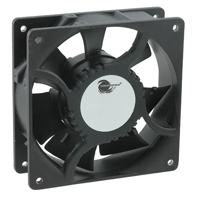

Comair Rotron Specification Sheet Specification Date: Dec 12, 2017 Version:02 COMAIR ROTRON PART NUMBER: COMAIR ROTRON MODEL NUMBER: 17000538A CREC12038-3600 A.) MOTOR: RATED VOLTAGE: 100~240VAC±10% OPERATING VOLTAGE RANGE: 90~264VAC LOW-START VOLTAGE: 80VAC RUNNING CURRENT: 0.12~0.31 Amps OPERATING FREGUENCY: 50~60Hz INPUT POWER: 17 Watts NOMINAL SPEED: 3,600 RPM 5% (At Free Delivery) MOTOR TYPE: Brushless EC MOTOR PROTECTION: By Integrated Circuit LOCKED ROTORT PROTECTION: IC protected POLARITY PROTECTION: Yes AUTOMATIC RESTART CAPABILITY: By Integrated Circuit ROTATION: Counter Clockwise when viewed from the impeller B.) MECHANICAL DIMENSIONS: 120mm x120mm x 38mm WEIGHT: 490g BEARING TYPE: Permanently Lubricated Ball Bearings VENTURI: Die Cast magnesium alloy, ED coating and powder coating PROPELLER: Die Cast magnesium alloy, ED coating and powder coating -1- Comair Rotron Specification Sheet Specification Date: Dec 12, 2017 Version:02 Figure 1 C.) ENVIRONMENTAL OPERATING TEMPERATURE: -20C to +70C STORAGE TEMPERATURE: The storage temperature will be suggested at -20℃ ~ 50℃ to ensure a better performance. HUMIDITY: 20 to 85% RH, non-condensing -2- Comair Rotron Specification Sheet Specification Date: Dec 12, 2017 Version:02 D.) PERFORMANCE CHARACTERISTICS AIR FLOW: 144 CFM  5% (Measuring at zero static pressure) STATIC PRESSURE: 0.46” Inches of H20 (Measuring at zero airflow) ACOUSTIC LEVEL: 60 dBA Max. at MAX. speed (Measured via Freely Suspended at 1 meter ) -3- Comair Rotron Specification Sheet Specification Date: Dec 12, 2017 Version:02 E.) TERMINATION Joint terminal: suit with 0.5×3×7mm PIN F.) RELIABILITY Bearing type Ball bearing Temperature 20℃ Hours 60,000 40℃ 50,000 60℃ 40,000 90℃ 20,000 G.) SAFETY UL, CUL, CE H.) FLAMMABILITY The fan including all components meets a UL94V-0 rating or better. -4-
