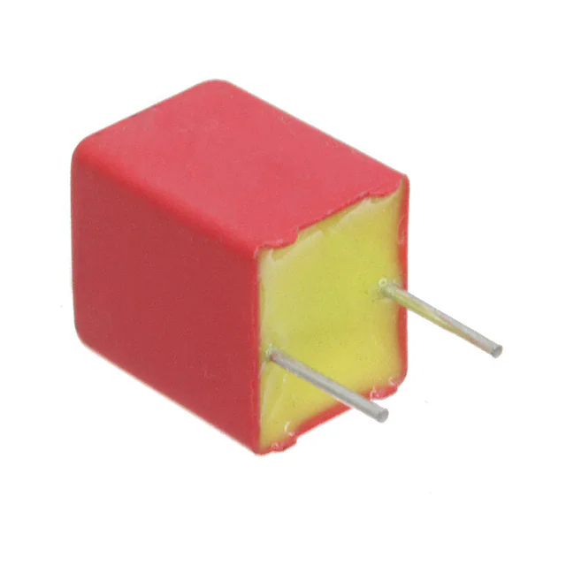

D WIMA FKP 2 Polypropylene (PP) Film/Foil Capacitors for Pulse Applications in PCM 5 mm. Capacitances from 33 pF to 0.033 mF. Rated Voltages from 63 VDC to 1000 VDC. Special Features Electrical Data ˜ Pulse duty construction ˜ Close tolerances up to ±2.5 % (±1 % on request) ˜ Very low dissipation factor ˜ Negative capacitance change versus temperature ˜ Very low dielectric absorption ˜ According to RoHS 2011/65/EU Typical Applications For high frequency applications e.g. ˜ Sample and hold ˜ Timing ˜ LC-Filtering ˜ Oscillating circuits ˜ Audio equipment Construction Dielectric: Polypropylene (PP) film Capacitor electrodes: Metal foil Internal construction: Capacitance range: 33 pF to 0.033 mF (E12-values on request) Rated voltages: 63 VDC, 100 VDC, 250 VDC, 400 VDC, 630 VDC, 800 VDC, 1000 VDC Capacitance tolerances: ±20%, ±10%, ±5%, ±2.5% (±2%, ±1.5% or ±1% available as precision capacitors subject to special enquiry) Operating temperature range: –55+ C to +100+ C Test specifications: In accordance with IEC 60384-13 Climatic test category: 55/100/56 in accordance with IEC Insulation resistance at +20+ C:  3 x 105 M¸ Measuring voltage: U r   =   63 V: U test =   50 V/1 min. Ur 100 V: Utest = 100 V/1 min. Dissipation factors at +20) C: tan d at f   1 kHz   10 kHz 100 kHz    1 MHz C  1000 pF      5  6  8 10 x x x x 10 -4 10 -4 10 -4 10 -4 Test voltage: 2 Ur, 2 sec. Maximum pulse rise time: 1000 V/msec Dielectric absorption: 0.05% Temperature coefficient: –200 x 10-6/+ C (typical) Voltage derating: A voltage derating factor of 1.35 % per K must be applied from +85+ C for DC voltages and from +75+ C for AC voltages Reliability: Operational life  300 000 hours Failure rate  5 fit (0.5 x Ur and 40+ C) 1000 pF < C T 4700 pF C > 4700 pF  5 x 10-4  5 x 10 -4  6 x 10-4  6 x 10 -4  8 x 10-4 – – – Plastic film Metal foil electrode Terminating wire Pull test on pins: 10 N in direction of pins according to IEC 60068-2-21 Vibration: 6 hours at 10 ... 2000 Hz and 0.75 mm displacement amplitude or 10 g in accordance with IEC 60068-2-6 Low air density: 1kPa = 10 mbar in accordance with IEC 60068-2-13 Bump test: 4000 bumps at 390 m/sec2 in accordance with IEC 60068-2-29 Packing Available taped and reeled. Detailed taping information and graphs at the end of the catalogue. For further details and graphs please refer to Technical Information. 06.21 Encapsulation: Solvent-resistant, flame-retardant plastic case with epoxy resin seal, UL 94 V-0 Terminations: Tinned wire. Marking: Colour: Red. Marking: Black. Mechanical Tests 34 D WIMA FKP 24 Continuation General Data Capacitance W H L 63 VDC/40 VAC* PCM** Part number   100   150   220   330   470   680 pF „ „ „ „ „ 4.5 4.5 4.5 4.5 4.5 4.5 6 6 6 6 6 6 7.2 7.2 7.2 7.2 7.2 7.2 5 5 5 5 5 5 FKP2C001001D00_ _ _ _ FKP2C001501D00_ _ _ _ FKP2C002201D00_ _ _ _ FKP2C003301D00_ _ _ _ FKP2C004701D00_ _ _ _ FKP2C006801D00_ _ _ _ 4.5  6   4.5  6   4.5  6   4.5  6   4.5  6   4.5  6   7.2 7.2 7.2 7.2 7.2 7.2 5 5 5 5 5 5 FKP2D001001D00_ _ _ _ FKP2D001501D00_ _ _ _ FKP2D002201D00_ _ _ _ FKP2D003301D00_ _ _ _ FKP2D004701D00_ _ _ _ FKP2D006801D00_ _ _ _ 1000 1500 2200 3300 4700 6800 pF „ „ „ „ „ 4.5 6 4.5 6 4.5  6   4.5  6   4.5  6   4.5  6   7.2 7.2 7.2 7.2 7.2 7.2 5 5 5 5 5 5 FKP2C011001D00_ _ _ _ FKP2C011501D00_ _ _ _ FKP2C012201D00_ _ _ _ FKP2C013301D00_ _ _ _ FKP2C014701D00_ _ _ _ FKP2C016801D00_ _ _ _ 4.5  6   4.5  6   4.5  6   5.5  7   5.5  7   5.5  7   7.2 7.2 7.2 7.2 7.2 7.2 5 5 5 5 5 5 FKP2D011001D00_ _ _ _ FKP2D011501D00_ _ _ _ FKP2D012201D00_ _ _ _ FKP2D013301G00_ _ _ _ FKP2D014701G00_ _ _ _ FKP2D016801G00_ _ _ _ 0.01  0.015 0.022 0.033 mF „ „ „ 5.5  7   6.5  8   7.2   8.5 8.5 10   7.2 7.2 7.2 7.2 5 5 5 5 FKP2C021001G00_ _ _ _ FKP2C021501I00_ _ _ _ FKP2C022201J00_ _ _ _ FKP2C023301L00_ _ _ _ 6.5  8   7.2 7.2  8.5 7.2 8.5 10   7.2 5 5 5 FKP2D021001I00_ _ _ _ FKP2D021501J00_ _ _ _ FKP2D022201L00_ _ _ _ 250 VDC/160 VAC* L PCM** Part number W H L 100 VDC/63 VAC* PCM** Part number Capacitance W  100  150  220  330  470  680 pF „ „ „ „ „ 4.5  6   4.5  6   4.5  6   4.5  6   4.5  6   4.5  6   7.2 7.2 7.2 7.2 7.2 7.2 5 5 5 5 5 5 FKP2F001001D00_ _ _ _ FKP2F001501D00_ _ _ _ FKP2F002201D00_ _ _ _ FKP2F003301D00_ _ _ _ FKP2F004701D00_ _ _ _ FKP2F006801D00_ _ _ _ 4.5  6   4.5  6   4.5  6   4.5  6   4.5  6   4.5  6   7.2 7.2 7.2 7.2 7.2 7.2 5 5 5 5 5 5 FKP2G001001D00_ _ _ _ FKP2G001501D00_ _ _ _ FKP2G002201D00_ _ _ _ FKP2G003301D00_ _ _ _ FKP2G004701D00_ _ _ _ FKP2G006801D00_ _ _ _ 1000 1500 2200 3300 4700 6800 pF „ „ „ „ „ 4.5  6   4.5  6   4.5  6   5.5  7   6.5  8   6.5  8   7.2 7.2 7.2 7.2 7.2 7.2 5 5 5 5 5 5 FKP2F011001D00_ _ _ _ FKP2F011501D00_ _ _ _ FKP2F012201D00_ _ _ _ FKP2F013301G00_ _ _ _ FKP2F014701I00_ _ _ _ FKP2F016801I00_ _ _ _ 4.5  6   4.5  6   4.5  6   5.5  7   6.5  8   7.2  8.5 7.2 7.2 7.2 7.2 7.2 7.2 5 5 5 5 5 5 FKP2G011001D00_ _ _ _ FKP2G011501D00_ _ _ _ FKP2G012201D00_ _ _ _ FKP2G013301G00_ _ _ _ FKP2G014701I00_ _ _ _ FKP2G016801J00_ _ _ _ 0.01  mF 0.015 „ 7.2  8.5 8.5 10   7.2 7.2 5 5 FKP2F021001J00_ _ _ _ FKP2F021501L00_ _ _ _ 8.5 7.2 5 FKP2G021001L00_ _ _ _ H W H 10   * AC voltage: f  1000 Hz; 1.4 x U rms + UDC  U r ** PCM = Printed circuit module = pin spacing. E12 values and individual values available from 27 pF up on request. W L H d = 0.5 l 6 -2 d 5 PCM at the pin exit points (± 0.5) Rights reserved to amend design data without prior notification. 400 VDC/220 VAC* PCM** Part number 10 Part number completion: Tolerance:  20 % = M  10 % = K   5 % = J 2.5 % = H   2 % = G 1.5 % = F   1 % = E Packing: bulk = S Pin length: 6-2 = SD Taped version see page 161. Z  1 7 5 3 pF 337 pF 4 -F p -100 pF -220 F p -470 pF -0 F 100 -0 p F 220 -0 p 470 µF -1 0.0 2 µF -2 0.0 3 µF -3 0.0 -- Dims. in mm. L 0.1 7 5 3 0.01 1 3 5 7 10 3 5 7 100 1000 f/MHz Impedance change with frequency (general guide). 06.21 Continuation page 36 35 D WIMA FKP 24 Continuation General Data Capacitance W 630 VDC/250 VAC* L PCM** Part number  100  150  220  330  470  680 pF „ „ „ „ „ 4.5  6   4.5  6   4.5  6   4.5  6   4.5  6   4.5  6   7.2 7.2 7.2 7.2 7.2 7.2 5 5 5 5 5 5 FKP2J001001D00_ _ _ _ FKP2J001501D00_ _ _ _ FKP2J002201D00_ _ _ _ FKP2J003301D00_ _ _ _ FKP2J004701D00_ _ _ _ FKP2J006801D00_ _ _ _ 4.5  6   4.5  6   4.5  6   4.5  6   5.5  7   5.5  7   1000 1500 2200 3300 4700 6800 pF „ „ „ „ „ 4.5  6   4.5  6   5.5  7   6.5  8   6.5  8   7.2   8.5 7.2 7.2 7.2 7.2 7.2 7.2 5 5 5 5 5 5 FKP2J011001D00_ _ _ _ FKP2J011501D00_ _ _ _ FKP2J012201G00_ _ _ _ FKP2J013301I00_ _ _ _ FKP2J014701I00_ _ _ _ FKP2J016801J00_ _ _ _ 5.5  7   7.2 5.5  7   7.2 6.5  8   7.2 7.2   8.5 7.2 8.5 10   7.2 0.01 mF 8.5 10   7.2 5 FKP2J021001L00_ _ _ _ Capacitance W H    33 pF    47 „    68 „ 4.5   6    4.5   6   4.5   6   7.2 7.2 7.2 5 5 5 FKP2O100331D00_ _ _ _ FKP2O100471D00_ _ _ _ FKP2O100681D00_ _ _ _  100  150  220  330  470  680 pF „ „ „ „ „ 4.5  6    4.5  6   4.5  6   4.5  6   5.5  7   5.5  7   7.2 7.2 7.2 7.2 7.2 7.2 5 5 5 5 5 5 FKP2O101001D00_ _ _ _ FKP2O101501D00_ _ _ _ FKP2O102201D00_ _ _ _ FKP2O103301D00_ _ _ _ FKP2O104701G00_ _ _ _ FKP2O106801G00_ _ _ _ 1000 pF 1500 „ 2200 „ 6.5  8   7.2   8.5 8.5 10   7.2 7.2 7.2 5 5 5 FKP2O111001I00_ _ _ _ FKP2O111501J00_ _ _ _ FKP2O112201L00_ _ _ _ H 1000 VDC/250 VAC* L PCM** Part number W H 800 VDC/250 VAC* L PCM** Part number 7.2 7.2 7.2 7.2 7.2 7.2 5 5 5 5 5 5 FKP2L001001D00_ _ _ _ FKP2L001501D00_ _ _ _ FKP2L002201D00_ _ _ _ FKP2L003301D00_ _ _ _ FKP2L004701G00_ _ _ _ FKP2L006801G00_ _ _ _ 5 5 5 5 5 FKP2L011001G00_ _ _ _ FKP2L011501G00_ _ _ _ FKP2L012201I00_ _ _ _ FKP2L013301J00_ _ _ _ FKP2L014701L00_ _ _ _ E12 values and individual values available from 27 pF up on request. Dims. in mm. Part number completion: Tolerance:  20 % = M  10 % = K   5 % = J 2.5 % = H   2 % = G 1.5 % = F   1 % = E Packing: bulk = S Pin length: 6-2 = SD Taped version see page 161. * AC voltage: f  1000 Hz; 1.4 x U rms + UDC  U r ** PCM = Printed circuit module = pin spacing. Rights reserved to amend design data without prior notification. Permissible AC voltage in relation to frequency at 10) C internal temperature rise (general guide). Urms V 5 22 10 0 00 102 47 pF 00 630 VDC 800 VDC 1000 VDC 5 2 pF 47 33 pF pF 10 0 47 pF 0 22 00 0. 01 pF pF pF 06.21 250 2 µF 101 104 36 2 5 105 2 5 106 2 5 f 107 Hz D Recommendation for Processing and Application of Through-Hole Capacitors Soldering Process Internal temperature of the capacitor must be kept as follows: Polyester: preheating: T max. T 125° C soldering: T max. T 135° C Polypropylene: preheating: Tmax. T 100° C soldering: T max. T 110° C Single wave soldering Soldering bath temperature: T P 260 ° C Dwell time: t P 5 sec Double wave soldering Soldering bath temperature: T P 260 ° C Dwell time: St P 5 sec Due to different soldering processes and heat requirements the graphs are to be regarded as a recommendation only. WIMA Quality and Environmental Philosophy ISO 9001:2015 Certification ISO 9001:2015 is an international basic standard of quality assurance systems for all branches of industry. The approval according to ISO 9001:2015 of our factories by the infaz (Institut für Auditierung und Zertifizierung) certifies that organisation, equipment and monitoring of quality assurance in our factories correspond to internationally recognized standards. WIMA WPCS The WIMA Process Control System (WPCS) is a quality surveillance and optimization system developed by WIMA. WPCS is a major part of the quality-oriented WIMA production. Points of application during production process: All WIMA capacitors, irrespective of whether through-hole devices or SMD, are made of environmentally friendly materials. Neither during manufacture nor in the product itself any toxic substances are used, e.g. – – – – – Lead PCB CFC Hydrocarbon chloride Chromium 6+ – – – – – PBB/PBDE Arsenic Cadmium Mercury etc. We merely use pure, recyclable materials for packing our components, such as: ” carton ” cardboard ” adhesive tape made of paper ” polystyrene We almost completely refrain from using packing materials such as: ” adhesive tapes made of plastic ” metal clips RoHS Compliance According to the RoHS Directive 2011/65/EU as amended from time to time certain hazardous substances like e.g. lead, cadmium, mercury must not be used any longer in electronic equipment as of July 1st, 2006. For the sake of the environment WIMA has refraind from using such substances since years already. WIMA Kondensatoren sind bleifrei konform RoHS 2011/65/EU WIMA capacitors are lead free in accordance with RoHS 2011/65/EU Tape for lead-free WIMA capacitors DIN EN ISO 14001:2004 WIMA’s environmental management has been established in accordance with the guidelines of DIN EN ISO 14001:2004 to optimize the production processes with regard to energy and resources. 06.21 ” incoming material inspection ” metallization ” film inspection ” schoopage ” pre-healing ” pin attachment ” cast resin preparation/ encapsulation ” 100% final inspection ” Testing as per customer requirements WIMA Environmental Policy 15 D Typical Dimensions for Taping Configuration Vh P P2 Diagram 1: PCM 2.5/5/7.5mm W W1 W0 H H1 W2 P1 D0 d P t F P0 H1 P P1 H P1 d d F P0 P2 Diagram 2: PCM 10/15 mm Diagram 3: PCM 22.5 and 27.5*mm *PCM 27.5 taping possible with two feed holes between components Designation Carrier tape width Dimensions for Radial Taping Symbol PCM 2.5 taping W P0 P2 F PCM 5 taping PCM 7.5 taping PCM 10 taping* PCM 15 taping* PCM 22.5 taping PCM 27.5 taping 18.0 p0.5 18.0 p0.5 18.0 p0.5 18.0 p0.5 18.0 p0.5 18.0 p0.5 18.0 p0.5 for hot-sealing for hot-sealing for hot-sealing for hot-sealing for hot-sealing for hot-sealing for hot-sealing Hold-down tape width W0 6.0 6.0 12.0 12.0 12.0 12.0 12.0      adhesive tape      adhesive tape       adhesive tape       adhesive tape       adhesive tape       adhesive tape       adhesive tape Hole position W1 9.0 p0.5 9.0 p0.5 9.0 p0.5 9.0 p0.5 9.0 p0.5 9.0 p0.5 9.0 p0.5 Hold-down tape position W 2 Feed hole diameter D0 4.0 p0.2 4.0 p0.2 4.0 p0.2 4.0 p0.2 4.0 p0.2 4.0 p0.2 4.0 p0.2 P 12.7 p1.0 12.7 p1.0 12.7 p1.0 25.4 p1.0 25.4 p1.0 38.1 p1.5 3*8.1 p1.5 or 50.8 p1.5 0.5 to 3.0 max. Pitch of component Feed hole pitch P0 12.7 p0.3 cumulative pitch error max. 1.0 mm/20 pitch 0.5 to 3.0 max. 12.7 p0.3 cumulative pitch error max. 1.0 mm/20 pitch 0.5 to 3.0 max. 12.7 p0.3 cumulative pitch error max. 1.0 mm/20 pitch 0.5 to 3.0 max. 12.7 p0.3 0.5 to 3.0 max. cumulative pitch error max. 1.0 mm/20 pitch 12.7 p0.3 cumulative pitch error max. 1.0 mm/20 pitch 0.5 to 3.0 max. 12.7 p0.3 cumulative pitch error max. 1.0 mm/20 pitch 0.5 to 3.0 max. 12.7 p0.3 Feed hole centre to pin P1 5.1 p0.5 3.85 p0.7 2.6 p0.7 7.7 p0.7 5.2 p0.7 7.8 p0.7 5.3 p0.7 Hole centre to component centre P2 6.35 p1.3 6.35 p1.3 6.35 p1.3 12.7 p1.3 12.7 p1.3 19.05 p1.3 19.05 p1.3 Feed hole centre to bottom H edge of the component cumulative pitch error max. 1.0 mm/20 pitch 16.5 p0.3 16.5 p0.3 16.5 p0.5 16.5 p0.5 16.5 p0.5 16.5 p0.5 16.5 p0.5 18.5 p0.5 18.5 p0.5 18.5 p0.5 18.5 p0.5 18.5 p0.5 18.5 p0.5 18.5 p0.5 Feed hole centre to top H+Hcomponent < H1 H+Hcomponent < H1 H+Hcomponent < H1 H+Hcomponent < H1 H+Hcomponent < H1 H+Hcomponent < H1 H+Hcomponent < H1 H edge of the component 1 32.25 max. 32.25 max. 24.5 to 31.5 25.0 to 31.5 26.0 to 37.0 30.0 to 43.0 35.0 to 45.0 Pin spacing at +0.8 F 2.5 p0.5 5.0 7.5 p0.8 10.0 p0.8 15 p0.8 22.5 p0.8 27.5 p0.8 upper edge of carrier tape     –0.2 Pin diameter d 0.4 p0.05 0.5 p0.05 Component alignment Dh p 2.0 max. Total tape thickness t p 2.0 max. +0.06 +0,06 +0,08 +0,08 +0.08 „ 0.5 p0.05 or 0.6 –0.05 „ 0.5 p0.05 or 0.6 –0.05 0.8 –0.05 0.8 –0.05 0.8 –0.05 p 3.0 max. p 3.0 max. p 3.0 max. p 3.0 max. p 3.0 max. 0.6 p0.2 0.6 p0.2 0.6 p0.2 0.6 p0.2 0.6 p0.2 0.6 p0.2 0.6 p0.2 ROLL/AMMO Package (see also page 162) 52 p2 depending on P 360 max. B p2 comp. dimensions REEL P 30 p1 58 Unit AMMO 52 p2 54 p2 500 max. B 60 p2 REEL P 360 max. B 58 p2 or REEL PP 25 p1 P 30 p1 66 p2 68 p2 depending on PCM and component dimensions see details page 163. Dims in mm. 06.21 „ Diameter of pins see General Data. Please clarify customer-specific deviations with the manufacturer. * PCM 10 and PCM 15 can be crimped to PCM 7.5. Position of components according to PCM 7.5 (sketch 1). P 0 = 12.7 or 15.0 is possible 161 D Types of Tape Packaging of Capacitors for Automatic Radial Insertion ˜ REEL Packaging 340 max.  30±1 25±1 360 max. 500 max. ˜ AMMO Packaging 340 max. 370 max. ˜ ROLL Packaging 34 0m ax. 50 max. 50 max. 70 max. . ax 0 m ax. 34 0 m 49 B BAR CODE (Labelling) Labelling of package units in plain text and with alphanumerical Bar Code BARCODE PDF417 BARCODE 2D Datamatrix „ WIMA supplier number „ Date code „ Customer‘s P/O number „ P/O line „ Customer‘s part number „ WIMA part number „ Quantity „ WIMA confirmation number „ Country of origin „ Customer name „ Handling unit number „ Week of delivery. In addition part description of article capacitance value rated voltage dimensions technical note capacitance tolerance packing connecting information 06.21 – – – – – – – – 162 D Packing Quantities for Capacitors with Radial Pins in PCM 2.5 mm to 22.5 mm Size PCM 2.5 mm 5 mm 7.5 mm 10 mm 15 mm 22.5 mm W  2.5  3  3.8  4.6  5.5  2.5  3  3.5  4.5  4.5  5  5.5  5.5  6.5  7.2  7.2  8.5  8.5 11  2.5  3  4  4.5  5  5.7  7.2  3  4  4  4  5  5  6  6  8  5  5  6  6  7  7  8  8  9  9 10 11  5  6  7  8  8.5 10 10.5 10.5 11 12 H  7  7.5  8.5  9 10  6.5  7.5  8.5  6  9.5 10  7 11.5  8  8.5 13 10 14 16  7  8.5  9  9.5 10.5 12.5 12.5  9  8.5  9  9.5 10 11 12 12.5 12 11 13 12.5 14 14 15 15 17 14 16 18 14 14 15 16.5 20 18.5 22 19 20.5 21 24 bulk L  4.6  4.6  4.6  4.6  4.6  7.2  7.2  7.2  7.2  7.2  7.2  7.2  7.2  7.2  7.2  7.2  7.2  7.2  7.2 10 10 10 10.3 10.3 10.3 10.3 13 13.5 13 13 13.5 13 13 13 13 18 19 18 19 18 19 18 19 18 18 19 18 26.5 26.5 26.5 28 26.5 28 26.5 26.5 26.5 28 Codes 0B 0C 0D 0E 0F 1A 1B 1C 1D 1E 1F 1G 1H 1I 1J 1K 1L 1M 1N 2A 2B 2C 2D 2E 2F 2G 3A FA 3C 3D FB 3F 3G 3H 3I 4B FC 4C FD 4D FE 4F FF 4H 4J FG 4M 5A 5B 5D FH 5F FI 5G 5H 5I FJ S 5000 5000 5000 5000 5000 5000 5000 5000 6000 4000 3500 4000 2500 2500 2500 2000 2000 1500 1000 5000 5000 4000 3500 3000 2000 1500 3000 3000 3000 3000 2000 3000 2400 2400 2000 2400 1000 2000 1000 1600 1000 1200  500 1200  900  500 1000 1200 1000  760  500  500 570* 594* 594* 561* 480* Moulded versions. Rights reserved to amend design data without prior notification. 06.21 * TPS (Tray-Packing-System). Plate versions may have different packing units. Samples and pre-production needs on request. pcs. per packing unit REEL AMMO P 360 P 500 340 x 340 490 x 370 H16.5 H18.5 H16.5 H18.5 H16.5 H18.5 H16.5 H18.5 H16.5 H18.5 N O F I H J A C B D 2200 2500 – 2800 – 2000 2300 – 2300 – 1500 1800 – 1800 – 1200 1500 – 1500 –  900 1200 – 1200 – 2200 2500 – 2800 – 2000 2300 – 2300 – 1600 2000 – 2000 – 1300 1500 – 1500 – 1300 1500 – 1500 – 1100 1400 – 1400 – 1000 1200 – 1200 – 1000 1200 – 1200 –  800 1000 – 1000 – 1000 – 1000 –  700  700  950 – 1000 –  600  800  800 – –  600  800  800 – –  500  600  640 – – – 2500 4400 2500 – – 2200 4300 2300 4150 – 1700 3200 1700 3000 – 1500 2900 1400 2700 – 1300 2500 1300 – – 1000 2200 1100 –  900 – 1800 1000 – – 1100 2200 – 1900  900 – 1600 – 1450 –  900 1600 – 1450  900 – 1600 – 1400 –  700 1300 – 1200  700 – 1300 – 1100 –  550 1100 – 1000 – 1100 – 1000  550 – –  400  800  740 1200 – 1150 –  600 –  600 1200 – 1200 – 1000 – 1000  500 –  500 1000 – 1000 – –  450  900  850 –  450  900 –  850 – –  400  800  740 –  400  800 –  740 – –  350  700  650 –  350  700 –  650 – –  300  650  590  300  600  540 – – – –  800 –  770  700  640 – – – – –  600 –  550 – – –  500  480 – –  480 –  450 – – –  420  380 – –  400 –  360  400  360 – – – – –  380 –  350  350  310 – – – ROLL 163 D Packing Quantities for Capacitors with Radial Pins in PCM 27.5 mm to 52.5 mm Size PCM pcs. per packing unit REEL AMMO P 360 P 500 340 x 340 490 x 370 H16.5 H18.5 H16.5 H18.5 H16.5 H18.5 H16.5 H18.5 H16.5 H18.5 N O F I H J A C B D – – 460/340* – – – – 380/280* – – – –  300 – – – – – – –  270 – – – – – – – – – – – – – – – – – – – – – – – – – – – – – ROLL bulk W  9 11 13 13 15 15 17 17 20 20 H 19 21 24 25 26 26 29 34.5 32 39.5 L 31.5 31.5 31.5 33 31.5 33 31.5 31.5 33 31.5 Codes 6A 6B 6D FK 6F FL 6G 6I FM 6J S 567* 459* 378* 405* 324* 324* 198* 198* 162* 162* 37.5 mm  9 11 13 15 17 19 20 24 28 31 35 40 19 22 24 26 29 32 39.5 45.5 38 46 50 55 41.5 41.5 41.5 41.5 41.5 41.5 41.5 41.5 41.5 41.5 41.5 41.5 7A 7B 7C 7D 7E 7F 7G 7H 7L 7I 7J 7K 441* 357* 294* 252* 154* 140* 126* 112*  84*  84*  35*  28* – – – – – – – – – – – – – – – – – – – – – – – – – – – – – – – – – – – – – – – – – – – – – – – – – – – – – – – – – – – – 48.5 mm 19 23 27 33 37 31 34 37.5 48 54 56 56 56 56 56 8D 8E 8H 8J 8L 120*  80*  84*  25*  25* – – – – – – – – – – – – – – – – – – – – – – – – – 52.5 mm 25 30 35 45 45 45 45 50 55 65 57 57 57 57 57 9D 9E 9F 9H 9J  70*  60*  25*  20*  20* – – – – – – – – – – – – – – – – – – – – – – – – – 27.5 mm * for 2-inch transport pitches. * TPS (Tray-Packing-System). Plate versions may have different packing units. Samples and pre-production needs on request. Moulded versions. Rights reserved to amend design data without prior notification. 06.21 Updated data on www.wima.com 164 D WIMA Part Number System A WIMA part number consists of 18 digits and is composed as follows: Field   1 -   4: Type description Field   5 -   6: Rated voltage Field   7 - 10: Capacitance Field 11 - 12: Size and PCM Field 13 - 14: Version code (e.g. Snubber versions) Field 15: Capacitance tolerance Field 16: Packing Field 17 - 18: Pin length (untaped) 1 2 3 4 5 6 7 8 9 10 11 12 13 14 15 16 17 18 M K S 2 C 0 2 1 0 0 1 A 0 0 M S S D 20 % bulk MKS 2 06.21 Type description: SMD-PET = SMDT SMD-PEN = SMDN SMD-PPS = SMDI FKP 02 = FKP0 MKS 02 = MKS0 FKS 2 = FKS2 FKP 2 = FKP2 FKS 3 = FKS3 FKP 3 = FKP 3 MKS 2 = MKS2 MKP 2 = MKP2 MKS 4 = MKS4 MKP 4 = MKP4 MKP 10 = MKP1 FKP 4 = FKP4 FKP 1 = FKP1 MKP-X2 = MKX2 MKP-X1 R = MKX1 MKP-Y2 = MKY2 MP 3-X2 = MPX2 MP 3-X1 = MPX1 MP 3-Y2 = MPY2 MP 3R-Y2 = MPRY MKP 4F = MKPF Snubber MKP = SNMP Snubber FKP = SNFP GTO MKP = GTOM DC-LINK MKP 4 = DCP4 DC-LINK MKP 6 = DCP6 DC-LINK HC = DCHC 63 VDC Rated voltage: 50 VDC = B0 63 VDC = C0 100 VDC = D0 250 VDC = F0 400 VDC = G0 450 VDC = H0 520 VDC = H2 600 VDC = I0 630 VDC = J0 700 VDC = K0 800 VDC = L0 850 VDC = M0 900 VDC = N0 1000 VDC = O1 1100 VDC = P0 1200 VDC = Q0 1250 VDC = R0 1500 VDC = S0 1600 VDC = T0 1700 VDC = TA 2000 VDC = U0 2500 VDC = V0 3000 VDC = W0 4000 VDC = X0 6000 VDC = Y0 250 VAC = 0W 275 VAC = 1W 300 VAC = 2W 305 VAC = AW 350 VAC = BW 440 VAC = 4W 500 VAC = 5W ... 0.01 mF Capacitance: 22 pF = 0022 47 pF = 0047 100 pF = 0100 150 pF = 0150 220 pF = 0220 330 pF = 0330 470 pF = 0470 680 pF = 0680 1000 pF = 1100 1500 pF = 1150 2200 pF = 1220 3300 pF = 1330 4700 pF = 1470 6800 pF = 1680 0.01 mF = 2100 0.022 mF = 2220 0.047 mF = 2470 0.1 mF = 3100 0.22 mF = 3220 0.47 mF = 3470 = 4100 1 mF 2.2 mF = 4220 4.7 mF = 4470 = 5100 10 mF = 5220 22 mF = 5470 47 mF 100 mF = 6100 220 mF = 6220 1000 mF = 7100 1500 mF = 7150 ... 2.5 x 6.5 x 7.2 - Size: 4.8 x 3.3 x 3 Size 1812 = KA 4.8 x 3.3 x 4 Size 1812 = KB 5.7 x 5.1 x 3.5 Size 2220 = QA 5.7 x 5.1 x 4.5 Size 2220 = QB 7.2 x 6.1 x 3 Size 2824 = TA 7.2 x 6.1 x 5 Size 2824 = TB 10.2 x 7.6 x 5 Size 4030 = VA 12.7 x 10.2 x 6 Size 5040 = XA 15.3 x 13.7 x 7 Size 6054 = YA 2.5 x 7 x 4.6 PCM 2.5 = 0B 3 x 7.5 x 4.6 PCM 2.5 = 0C 2.5 x 6.5 x 7.2 PCM 5 = 1A 3 x 7.5 x 7.2 PCM 5 = 1B 2.5 x 7 x 10 PCM 7.5 = 2A 3 x 8.5 x 10 PCM 7.5 = 2B 3 x 9 x 13 PCM 10 = 3A 4 x 9 x 13 PCM 10 = 3C 5 x 11 x 18 PCM 15 = 4B 6 x 12.5 x 18 PCM 15 = 4C 5 x 14 x 26.5 PCM 22.5 = 5A 6 x 15 x 26.5 PCM 22.5 = 5B 9 x 19 x 31.5 PCM 27.5 = 6A 11 x21 x 31.5 PCM 27.5 = 6B 9 x 19 x 41.5 PCM 37.5 = 7A 11 x 22 x 41.5 PCM 37.5 = 7B 19 x 31 x 56 PCM 48.5 = 8D 25 x 45 x 57 PCM 52.5 = 9D ... Version code: Standard = Version A1 = Version A1.1.1 = Version A2 = ... 00 1A 1B 2A Tolerance: ±20 % = ±10 % = ±5 % = ±2.5 % = ±1 % = ... 6 -2 M K J H E Packing: AMMO H16.5 340 x 340 AMMO H16.5 490 x 370 AMMO H18.5 340 x 340 AMMO H18.5 490 x 370 REEL H16.5 360 REEL H16.5 500 REEL H18.5 360 REEL H18.5 500 ROLL H16.5 ROLL H18.5 BLISTER W12 180 BLISTER W12 330 BLISTER W16 330 BLISTER W24 330 Bulk/TPS Standard ... =A =B =C =D =F =H =I =J =N =O =P =Q =R =T =S Pin length (untaped) 3.5 ±0.5 = C9 6 -2 = SD 16 ±1 = P1 ... Pin length (taped) none = 00 The data on this page is not complete and serves only to explain the part number system. Part number information is listed on the pages of the respective WIMA range. 159
