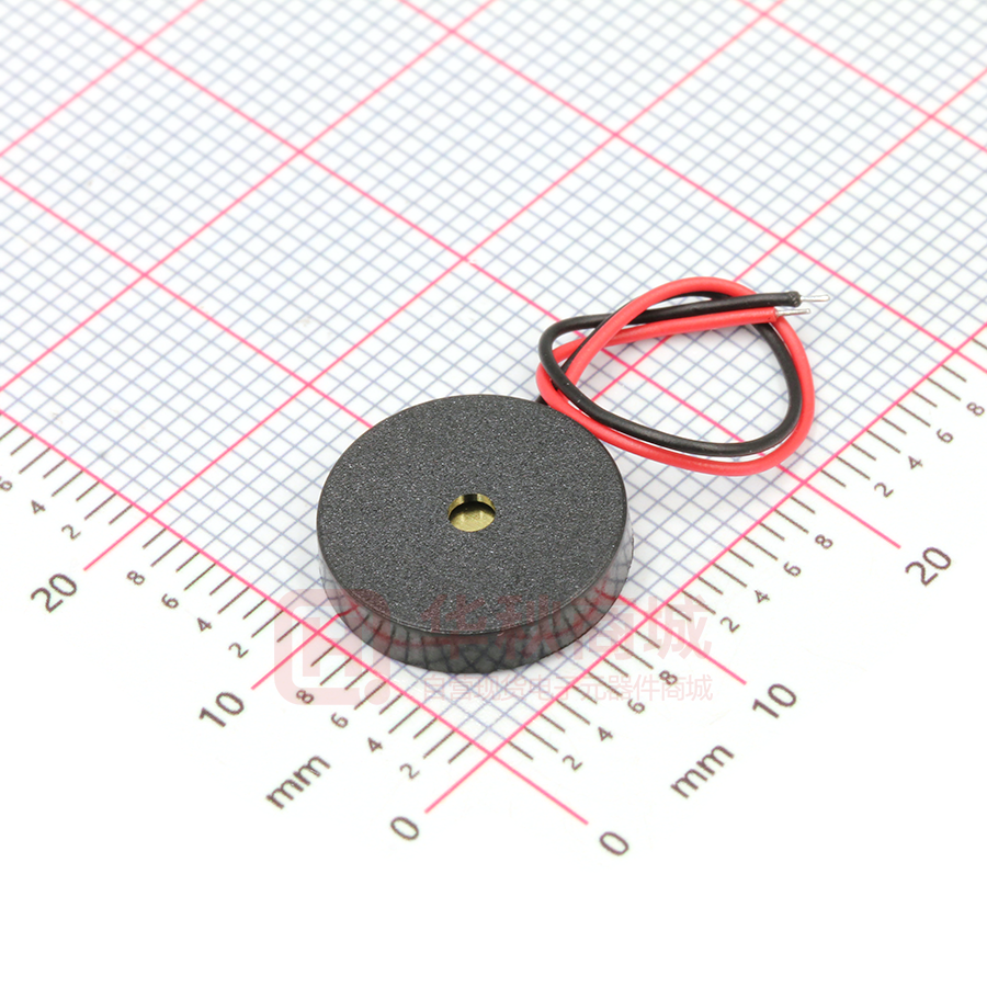

GPC13025L50-5V
GPC13025L50-5V
    INGHAI(赢海)
    Lead wire
    频率7KHz 电压-额定5V
GPC13025L50-5V 数据手册
規 格 承 認 書 PECIFICATION FOR APPROVAL 客 戶 CUSTOMER 項 目 ITEM 型 號 : : 压电式无源蜂鸣器(外部驱动) TYPE : GPC13025L50-5V7000 描述 DESCRIPTION : φ13.0x H2.6 mm 7000Hz 12,000pF 5V ≥85DB ABS 材质 L=50 mm 客戶料號 CUSTOMER NO. : 規 格 書 號 SPECIFICATION NO.: 版 本 EDITION NO. 日 期 DATE : V1.1 : 2013-7-16 客戶承認 CUSTOMER CONFIRM AND SIGN 檢查 審核 承認 TESTED BY CHECKED BY APPROVED BY 東莞市赢海電子有限公司 DONGUAN INGHAI ELECTRONICS CO.,LTD 製作 審查 確認 ISSUED BY CHECKED BY APPROVED BY 周明 李林 地址:廣東省東莞市長安鎮廈邊元灶頭工業區 16-6 號 電話 / TEL:0769-83060958 傳真 / FAX: 0769-81608993 1/4 網址:HTTP://WWW.INGHAI.COM DONGGUAN INGHAI ELECTRONICS CO.,LTD Model NO: GPC13025L50-5V7000 DIMEMSIONS: Unit:mm Tolerance:±0.5 50±2   BLACK φ 0.6*5 φ 0.6*5 SPECIFICATIONS Model NO GPC13025L Sound Pressure Min.85dB / 7KHZ / 5VP-P Resonant Frequency 7000Hz Rated Current Max. 5mA Capacitance at 1KHz 12,000pF+30% Rated Voltage 5Vp-p Operating Voltage 2~30 Vp-p Operating Temperature -20 ℃~+60 ℃ Storage Temperature -20 ℃~+70 ℃ Case material and color ABS / Black Measuring condition Part shall be measured under a condition (Temperature: 5~35℃, Humidity: 45%~85%R.H., Atmospheric pressure: 2/4 860 ~1060hPa) unless the standard condition (Temperature: 25±3℃, Humidity: 60±10%R.H. Atmospheric pressure: 860 ~1060hPa) is regulated to measure. Acoustic Characteristics: The oscillation frequency, current consumption and sound pressure are measured by the measuring instruments shown below In the measuring test, buzzer is placed as follows: 3/4 D: Reliability Test After any following tests the part shall meet specifications without any degradation in appearance and performance except SPL. SPL shall not deviate more than -10 dB from the initial value 1. Ordinary Temperature Life Test The part shall be subjected to 96 hours at 25±10℃. Input rated voltage Resonant frequency, 1/2 duty Square wave. 2. High Temperature Test The part shall be capable of with standing a storage temperature of +70℃ for 96 hours. 3. Low Temperature Test The part shall be capable of with standing a storage temperature of -30℃ for 96 hours. 4. Humidity Test Temperature:+40℃±3℃ Relative Humidity:90%~95% Duration: 48 hours and expose to room temperature for 6 hours 5. Temperature Shock Test Temperature:60℃ /1hour→ 25℃/3hours→-30℃/1hour→ 25℃/3hours (1cycle) Total cycle: 10 cycles 6. Drop Test Standard Packaging From 120mm(Drop on hard wood or board of 5cm thick, three sides, six plain.) 7. Vibration Test Vibration:1000cycles /min. Amplitude:1.5mm, Duration: 1 hour in each 3 axes Note: As this product is not protected from foreign material entering, please make sure that any foreign materials (e.g. magnetic powder, washing solvent, flux, corrosive gas) do not enter this product in your production processes. The functional degradation (e.g. SPL down) may occur if foreign material enter it. 4/4
