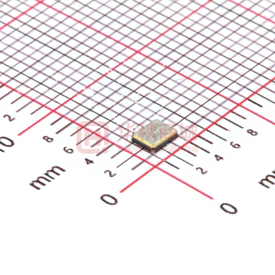

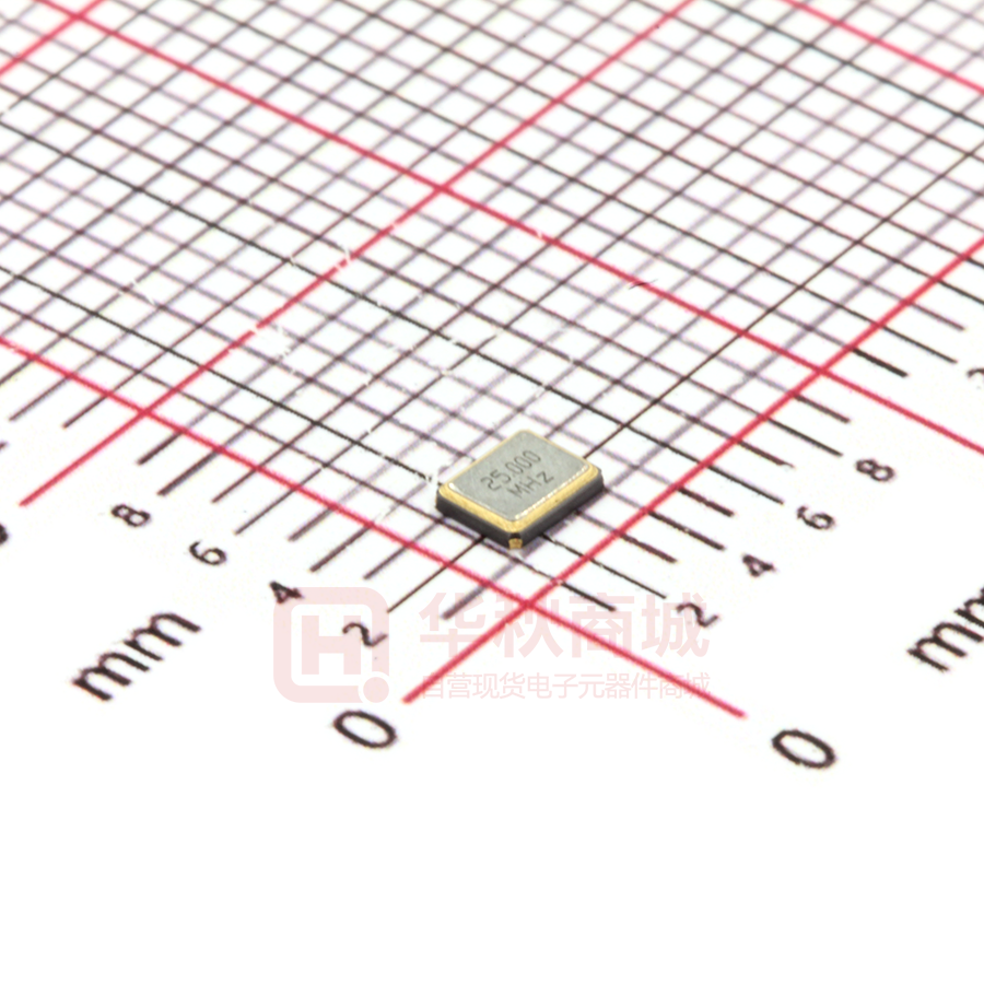

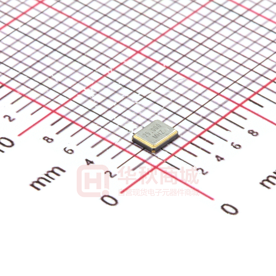

3.2×2.5×0.7mm typ 12MHz up to 60MHz Feature A small surface mount type crystal unit,especially suited for small-sizing requirements. Ultra compact and thin.(3.2×2.5×0.7 mm typ.) Tight Tolerance 10ppm available. Application:Bluetooth ;Mobile phone;W-LAN;Office Automation; Audio & Visual. Meets the requirements for re-flow profiling using lead-free solder. Specifications Type Item TX3-Type 12~13MHz 13~19.5MHz 19.5~27MHz 27~60MHz Fundamental Series,6~32pf,or speecify 10μW(200μW max.) ±10×10-6,±20×10-6,±30×10-6,±50×10 -6 (at 25°C) 150 Ω max. 80 Ω max. 60 Ω max. 50 Ω max. -10~+60°C, -20~+70°C, -40~+85°C -55~+125°C 3000pcs/reel(Ø180) Frequency Range Oscillator Mode Load Capacitance Drive Level Frequency Tolerance Series Resistance Operating Temperature Range Storage Temperature Range Packing Unit Outline Drawing(mm) 3.20±0.20 [TOP VIEW] Internal connections #3 2.50±0.20 GND #4 #2 GND #1 [SIDE VIEW] 0.70±0.20 * # 2 and #4 are connected with metal cap. Of top. Solder Pad Layout [BOTTOM VIEW] #1 #4 1.10 0.90±0.10 1.60 1.50±0.10 #2 #3 0.90±0.10 1.20 2.20 2.10±0.10 Frequency Stability Vs. Temperature Range ±30 ±50 √+ √√ Conditional × + √ Available ±20 × -40 ~ +105 -40 ~ +125 ±15 √ PPm ±15 + × Temp.(°C) ±10 √ √+ -10 ~ +60 -20 ~ +70 -40 ~ +85 ±5 √√× PPm + × × Temp.(°C) Not Available Oscillation Circuit of Fundamental Mode RF R C1 Crystal C2 CL= C1*C2 C1+C2 +3~5pf ①      ②     ③     ④     1612 2016 2520 3225 5032 6035 3225 5032 8045 49S 49MD  ⑤ B 产 品编号 : - - - - ①     ②    ③    ④     ⑤ ① 型号 ② 频率 ③ 负载电容 ④ 频率稳定度(X10- 6 ,+25℃) 范例: 3225 -12.00-20-20-20/A ①   ②    ③   ④ ⑤ ⑤温度
