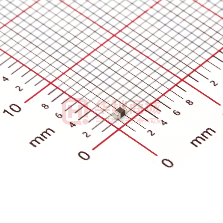

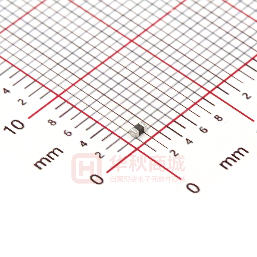

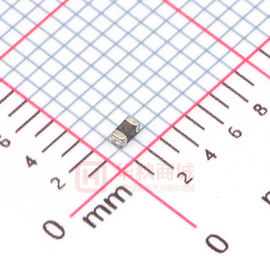

    最大DC电压5VDC, ±20%, 钳位电压25V
RL0603E005M500K 数据手册
ELECTRONICS Metal Oxide Varistors RL0603E Series Circuit Protection System Specifications are subject to change without notice. Metal Oxide Varistors - RL0603E Series Features 1. Excellent ESD clamping & Small Insertion Loss 2. High transient current capability, Fastest response time 3. Capacitance is designed to ultra-low value, which can be efficiently suitable to high speed data line. 4. EU-RoHS Compliance Product Name R L Brand Name 0 6 0 3 E EIA Type 0603 E:ESD 0 0 5 Varistor Voltage M M±30% 0 1 5 K capacitance Type 0.15PF=015 Package Dimensions Unit:mm EIA L1(mm) W(mm) H(mm) L2&L3(mm) 0603 1.60±0.15 0.80±0.15 0.95 0.35±0.15 Circuit Protection System Specifications are subject to change without notice. Page:1 Metal Oxide Varistors - RL0603E Series Electriacl Characteristics Max. Operating Voltage Max. Leakage Curren VDC(V) (uA) @1MHz(Cp) (V) (V) RL0603E005M005K 5 0.001 0.05 450 RL0603E005M015K 5 0.05 0.15 RL0603E005M250K 5 1 RL0603E005M500K 5 RL0603E012M005K capacitance Trigger Voltage Clamping Voltage Attenuation esd capability3 Cont.Discharge 50 -3dB at 5GHz 8KV 250 50 -3dB at 5GHz 8KV 2.5 200 50 - 8KV 1 5 15 25 - 8KV 12 0.05 0.05 250 50 -3dB at 5GHz 8KV RL0603E012M015K 12 1 0.15 200 50 -3dB at 5GHz 8KV RL0603E012M100K 12 1 1 200 50 - 8KV RL0603E018M015K 18 1 0.15 250 50 -3dB at 5GHz 8KV RL0603E018M100K 18 1 1 200 50 - 8KV RL0603E018M300K 18 1 3 125 50 - 8KV RL0603E024M015K 24 1 0.15 200 50 -3dB at 5GHz 8KV RL0603E024M250K 24 1 2.5 200 50 - 8KV Part Number Notes: 1.Leakage current at Max.operating Voltage 2.Capacitance is measured with 1Vrms 3.per IEC 61000-4-2,30A@8KV,level 4,clamp measuremtne made 30ns after initiation of pulse,all test IN contact discharge mode. Circuit Protection System Specifications are subject to change without notice. Page:2 Metal Oxide Varistors - RL0603E Series Electrical Rating No ltem 1 Operation Range 1. -40°C ~ 85°C 2 Leakage current Satisfaction to the specification, under 1uA Applied voltage : specified working voltage 3 Capacitance Satisfaction to the specification, under 1pF Frquency & OSC level : 1MHz, 1.0Vrms 4 Solderability More than 90% of the terminal electrode shall be covered with new solder. 1. Type of solder : H63A 2. Soldering Temp & Time : 230+/-5°C, 5+/-1 sec 5 Reflow soldering 1. No Serious mechanical damage 2. More than 50% of the terminal electrode shall be covered with new solder 3. Leakage Currrent :≤ 10uA 1. Type of solder : H63A 2. Temp & Time : max 260+/-5°C, min 10sec * Refer to the soldering profile of page 6 6 Humidity Load Test 1. No Serious mechanical damage 2. Leakage Currrent :≤ 10uA Test Temp. & Relative Humidity & Time : 85+/- 5°C, 85 +/- 5% RH, Vw Applied, 500 +/- 12hrs 7 Thermal Shock 1. No Serious mechanical damage 2. Leakage Currrent :≤ 10uA 1. Step 1 : -40 +/- 5°C, Step 2 : 85 +/- 5°C 2. Cycle : 30min ± 3min, each 5 cycles 8 High Temp. Test 1. No Serious mechanical damage 2. Leakage Currrent :≤ 10uA Temp. & time : 85+/-5°C , 1000 +/- 24hrs 9 Adhesive strength 10 ESD Test Condition / Description Requirement - 1. No Serious mechanical damage under condition of 1005 : min 0.5kgf, 1608 : min 1.0kgf 1. No mechanical damage after test 2. Leakage Current :≤ 10uA * ESD gun (IEC61000-4-2 standard) * C=150pF R=330Ω Circuit Protection System W [kgf] min. 1. Contact discharge * Voltage :+/-8kV(Level 4) * Number : 10 times in 10sec 2. Air discharge * Voltage :+/-15kV(Level 4) * Number : 10 times in 10sec Specifications are subject to change without notice. Page:3 Packing specifications Metal Oxide Varistors - RL0603E Series 1. Carrier tape Unit:mm Size A B W D E F P P0 P2 t 0603 1.10+/-0.10 1.90+/-0.10 8.00+/0.20 1.50+/0.25 1.75+/0.10 3.50+/0.50 4.0+/-0.1 4.0+/0.10 2.0+/0.10 1.1max 2. Reel & Label [Plastic Reel] Unit:mm t A code A ≥ 50 C Code ΦA ΦB unit : mm dimension dimension 178+/-2.0 178+/-2.0 13.0+/-0.5 B ΦC 13.0+/-0.5 22.0+/-2.0 C G 22.0+/-2.0 10.0+/-1.5 t 2.5+/-0.5 G t 10.0+/-1.5 2.5+/-0.5 Label B G Frequency properties ; Cp, Insertion Loss 1.0 5 -5 -10 -15 -25 (a) (a) (b) LOPIVA-0.8pF LOPIVA-0.15pF 2 4 6 Frequency (GHz) Circuit Protection System 8 10 Capacitance (pF) Attenuation (dB) 0 -20 (a) (b) (b) 0.8 LOPIVA-0.8pF LOPIVA-0.15pF 0.6 (a) 0.4 0.2 0.0 (b) 1 10 100 1000 Frequency (MHz) Specifications are subject to change without notice. Page:4 Packing specifications Metal Oxide Varistors - RL0603E Series 1) Land Pattern Design a Code b Land Dimension with Chip Size [mm] 0201 0402 0603 0805 a 0.20~0.35 0.30~0.50 0.60~0.70 0.60~0.70 b 0.25~0.40 0.40~0.60 0.60~0.80 0.80~1.10 c 0.25~0.40 0.30~0.50 0.60~0.80 1.00~1.20 c 2) Reflow Soldering 300 Temp. [deg. C] 250 200 150 100 a 50 d c b LOPIVA 16G05D 0 Time [sec] Zone a Curing temp. range [deg. C] time [sec] RT ~ 130 60 b Preheat max 220 90 ~ 150 c Soldering 220 ~ 260 [max 270] 90 ~ 150 d Cooling 220 ~ RT min 60 3) Soldering Iron Remark * Solder : Sn-Ag-Cu * 260deg. C, over 10sec Solder Iron 400+/ 400+/--5 deg. C, max 5sec Terminal Electrode Solder Solder pad To prevent a defective crack from thermal shock due to solder iron, the end of iron-tip must be located on between terminal electrode and solder pad PCB Circuit Protection System Specifications are subject to change without notice. Page:5 RuiLongYuan Electronics Co., Ltd. · Reproducing and modifying information of the document is prohibited without permission from Ruilongyuan International Inc. · Ruilongyuan International Inc. reserves the rights to make changes of the content herein the document anytime without notification. Please refer to our website for the latest document. · Ruilongyuan International Inc. disclaims any and all liability arising out of the application or use of any product including damages incidentally and consequentially occurred. · Ruilongyuan International Inc. does not assume any and all implied warranties, including warranties of fitness for particular purpose, non-infringement and merchantability. · Applications shown on the herein document are examples of standard use and operation. Customers are responsible in comprehending the suitable use in particular applications.Ruilongyuan International Inc. makes no representation or warranty that such applications will be suitable for the specifed use without further testing or modifcation. · The products shown herein are not designed and authorized for equipments requiring high level of reliability or relating to human life and for any applications concerning life-saving or life-sustaining, such as medical instruments, transportation equipment,aerospace machinery et cetera. Customers using or selling these products for use in such applications do so at their own risk and agree to fullyindemnify Ruilongyuan International Inc. for any damages resulting from such improper use or sale. Circuit Protection System Specifications are subject to change without notice. Page:6
