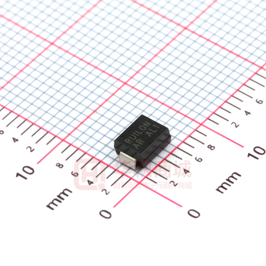

    TVS二极管 VRWM=8V VBR(Min)=8.89V VC=13.6V IPP=44.2A Ppp=600W SMB
SMBJ8.0CA 数据手册
Transient Voltage Suppressors SMBJ Series Circuit Protection System Revision:DEC-16 Please refer to http://www.ruilon.com.cn for current information. Transient Voltage Suppressors - SMBJ Series Features UNI • Very fast response time • Halogen free and RoHS compliant • Low incremental surge resistance • Optimized for LAN protection applications • Matte tin lead–free Plated BI • Halogen ree and RoHS compliant • Typical IR less than 1µA above 12V • For surface mounted applications to optimize board space • ESD protection of data lines in accordance with IEC 61000-4-2 (IEC801-2) • EFT protection of data lines in accordance with IEC 61000-4-4 (IEC801-4) • 600W peak pulse power capability with at 10/1000μs waveform,repetition rate (duty cycle): 0.01% BI Cathode Anode • High temperature soldering : 260°C/ 40 seconds at terminals UNI Description The SMBJ series is designed specifically to protect sensitive electronic equipment from voltage transients induced by lightning and other transient voltage events. Mechanical Characteristics Rating Symbol Value Units PPPM 600 Watts PD 5.0 Watts IFSM 100 A VF 3.5/5.0 V TJ,TSTG -55°C to 150°C °C Typical Thermal Resistance Junction to Lead RθJL 20 °C/W Typical Thermal Resistance Junction to Ambient RθJL 100 °C/W Peak Pulse Power Dissipation at TA=25ºC by 10/1000µs Waveform (Fig.2)(Note 1), (Note 2) Power Dissipation on Infinite Heat Sink at TA=50°C Peak Forward Surge Current, 8.3ms Single Half Sine Wave (Note 3) Maximum Instantaneous Forward Voltage at 25A for Unidirectional Only (Note 4) Operating junction and Storage Temperature Range. Notes: 1. Non-repetitive current pulse, per Fig.4 and derated above TA=25ºC per Fig. 3. 2. Mounted on 5.0x5.0mm copper pad to each terminal. 3. Measured on 8.3ms single half sine wave or equivalent square wave for unidirectional device only, duty cycle=4 per minute maximum. 4. VF< 3.5V for single die parts and VF< 5.0V for stacked-die parts Circuit Protection System Revision:DEC-16 Please refer to http://www.ruilon.com.cn for current information. Page:1 Transient Voltage Suppressors - SMBJ Series Electriacl Characteristics Device Marking Code Type Number Reverse Stand-Off Voltage Breakdown Voltage@IT Test Current VBR MIN.(V) VBR MAX.(V) IT(mA) VC(V) IPP(A) IR(µA) 10 10 10 10 1 1 1 1 1 1 1 1 1 1 1 1 1 1 1 1 1 1 1 1 1 1 1 1 1 1 1 1 1 1 1 1 1 1 1 1 1 1 1 1 1 1 1 1 1 1 1 9.2 10.3 11.2 12.0 12.9 13.6 14.4 15.4 17.0 18.2 19.9 21.5 23.2 24.4 26.0 27.6 29.2 32.4 35.5 38.9 42.1 45.4 48.4 53.3 58.1 64.5 69.4 72.7 77.4 82.4 87.1 93.6 96.8 103.0 113.0 121.0 126.0 137.0 146.0 162.0 177.0 193.0 209.0 243.0 259.0 275.0 292.0 308.0 324.0 340.0 356.0 65.3 58.3 53.6 50.0 46.6 44.1 41.7 39.0 35.3 33.0 30.2 27.9 25.8 24.6 23.1 21.7 20.5 18.5 16.9 15.2 14.2 13.2 12.4 11.3 10.3 9.3 8.6 8.3 7.7 7.3 6.9 6.4 6.2 5.8 5.3 4.9 4.7 4.4 4.1 3.7 3.4 3.1 2.9 2.5 2.3 2.2 2.1 2.0 1.9 1.8 1.7 800 800 500 200 100 50 20 10 5 1 1 1 1 1 1 1 1 1 1 1 1 1 1 1 1 1 1 1 1 1 1 1 1 1 1 1 1 1 1 1 1 1 1 1 1 1 1 1 1 1 1 UNI BI UNI BI VRWM(V) SMBJ5.0A SMBJ6.0A SMBJ6.5A SMBJ7.0A SMBJ7.5A SMBJ8.0A SMBJ8.5A SMBJ9.0A SMBJ10A SMBJ11A SMBJ12A SMBJ13A SMBJ14A SMBJ15A SMBJ16A SMBJ17A SMBJ18A SMBJ20A SMBJ22A SMBJ24A SMBJ26A SMBJ28A SMBJ30A SMBJ33A SMBJ36A SMBJ40A SMBJ43A SMBJ45A SMBJ48A SMBJ51A SMBJ54A SMBJ58A SMBJ60A SMBJ64A SMBJ70A SMBJ75A SMBJ78A SMBJ85A SMBJ90A SMBJ100A SMBJ110A SMBJ120A SMBJ130A SMBJ150A SMBJ160A SMBJ170A SMBJ180A SMBJ190A SMBJ200A SMBJ210A SMBJ220A SMBJ5.0CA SMBJ6.0CA SMBJ6.5CA SMBJ7.0CA SMBJ7.5CA SMBJ8.0CA SMBJ8.5CA SMBJ9.0CA SMBJ10CA SMBJ11CA SMBJ12CA SMBJ13CA SMBJ14CA SMBJ15CA SMBJ16CA SMBJ17CA SMBJ18CA SMBJ20CA SMBJ22CA SMBJ24CA SMBJ26CA SMBJ28CA SMBJ30CA SMBJ33CA SMBJ36CA SMBJ40CA SMBJ43CA SMBJ45CA SMBJ48CA SMBJ51CA SMBJ54CA SMBJ58CA SMBJ60CA SMBJ64CA SMBJ70CA SMBJ75CA SMBJ78CA SMBJ85CA SMBJ90CA SMBJ100CA SMBJ110CA SMBJ120CA SMBJ130CA SMBJ150CA SMBJ160CA SMBJ170CA SMBJ180CA SMBJ190CA SMBJ200CA SMBJ210CA SMBJ220CA KE KG KK KM KP KR KT KV KX KZ LE LG LK LM LP LR LT LV LX LZ ME MG MK MM MP MR MT MV MX MZ NE NG NK NM NP NR NT NV NX NZ PE PG PK PM PP PR PT PV PX PZ QE AE AG AK AM AP AR AT AV AX AZ BE BG BK BM BP BR BT BV BX BZ CE CG CK CM CP CR CT CV CX CZ DE DG DK DM DP DR DT DV DX DZ EE EG EK EM EP ER ET EV EX EZ FE 5.0 6.0 6.5 7.0 7.5 8.0 8.5 9.0 10.0 11.0 12.0 13.0 14.0 15.0 16.0 17.0 18.0 20.0 22.0 24.0 26.0 28.0 30.0 33.0 36.0 40.0 43.0 45.0 48.0 51.0 54.0 58.0 60.0 64.0 70.0 75.0 78.0 85.0 90.0 100.0 110.0 120.0 130.0 150.0 160.0 170.0 180.0 190.0 200.0 210.0 220.0 Circuit Protection System 6.40 6.67 7.22 7.78 8.33 8.89 9.44 10.00 11.10 12.20 13.30 14.40 15.60 16.70 17.80 18.90 20.00 22.20 24.40 26.70 28.90 31.10 33.30 36.70 40.00 44.40 47.80 50.00 53.30 56.70 60.00 64.40 66.70 71.10 77.80 83.30 86.70 94.40 100.00 111.00 122.00 133.00 144.00 167.00 178.00 189.00 201.00 209.00 220.00 231.00 242.00 7.25 7.67 8.30 8.95 9.58 10.23 10.82 11.50 12.80 14.00 15.30 16.50 17.90 19.20 20.50 21.70 23.30 25.50 28.00 30.70 33.20 35.80 38.30 42.20 46.00 51.10 54.90 57.50 61.30 65.20 69.00 74.10 76.70 81.80 89.50 95.80 99.70 108.20 115.50 128.00 140.50 153.00 165.50 192.60 197.00 209.00 222.00 243.20 247.00 268.80 281.60 Maximum Peak Pulse Clamping Current Voltage@IPP Reverse Leakage @VRWM Revision:DEC-16 Please refer to http://www.ruilon.com.cn for current information. Page:2 Transient Voltage Suppressors - SMBJ Series Electriacl Characteristics Device Marking Code Type Number UNI SMBJ250A SMBJ300A SMBJ350A SMBJ400A SMBJ440A BI SMBJ250CA SMBJ300CA SMBJ350CA SMBJ400CA SMBJ440CA UNI QG QK QM QP QR BI FG FK FM FP FR Reverse Stand-Off Voltage VRWM(V) 250.0 300.0 350.0 400.0 440.0 Breakdown Voltage@IT Test Current VBR MIN.(V) VBR MAX.(V) 279.0 309.0 335.0 371.0 391.0 432.0 447.0 494.0 492.0 543.0 IT(mA) 1 1 1 1 1 Maximum Peak Pulse Clamping Current Voltage@IPP VC(V) IPP(A) 405.0 1.5 486.0 1.3 567.0 1.1 648.0 0.9 713.0 0.9 Reverse Leakage @VRWM IR(µA) 1 1 1 1 1 For bidirectional type having VR of 10 volts and less, the IR limit is double. I-VI-VCurve Characteristics Curve Characteristics BR V VBR Vc V VRR Vc Bi-directional I pp IIpp BR V VBR Vc V VRR Vc V V IIRR V VFF IITT IITT IIRR IIRR IITT VRRV BR Vc VBR Vc V V V pp IIpp pp IIpp PP PPM Peak Pulse Power Dissipation -- Max power dissipation PPM PPM Peak Pulse Power Dissipation -- Max power dissipation VV Stand-off Voltage -- Maximum voltage that can be applied to the TVS without operation RR R Stand-off Voltage -- Maximum voltage that can be applied to the TVS without operation VV Breakdown Voltage -- Maximum voltage that flows though the TVS at a specified test current (ITT) BR BR test current (IT) BR Breakdown Voltage -- Maximum voltage that flows though the TVS at a specified VV Clamping Voltage -- Peak--voltage across the suppressor a specified Ippm (peakIppm impulse current) CC C Clamping Voltage Peak measured voltage measured across theat TVS at a specified (peak impulse current) Leakage Current -- Current at VRR IRIRR Reverse Reverse Leakage Current -- measured Current measured at VR VV Forward Voltage Drop Drop for Uni-directional Forward Voltage for Uni-directional FF F Ratings and Characteristic Curves (TAA=25°C =25°C unless unless otherwise otherwise noted) noted) (T Figure 1 - TVS Transients Clamping Waveform Figure 2 - Peak Pulse Power Rating 1000 1000 -Peak Pulse Power (kW) PPPM PPM Voltage Transients Transients Voltage Voltage Across Across TVS TVS Voltage Voltage or Current P6KESeries Series P6KE Uni-directional Current Through Through TVS TVS Current 100 100 10 10 11 0.1 0.1 0.000001 0.000001 Time Time Circuit Protection System 0.00001 0.00001 0.0001 0.0001 0.001 0.001 -Pulse Width Width (Sec.) (Sec.) ttdd-Pulse Revision:DEC-16 Please refer to http://www.ruilon.com.cn for current information. Page:3 Transient Voltage Suppressors - SMBJ Series Ratings and Characteristic Curves (TA=25°C unless otherwise noted) Figure 3 - Pulse Derating Curve Figure 4 - Pulse Waveform 150 IPPM - Peak Pulse Cur rent, % IRSM Peak Pulse Power (PPP) or Current (IPP) Derating in Percentage % 100 80 60 40 20 0 0 25 50 75 100 125 150 tr=10µsec Half Value IPPM IPPM ( ) 2 50 0 TA-Ambient temperature (ºC) 10/1000µsec. Waveform as defined by R.E.A td 1.0 0 2.0 3.0 4.0 t-Time (ms) Figure 5 - Typical Junction Capacitance Figure 6 - Steady State Power Dissipation Derating Curve 10000 PM(AV), Steady State Power Dissipation (W) 6 Bi-directional V=0V 1000 Cj (pF) Peak Value IPPM 100 175 T J =25°C Pulse Width(td) is defined as the point where the peak current decays to 50% of IPPM Uni-directional V=0V Uni-directional @VR 100 Bi-directional @VR 10 Tj=25C f=1.0MHz Vsig=50mVp-p 1 1.0 10.0 100.0 VBR - Reverse Breakdown Voltage (V) 1000.0 5 4 3 2 1 0 0 25 50 75 100 125 150 175 TA - Ambient Temperature (ºC) Figure 7 - Maximum Non-Repetitive Peak Forward Surge Current Uni-Directional Only IFSM - Peak Forward Surge Current (A) 120 100 80 60 40 20 0 1 10 100 Number of Cycles at 60 Hz Circuit Protection System Revision:DEC-16 Please refer to http://www.ruilon.com.cn for current information. Page:4 Transient Voltage Suppressors - SMBJ Series Soldering Parameters 150°C TL 200°C 60-180 secs Average ramp up rate (Liquidus Temp (TA) to peak 3°C/second max TS(max) to TA - Ramp-up Rate 3°C/second max - Temperature (T A) (Liquidus) Reflow - Time (min to max) (t s) tL Ts(max) Ramp-down Ts(min) ts Preheat Time (t) 217°C 60-150 seconds 260+0/-5 °C Peak Temperature (T P) Time within 5°C of actual peak Temperature (t p) Critical Z one TL to TP Ramp-up - Temperature Min (T s(min)) - Temperature Max (T s(min)) - Time (min to max) (t s) Pre Heat tp TP Lead-free assembly Temperature (T) Reflow Condition 20-40 seconds Ramp-down Rate 6°C/second max Time 25°C to peak Temperature (T P) 8 minutes Max. Do not exceed 280°C Physical Specifications Environmental Specifications High Temp. Storage JESD22-A103 HTRB JESD22-A108 Temperature Cycling JESD22-A104 MSL JEDEC-J-STD-020, Level 1 H3TRB JESD22-A101 RSH JESD22-A111 Flow/Wave Soldering Weight 0.003 ounce, 0.093 grams Case JEDEC DO-214AA Molded Plastic over Polarity glass passivated junction Termina Matte Tin axial leads, solderable per JESD22-B102D. Peak Temperature : 265°C Dipping Time : 10 seconds Soldering : 1 time Dimensions DO-214AA/SMB Inches DIM A B C D E F G H I J K L Circuit Protection System Millimeters Min Max Min Max 0.077 0.160 0.130 0.084 0.030 0.205 0.006 0.089 0.085 0.085 0.086 0.180 0.155 0.096 0.060 0.008 0.220 0.012 0.107 - 1.950 4.060 3.300 2.130 0.760 5.210 0.152 2.260 2.160 2.160 2.200 4.570 3.940 2.440 1.520 0.203 5.590 0.305 2.740 - Revision:DEC-16 Please refer to http://www.ruilon.com.cn for current information. Page:5 0.157 (4.0) Cathode 0.31 (8.0) 0.157 (4.0) 0.059 DIA (1.5) Cover tape Transient Voltage Suppressors - SMBJ Series 13.0 (330) Dimensions are in inches (and millimeters). 0.80 (20.2) Arbor Hole Dia. Product Name Direction of Feed 0.33 (8.5) S Part Marking System Cathode band M B Series code 0.157 (4.0) J x x DC Spark-over Voltage 0.47 (12.0) x C (for Uni-directional products only) A RUILON Blank:UniDirectional C:BiDirectional XX XXX Cathode Date Code Product Code 5% Voltage Tolerance 0.157 (4.0) Packaging 0.059 DIA (1.5) 13.0 (330) 0.80 Part(20.2) Number Arbor Hole Dia. Component Package SMBJxxxXX DO-214AC 0.49 (12.5 Marking Code Cover tape Dimensions are in inches (and millimeters). Quantity Packaging Option Packaging Specification 500 Tape & Reel EIA RS-481 Direction of Feed Tape and Reel Specification 0.157 (4.0) Cathode 0.47 (12.0) 0.315 (8.0) 13.0 (330) 0.80 (20.2) Arbor Hole Dia. 0.059 DIA (1.5) Cover tape Dimensions are in inches (and millimeters). Direction of Feed 0.49 (12.5) 0.157 (4.0) Cathode 0.63 (16.0) 0.315 (8.0) 13.0 (330) 0.80 (20.2) Arbor Hole Dia. Circuit Protection System 0.059 DIA (1.5) Cover tape Dimensions are in inches (and millimeters). Revision:DEC-16 Please refer to http://www.ruilon.com.cn for current information. Page:6
SMBJ8.0CA
- 物料型号:瞬态电压抑制器,型号包括SMBJ5.0A至SMBJ300A等。 - 器件简介:专为保护敏感电子设备免受雷电和其他瞬态电压事件引起的电压瞬态而设计。 - 引脚分配:文档中未明确提供引脚分配图,但提到了UNI和BI两种类型,分别代表单向和双向瞬态电压抑制器。 - 参数特性:包括非常快的响应时间、无卤素且符合RoHS标准、低增加的浪涌电阻、优化的LAN保护应用、无铅锡焊端子、在12V以上时典型IR小于1µA、适用于表面贴装以优化板空间、符合IEC 61000-4-2和IEC 61000-4-4标准的数据线的ESD和EFT保护、600W峰值脉冲功率能力、260°C/40秒的高温焊接等。 - 功能详解:文档提供了详细的电气特性表,包括反向待机电压、击穿电压、测试电流、最大钳位电压、峰值脉冲电流和反向漏电流等。 - 应用信息:适用于数据线的ESD和EFT保护,以及LAN保护应用。 - 封装信息:提供了DO-214AA封装的尺寸信息和焊接参数,包括回流焊条件和环境规格。
