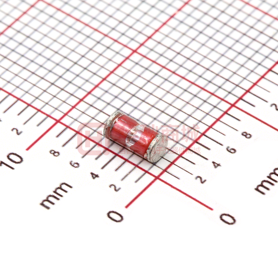

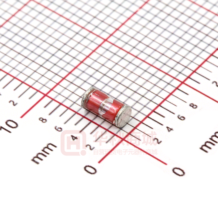

ELECTRONICS Glass Gas Discharge RLM102 Series Circuit Protection System Specifications are subject to change without notice. Glass Gas Discharge - RLM102 Series Features • Approximately zero leaking current before clamping voltage • Less decay at on/off state. • High capability to withstand repeated lightning strikes. • Low electrode capacitance(≤0.8pF) and high isolation(≥100MΩ). • RoHS compliant. • Bilateral symmetrical. • Temperature, humidity and lightness insensitive. • Operating temperature: -40℃ ~ +85℃ • Storage temperature: -40℃ ~ +125℃ • Meets MSL level 1, per J-STD-020 Applications • Power Supplies • Motor sparks eliminating • Relay switching spark absorbing • Data line pulse guarding • Electronic devices requiring UL497A and UL497B compliant • Telephone/Fax/Modem • High frequency signal transmitters/receivers • Satellite antenna • Radio amplifiers • Alarm systems • Cathode ray tubes in Monitors/TVs Part Number Code R L M LOGO Taping form 1 0 2 - 1 4 Surge Current Capacity DC Spark-over voltage(Vs) 501:0.5KA 14*10 =140V Blank:Line 102:1KA S:Magnet-type 302:3KA 1 1 N DC Sparkover voltage tolerance N:30% M:20% M:SMD Circuit Protection System Specifications are subject to change without notice. Page:1 Glass Gas Discharge - RLM102 Series ElectrIcal CharacterlstIcs Type Number DC Spark-Over Voltage Insulation Resistance Electrostatic Capacitance 1KHz-6Vmax Surge current capacity 8/20us V IR DC V pF A RLM102-141N 140±30% >100MΩmin 50 100MΩmin 100 100MΩmin 100 100MΩmin 250 100MΩmin 250 100MΩmin 250 100MΩmin 250 100MΩmin 500
