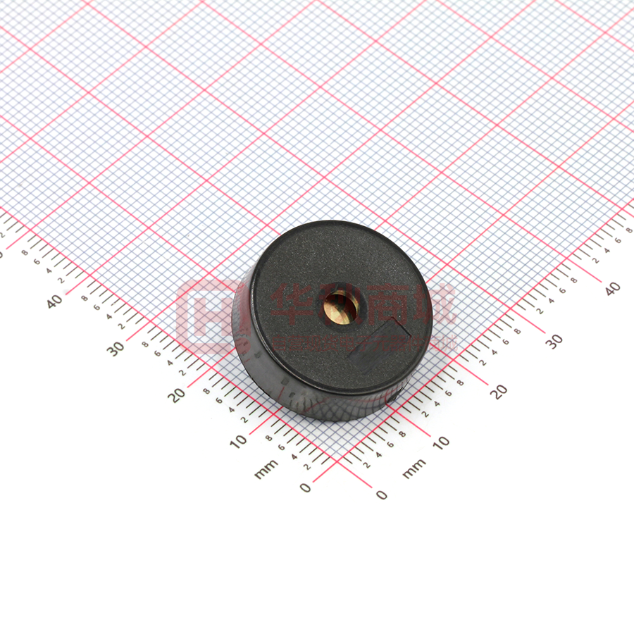

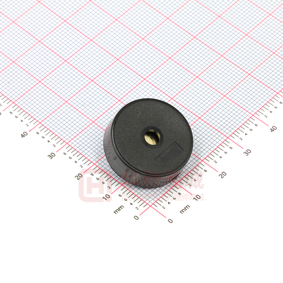

規 格 承 認 書 PECIFICATION FOR APPROVAL 客 戶 CUSTOMER 項 目 ITEM 型 號 : 立创 : 压电式无源蜂鸣器(外部驱动) TYPE : GPC2208AT-5V4000 描述 DESCRIPTION : φ22.0 x H8.0 mm 4000Hz 客戶料號 CUSTOMER NO. : 規 格 書 號 5V ≥85DB P=10mm 材质 PBT SPECIFICATION NO.: 版 本 EDITION NO. 日 期 DATE : V1.0 : 2015-9-10 客戶承認 CUSTOMER CONFIRM AND SIGN 檢查 TESTED BY 審核 CHECKED BY 承認 APPROVED BY 東莞市赢海電子有限公司 DONGUAN INGHAI ELECTRONICS CO.,LTD 製作 審查 確認 ISSUED BY CHECKED BY APPROVED BY 周明 李林 地址:廣東省東莞市長安鎮上沙第五工业区新春 1 路新春科技园 電話 / TEL:0769-83060958 傳真 / FAX: 0769-81608993 網址:HTTP://WWW.INGHAI.COM 1/4 DONGGUAN INGHAI ELECTRONICS CO.,LTD Model NO: GPC2208AT-5V4000 A:DIMEMSIONS Unit:mm Tolerance:±0.5 B:SPECIFICATIONS Model NO GPC2208AT Rated Voltage 5Vp-p Sound Pressure level(dB) Min.85dB at10cm/4KHZ/5VP-P Resonant Frequency 4000±500Hz Max. Current Consumption (mA) Max. 3mA at Rated Voltage Capacitance at 1KHz 13000±30% Operating Voltage 1~30 Vp-p Operating Temperature -20 ℃~+70 ℃ Storage Temperature -30 ℃~+80 ℃ Case material and color PBT / Black Measuring condition Part shall be measured under a condition (Temperature: 5~35℃, Humidity: 45%~85%R.H., Atmospheric pressure: 860 ~1060hPa) unless the standard condition (Temperature: 25±3℃, Humidity: 60±10%R.H. Atmospheric pressure: 860 ~1060hPa) is regulated to measure. 2/4 C:Acoustic Characteristics: The oscillation frequency, current consumption and sound pressure are measured by the measuring instruments shown below In the measuring test, buzzer is placed as follows: D:Typical Frequency Response Curve 100 A:FrequencyResponse, Magn dB re 20.00 μpa 90 dB 80 70 60 50 100 200 500 1K 2K Hz 5K 10K 3/4 E:Reliability Test After any following tests the part shall meet specifications without any degradation in appearance and performance except SPL. SPL shall not deviate more than -10 dB from the initial value 1. Ordinary Temperature Life Test The part shall be subjected to 96 hours at 25±10℃. Input rated voltage 2. 3. 4. Resonant frequency, 1/2 duty Square wave. High Temperature Test The part shall be capable of with standing a storage temperature of +80℃ for 96 hours. Low Temperature Test The part shall be capable of with standing a storage temperature of -30℃ for 96 hours. Humidity Test Temperature:+40℃±3℃ Relative Humidity:90%~95% Duration: 48 hours and expose to room temperature for 6 hours 5. Temperature Shock Test Temperature:70℃ /1hour→ 25℃/3hours→-30℃/1hour→ 25℃/3hours (1cycle) Total cycle: 10 cycles 6. Drop Test Standard Packaging From 120mm(Drop on hard wood or board of 5cm thick, three sides, six plain.) 7. Vibration Test Vibration:1000cycles /min. Amplitude:1.5mm, Duration: 1 hour in each 3 axes Note: As this product is not protected from foreign material entering, please make sure that any foreign materials (e.g. magnetic powder, washing solvent, flux, corrosive gas) do not enter this product in your production processes. The functional degradation (e.g. SPL down) may occur if foreign material enter it. 4/4
