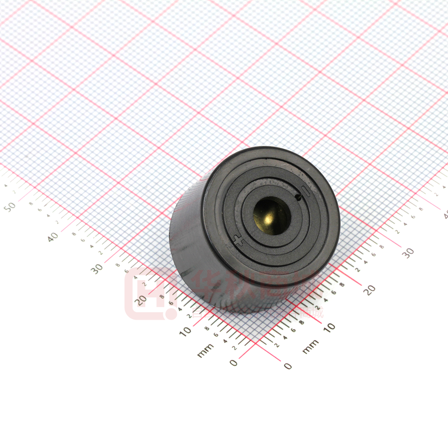

GPD2416YB-5V3500 数据手册
規 格 承 認 書 PECIFICATION FOR APPROVAL 客 戶 CUSTOMER 項 目 ITEM 型 號 : 通用型规格书 电压范围 3-24V : 压电有源蜂鸣器(内含驱动电路) TYPE : GPD2416YB-3-24V3500 描述 DESCRIPTION : 23.5 x 16 MM 3500Hz 3-24V >=90DB PBT 材质 客戶料號 CUSTOMER NO. : 規 格 書 號 P=15MM SPECIFICATION NO.: 版 本 EDITION NO. 日 期 DATE : V1.0 : 20 客戶承認 CUSTOMER CONFIRM AND SIGN 檢查 TESTED BY 審核 CHECKED BY 承認 APPROVED BY 東莞市赢海電子有限公司 DONGUAN INGHAI ELECTRONICS CO.,LTD 製作 ISSUED BY 審查 CHECKED BY 確認 APPROVED BY 周明 地址:廣東省東莞市長安鎮上沙管理區北橫路 8 號 電話 / TEL:0769-83060958 傳真 / FAX: 0769-81608993 網址:HTTP://WWW.INGHAI.COM 1/4 DONGGUAN INGHAI ELECTRONICS CO.,LTD Model NO: GPD2416YB-3-24V3500 DIMEMSIONS Unit:mm Tolerance:±0.5 + _ SPECIFICATIONS Model NO GPD2416YB Rated Voltage 3-24VDC Operating Voltage 3-28VDC Max.Rated Current Max.15mA sound Pressure level(dB/min)at10cm Min.90dB Resonant Frequency 3500±500Hz Operating Temperature -20 ℃~+75 ℃ Storage Temperature -30 ℃~+85 ℃ 2/4 NO. ITEM 1 High Temperature Test (Storage) 2 TEST CONDITION AND REQUIREMENT After being placed in a chamber with802ºC for 48 hours and then being placed in normal condition for 2 hours. Allowable variation of SPL after test: 10dB. After being Placed in a chamber with -302ºC for 48 hours and then being placed in normal condition for 2 hours. Low Temperature Test (Storage) 3 Allowable variation of SPL after test: 10dB. After being Placed in a chamber with 80-85% R.H. at 402ºC for 48 hours and then being placed in normal condition for 2 hours. Humidity Test Allowable variation of SPL after test: 10dB. The part shall be subjected to 5 cycles. One cycle shall be consist of: +80ºC +25ºC 4 Temperature Cycle Test +25ºC -30℃ Allowable variation of SPL after test: 10dB. Lead terminals are immersed in rosin for 3 seconds and then 5 Solderability Test 6 Terminal Strength Pulling Test immersed in solder bath of +32010ºC for 3 seconds . 90% min. lead terminals shall be wet with solder (Except the edge of terminals). The force of 5N is applied to each terminal in axial direction for 5 seconds. No visible damage and cutting off. TEST CONDITION. Standard Test Condition : b) Humidity : 45-85% c) Pressure : 860-1060mbar a) 温度 : +5 ~ +35℃ b) 湿度 : 45-85% c) 气压 : 860-1060mbar Judgment Test Condition : a) Temperature : +25 ± 2℃ b) Humidity : 60-70% c) Pressure 860-1060mbar 争议时测试条件 : 一般测试条件 : a) Temperature : +5 ~ +35℃ a) 温度 : +25 ± 2℃ b) 湿度 : 60-70% c) 气压 : 860-1060mbar 3/4
