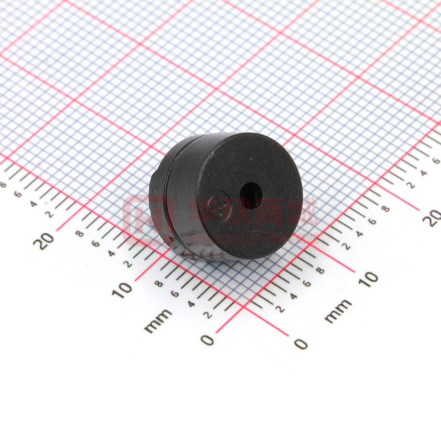

規 格 承 認 書 PECIFICATION FOR APPROVAL 客 戶 CUSTOMER 項 目 ITEM 型 號 : : 电磁无源分体蜂鸣器(外部驱动) TYPE : GMC12085YAS-8-120R2048 通用型(电阻 8-120 欧) 描述 DESCRIPTION : 12 x 8.5MM 2048Hz 8-120Ω >=80DB ABS 材质 光头蜂鸣器 客戶料號 CUSTOMER NO. : 規 格 書 號 SPECIFICATION NO.: 版 本 EDITION NO. 日 期 DATE : V1. : 20 客戶承認 CUSTOMER CONFIRM AND SIGN 檢查 審核 承認 TESTED BY CHECKED BY APPROVED BY 東莞市赢海電子有限公司 DONGUAN INGHAI ELECTRONICS CO.,LTD 製作 ISSUED BY 審查 CHECKED BY 周明 李林 確認 APPROVED BY 地址:廣東省東莞市長安鎮上沙管理區北橫路 8 號 電話 / TEL:0769-83060958 傳真 / FAX: 0769-81608993 網址:HTTP://WWW.INGHAI.COM DONGGUAN INGHAI ELECTRONICS CO.,LTD 1/4 Model NO: GMC12085YAS-8-120R2048 DIMEMSIONS Unit:mm Tolerance:±0.5 SPECIFICATIONS Model NO GMC12085YAS Rated Voltage 1.5-12V Operating Voltage 1.5 ~12V Max.Rated Current Max.80 mA Coil Resistance 8-120±4Ω Sound Pressure level(dB/)at10cm Min.80dB Resonant Frequency 2048Hz Operating Temperature -20 ℃~+60 ℃ Storage Temperature -20 ℃~+70 ℃ Case material and color ABS / Black Measuring condition Part shall be measured under a condition (Temperature: 5~35℃, Humidity: 45%~85%R.H., Atmospheric pressure: 860 ~1060hPa) unless the standard condition (Temperature: 25±3℃, Humidity: 60±10%R.H. Atmospheric pressure: 860 ~1060hPa) is regulated to measure. 备注:适用于手工焊接 Acoustic Characteristics: The oscillation frequency, current consumption and sound pressure are measured by the 2/4 measuring instruments shown below In the measuring test, buzzer is placed as follows: Typical Frequency Response Curve C: Reliability Test After any following tests the part shall meet specifications without any degradation in 3/4 appearance and performance except SPL. SPL shall not deviate more than -10 dB from the initial value 1. Ordinary Temperature Life Test The part shall be subjected to 96 hours at 25±10℃. Input rated voltage 2. 3. 4. Resonant frequency, 1/2 duty Square wave. High Temperature Test The part shall be capable of with standing a storage temperature of +70℃ for 96 hours. Low Temperature Test The part shall be capable of with standing a storage temperature of -30℃ for 96 hours. Humidity Test Temperature:+40℃±3℃ Relative Humidity:90%~95% Duration: 48 hours and expose to room temperature for 6 hours 5. Temperature Shock Test Temperature:60℃ /1hour→ 25℃/3hours→-30℃/1hour→ 25℃/3hours (1cycle) Total cycle: 10 cycles 6. Drop Test Standard Packaging From 120mm(Drop on hard wood or board of 5cm thick, three sides, six plain.) 7. Vibration Test Vibration:1000cycles /min. Amplitude:1.5mm, Duration: 1 hour in each 3 axes Note: As this product is not protected from foreign material entering, please make sure that any foreign materials (e.g. magnetic powder, washing solvent, flux, corrosive gas) do not enter this product in your production processes. The functional degradation (e.g. SPL down) may occur if foreign material enter it. 4/4

物料型号:GMC12085YAS-8-120R2048
器件简介:电磁无源分体蜂鸣器(外部驱动),ABS材质光头蜂鸣器,尺寸为12x8.5MM,频率为2048Hz,阻值为8-120欧。
引脚分配:未在文档中明确列出。
参数特性: - 额定电压:1.5-12V - 工作电压:1.5 ~12V - 最大额定电流:最大80 mA - 线圈电阻:8-120±4欧 - 声压级:最小80dB(在10cm处) - 谐振频率:2048Hz - 工作温度:-20°C~+60°C - 存储温度:-20°C~+70°C - 外壳材质和颜色:ABS / 黑色
功能详解: - 测量条件:在特定温湿度和大气压下进行测量。 - 声学特性:振荡频率、电流消耗和声压通过特定测量仪器进行测量。 - 可靠性测试:包括普通温度寿命测试、高温测试、低温测试、湿度测试、温度冲击测试、跌落测试和振动测试。
应用信息:适用于手工焊接。
封装信息:外壳尺寸为12.00mm x 8.50mm x 10.00mm,材质为ABS。
