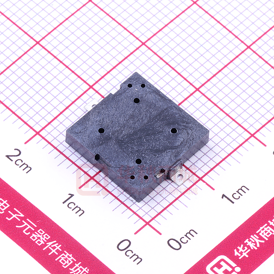

規 格 承 認 書 PECIFICATION FOR APPROVAL 客 戶 CUSTOMER 項 目 ITEM 型 號 : 立创 : 贴片式压电无源蜂鸣器(外部驱动) TYPE : GSC1325YB-3V4000 描述 DESCRIPTION : L13 x W13 x 2.5 MM 4000Hz 客戶料號 CUSTOMER NO. : 規 格 書 號 3V ≥75DB 正发音 LCP 材质 SPECIFICATION NO.: 版 本 EDITION NO. 日 期 DATE : : V1.0 2019-12-26 客戶承認 CUSTOMER CONFIRM AND SIGN 檢查 TESTED BY 審核 CHECKED BY 承認 APPROVED BY 東莞市赢海電子有限公司 DONGUAN INGHAI ELECTRONICS CO.,LTD 製作 ISSUED BY 審查 CHECKED BY 周明 李林 確認 APPROVED BY 地址:廣東省東莞市長安鎮廈邊元灶頭工業區 16-6 號 電話 / TEL:0769-83060958 傳真 / FAX: 0769-81608993 網址:HTTP://WWW.INGHAI.COM 1/5 A. SCOPE This specification applies SMD piezoelectric buzzer, GSC1325YB-3V4000 B. SPECIFICATION 1 Model No. GSC1325YB 2 Rated Voltage (Vp-p) 3 Operating Voltage (Vp-p) 1~30 4 Resonant Frequency (Hz) 4000 5 Static Capacitance at 100Hz 1V (PF) 6 *Sound Output at 10cm / Rated Voltage / 4000 Hz (dB) ≥75 7 *Current Consumption (mA) at Rated Voltage ≤3 8 Operating Temperature (℃) -30~+85 9 Storage Temperature (℃) -40~+85 10 Weight (g) 11 Housing Material 12 RoHS 3 16000±30% 0.5 LCP( Black ) Yes Measuring condition Part shall be measured under a condition (Temperature: 5~35℃, Humidity: 45%~85%R.H., Atmospheric pressure: 860 ~ 1060hPa) unless the standard condition (Temperature: 25±3℃, Humidity: 60±10%R.H. Atmospheric pressure: 860 ~1060hPa) is regulated to measure. C. APPEARANCE DRAWING 4 Sound holes 2/5 D: TEST METHOD: In the measuring test, buzzer is placed as follows: E: FREQUENCY RESPONSE: 3/5 F: Reliability Test After any following tests the part shall meet specifications without any degradation in appearance and performance except SPL. SPL shall not deviate more than -10 dB from the initial value 1. Ordinary Temperature Life Test The part shall be subjected to 96 hours at 25±10℃. Input rated voltage 2. 3. 4. 5. 6. 7. Resonant frequency, 1/2 duty Square wave. High Temperature Test The part shall be capable of with standing a storage temperature of +85℃ for 96 hours. Low Temperature Test The part shall be capable of with standing a storage temperature of -40℃ for 96 hours. Humidity Test Temperature:+40℃±3℃ Relative Humidity:90%~95% Duration: 48 hours and expose to room temperature for 6 hours Temperature Shock Test Temperature:85℃ /1hour→ 25℃/3hours→-30℃/1hour→ 25℃/3hours (1cycle) Total cycle: 10 cycles Drop Test Standard Packaging From 120mm(Drop on hard wood or board of 5cm thick, three sides, six plain.) Vibration Test Vibration:1000cycles /min. Amplitude:1.5mm, Duration: 1 hour in each 3 axes Note: As this product is not protected from foreign material entering, please make sure that any foreign materials (e.g. magnetic powder, washing solvent, flux, corrosive gas) do not enter this product in your production processes. The functional degradation (e.g. SPL down) may occur if foreign material enter it. 4/5 G: Reliability Test 1 Reel : 1000PCS Carton Box (10 Inner Box) Inner Box (1Layer Reel) Inner Box 330mmx330mmx30mm 1x1000PCS=1000PCS Carton Box 350mmx350mmx370mm 10x1000PCS=10,000PCS 5/5
