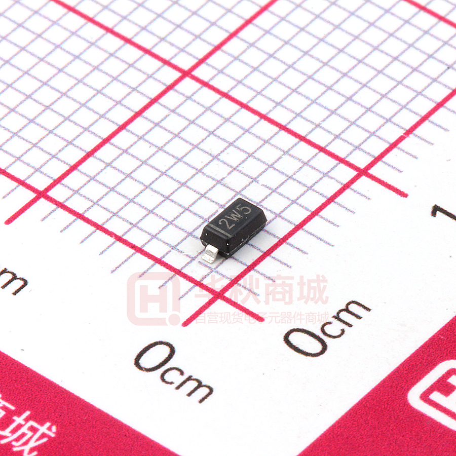

    齐纳二极管 Vz=3.9V 3.82V~3.98V Izt=5mA P=500mW SOD123
BZT52B3V9 数据手册
BZT52B2V4-BZT52B51 Surface Mount Zener Diode SOD-123 0.022(0.55) Typ. Min. 0.053(1.35) Max. Features — Planar die construction. 0.152(3.85) 0.140(3.55) — “B” for ±2% tolerance. — General purpose, medium current. — Ideally suited for automated assembly processes. 0.112(2.85) 0.100(2.55) 0.010(0.25) Min. 0.067(1.70) 0.055(1.40) 0.006(0.15) Typ. Min. Applications 0.004(0.10) Max. — Zener diode. — Ultra-small surface mount package. Dimensions in inches and (millimeters) Ordering Information Type No. Marking BZT52B2V4-BZT52B51 See table 2 Package Code SOD-123 Package Information Device Package Shipping BZT52B2V4-BZT52B51 SOD-123 3000/Tape&Reel MAXIMUM RATING @ Ta=25℃ unless otherwise specified Characteristic Symbol Value Unit VF 0.9 V Power Dissipation Pd 500 mW Thermal resistance,junction to ambient air RθjA 305 ℃/W Junction temperature Tj 150 ℃ Storage temperature range Tstg -65-150 ℃ Forward Voltage @ IF=10mA Notes: 1. Device mounted on ceramic PCB; 7.6mm x 9.4mm x 0.87mm with pad areas 25mm2 2. Short duration test pulse used to minimize self-heating effect. 3. When provided, otherwise, parts are provided with date code only, and type number identifications appears on reel only. 4. f = 1KHz ht t p : // Revision:20170701-P1 www.lgesemi .c o m mail:lge@lgesemi.com BZT52B2V4-BZT52B51 Surface Mount Zener Diode ELECTRICAL CHARACTERISTICS @ Ta=25℃ unless otherwise specified Type Number Maximum Zener Impedance Zener Voltage Range Marking Code VZ@IZT IZT Nom(V) Min(V) Max(V) mA ZZT@IZT ZZK@IZK Ω IZK mA BZT52B2V4 2WX 2.4 2.35 2.45 5 85 600 1.0 BZT52B2V7 2W1 2.7 2.65 2.75 5 83 500 1.0 BZT52B3V0 2W2 3.0 2.94 3.06 5 95 500 1.0 BZT52B3V3 2W3 3.3 3.23 3.37 5 95 500 1.0 BZT52B3V6 2W4 3.6 3.53 3.67 5 95 500 1.0 BZT52B3V9 2W5 3.9 3.82 3.98 5 95 500 1.0 BZT52B4V3 2W6 4.3 4.21 4.39 5 95 500 1.0 BZT52B4V7 2W7 4.7 4.61 4.79 5 78 500 1.0 BZT52B5V1 2W8 5.1 5 5.2 5 60 480 1.0 BZT52B5V6 2W9 5.6 5.49 5.71 5 40 400 1.0 BZT52B6V2 2WA 6.2 6.08 6.32 5 10 200 1.0 BZT52B6V8 2WB 6.8 6.66 6.94 5 8 150 1.0 BZT52B7V5 2WC 7.5 7.35 7.65 5 7 50 1.0 BZT52B8V2 2WD 8.2 8.04 8.36 5 7 50 1.0 BZT52B9V1 2WE 9.1 8.92 9.28 5 10 50 1.0 BZT52B10 2WF 10 9.8 10.2 5 15 70 1.0 BZT52B11 2WG 11 10.8 11.2 5 20 70 1.0 BZT52B12 2WH 12 11.8 12.2 5 20 90 1.0 BZT52B13 2WI 13 12.7 13.3 5 25 110 1.0 BZT52B15 2WJ 15 14.7 15.3 5 30 110 1.0 BZT52B16 2WK 16 15.7 16.3 5 40 170 1.0 BZT52B18 2WL 18 17.6 18.4 5 50 170 1.0 BZT52B20 2WM 20 19.6 20.4 5 50 220 1.0 BZT52B22 2WN 22 21.6 22.4 5 55 220 1.0 BZT52B24 2WO 24 23.5 24.5 5 80 220 1.0 BZT52B27 2WP 27 26.5 27.5 5 80 250 1.0 BZT52B30 2WQ 30 29.4 30.6 5 80 250 1.0 BZT52B33 2WR 33 32.3 33.7 5 80 250 1.0 BZT52B36 2WS 36 35.3 36.7 5 90 250 1.0 BZT52B39 2WT 39 38.2 39.8 5 90 300 1.0 BZT52B43 2WU 43 42.1 43.9 5 100 700 1.0 BZT52B47 2WV 47 46.1 47.9 5 100 750 1.0 BZT52B51 2WW 51 50 52 5 100 750 1.0 ht t p : // Revision:20170701-P1 www.lgesemi .c o m mail:lge@lgesemi.com BZT52B2V4-BZT52B51 Surface Mount Zener Diode TYPICAL CHARACTERISTICS @ Ta=25℃ unless otherwise specified PACKAGE SPQ/PCS CARTON SPQ/PCS CARTON SIZE/CM CARTON GW/KG CARTON NW/KG SOD-123 3000/REEL 90000 40X20X22 5.00 4.00 ht t p : // Revision:20170701-P1 www.lgesemi .c o m mail:lge@lgesemi.com
