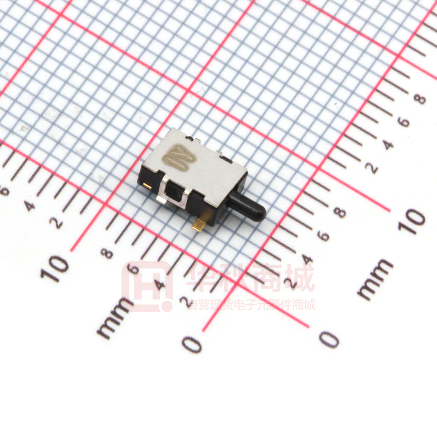

■ FEATURES
● High reliability by Gold contact
● RoHS compliant
● For detection of operation from side direction
● Automatic mounting possible
● Low profile design of 2mm
