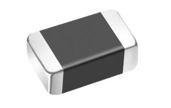

CB2012-121(f)
CB2012-121(f)
    CEC(振华)
    0805
    贴片磁珠 0805 120Ω@100MHz ±25% 700mA 150mΩ
CB2012-121(f) 数据手册
CB Series Specification 1 Scope: 2 Shape And Dimensions This specification applies to MULTILAYER CHIP FERRITE BEADS Dimensions in mm Type 3 L W T a1 ,a2 CB1005 1.0±0.15 0.5±0.15 0.5±0.15 0.25±0.15 CB1608 1.60±0.15 0.80±0.15 0.80±0.15 0.30±0.20 CB2012 2.00±0.20 1.20±0.20 0.85±0.15 0.40±0.20 CB3216 3.20±0.20 1.60±0.20 0.85±0.15 0.50±0.30 Part Numbering: Product Identification CB 2012 ① ② - 601 T (f) ③ ④ ⑤ (1) Product symbol 系列代号: (2) Dimensions 尺寸: Length 长(L)×Width 宽(W) (3) Impedance 阻抗:000:≤10Ω; (4) Packing style 包装方式: 100:10Ω 601:600Ω; 222:2200Ω B:Bulk 散装; T:Tape and reel 载带盘装 (5) Leadfree productors 无铅产品:据客户要求 4 Test Equipment □ HP4287A PACKED RF LCR METER; □ HP4338B MILLIOHM METER; □ CHEN HUA 502BC OHM METER; □ E4991A RF IMPEDANCANALYZER。 5 Rating Operating Temperature(使用温度): Storage Temperature(储存温度): 6 –40℃~+125℃ 40℃max. 70% RH Test Data For Preproduction Samples max. 通用型铁氧体叠层片式磁珠电性能 CB1005 型 产品型号 阻抗(Ω)±25% 阻抗测试频率(MHz) 直流电阻(Ω)max 额定电流(mA) CB1005-060 6 100 0.05 500 CB1005-110 11 100 0.05 500 CB1005-150 15 100 0.05 500 CB1005-220 22 100 0.10 300 CB1005-300 30 100 0.20 300 CB1005-470 47 100 0.30 300 CB1005-600 60 100 0.30 200 CB1005-800 80 100 0.35 200 CB1005-101 100 100 0.45 150 CB1005-151 150 100 0.50 150 CB1005-221 220 100 0.65 120 CB1005-301 300 100 0.70 100 CB1005-471 470 100 1.00 100 CB1005-501 500 100 1.20 100 CB1005-601 600 100 1.20 100 CB1005-801 800 100 1.50 50 CB1005-102 1000 100 1.60 50 CB1608 型 产品型号 阻抗(Ω)±25% 阻抗测试频率(MHz) 直流电阻(Ω)max 额定电流(mA) CB1608-000 <10 100 0.05 1500 CB1608-100 10 100 0.05 1500 CB1608-190 19 100 0.05 1500 CB1608-310 31 100 0.06 1000 CB1608-600 60 100 0.10 500 CB1608-700 70 100 0.15 400 CB1608-121 120 100 0.20 300 CB1608-151 150 100 0.30 300 CB1608-181 180 100 0.30 200 CB1608-221 220 100 0.40 200 CB1608-301 300 100 0.40 200 CB1608-501 500 100 0.55 200 CB1608-601 600 100 0.60 200 CB1608-751 750 100 0.60 200 CB1608-102 1000 100 0.70 150 CB1608-122 1200 100 0.80 100 CB1608-152 1500 50 1.00 100 CB1608-202 2000 50 1.20 100 CB2012 型 产品型号 阻抗(Ω)±25% 阻抗测试频率(MHz) 直流电阻(Ω)max 额定电流(mA) CB2012-000 ≤10 100 0.04 2000 CB2012-110 11 100 0.04 2000 CB2012-190 19 100 0.04 2000 CB2012-260 26 100 0.05 1500 CB2012-310 31 100 0.05 1500 CB2012-400 40 100 0.06 1000 CB2012-600 60 100 0.10 1000 CB2012-700 70 100 0.10 1000 CB2012-800 80 100 0.10 800 CB2012-121 120 100 0.15 700 CB2012-151 150 100 0.18 700 CB2012-181 180 100 0.18 600 CB2012-221 220 100 0.20 500 CB2012-301 300 100 0.20 500 CB2012-501 500 100 0.30 500 CB2012-601 600 100 0.30 500 CB2012-751 750 100 0.35 500 CB2012-102 1000 100 0.40 500 CB2012-122 1200 100 0.45 500 CB2012-152 1500 50 0.60 300 CB2012-202 2000 50 0.80 200 CB2012-252 2500 50 0.80 200 CB3216 型 7 产品型号 阻抗(Ω)±25% 阻抗测试频率(MHz) 直流电阻(Ω)max 额定电流(mA) CB3216-000 ≤10 100 0.05 2000 CB3216-100 10 100 0.05 2000 CB3216-190 19 100 0.06 1500 CB3216-260 26 100 0.06 1500 CB3216-310 31 100 0.06 1500 CB3216-600 60 100 0.10 1000 CB3216-700 70 100 0.10 1000 CB3216-800 80 100 0.10 1000 CB3216-121 120 100 0.10 600 CB3216-151 150 100 0.20 600 CB3216-201 200 100 0.20 600 CB3216-301 300 100 0.20 600 CB3216-501 500 100 0.30 600 CB3216-601 600 100 0.30 600 CB3216-751 750 100 0.35 600 CB3216-102 1000 100 0.60 500 CB3216-122 1200 100 0.60 500 CB3216-152 1500 50 0.70 200 CB3216-202 2000 50 0.70 200 CB3216-252 2500 50 0.80 200 Detail electrical characteristics CB1005 TYPE CB1608 TYPE CB2012 TYPE CB3216 TYPE
