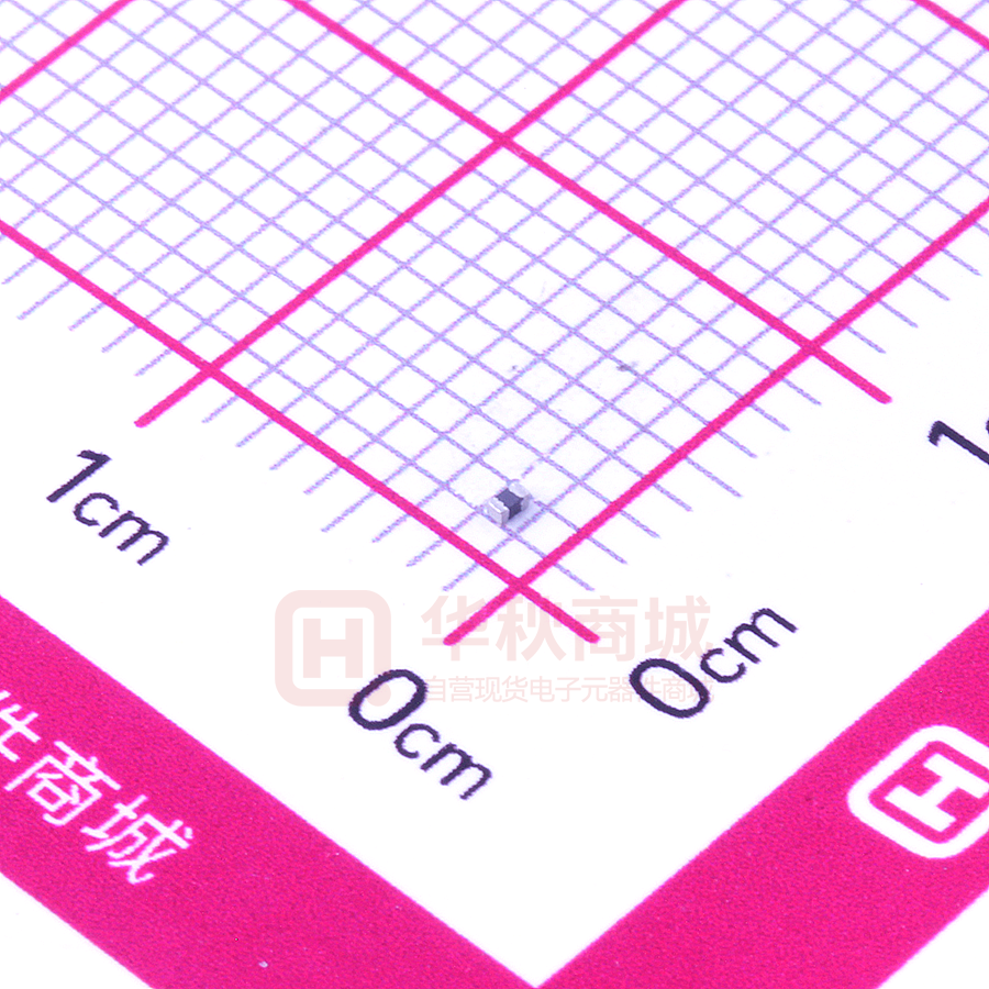

    贴片磁珠 0402 30Ω@100MHz ±25% 600mA 150mΩ
SBM1005G300HSP 数据手册
SBM Series Multilayer Chip Ferrite Bead Pb ◆ Features 、Internal silver printed layers and magnetic shielded structures to minimize crosstalk 2、It has sharp impedance characteristics at 1 desirable frequency and does not affect the signal frequency 3 SMD Type & suitable for reflow and wave soldering 4 Four types material and wide range of 、 、 impedance values for various applications 5、Excellent solderability and heat resistance 6、RoHS Compliant. ◆ PRODUCT IDENTIFICATION ◆ Application Filtering between analog and digital circuitry, clock Generation circuitry, I/O interconnects, isolation between RF noisy circuits and logic devices susceptible to functional degradation, power supply filtering to prevent conducted RF energy from corrupting the power generation circuitry, high frequency EMI prevention of computer, printers, VCRs, TVs and portable telephones. SBM 1608 (1) (2) K (3) 601 A S P (4) (5) (6) (7) (1) Series Type (2) Chip Size mm :Length X Width (3) Material Code ( ) (4) ; Nominal Impedance:601=600Ω 102=1000Ω (5) Rated Curren :A=50mA; B=100mA;C=150mA; D=200mA;E=300mA;F=400mA; G=500mA;H=600mA;I=700mA; J=800mA;K=900mA;L=1000mA. ◆ Dimensions Unit: mm (6) Company Code (7) Packaging Size(EIA) 0603 (0201) 1005 (0402) 1608 (0603) 2012 (0805) L 0.60±0.03 1.00±0.10 1.60±0.150 2.00±0.20 W 0.30±0.03 0.50±0.10 0.80±0.150 1.25±0.20 T 0.30±0.03 0.50±0.10 0.80±0.150 0.90±0.20 E 0.15±0.05 0.25±0.10 0.30±0.20 0.50±0.30 Rev.01 Page 1 of 10 :E- Embossed plastic tape, 7" reel P – Embossed paper tape, 7" reel www. sunltech.com SBM Series ◆ Specification Part Number Impedance (Ω) Test Frequency (MHz) DCR Max. (Ω) Rated Current (mA) SBM0603 Series SBM0603G100DSP 10±25% 100 0.25 200 SBM0603G220DSP 22±25% 100 0.45 200 SBM0603G330CSP 33±25% 100 0.55 150 SBM0603G600DSP 60±25% 100 0.40 200 SBM0603G121DSP 120±25% 100 0.80 200 SBM0603G241BSP 240±25% 100 1.00 100 SBM1005G050HSP 0~15 100 0.15 600 SBM1005G300HSP 30±25% 100 0.15 600 SBM1005G600HSP 60±25% 100 0.20 600 SBM1005G750GSP 75±25% 100 0.30 500 SBM1005G121ESP 120±25% 100 0.40 400 SBM1005G221DSP 220±25% 100 0.70 200 SBM1005K301DSP 300±25% 100 0.80 200 SBM1005K421CSP 420±25% 100 0.90 150 SBM1005K601CSP 600±25% 100 1.00 150 SBM1005K751BSP 750±25% 100 1.10 100 SBM1005K102BSP 1000±25% 100 1.20 100 SBM1005B152BSP 1500±25% 100 1.40 100 SBM1005B182ASP 1800±25% 100 1.80 50 SBM1608G050JSP 0~15 100 0.05 800 SBM1608G220JSP 22±25% 100 0.05 800 SBM1608G600HSP 60±25% 100 0.10 600 SBM1608G121HSP 120±25% 100 0.20 600 SBM1608G221FSP 220±25% 100 0.30 500 SBM1608G331FSP 330±25% 100 0.35 500 SBM1608G471ESP 470±25% 100 0.45 400 SBM1608G601ESP 600±25% 100 0.50 300 SBM1608G102DSP 1000±25% 100 0.60 200 SBM1608G152CSP 1500±25% 100 0.75 150 SBM1608G182CSP 1800±25% 100 0.90 150 SBM1005 Series SBM1608 Series Rev.01 Page 2 of 10 www. sunltech.com SBM Series ◆ Specification Part Number Impedance (Ω) Test Frequency (MHz) DCR Max. (Ω) Rated Current (mA) SBM1608 Series SBM1608K202BSP 2000±25% 100 1.00 100 SBM1608K222BSP 2200±25% 100 1.00 100 SBM1608K252BSP 2500±25% 100 1.20 100 SBM1608K272BSP 2700±25% 100 1.40 100 SBM2012G050LSP 0~15 100 0.07 1000 SBM2012G300LSP 30±25% 100 0.10 1000 SBM2012G600JSP 60±25% 100 0.20 800 SBM2012K121HSP 120±25% 100 0.22 600 SBM2012K221HSP 220±25% 100 0.25 600 SBM2012K301HSP 300±25% 100 0.30 600 SBM2012K421HSP 420±25% 100 0.30 600 SBM2012K601HSP 600±25% 100 0.35 600 SBM2012K102FSP 1000±25% 100 0.40 500 SBM2012K152DSP 1500±25% 100 0.45 200 SBM2012K222DSP 2200±25% 100 0.60 200 SBM2012K252DSP 2500±25% 100 0.70 200 SBM2012K272DSP 2700±25% 100 0.80 200 SBM2012 Series ◆ General Technical Data Storage Condition ℃ ~ +125℃ Less than 40℃ and 70% RH Soldering Method Reflow or Wave Soldering Operating Temperature Range Rev.01 -55 Page 3 of 10 www. sunltech.com SBM Series ◆ Characteristics SBM0603 TYPE SBM0603G100DSP SBM0603G220DSP SBM0603G330CSP SBM0603G600DSP SBM0603G121DSP SBM0603G241BSP SBM1005 TYPE SBM1005G050HSP Rev.01 SBM1005G300HSP Page 4 of 10 SBM1005G750HSP www. sunltech.com SBM Series ◆ Characteristics SBM1005 TYPE SBM1005K121ESP SBM1005K421CSP SBM1005B152BSP Rev.01 SBM1005K221DSP SBM1005K601CSP SBM1005K301DSP SBM1005K102BSP SBM1005B182ASP Page 5 of 10 www. sunltech.com SBM Series ◆ Characteristics SBM1608 TYPE SBM1608F050FSP SBM1608F100FSP SBM1608F220FSP SBM1608F470DSP SBM1608F750DSP SBM1608F121DSP SBM1608G050JSP SBM1608G220JSP SBM1608G600HSP SBM1608G121HSP SBM1608G221FSP SBM1608G331FSP ◆ Characteristics Rev.01 Page 6 of 10 www. sunltech.com SBM Series ◆ Characteristics SBM1608 TYPE Rev.01 SBM1608G471ESP SBM1608G601DSP SBM1608G102CSP SBM1608K121HSP SBM1608K221FSP SBM1608K331FSP SBM1608K471ESP SBM1608K601DSP SBM1608K102DSP SBM1608K152DSP SBM1608K202DSP SBM1608K222DSP Page 7 of 10 www. sunltech.com SBM Series ◆ Characteristics SBM1608 TYPE SBM1608K252DSP SBM1608K272DSP SBM2012 TYPE Rev.01 SBM2012G050LSP SBM2012G300LSP SBM2012G600JSP SBM2012G121HSP SBM2012G221HSP SBM2012G301HSP SBM2012G421HSP SBM2012G601HSP SBM2012G102FSP Page 8 of 10 www. sunltech.com SBM Series ◆ Characteristics SBM2012 TYPE SBM2012K121HSP SBM2012K221HSP SBM2012K301HSP SBM2012K421HSP SBM2012K601HSP SBM2012K102FSP SBM2012K152DSP SBM2012K222DSP SBM2012K252DSP SBM2012K272DSP Rev.01 Page 9 of 10 www. sunltech.com SBM Series ◆ Package Size EIA (EIA) Standard Packing Quantity (pcs / reel) Rev.01 0603 (0201) 1005 (0402) 1608 (0603) 2012 (0805) 15,000 10,000 4,000 4,000 Page 10 of 10 www. sunltech.com
