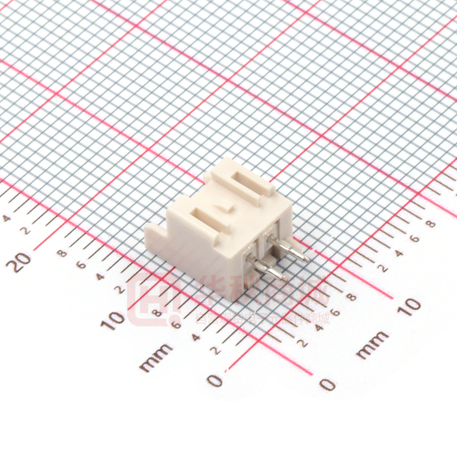

    线对板连接器 2Pin(1x2) P=2.50mm 直插
B02B-XASK-1-A 数据手册
XA CONNECTOR Emboss Tape Radial Tape 2.5 mm pitch/Disconnectable Crimp style connectors Specifications • Current rating: 3 A AC/DC (AWG #22, #20) • Voltage rating: 250 V AC/DC • Temperature range: -25℃ to +85℃ (including temperature rise in applying electrical current) • Contact resistance: Initial value/ 10 mΩ max. After environmental tests/ 20 mΩ max. • Insulation resistance: 1,000 MΩ min. • Withstanding voltage: 1,000 VAC/minute • Applicable wire: AWG #28 to #20 • Applicable PC board thickness: 1.6 mm XA CONNECTOR * In using the products,refer to "Handling Precautions for Terminals and Connectors" described on our website (Technical documents of Product information page). * RoHS2 compliance * Dimensional unit: mm * Contact JST for details. Secure locking device Solder crack preventive material Low insertion force Insertion guide mechanism Applicable to automatic board mounting machine ● Polarizing boss ● ● ● ● ● Standards ® Recognized E 60389 Certified LR 20812 R9851220 ® ® ® ® PC board layout and Assembly layout Side entry type (6.9) 2.5 min. (15.1) (8.1) 6.5 ±0.05 φ1.2+0.1  0 2 ±0.05 2.5 +0.1 φ0.9 0 ±0.05 D±0.05 2.8±0.05 (11.3) +0.1 φ0.9 0 with a boss 1.6 ±0.05 without a boss 2.7 min. Top entry type 2.7 9.2 2.5 ±0.05 1.6 ±0.05 2.5±0.05 Dimension D: Refer to the Model No. chart of header side entry type. A±0.05 2.5 ±0.03 (1.4) 4.65 4.25 ±0.1 (1) ±0.1 3.3 ±0.1 3.3 1.2 ±0.1 (8) ±0.1 6.2 ±0.1 0.5 ±0.03 0.5 ±0.03 1.3 ±0.1 (11.9) Top entry type 6.2 ±0.1 +0.1 φ0.9 0 2.3 ±0.05 Note: 1. The above figure is the figure viewed from the connector mounting side . 2. Tolerances are non-cumulative: ± 0.05 mm for all centers. 3. Hole dimensions differ according to the type of PC board and piercing method. The dimensions above should serve as a guideline. Contact JST for details. 1 XA CONNECTOR Contact Applicable wire Model No. 1.9 SXA-001T-P0.6 SXA-01T-P0.6 SXA-001T-P0.6L 6.5 3.1 1.3 Q’ty/reel mm2 AWG # Insulation O.D. (mm) 0.08~0.33 28~22 0.8~1.9 8,000 0.22~0.5 24~20 1.5~1.9 8,000 0.13~0.33 26~22 1.3~1.7 8,000 Material and Finish 1.6 Phosphor bronze, tin-plated (reflow treatment) 2.3 RoHS2 compliance Note :1 .SXA-001T-P0.6L is low-insertion force type contact, for easier insertion/withdrawal, which would be less resistant to the vibration. The crimp height is different from the standard contact. Note :2.Contact JST for gold-plated products. Crimping machine Crimp applicator Contact SXA-001T-P0.6 SXA-01T-P0.6 AP-K2N MKS-L SXA-001T-P0.6L Applicator Dies Crimp applicator with dies MK/SXA/M-001-06 APLMK SXA/M001-06 MK/SXA/M-01-06 APLMK SXA/M01-06 MK/SXA/M-001-06L APLMK SXA/M001-06L Note: Contact JST for fully automatic crimping applicator. Housing Standard type No. of circuits 2 3 4 5 6 7 8 9 10 11 12 13 14 15 18 20 B 2.5 2.4 9.5 6.9 A Circuit No.1 5.8 Retainer mountable type XAP-02V-1 XAP-03V-1 XAP-04V-1 XAP-05V-1 XAP-06V-1 XAP-07V-1 XAP-08V-1 XAP-09V-1 XAP-10V-1 XAP-11V-1 XAP-12V-1 XAP-13V-1 XAP-14V-1 XAP-15V-1 XAP-20V-1 Dimensions (mm) Retainer mountable type XARP-02V XARP-03V XARP-04V XARP-05V XARP-06V XARP-07V XARP-08V XARP-09V XARP-10V XARP-11V XARP-12V XARP-13V XARP-14V XARP-15V XARP-18V - A B 2.5 5.0 7.5 10.0 12.5 15.0 17.5 20.0 22.5 25.0 27.5 30.0 32.5 35.0 42.5 47.5 7.3 9.8 12.3 14.8 17.3 19.8 22.3 24.8 27.3 29.8 32.3 34.8 37.3 39.8 47.3 52.3 1,000 1,000 1,000 1,000 1,000 1,000 1,000 1,000 1,000 1,000 1,000 1,000 500 500 500 Material and Finish 7.4 Circuit No.1 0.6 RoHS2 compliance As the color identification, the following alphabet shall be put in the underlined part. For availability, delivery and minimum order quantity, contact JST. 10.5 2.5 2.4 ex. XAP-02V-1-oo(blank)...natural (white) K...black R...red E...blue Y...yellow L...lemon yellow M...green O...orange N...brown H...gray P...purple LE...light blue PK...pink FY...vivid yellow Z...ivory 5.8 ex. XARP-02V-oo (blank)...natural (white) K...black R...red E...blue L...lemon yellow 2 Q’ty/bag Standard Retainer type mountable type PA 66, UL94V-0, natural (white) B A Model No. Standard type 1,000 1,000 1,000 1,000 1,000 1,000 1,000 1,000 1,000 1,000 1,000 1,000 1,000 1,000 500 - XA CONNECTOR 5 6 7 8 9 10 11 12 13 14 2.5 15 XMS-02V XMS-03V XMS-04V XMS-05V XMS-06V XMS-07V XMS-08V XMS-09V XMS-10V XMS-11V XMS-12V XMS-13V XMS-14V 7.8 XMS-15V 2.5 1,000 5.0 1,000 7.5 1,000 10.0 1,000 No. of circuits 12.5 1,000 15.0 1,000 2 17.5 1,000 20.0 1,000 22.5 1,000 25.0 1,000 27.5 1,000 30.0 1,000 9 32.5 1,000 10 35.0 1,000 11 A 4 A 2.5 2 Retainer 3 Model No. 0.95 No. of circuits Q’ty/bag 3 4 5 6 7 8 12 Material and Finish 13 Glass-filled PA 66, UL94V-0, natural (ivory) 14 15 RoHS2 compliance Through-hole type shrouded header No. of circuits 6.4 Circuit No.1 2 3 4 5 6 6.5 7 8 9 3.4 8.8 2.5 1,000 5.0 1,000 7.5 1,000 10.0 1,000 12.5 1,000 15.0 1,000 17.5 1,000 20.0 1,000 22.5 1,000 25.0 1,000 27.5 1,000 30.0 1,000 32.5 1,000 35.0 1,000 Q’ty/bag Material and Finish B 10 φ0.6 3.2 11 12 13 A 14 15 20 Top entry type with a boss Dimensions (mm) Model No. Top entry type Without a boss B02B-XASK-1 B03B-XASK-1 B04B-XASK-1 B05B-XASK-1 B06B-XASK-1 B07B-XASK-1 B08B-XASK-1 B09B-XASK-1 B10B-XASK-1 B11B-XASK-1 B12B-XASK-1 B13B-XASK-1 B14B-XASK-1 B15B-XASK-1 B20B-XASK-1 With a boss B02B-XASK-1-A B03B-XASK-1-A B04B-XASK-1-A B05B-XASK-1-A B06B-XASK-1-A B07B-XASK-1-A B08B-XASK-1-A B09B-XASK-1-A B10B-XASK-1-A B11B-XASK-1-A B12B-XASK-1-A B13B-XASK-1-A B14B-XASK-1-A B15B-XASK-1-A B20B-XASK-1-A A B Q’ty/box 2.5 7.5 1,000 5.0 10.0 400 7.5 12.5 400 10.0 15.0 400 12.5 17.5 400 15.0 20.0 250 17.5 22.5 250 20.0 25.0 250 22.5 27.5 250 25.0 30.0 200 27.5 32.5 200 30.0 35.0 100 32.5 37.5 100 35.0 40.0 100 47.5 52.5 100 Material and Finish B 6.4 6.5 3.4 1.5 8.8 Circuit No.1 2.5 A Glass-filled PA 66, UL94V-0, natural (ivory) Top entry type without a boss 2.5 Model No. XMS-02V XMS-03V XMS-04V XMS-05V XMS-06V XMS-07V XMS-08V XMS-09V XMS-10V XMS-11V XMS-12V XMS-13V XMS-14V XMS-15V φ0.6 φ1 A 1.6 1.6 3.2 Side entry type with a hook B 12.6 Circuit No.1 Pin: Copper alloy, copper-undercoated, tin-plated (reflow treatment) Wafer: Glass-filled PA 66, UL94V-0, natural (ivory) RoHS2 compliance  This product displays (LF)(SN) on a label. Note: Contact JST for gold-plated products. Model No. No. of circuits Side entry type with a hook 2 S02B-XASS-1 3 S03B-XASK-1 4 S04B-XASK-1 5 S05B-XASK-1 6 S06B-XASK-1 7 S07B-XASK-1 8 S08B-XASK-1 9 S09B-XASK-1 10 S10B-XASK-1 11 S11B-XASK-1 12 S12B-XASK-1 13 S13B-XASK-1 14 S14B-XASK-1 A Dimensions (mm) B D Q’ty/box 2.5 7.5 1.25 250 5.0 10.0 2.50 250 7.5 12.5 3.75 200 10.0 15.0 5.00 200 12.5 17.5 6.25 200 15.0 20.0 7.50 200 17.5 22.5 8.75 100 20.0 25.0 10.00 100 22.5 27.5 11.25 100 25.0 30.0 12.50 100 27.5 32.5 13.75 100 30.0 35.0 15.00 100 32.5 37.5 16.25 100 Material and Finish φ0.6 2.5 A 3.5 7.6 3.2 H JST Circuit No.1 Mark Pin: Copper alloy, copper-undercoated, tin-plated (reflow treatment) Wafer: Glass-filled PA 66, UL94V-0, natural (ivory) 2.7 1.8 9.2 RoHS2 compliance  This product displays (LF)(SN) on a label. Note: 1 . Dimension D...See PC board layout. 2. Contact JST for gold-plated products. As the color identification, the following alphabet shall be put in the underlined part. For availability, delivery and minimum order quantity, contact JST. ex. S02B-XASK-1S...natural (ivory) K...black R...red E...blue M...green Y...yellow 3 XA CONNECTOR Through-hole type shrouded header N type No. of circuits Top entry type without a boss 2 3 B 6.4 Circuit No.1 4 5 6 7 9 6.5 8.8 8 10 11 3.4 12 13 2.5 φ0.6 3.2 A 14 15 18 Model No. Dimensions (mm) Top entry type Q’ty/box A B Without a boss With a boss 1,000 2.5 7.5 B02B-XASK-1N-A B02B-XASK-1N 400 5.0 10.0 B03B-XASK-1N-A B03B-XASK-1N 400 7.5 12.5 B04B-XASK-1N-A B04B-XASK-1N 400 10.0 15.0 B05B-XASK-1N-A B05B-XASK-1N 400 12.5 17.5 B06B-XASK-1N-A B06B-XASK-1N 250 15.0 20.0 B07B-XASK-1N-A B07B-XASK-1N 250 17.5 22.5 B08B-XASK-1N-A B08B-XASK-1N 250 20.0 25.0 B09B-XASK-1N-A B09B-XASK-1N 22.5 250 27.5 B10B-XASK-1N-A B10B-XASK-1N 25.0 200 30.0 B11B-XASK-1N-A B11B-XASK-1N 27.5 200 32.5 B12B-XASK-1N-A B12B-XASK-1N 30.0 100 35.0 B13B-XASK-1N-A B13B-XASK-1N 100 32.5 37.5 B14B-XASK-1N-A B14B-XASK-1N 100 35.0 40.0 B15B-XASK-1N-A B15B-XASK-1N 100 42.5 47.5 B18B-XASK-1N Material and Finish Pin: Copper alloy, copper-undercoated, tin-plated (reflow treatment) Wafer: Glass-filled PA 66, UL94V-0, natural (white) Top entry type with a boss RoHS2 compliance This product displays (LF)(SN) on a label. B 6.4 Circuit No.1 As the color identification, the following alphabet shall be put in the underlined part. For availability, delivery and minimum order quantity, contact JST. 2.5 φ0.6 φ1 A 1.6 6.5 1.6 3.2 No. of circuits 2 3 4 Side entry type without a hook 5 6 7 12.6 B Circuit No.1 8 9 10 11 12 13 7.6 H JST 14 4 φ0.6 2.5 A Model No. Side entry type without a hook S02B-XASS-1N-BN S03B-XASS-1N-BN S04B-XASS-1N-BN S05B-XASS-1N-BN S06B-XASS-1N-BN S07B-XASS-1N-BN S08B-XASS-1N-BN S09B-XASS-1N-BN S10B-XASS-1N-BN S11B-XASS-1N-BN S12B-XASS-1N-BN S13B-XASS-1N-BN S14B-XASS-1N-BN Dimensions (mm) A B Q’ty/box 02.5 7.5 250 05.0 10.0 250 07.5 12.5 200 10.0 15.0 200 12.5 17.5 200 15.0 20.0 200 17.5 22.5 100 20.0 25.0 100 22.5 27.5 100 25.0 30.0 100 27.5 32.5 100 30.0 35.0 100 32.5 37.5 100 Material and Finish 3.2 Circuit No.1 Mark B02B-XASK-1N-AS...natural (white) K...black R...red E...blue Y...yellow L...lemon yellow M...green O...orange N...brown H...gray P...purple LE...light blue PK...pink FY...vivid yellow 3.4 1.5 8.8 ex. 9.2 Pin: Copper alloy, copper-undercoated, tin-plated (reflow treatment) Wafer: Glass-filled PA 66, UL94V-0, natural (white) RoHS2 compliance This product displays (LF)(SN) on a label. Note: 1. As for side entry type, we recommend to use a product with a boss (hook) because stress is applied directly to fillet part when handling the wire. When using the side entry type product without a boss (hook), please handle the wire with care. XA CONNECTOR SMT type shrouded header No. of circuits B 1.4 A 8 2 1 3 Circuit No.1 4 5 6 7.1 9.4 7 8 9 12 13 15 A B Q’ty/reel 2.5 10.0 500 5.0 12.5 500 7.5 15.0 500 10.0 17.5 500 12.5 20.0 500 15.0 22.5 500 17.5 25.0 500 20.0 27.5 500 27.5 35.0 500 30.0 37.5 500 35.0 42.5 500 Material and Finish B 1.4 A Dimensions (mm) Model No. Top entry type BM02B-XASS-TF BM03B-XASS-TF BM04B-XASS-TF BM05B-XASS-TF BM06B-XASS-TF BM07B-XASS-TF BM08B-XASS-TF BM09B-XASS-TF BM12B-XASS-TF BM13B-XASS-TF BM15B-XASS-TF 8 Pin: Copper alloy, copper-undercoated, tin-plated (reflow treatment) Wafer: PA, UL94V-0, natural Solder tab: Brass, copper-undercoated, tin-plated (reflow treatment) 1 Circuit No.1 7.1 9.4 RoHS2 compliance This product displays (LF)(SN) on a label. As the color identification, the following alphabet shall be put in the underlined part. For availability, delivery and minimum order quantity, contact JST. ex. BM02B-XASS-TFS...natural K...black R...red E...blue Through-hole type shrouded header on radial-tape Model No. Dimensions (mm) No. of Q’ty/box circuits Top entry type without a boss Top entry type with a boss A B 2.5 7.5 1,000 2 B02B-XASS-1-T 5.0 10.0 1,000 3 B03B-XASS-1-T B03B-XASS-1-A-T 7.5 12.5 500 4 B04B-XASS-1-T B04B-XASS-1-A-T 10.0 15.0 500 5 B05B-XASS-1-T B05B-XASS-1-A-T 12.5 17.5 500 6 B06B-XASS-1-T B06B-XASS-1-A-T 15.0 20.0 500 7 B07B-XASS-1-T B07B-XASS-1-A-T 17.5 22.5 500 8 B08B-XASS-1-T B08B-XASS-1-A-T Top entry type without a boss B A Circuit No.1 6.4 6.5 8.8 2.5 2.8 Material and Finish φ0.6 Pin: Copper alloy, copper-undercoated, tin-plated (reflow treatment) Wafer: Glass-filled PA 66, UL94V-0, natural (ivory) 3.2 RoHS2 compliance This product displays (LF)(SN) on a label. As the color identification, the following alphabet shall be put in the underlined part. For availability, delivery and minimum order quantity, contact JST. ex. B03B-XASS-1-A-TS...natural (ivory) R...red E...blue M...green Taping specifications Top entry type with a boss B A 6.4 Circuit No.1 6.4 6 3.2 18 1.6 2.8 1.6 φ0.6 20 6.5 8.8 1.5 2.5 12.7 φ4 Note: Conforms to JIC C 0806 of "Tape packaging of components with unidirectional leads on continuous tapes". 5 XA CONNECTOR Packaging specifications Package type Distance between folds Box size Distance between the end of the tape and the first connector’s center line (either end) 2, 3 circuits Quantity 4 to 8 circuits D H TERMIN ALS & CONN ECTORS W Distance between the end of the tape and the first connector's center line (either end) 6 316(W) × 45(D) × 330(H) mm 19.05 mm 1,000 pcs./box 500 pcs./box Note: Products of different packaging specifications are also available. Contact JST for details. R Tail tape Flat pack (zigzag folded) 24 indexing holes per fold (304.8 mm) Leader tape
