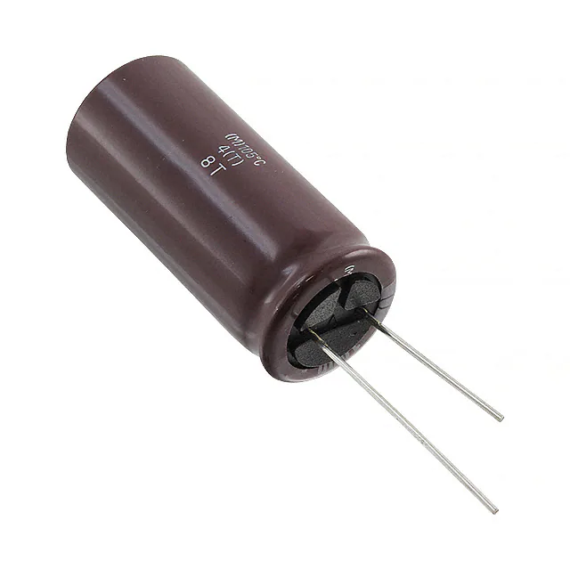

EKYB101ELL102MM40S 数据手册
MINIATURE ALUMINUM ELECTROLYTIC CAPACITORS KYB Low impedance, 105℃ Series KYB ・Low impedance, high ripple and long life from KYA series ・Newly innovative electrolyte is employed to minimize impedance ・Endurance with ripple current : 4,000 to 10,000 hours at 105℃ ・Non solvent resistant type ・RoHS2 Compliant Lower Z KYA ◆SPECIFICATIONS Items Characteristics Category Temperature Range Rated Voltage Range Capacitance Tolerance Leakage Current -40 to +105℃ 6.3 to 100Vdc (at 20℃, 120Hz) ±20% (M) I=0.01CV or 3µA, whichever is greater. Where, I : Max. leakage current (µA), C : Nominal capacitance (µF), V : Rated voltage (V) (at 20℃ after 2 minutes) Rated voltage (Vdc) 6.3V 10V 16V 25V 35V 50V 63V 80V 100V tanδ (Max.) 0.22 0.19 0.16 0.14 0.12 0.10 0.09 0.09 0.08 When nominal capacitance exceeds 1,000µF, add 0.02 to the value above for each 1,000µF increase. (at 20℃, 120Hz) Rated voltage (Vdc) 6.3V 10V 16V 25V 35V 50V 63V 80V 100V Z(-25℃)/Z(+20℃) 4 3 2 2 2 2 2 2 2 Z(-40℃)/Z(+20℃) 8 6 4 3 3 3 3 3 3 (at 120Hz) The following specifications shall be satisfied when the capacitors are restored to 20℃ after subjected to DC voltage with the rated ripple current is applied (the peak voltage shall not exceed the rated voltage) for the specified period of time at 105℃. Rated Voltage(Vdc) 6.3 to 10Vdc 16 to 100Vdc Time φ5: 4,000hours φ6.3 & 8: 6,000hours φ10 to 18: 8,000hours φ5: 5,000hours φ6.3 & 8: 7,000hours φ10 to 18: 10,000hours Capacitance change ≦±30% of the initial value ≦±25% of the initial value D.F. (tanδ) ≦200% of the initial specified value ≦200% of the initial specified value Leakage current ≦The initial specified value ≦The initial specified value The following specifications shall be satisfied when the capacitors are restored to 20℃ after exposing them for 500 hours at 105℃ without voltage applied. Before the measurement, the capacitor shall be preconditioned by applying voltage according to Item 4.1 of JIS C 5101-4. Capacitance change ≦±25% of the initial value D.F. (tanδ) ≦200% of the initial specified value Leakage current ≦The initial specified value Dissipation Factor (tanδ) Low Temperature Characteristics (Max. Impedance Ratio) Endurance Shelf Life ◆DIMENSIONS [mm] φd Sleeve (PET : Brown) F±0.5 Code : E F±0.5 ●Terminal φD φd φD' F φD' L' Vent (Exceptφ5 &φ6.3) 15min. 4min. (φ5 to φ10) (φ12.5 to φ18) L' 5 0.5 2.0 6.3 0.5 2.5 10 12.5 8 0.6 0.6 0.6 3.5 5.0 5.0 φD+0.5max. L+1.5max. 16 0.8 7.5 18 0.8 7.5 Gas escape end seal ◆PART NUMBERING SYSTEM 1 2 3 4 E KYB 5 6 7 8 E 9 10 11 12 13 14 M 15 16 17 18 Supplement code Size code Capacitance tolerance code Capacitance code (ex. 6.8µF:6R8, 39µF:390, 470µF:471) Lead forming·taping code Terminal code Voltage code (ex. 6.3V:6R3, 50V:500) Series code Category Please refer to "Product code guide (radial lead type)" Product specifications in this catalog are subject to change without notice.Request our product specifications before purchase and/or use. Please use our products based on the information contained in this catalog and product specifications. CAT. No. E1001V 2021 MINIATURE ALUMINUM ELECTROLYTIC CAPACITORS Low impedance, 105℃ KYBSeries ◆STANDARD RATINGS WV (Vdc) Cap (µF) Case size φD×L(mm) 20℃ 180 390 820 1,200 1,200 1,500 1,800 2,200 2,700 3,300 3,900 4,700 6.3 6,800 6,800 8,200 8,200 10,000 10,000 12,000 12,000 15,000 15,000 18,000 18,000 22,000 120 330 560 820 1,000 1,000 1,200 1,800 2,200 2,700 2,700 3,900 10 4,700 4,700 5,600 6,800 6,800 6,800 8,200 8,200 10,000 10,000 12,000 12,000 15,000 120 270 470 680 680 820 1,000 16 1,500 1,800 2,200 2,200 3,300 3,900 3,900 5×11 6.3×11 8×11.5 8×15 10×12.5 8×20 10×16 10×20 10×25 10×30 12.5×20 12.5×25 12.5×30 16×20 12.5×35 18×20 12.5×40 16×25 16×31.5 18×25 16×35.5 18×31.5 16×40 18×35.5 18×40 5×11 6.3×11 8×11.5 8×15 8×20 10×12.5 10×16 10×20 10×25 10×30 12.5×20 12.5×25 12.5×30 16×20 12.5×35 12.5×40 16×25 18×20 16×31.5 18×25 16×35.5 18×31.5 16×40 18×35.5 18×40 5×11 6.3×11 8×11.5 8×15 10×12.5 8×20 10×16 10×20 10×25 10×30 12.5×20 12.5×25 12.5×30 16×20 Rated ripple current (mArms/ -10℃ 105℃, 100kHz) Impedance (Ω max./100kHz) 0.29 0.15 0.087 0.069 0.064 0.060 0.049 0.037 0.031 0.027 0.027 0.024 0.021 0.025 0.018 0.021 0.017 0.020 0.016 0.017 0.014 0.014 0.013 0.012 0.011 0.29 0.15 0.087 0.069 0.060 0.064 0.049 0.037 0.031 0.027 0.027 0.024 0.021 0.025 0.018 0.017 0.020 0.021 0.016 0.017 0.014 0.014 0.013 0.012 0.011 0.29 0.15 0.087 0.069 0.064 0.060 0.049 0.037 0.031 0.027 0.027 0.024 0.021 0.025 1.2 0.60 0.35 0.28 0.26 0.24 0.20 0.15 0.13 0.11 0.11 0.096 0.084 0.10 0.072 0.084 0.068 0.080 0.064 0.068 0.056 0.056 0.052 0.048 0.044 1.2 0.60 0.35 0.28 0.24 0.26 0.20 0.15 0.13 0.11 0.11 0.096 0.084 0.10 0.072 0.068 0.080 0.084 0.064 0.068 0.056 0.056 0.052 0.048 0.044 1.2 0.60 0.35 0.28 0.26 0.24 0.20 0.15 0.13 0.11 0.11 0.096 0.084 0.10 340 540 840 1,050 1,050 1,210 1,400 1,650 1,910 2,230 2,230 2,530 2,860 2,610 3,140 3,000 3,640 3,140 3,610 3,530 4,080 4,220 4,220 4,280 4,700 340 540 840 1,050 1,210 1,050 1,400 1,650 1,910 2,230 2,230 2,530 2,860 2,610 3,140 3,640 3,140 3,000 3,610 3,530 4,080 4,220 4,220 4,280 4,700 340 540 840 1,050 1,050 1,210 1,400 1,650 1,910 2,230 2,230 2,530 2,860 2,610 Part No. WV (Vdc) Cap (µF) Case size φD×L(mm) 20℃ EKYB6R3E□□181ME11D EKYB6R3E□□391MF11D EKYB6R3E□□821MHB5D EKYB6R3E□□122MH15D EKYB6R3E□□122MJC5S EKYB6R3E□□152MH20D EKYB6R3E□□182MJ16S EKYB6R3E□□222MJ20S EKYB6R3E□□272MJ25S EKYB6R3E□□332MJ30S EKYB6R3E□□392MK20S EKYB6R3E□□472MK25S EKYB6R3E□□682MK30S EKYB6R3E□□682ML20S EKYB6R3E□□822MK35S EKYB6R3E□□822MM20S EKYB6R3E□□103MK40S EKYB6R3E□□103ML25S EKYB6R3E□□123MLN3S EKYB6R3E□□123MM25S EKYB6R3E□□153MLP1S EKYB6R3E□□153MMN3S EKYB6R3E□□183ML40S EKYB6R3E□□183MMP1S EKYB6R3E□□223MM40S EKYB100E□□121ME11D EKYB100E□□331MF11D EKYB100E□□561MHB5D EKYB100E□□821MH15D EKYB100E□□102MH20D EKYB100E□□102MJC5S EKYB100E□□122MJ16S EKYB100E□□182MJ20S EKYB100E□□222MJ25S EKYB100E□□272MJ30S EKYB100E□□272MK20S EKYB100E□□392MK25S EKYB100E□□472MK30S EKYB100E□□472ML20S EKYB100E□□562MK35S EKYB100E□□682MK40S EKYB100E□□682ML25S EKYB100E□□682MM20S EKYB100E□□822MLN3S EKYB100E□□822MM25S EKYB100E□□103MLP1S EKYB100E□□103MMN3S EKYB100E□□123ML40S EKYB100E□□123MMP1S EKYB100E□□153MM40S EKYB160E□□121ME11D EKYB160E□□271MF11D EKYB160E□□471MHB5D EKYB160E□□681MH15D EKYB160E□□681MJC5S EKYB160E□□821MH20D EKYB160E□□102MJ16S EKYB160E□□152MJ20S EKYB160E□□182MJ25S EKYB160E□□222MJ30S EKYB160E□□222MK20S EKYB160E□□332MK25S EKYB160E□□392MK30S EKYB160E□□392ML20S 16 25 35 50 4,700 4,700 5,600 5,600 6,800 6,800 8,200 8,200 10,000 10,000 12,000 82 150 330 390 470 560 680 1,000 1,200 1,500 1,500 2,200 2,700 2,700 3,300 3,300 3,900 3,900 4,700 4,700 5,600 6,800 6,800 8,200 47 100 180 270 330 330 470 680 820 1,000 1,000 1,500 1,800 1,800 2,200 2,200 2,700 2,700 3,300 3,300 3,900 4,700 4,700 5,600 27 56 100 150 150 12.5×35 18×20 12.5×40 16×25 16×31.5 18×25 16×35.5 18×31.5 16×40 18×35.5 18×40 5×11 6.3×11 8×11.5 8×15 10×12.5 8×20 10×16 10×20 10×25 10×30 12.5×20 12.5×25 12.5×30 16×20 12.5×35 18×20 12.5×40 16×25 16×31.5 18×25 16×35.5 16×40 18×31.5 18×35.5 5×11 6.3×11 8×11.5 8×15 8×20 10×12.5 10×16 10×20 10×25 10×30 12.5×20 12.5×25 12.5×30 16×20 12.5×35 18×20 12.5×40 16×25 16×31.5 18×25 16×35.5 16×40 18×31.5 18×35.5 5×11 6.3×11 8×11.5 8×15 10×12.5 Rated ripple current (mArms/ -10℃ 105℃, 100kHz) Impedance (Ω max./100kHz) 0.018 0.021 0.017 0.020 0.016 0.017 0.014 0.014 0.013 0.012 0.011 0.29 0.15 0.087 0.069 0.064 0.060 0.049 0.037 0.031 0.027 0.027 0.024 0.021 0.025 0.018 0.021 0.017 0.020 0.016 0.017 0.014 0.013 0.014 0.012 0.29 0.15 0.087 0.069 0.060 0.064 0.049 0.037 0.031 0.027 0.027 0.024 0.021 0.025 0.018 0.021 0.017 0.020 0.016 0.017 0.014 0.013 0.014 0.012 0.48 0.20 0.12 0.093 0.10 0.072 0.084 0.068 0.080 0.064 0.068 0.056 0.056 0.052 0.048 0.044 1.2 0.60 0.35 0.28 0.26 0.24 0.20 0.15 0.13 0.11 0.11 0.096 0.084 0.10 0.072 0.084 0.068 0.080 0.064 0.068 0.056 0.052 0.056 0.048 1.2 0.60 0.35 0.28 0.24 0.26 0.20 0.15 0.13 0.11 0.11 0.096 0.084 0.10 0.072 0.084 0.068 0.080 0.064 0.068 0.056 0.052 0.056 0.048 2.0 0.80 0.48 0.38 0.40 3,140 3,000 3,640 3,140 3,610 3,530 4,080 4,220 4,220 4,280 4,700 340 540 840 1,050 1,050 1,210 1,400 1,650 1,910 2,230 2,230 2,530 2,860 2,610 3,140 3,000 3,640 3,140 3,610 3,530 4,080 4,220 4,220 4,280 340 540 840 1,050 1,210 1,050 1,400 1,650 1,910 2,230 2,230 2,530 2,860 2,610 3,140 3,000 3,640 3,140 3,610 3,530 4,080 4,220 4,220 4,280 238 385 620 810 810 Part No. EKYB160E□□472MK35S EKYB160E□□472MM20S EKYB160E□□562MK40S EKYB160E□□562ML25S EKYB160E□□682MLN3S EKYB160E□□682MM25S EKYB160E□□822MLP1S EKYB160E□□822MMN3S EKYB160E□□103ML40S EKYB160E□□103MMP1S EKYB160E□□123MM40S EKYB250E□□820ME11D EKYB250E□□151MF11D EKYB250E□□331MHB5D EKYB250E□□391MH15D EKYB250E□□471MJC5S EKYB250E□□561MH20D EKYB250E□□681MJ16S EKYB250E□□102MJ20S EKYB250E□□122MJ25S EKYB250E□□152MJ30S EKYB250E□□152MK20S EKYB250E□□222MK25S EKYB250E□□272MK30S EKYB250E□□272ML20S EKYB250E□□332MK35S EKYB250E□□332MM20S EKYB250E□□392MK40S EKYB250E□□392ML25S EKYB250E□□472MLN3S EKYB250E□□472MM25S EKYB250E□□562MLP1S EKYB250E□□682ML40S EKYB250E□□682MMN3S EKYB250E□□822MMP1S EKYB350E□□470ME11D EKYB350E□□101MF11D EKYB350E□□181MHB5D EKYB350E□□271MH15D EKYB350E□□331MH20D EKYB350E□□331MJC5S EKYB350E□□471MJ16S EKYB350E□□681MJ20S EKYB350E□□821MJ25S EKYB350E□□102MJ30S EKYB350E□□102MK20S EKYB350E□□152MK25S EKYB350E□□182MK30S EKYB350E□□182ML20S EKYB350E□□222MK35S EKYB350E□□222MM20S EKYB350E□□272MK40S EKYB350E□□272ML25S EKYB350E□□332MLN3S EKYB350E□□332MM25S EKYB350E□□392MLP1S EKYB350E□□472ML40S EKYB350E□□472MMN3S EKYB350E□□562MMP1S EKYB500E□□270ME11D EKYB500E□□560MF11D EKYB500E□□101MHB5D EKYB500E□□151MH15D EKYB500E□□151MJC5S □□ : Enter the appropriate lead forming or taping code. Product specifications in this catalog are subject to change without notice.Request our product specifications before purchase and/or use. Please use our products based on the information contained in this catalog and product specifications. CAT. No. E1001V 2021 MINIATURE ALUMINUM ELECTROLYTIC CAPACITORS Low impedance, 105℃ KYBSeries ◆STANDARD RATINGS WV (Vdc) Cap (µF) Case size φD×L(mm) 20℃ 50 63 80 180 220 270 390 470 470 680 820 820 1,000 1,000 1,200 1,200 1,500 1,500 1,800 2,200 2,200 2,700 18 33 56 82 120 120 180 220 330 390 390 560 680 680 820 820 1,000 1,000 1,200 1,200 1,500 1,500 1,800 1,800 2,200 12 22 39 8×20 10×16 10×20 10×25 10×30 12.5×20 12.5×25 12.5×30 16×20 12.5×35 18×20 12.5×40 16×25 16×31.5 18×25 16×35.5 16×40 18×31.5 18×35.5 5×11 6.3×11 8×11.5 8×15 8×20 10×12.5 10×16 10×20 10×25 10×30 12.5×20 12.5×25 12.5×30 16×20 12.5×35 18×20 12.5×40 16×25 16×31.5 18×25 16×35.5 18×31.5 16×40 18×35.5 18×40 5×11 6.3×11 8×11.5 Rated ripple current (mArms/ -10℃ 105℃, 100kHz) Impedance (Ω max./100kHz) 0.075 0.069 0.055 0.043 0.038 0.034 0.030 0.025 0.028 0.021 0.025 0.019 0.024 0.019 0.021 0.016 0.014 0.014 0.013 0.50 0.25 0.16 0.12 0.085 0.11 0.073 0.055 0.045 0.040 0.036 0.030 0.026 0.028 0.022 0.028 0.020 0.025 0.020 0.022 0.018 0.018 0.016 0.017 0.016 0.80 0.43 0.18 0.30 0.28 0.22 0.18 0.16 0.14 0.12 0.10 0.12 0.084 0.10 0.076 0.096 0.076 0.084 0.064 0.056 0.056 0.052 2.0 1.0 0.64 0.48 0.34 0.44 0.30 0.22 0.18 0.16 0.15 0.12 0.11 0.12 0.088 0.12 0.080 0.10 0.080 0.088 0.072 0.072 0.064 0.068 0.064 3.2 1.8 0.72 980 1,100 1,300 1,600 1,820 1,820 2,100 2,450 2,350 2,800 2,600 3,100 2,750 3,150 2,890 3,550 3,900 3,800 4,100 220 350 530 700 880 725 1,050 1,300 1,550 1,780 1,780 2,100 2,415 2,250 2,700 2,500 3,000 2,730 3,000 2,800 3,200 3,300 3,590 3,570 3,670 163 267 462 Part No. WV (Vdc) Cap (µF) Case size φD×L(mm) 20℃ EKYB500E□□181MH20D EKYB500E□□221MJ16S EKYB500E□□271MJ20S EKYB500E□□391MJ25S EKYB500E□□471MJ30S EKYB500E□□471MK20S EKYB500E□□681MK25S EKYB500E□□821MK30S EKYB500E□□821ML20S EKYB500E□□102MK35S EKYB500E□□102MM20S EKYB500E□□122MK40S EKYB500E□□122ML25S EKYB500E□□152MLN3S EKYB500E□□152MM25S EKYB500E□□182MLP1S EKYB500E□□222ML40S EKYB500E□□222MMN3S EKYB500E□□272MMP1S EKYB630E□□180ME11D EKYB630E□□330MF11D EKYB630E□□560MHB5D EKYB630E□□820MH15D EKYB630E□□121MH20D EKYB630E□□121MJC5S EKYB630E□□181MJ16S EKYB630E□□221MJ20S EKYB630E□□331MJ25S EKYB630E□□391MJ30S EKYB630E□□391MK20S EKYB630E□□561MK25S EKYB630E□□681MK30S EKYB630E□□681ML20S EKYB630E□□821MK35S EKYB630E□□821MM20S EKYB630E□□102MK40S EKYB630E□□102ML25S EKYB630E□□122MLN3S EKYB630E□□122MM25S EKYB630E□□152MLP1S EKYB630E□□152MMN3S EKYB630E□□182ML40S EKYB630E□□182MMP1S EKYB630E□□222MM40S EKYB800E□□120ME11D EKYB800E□□220MF11D EKYB800E□□390MHB5D 56 82 82 120 180 220 270 270 390 470 470 80 560 560 680 680 820 820 1,000 1,200 1,200 1,500 6.8 15 27 39 56 56 82 100 120 150 180 220 100 270 270 330 390 390 470 470 560 560 680 680 820 1,000 8×15 8×20 10×12.5 10×16 10×20 10×25 10×30 12.5×20 12.5×25 12.5×30 16×20 12.5×35 18×20 12.5×40 16×25 16×31.5 18×25 16×35.5 16×40 18×31.5 18×35.5 5×11 6.3×11 8×11.5 8×15 8×20 10×12.5 10×16 10×20 10×25 10×30 12.5×20 12.5×25 12.5×30 16×20 16×25 12.5×35 18×20 12.5×40 16×31.5 16×35.5 18×25 16×40 18×31.5 18×35.5 18×40 Rated ripple current (mArms/ -10℃ 105℃, 100kHz) Impedance (Ω max./100kHz) 0.14 0.11 0.14 0.10 0.075 0.060 0.053 0.048 0.039 0.033 0.036 0.026 0.032 0.024 0.028 0.022 0.027 0.020 0.018 0.020 0.018 0.80 0.43 0.18 0.14 0.11 0.14 0.10 0.075 0.060 0.053 0.048 0.039 0.033 0.036 0.028 0.026 0.032 0.024 0.022 0.020 0.027 0.018 0.020 0.018 0.017 0.56 0.44 0.56 0.40 0.30 0.24 0.22 0.20 0.16 0.14 0.15 0.11 0.13 0.096 0.12 0.088 0.11 0.080 0.072 0.080 0.072 3.2 1.8 0.72 0.56 0.44 0.56 0.40 0.30 0.24 0.22 0.20 0.16 0.14 0.15 0.12 0.11 0.13 0.096 0.088 0.080 0.11 0.072 0.080 0.072 0.068 585 735 624 780 1,040 1,170 1,350 1,430 1,620 1,950 1,750 2,250 2,100 2,450 2,250 2,400 2,270 2,600 2,900 2,550 3,050 163 267 462 585 735 624 780 1,040 1,170 1,350 1,430 1,620 1,950 1,750 2,250 2,250 2,100 2,450 2,400 2,600 2,270 2,900 2,550 3,050 3,510 Part No. EKYB800E□□560MH15D EKYB800E□□820MH20D EKYB800E□□820MJC5S EKYB800E□□121MJ16S EKYB800E□□181MJ20S EKYB800E□□221MJ25S EKYB800E□□271MJ30S EKYB800E□□271MK20S EKYB800E□□391MK25S EKYB800E□□471MK30S EKYB800E□□471ML20S EKYB800E□□561MK35S EKYB800E□□561MM20S EKYB800E□□681MK40S EKYB800E□□681ML25S EKYB800E□□821MLN3S EKYB800E□□821MM25S EKYB800E□□102MLP1S EKYB800E□□122ML40S EKYB800E□□122MMN3S EKYB800E□□152MMP1S EKYB101E□□6R8ME11D EKYB101E□□150MF11D EKYB101E□□270MHB5D EKYB101E□□390MH15D EKYB101E□□560MH20D EKYB101E□□560MJC5S EKYB101E□□820MJ16S EKYB101E□□101MJ20S EKYB101E□□121MJ25S EKYB101E□□151MJ30S EKYB101E□□181MK20S EKYB101E□□221MK25S EKYB101E□□271MK30S EKYB101E□□271ML20S EKYB101E□□331ML25S EKYB101E□□391MK35S EKYB101E□□391MM20S EKYB101E□□471MK40S EKYB101E□□471MLN3S EKYB101E□□561MLP1S EKYB101E□□561MM25S EKYB101E□□681ML40S EKYB101E□□681MMN3S EKYB101E□□821MMP1S EKYB101E□□102MM40S □□ : Enter the appropriate lead forming or taping code. ◆RATED RIPPLE CURRENT MULTIPLIERS ・Frequency Multipliers Frequency(Hz) Capacitance(µF) 6.8 220 680 2,200 4,700 to to to to to 180 560 1,800 3,900 120 0.40 0.50 0.60 0.75 0.85 1k 0.75 0.85 0.87 0.90 0.95 10k 0.90 0.94 0.95 0.95 0.98 100k 1.00 1.00 1.00 1.00 1.00 The endurance of capacitors is reduced with internal heating produced by ripple current at the rate of halving the lifetime with every 5℃ rise. When long life performance is required in actual use, the rms ripple current has to be reduced. Product specifications in this catalog are subject to change without notice.Request our product specifications before purchase and/or use. Please use our products based on the information contained in this catalog and product specifications. CAT. No. E1001V 2021
