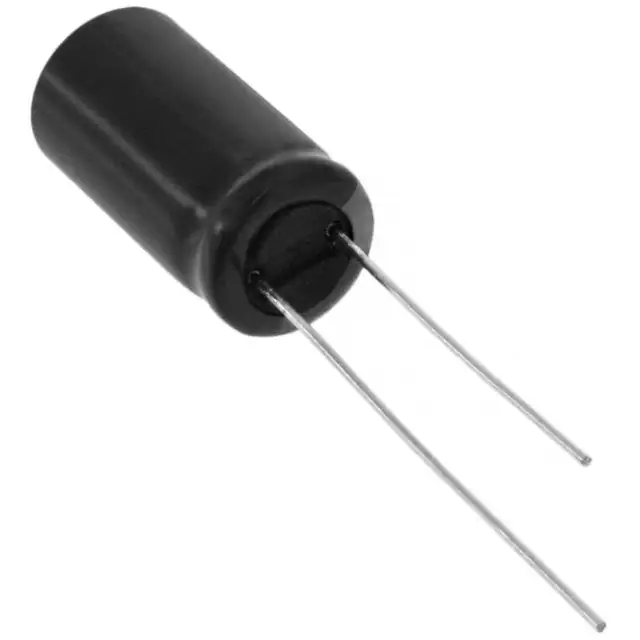

ELXV500ELL121MH20D 数据手册
MINIATURE ALUMINUM ELECTROLYTIC CAPACITORS LXV Low impedance, 105℃ LXY Series Lower Z ・Low impedance LXV ・Endurance with ripple current : 2,000 to 5,000 hours at 105℃ ・Solvent resistant type (see PRECAUTIONS AND GUIDELINES) ・RoHS2 Compliant ・AEC-Q200 compliant : Please contact Chemi-Con for more details, test data, information. ◆SPECIFICATIONS Items Characteristics Category Temperature Range Rated Voltage Range Capacitance Tolerance Leakage Current -55 to +105℃ 6.3 to 100Vdc (at 20℃, 120Hz) ±20% (M) I=0.01CV or 3µA, whichever is greater. Where, I : Max. leakage current (µA), C : Nominal capacitance (µF), V : Rated voltage (V) (at 20℃ after 2 minutes) Rated voltage (Vdc) 6.3V 10V 16V 25V 35V 50V 63V 80V 100V tanδ (Max.) 0.22 0.19 0.16 0.14 0.12 0.10 0.10 0.09 0.08 When nominal capacitance exceeds 1,000µF, add 0.02 to the value above for each 1,000µF increase. (at 20℃, 120Hz) Capacitance changeΔC (-55℃ /+20℃) 0.7min. Max. impedance ratio (-55℃ /+20℃) 3max.(6.3Vdc: 4max.) (at 120Hz) The following specifications shall be satisfied when the capacitors are restored to 20℃ after subjected to DC voltage with the rated ripple current is applied (the peak voltage shall not exceed the rated voltage) for the specified period of time at 105℃. Time φ5 to 6.3 : 2,000hours φ8 &10: 3,000hours φ12.5toφ18: 5,000hours Capacitance change ≦±20% of the initial value D.F. (tanδ) ≦200% of the initial specified value Leakage current ≦The initial specified value The following specifications shall be satisfied when the capacitors are restored to 20℃ after exposing them for 1,000 hours at 105℃ without voltage applied. Before the measurement, the capacitor shall be preconditioned by applying voltage according to Item 4.1 of JIS C 5101-4. Capacitance change ≦±20% of the initial value D.F. (tanδ) ≦200% of the initial specified value Leakage current ≦The initial specified value Dissipation Factor (tanδ) Low Temperature Characteristics Endurance Shelf Life ◆DIMENSIONS [mm] F±0.5 Code : E φD' φd Sleeve (PET : Brown) F±0.5 ●Terminal L' 15min. 4min. Vent (Exceptφ5 & φ6.3) (φ5 to φ10) (φ12.5 to φ18) φD φd F φD' L' 5 0.5 2.0 6.3 0.5 2.5 10 12.5 8 0.6 0.6 0.6 3.5 5.0 5.0 φD+0.5max. L+1.5max. 16 0.8 7.5 18 0.8 7.5 Gas escape end seal ◆PART NUMBERING SYSTEM 1 2 3 4 5 6 7 8 9 10 11 12 13 14 15 16 17 18 E L XV AAA E AA AAA M AAA N Supplement code Size code Capacitance tolerance code Capacitance code (ex. 120µF:121, 1,500µF:152) Lead forming·taping code Terminal code Voltage code (ex. 6.3V:6R3, 25V:250, 100V:101) Series code Category Please refer to "Product code guide (radial lead type)" Product specifications in this catalog are subject to change without notice.Request our product specifications before purchase and/or use. Please use our products based on the information contained in this catalog and product specifications. CAT. No. E1001W 2022 MINIATURE ALUMINUM ELECTROLYTIC CAPACITORS Low impedance, 105℃ LXVSeries ◆STANDARD RATINGS WV (Vdc) Cap (µF) Case size φD×L(mm) 20℃ 120 220 330 390 470 560 680 820 1,200 1,500 2,200 2,200 2,700 6.3 3,900 3,900 4,700 5,600 5,600 5,600 6,800 6,800 8,200 10,000 10,000 12,000 15,000 82 180 270 330 390 470 680 680 1,000 1,200 1,500 1,800 2,200 10 2,700 3,300 3,300 3,900 3,900 3,900 4,700 5,600 6,800 6,800 8,200 8,200 10,000 56 120 180 270 270 330 470 470 16 680 820 1,200 1,200 1,500 2,200 2,200 5×11.5 6.3×11.5 6.3×15 8×12 10×12.5 8×15 10×16 8×20 10×20 10×25 10×30 12.5×20 12.5×25 12.5×30 16×20 12.5×35 12.5×40 16×25 18×20 16×30 18×25 16×35 16×40 18×30 18×35 18×40 5×11.5 6.3×11.5 6.3×15 8×12 10×12.5 8×15 8×20 10×16 10×20 10×25 10×30 12.5×20 12.5×25 12.5×30 12.5×35 16×20 12.5×40 16×25 18×20 18×25 16×30 16×35 18×30 16×40 18×35 18×40 5×11.5 6.3×11.5 6.3×15 8×12 10×12.5 8×15 8×20 10×16 10×20 10×25 10×30 12.5×20 12.5×25 12.5×30 16×20 Rated ripple current (mArms/ -10℃ 105℃, 100kHz) Impedance (Ω max./100kHz) 0.72 0.38 0.27 0.20 0.12 0.16 0.084 0.11 0.062 0.052 0.044 0.046 0.034 0.030 0.038 0.027 0.024 0.028 0.036 0.025 0.027 0.022 0.018 0.024 0.021 0.017 0.72 0.38 0.27 0.20 0.12 0.16 0.11 0.084 0.062 0.052 0.044 0.046 0.034 0.030 0.027 0.038 0.024 0.028 0.036 0.027 0.025 0.022 0.024 0.018 0.021 0.017 0.72 0.38 0.27 0.20 0.12 0.16 0.11 0.084 0.062 0.052 0.044 0.046 0.034 0.030 0.038 1.8 0.95 0.68 0.50 0.30 0.40 0.21 0.28 0.16 0.13 0.11 0.12 0.085 0.075 0.095 0.068 0.060 0.070 0.090 0.063 0.068 0.055 0.045 0.060 0.053 0.043 1.8 0.95 0.68 0.50 0.30 0.40 0.28 0.21 0.16 0.13 0.11 0.12 0.085 0.075 0.068 0.095 0.060 0.070 0.090 0.068 0.063 0.055 0.060 0.045 0.053 0.043 1.8 0.95 0.68 0.50 0.30 0.40 0.28 0.21 0.16 0.13 0.11 0.12 0.085 0.075 0.095 165 255 330 415 635 495 825 640 1,060 1,260 1,450 1,360 1,700 1,980 1,770 2,230 2,460 2,190 1,940 2,510 2,350 2,770 3,110 2,720 3,050 3,300 165 255 330 415 635 495 640 825 1,060 1,260 1,450 1,360 1,700 1,980 2,230 1,770 2,460 2,190 1,940 2,350 2,510 2,770 2,720 3,110 3,050 3,300 165 255 330 415 635 495 640 825 1,060 1,260 1,450 1,360 1,700 1,980 1,770 Part No. WV (Vdc) Cap (µF) Case size φD×L(mm) 20℃ ELXV6R3E□□121MEB5D ELXV6R3E□□221MFB5D ELXV6R3E□□331MF15D ELXV6R3E□□391MH12D ELXV6R3E□□471MJC5S ELXV6R3E□□561MH15D ELXV6R3E□□681MJ16S ELXV6R3E□□821MH20D ELXV6R3E□□122MJ20S ELXV6R3E□□152MJ25S ELXV6R3E□□222MJ30S ELXV6R3E□□222MK20S ELXV6R3E□□272MK25S ELXV6R3E□□392MK30S ELXV6R3E□□392ML20S ELXV6R3E□□472MK35S ELXV6R3E□□562MK40S ELXV6R3E□□562ML25S ELXV6R3E□□562MM20S ELXV6R3E□□682ML30S ELXV6R3E□□682MM25S ELXV6R3E□□822ML35S ELXV6R3E□□103ML40S ELXV6R3E□□103MM30S ELXV6R3E□□123MM35S ELXV6R3E□□153MM40S ELXV100E□□820MEB5D ELXV100E□□181MFB5D ELXV100E□□271MF15D ELXV100E□□331MH12D ELXV100E□□391MJC5S ELXV100E□□471MH15D ELXV100E□□681MH20D ELXV100E□□681MJ16S ELXV100E□□102MJ20S ELXV100E□□122MJ25S ELXV100E□□152MJ30S ELXV100E□□182MK20S ELXV100E□□222MK25S ELXV100E□□272MK30S ELXV100E□□332MK35S ELXV100E□□332ML20S ELXV100E□□392MK40S ELXV100E□□392ML25S ELXV100E□□392MM20S ELXV100E□□472MM25S ELXV100E□□562ML30S ELXV100E□□682ML35S ELXV100E□□682MM30S ELXV100E□□822ML40S ELXV100E□□822MM35S ELXV100E□□103MM40S ELXV160E□□560MEB5D ELXV160E□□121MFB5D ELXV160E□□181MF15D ELXV160E□□271MH12D ELXV160E□□271MJC5S ELXV160E□□331MH15D ELXV160E□□471MH20D ELXV160E□□471MJ16S ELXV160E□□681MJ20S ELXV160E□□821MJ25S ELXV160E□□122MJ30S ELXV160E□□122MK20S ELXV160E□□152MK25S ELXV160E□□222MK30S ELXV160E□□222ML20S 16 25 35 50 2,700 2,700 3,300 3,300 3,900 3,900 4,700 4,700 5,600 6,800 8,200 39 82 120 150 180 220 330 330 470 560 820 820 1,000 1,500 1,500 1,800 1,800 2,200 2,200 2,700 2,700 3,300 3,300 3,900 3,900 4,700 27 56 82 120 120 180 220 220 330 390 560 560 680 1,000 1,000 1,200 1,200 1,500 1,500 1,800 1,800 2,200 2,200 2,700 2,700 3,300 18 39 56 68 12.5×35 16×25 12.5×40 18×20 16×30 18×25 16×35 18×30 16×40 18×35 18×40 5×11.5 6.3×11.5 6.3×15 8×12 10×12.5 8×15 8×20 10×16 10×20 10×25 10×30 12.5×20 12.5×25 12.5×30 16×20 12.5×35 16×25 12.5×40 18×20 16×30 18×25 16×35 18×30 16×40 18×35 18×40 5×11.5 6.3×11.5 6.3×15 8×12 10×12.5 8×15 8×20 10×16 10×20 10×25 10×30 12.5×20 12.5×25 12.5×30 16×20 12.5×35 16×25 12.5×40 18×20 16×30 18×25 16×35 18×30 16×40 18×35 18×40 5×11.5 6.3×11.5 6.3×15 8×12 Rated ripple current (mArms/ -10℃ 105℃, 100kHz) Impedance (Ω max./100kHz) 0.027 0.028 0.024 0.036 0.025 0.027 0.022 0.024 0.018 0.021 0.017 0.72 0.38 0.27 0.20 0.12 0.16 0.11 0.084 0.062 0.052 0.044 0.046 0.034 0.030 0.038 0.027 0.028 0.024 0.036 0.025 0.027 0.022 0.024 0.018 0.021 0.017 0.72 0.38 0.27 0.20 0.12 0.16 0.11 0.084 0.062 0.052 0.044 0.046 0.034 0.030 0.038 0.027 0.028 0.024 0.036 0.025 0.027 0.022 0.024 0.018 0.021 0.017 1.1 0.56 0.41 0.29 0.068 0.070 0.060 0.090 0.063 0.068 0.055 0.060 0.045 0.053 0.043 1.8 0.95 0.68 0.50 0.30 0.40 0.28 0.21 0.16 0.13 0.11 0.12 0.085 0.075 0.095 0.068 0.070 0.060 0.090 0.063 0.068 0.055 0.060 0.045 0.053 0.043 1.8 0.95 0.68 0.50 0.30 0.40 0.28 0.21 0.16 0.13 0.11 0.12 0.085 0.075 0.095 0.068 0.070 0.060 0.090 0.063 0.068 0.055 0.060 0.045 0.053 0.043 3.3 1.6 1.2 0.84 2,230 2,190 2,460 1,940 2,510 2,350 2,770 2,720 3,110 3,050 3,300 165 255 330 415 635 495 640 825 1,060 1,260 1,450 1,360 1,700 1,980 1,770 2,230 2,190 2,460 1,940 2,510 2,350 2,770 2,720 3,110 3,050 3,300 165 255 330 415 635 495 640 825 1,060 1,260 1,450 1,360 1,700 1,980 1,770 2,230 2,190 2,460 1,940 2,510 2,350 2,770 2,720 3,110 3,050 3,300 165 255 310 415 Part No. ELXV160E□□272MK35S ELXV160E□□272ML25S ELXV160E□□332MK40S ELXV160E□□332MM20S ELXV160E□□392ML30S ELXV160E□□392MM25S ELXV160E□□472ML35S ELXV160E□□472MM30S ELXV160E□□562ML40S ELXV160E□□682MM35S ELXV160E□□822MM40S ELXV250E□□390MEB5D ELXV250E□□820MFB5D ELXV250E□□121MF15D ELXV250E□□151MH12D ELXV250E□□181MJC5S ELXV250E□□221MH15D ELXV250E□□331MH20D ELXV250E□□331MJ16S ELXV250E□□471MJ20S ELXV250E□□561MJ25S ELXV250E□□821MJ30S ELXV250E□□821MK20S ELXV250E□□102MK25S ELXV250E□□152MK30S ELXV250E□□152ML20S ELXV250E□□182MK35S ELXV250E□□182ML25S ELXV250E□□222MK40S ELXV250E□□222MM20S ELXV250E□□272ML30S ELXV250E□□272MM25S ELXV250E□□332ML35S ELXV250E□□332MM30S ELXV250E□□392ML40S ELXV250E□□392MM35S ELXV250E□□472MM40S ELXV350E□□270MEB5D ELXV350E□□560MFB5D ELXV350E□□820MF15D ELXV350E□□121MH12D ELXV350E□□121MJC5S ELXV350E□□181MH15D ELXV350E□□221MH20D ELXV350E□□221MJ16S ELXV350E□□331MJ20S ELXV350E□□391MJ25S ELXV350E□□561MJ30S ELXV350E□□561MK20S ELXV350E□□681MK25S ELXV350E□□102MK30S ELXV350E□□102ML20S ELXV350E□□122MK35S ELXV350E□□122ML25S ELXV350E□□152MK40S ELXV350E□□152MM20S ELXV350E□□182ML30S ELXV350E□□182MM25S ELXV350E□□222ML35S ELXV350E□□222MM30S ELXV350E□□272ML40S ELXV350E□□272MM35S ELXV350E□□332MM40S ELXV500E□□180MEB5D ELXV500E□□390MFB5D ELXV500E□□560MF15D ELXV500E□□680MH12D □□ : Enter the appropriate lead forming or taping code. are not recommended for new designs (NRND). The products shown in Product specifications in this catalog are subject to change without notice.Request our product specifications before purchase and/or use. Please use our products based on the information contained in this catalog and product specifications. CAT. No. E1001W 2022 MINIATURE ALUMINUM ELECTROLYTIC CAPACITORS Low impedance, 105℃ LXVSeries ◆STANDARD RATINGS WV (Vdc) Cap (µF) Case size φD×L(mm) 20℃ 82 82 120 120 180 220 330 330 470 560 680 50 680 820 820 820 1,000 1,000 1,200 1,500 1,500 1,800 2,200 12 27 39 47 56 68 68 82 120 150 180 220 270 63 390 390 470 470 560 560 680 680 820 820 1,000 1,000 1,200 8.2 80 18 8×15 10×12.5 8×20 10×16 10×20 10×25 10×30 12.5×20 12.5×25 12.5×30 12.5×35 16×20 12.5×40 16×25 18×20 16×30 18×25 16×35 16×40 18×30 18×35 18×40 5×11.5 6.3×11.5 6.3×15 8×12 10×12.5 8×15 10×16 8×20 10×20 10×25 10×30 12.5×20 12.5×25 12.5×30 16×20 12.5×35 16×25 12.5×40 18×20 16×30 18×25 16×35 18×30 16×40 18×35 18×40 5×11.5 6.3×11.5 Rated ripple current (mArms/ -10℃ 105℃, 100kHz) Impedance (Ω max./100kHz) 0.24 0.16 0.18 0.12 0.088 0.068 0.059 0.059 0.045 0.039 0.033 0.043 0.029 0.033 0.039 0.029 0.030 0.025 0.021 0.026 0.023 0.020 1.9 1.1 0.62 0.49 0.27 0.34 0.21 0.21 0.16 0.13 0.10 0.11 0.074 0.068 0.085 0.063 0.055 0.051 0.085 0.046 0.055 0.040 0.046 0.036 0.040 0.036 1.9 1.1 0.72 0.40 0.52 0.30 0.22 0.17 0.15 0.15 0.11 0.098 0.083 0.11 0.073 0.083 0.098 0.073 0.075 0.063 0.053 0.065 0.058 0.050 4.8 2.8 1.6 1.3 0.68 0.85 0.53 0.53 0.40 0.33 0.25 0.28 0.19 0.17 0.22 0.16 0.14 0.13 0.22 0.12 0.14 0.10 0.12 0.09 0.10 0.09 5.1 3.0 505 530 610 755 945 1,150 1,260 1,190 1,500 1,720 1,900 1,500 2,120 1,880 1,660 2,150 2,020 2,320 2,650 2,340 2,620 2,790 100 160 230 275 420 360 523 500 650 780 960 870 1,150 1,280 1,100 1,390 1,480 1,530 1,170 1,720 1,520 1,910 1,770 2,070 1,970 2,130 100 150 WV (Vdc) Part No. Cap (µF) Case size φD×L(mm) 20℃ ELXV500E□□820MH15D ELXV500E□□820MJC5S ELXV500E□□121MH20D ELXV500E□□121MJ16S ELXV500E□□181MJ20S ELXV500E□□221MJ25S ELXV500E□□331MJ30S ELXV500E□□331MK20S ELXV500E□□471MK25S ELXV500E□□561MK30S ELXV500E□□681MK35S ELXV500E□□681ML20S ELXV500E□□821MK40S ELXV500E□□821ML25S ELXV500E□□821MM20S ELXV500E□□102ML30S ELXV500E□□102MM25S ELXV500E□□122ML35S ELXV500E□□152ML40S ELXV500E□□152MM30S ELXV500E□□182MM35S ELXV500E□□222MM40S ELXV630E□□120MEB5D ELXV630E□□270MFB5D ELXV630E□□390MF15D ELXV630E□□470MH12D ELXV630E□□560MJC5S ELXV630E□□680MH15D ELXV630E□□680MJ16S ELXV630E□□820MH20D ELXV630E□□121MJ20S ELXV630E□□151MJ25S ELXV630E□□181MJ30S ELXV630E□□221MK20S ELXV630E□□271MK25S ELXV630E□□391MK30S ELXV630E□□391ML20S ELXV630E□□471MK35S ELXV630E□□471ML25S ELXV630E□□561MK40S ELXV630E□□561MM20S ELXV630E□□681ML30S ELXV630E□□681MM25S ELXV630E□□821ML35S ELXV630E□□821MM30S ELXV630E□□102ML40S ELXV630E□□102MM35S ELXV630E□□122MM40S ELXV800E□□8R2MEB5D ELXV800E□□180MFB5D 27 33 39 47 56 56 82 100 150 150 180 270 80 270 330 330 390 390 470 470 560 680 680 820 1,000 5.6 12 18 22 27 33 33 39 56 68 100 100 120 100 180 180 220 220 270 270 330 330 390 390 470 560 680 6.3×15 8×12 10×12.5 8×15 8×20 10×16 10×20 10×25 10×30 12.5×20 12.5×25 12.5×30 16×20 12.5×35 16×25 12.5×40 18×20 16×30 18×25 16×35 16×40 18×30 18×35 18×40 5×11.5 6.3×11.5 6.3×15 8×12 10×12.5 8×15 10×16 8×20 10×20 10×25 10×30 12.5×20 12.5×25 12.5×30 16×20 12.5×35 16×25 12.5×40 18×20 16×30 18×25 16×35 18×30 16×40 18×35 18×40 Rated ripple current (mArms/ -10℃ 105℃, 100kHz) Impedance (Ω max./100kHz) 0.62 0.53 0.47 0.35 0.27 0.33 0.26 0.19 0.15 0.15 0.11 0.094 0.11 0.087 0.081 0.060 0.085 0.058 0.070 0.052 0.041 0.058 0.052 0.041 1.9 1.1 0.62 0.53 0.47 0.35 0.33 0.27 0.26 0.19 0.15 0.15 0.11 0.094 0.11 0.087 0.081 0.060 0.085 0.058 0.070 0.052 0.058 0.041 0.052 0.041 1.7 1.5 1.3 0.97 0.74 0.90 0.70 0.52 0.41 0.41 0.30 0.26 0.30 0.24 0.22 0.17 0.23 0.16 0.19 0.14 0.11 0.16 0.14 0.11 5.1 3.0 1.7 1.5 1.3 0.97 0.90 0.74 0.70 0.52 0.41 0.41 0.30 0.26 0.30 0.24 0.22 0.17 0.23 0.16 0.19 0.14 0.16 0.11 0.14 0.11 220 275 380 360 490 500 620 795 955 890 1,040 1,270 1,240 1,450 1,440 1,610 1,450 1,790 1,650 2,000 2,200 1,850 1,990 2,370 100 150 220 275 380 360 500 490 620 795 955 890 1,040 1,270 1,240 1,450 1,440 1,610 1,450 1,790 1,650 2,000 1,850 2,200 1,990 2,370 Part No. ELXV800E□□270MF15D ELXV800E□□330MH12D ELXV800E□□390MJC5S ELXV800E□□470MH15D ELXV800E□□560MH20D ELXV800E□□560MJ16S ELXV800E□□820MJ20S ELXV800E□□101MJ25S ELXV800E□□151MJ30S ELXV800E□□151MK20S ELXV800E□□181MK25S ELXV800E□□271MK30S ELXV800E□□271ML20S ELXV800E□□331MK35S ELXV800E□□331ML25S ELXV800E□□391MK40S ELXV800E□□391MM20S ELXV800E□□471ML30S ELXV800E□□471MM25S ELXV800E□□561ML35S ELXV800E□□681ML40S ELXV800E□□681MM30S ELXV800E□□821MM35S ELXV800E□□102MM40S ELXV101E□□5R6MEB5D ELXV101E□□120MFB5D ELXV101E□□180MF15D ELXV101E□□220MH12D ELXV101E□□270MJC5S ELXV101E□□330MH15D ELXV101E□□330MJ16S ELXV101E□□390MH20D ELXV101E□□560MJ20S ELXV101E□□680MJ25S ELXV101E□□101MJ30S ELXV101E□□101MK20S ELXV101E□□121MK25S ELXV101E□□181MK30S ELXV101E□□181ML20S ELXV101E□□221MK35S ELXV101E□□221ML25S ELXV101E□□271MK40S ELXV101E□□271MM20S ELXV101E□□331ML30S ELXV101E□□331MM25S ELXV101E□□391ML35S ELXV101E□□391MM30S ELXV101E□□471ML40S ELXV101E□□561MM35S ELXV101E□□681MM40S □□ : Enter the appropriate lead forming or taping code. are not recommended for new designs (NRND). The products shown in ◆RATED RIPPLE CURRENT MULTIPLIERS ・Frequency Multipliers Frequency (Hz) Rated voltage Case size (Vdc) 120 1k 10k 100k φD (mm) 5 to 8 0.65 0.83 0.95 1.00 5 to 8 10 & 12.5 0.70 0.85 0.96 1.00 35 & 50 10 & 12.5 16 & 18 0.85 0.92 0.97 1.00 16 & 18 5 to 8 0.55 0.76 0.91 1.00 5 to 8 10 & 12.5 0.65 0.83 0.93 1.00 63 to 100 10 & 12.5 16 & 18 0.70 0.87 0.96 1.00 16 & 18 Rated voltage Case size (Vdc) φD (mm) 6.3 & 10 16 & 25 Frequency (Hz) 120 1k 10k 100k 0.40 0.66 0.85 1.00 0.50 0.73 0.89 1.00 0.60 0.81 0.94 1.00 0.20 0.55 0.80 1.00 0.35 0.65 0.85 1.00 0.50 0.75 0.90 1.00 The deterioration of aluminum electrolytic capacitors accelerates their life due to the internal heating produced by ripple current. For details, refer to Section "5-3 Ripple Current Effect on Lifetime" in the catalog, Technical Note. Product specifications in this catalog are subject to change without notice.Request our product specifications before purchase and/or use. Please use our products based on the information contained in this catalog and product specifications. CAT. No. E1001W 2022
