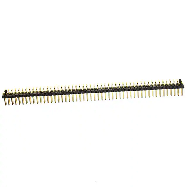

GRPB502VWQP-RC 数据手册
Headers .050” [1.27 mm] Contact Centers, Male Headers, Straight/Right Angle/SMT SPECIFICATIONS • • • • • • Insulator Material: Nylon Contact Material: Brass Plating: Gold Flash Overall 1 Amp current rating UL Flammability Rating: 94V-0 Stacker Options available - Consult factory TERMINATION TYPE PCB LAYOUT SINGLE READOUT STRAIGHT (VWV) RIGHT ANGLE (VWC) DUAL READOUT A STRAIGHT Ø .028” ± .002” [0.70 ± 0.05] .050” [1.27] .118” [3.00] .118” [3.00] STRAIGHT (VWV) RIGHT ANGLE (MWC) A .091” [2.30] .050” [1.27] .091” [2.30] .016” [0.40] SQ. .050” [1.27] (VWVN) (VWVN) SURFACE MOUNT PIN 1 LEFT (VWTC) STANDARD Headers RIGHT ANGLE .098” [2.50] .098” [2.50] .118” [3.00] .118” [3.00] Ø .028” ± .002” [0.70 ± 0.05] .065” [1.65] A .100” [2.54] PIN 1 LEFT .050” [1.27] .089” [2.25] .177” [4.50] .069” [1.75] .030” [0.76] (VWCN) (MWCN) .050” [1.27] PIN 1 RIGHT (VWTD) A SURFACE MOUNT (SMT) .118” [3.00] .083” [2.10] .030” [0.76] .089” [2.25] PIN 1 RIGHT .118” [3.00] .177” [4.50] .079” [2.00] .100” [2.54] .050” [1.27] (VWQ) .138” [3.50] .201” [5.10] (VWTC, VWTD) Optional Guide Posts, (VWQP) (VWQS), Without Guide Posts (VWQP), With Guide Posts PIN 1 C 2X Ø .039” [1.00] OPTIONAL FOR 'P' MOUNTING .232” [5.90] .087” [2.20] .050” [1.27] A .030” [0.76] MOUNTING STYLE PIN 1 PIN 1 No Mounting, (N) 94 SMT, Pin 1 Left (C) Standard SMT SMT, Pin 1 Right (D) Only Even Positions SMT, Without Guide Posts (S) SMT, With Guide Posts (P) www.sullinscorp.com | 760-744-0125 | toll-free 888-774-3100 | fax 760-744-6081 | info@sullinscorp.com Headers .050” [1.27 mm] Contact Centers, Male Headers, Straight/Right Angle/SMT PART NUMBER OPTIONS G R P B xx 1 VWV N - RC INSULATOR MATERIAL RoHS COMPLIANT G = Nylon Consult Factory For Modifications CONTACT MATERIAL MOUNTING STYLE R = Brass N = No Mounting C = Surface Mount, Pin 1 Left (Single Row Only) D = Surface Mount, Pin 1 Right (Single Row on Even Positions Only) S = Surface Mount without Guide Pins (Dual Row Only) P = Surface Mount with Guide Posts (Dual Row Only) CONTACT FINISH - RoHS Compliant P = Gold Flash Overall CONTACT CENTERS B = .050” [1.27 mm] NUMBER OF POSITIONS Positions Termination Available TERMINATION TYPE (Opposite Page) VWV, VWC, MWC, VWT, VWQ NUMBER OF ROWS 2 Thru 50 = VWC, VWQ, VWT, VWV 1 Thru 50 = MWC 1 = Single Row 2 = Dual Row DIMENSIONS Dimensions in [ ] are in millimeters, all others are in inches. STRAIGHT (SHOWN) & RIGHT ANGLE A B B SURFACE MOUNT, PIN 1 LEFT, SINGLE ROW(SHOWN) .039 [1.00] .084 [2.14] PIN 1 B .134 [3.40] .084 [2.14] .050 [1.27] DUAL ROW SINGLE ROW .016 [0.40] SQ. .050 [1.27] SURFACE MOUNT, DUAL ROW WITHOUT GUIDE POSTS, (VWQS) .039 [1.00] A A .039 [1.00] .039 [1.00] .134 [3.40] .059 [1.50] .050 [1.27] C .016 [0.40] SQ. POSITIONS NUMBER OF CONTACTS SINGLE/DUAL A in mm in mm 01 02 03 04 05 06 07 08 09 10 11 12 13 14 15 16 17 18 19 20 21 22 23 24 25 01/02 02/04 03/06 04/08 05/10 06/12 07/14 08/16 09/18 10/20 11/22 12/24 13/26 14/28 15/30 16/32 17/34 18/36 19/38 20/40 21/42 22/44 23/46 24/48 25/50 N/A .050 .100 .150 .200 .250 .300 .350 .400 .450 .500 .550 .600 .650 .700 .750 .800 .850 .900 .950 1.000 1.050 1.100 1.150 1.200 N/A 1.27 2.54 3.81 5.08 6.35 7.62 8.89 10.16 11.43 12.70 13.97 15.24 16.51 17.78 19.05 20.32 21.59 22.86 24.13 25.40 26.67 27.94 29.21 30.48 .050 .100 .150 .200 .250 .300 .350 .400 .450 .500 .550 .600 .650 .700 .750 .800 .850 .900 .950 1.000 1.050 1.100 1.150 1.200 1.250 1.27 2.54 3.81 5.08 6.35 7.62 8.89 10.16 11.43 12.70 13.97 15.24 16.51 17.78 19.05 20.32 21.59 22.86 24.13 25.40 26.67 27.94 29.21 30.48 31.75 2X Ø .028 [0.70] B C in mm N/A .050 .100 .150 .200 .250 .300 .350 .400 .450 .500 .550 .600 .650 .700 .750 .800 .850 .900 .950 1.000 1.050 1.100 1.150 ” 1.27 2.54 3.81 5.08 6.35 7.62 8.89 10.16 11.43 12.70 13.97 15.24 16.51 17.78 19.05 20.32 21.59 22.86 24.13 25.40 26.67 27.94 29.21 POSITIONS 26 27 28 29 30 31 32 33 34 35 36 37 38 39 40 41 42 43 44 45 46 47 48 49 50 .016 [0.40] SQ. .083 [2.10] B C Headers B PIN 1 A WITH GUIDE POSTS, (VWQP) .016 [0.40] SQ. NUMBER OF CONTACTS SINGLE/DUAL 26/52 27/54 28/56 29/58 30/60 31/62 32/64 33/66 34/68 35/70 36/72 37/74 38/76 39/78 40/80 41/82 42/84 43/86 44/88 45/90 46/92 47/94 48/96 49/98 50/100 A in mm in mm in mm 1.250 1.300 1.350 1.400 1.450 1.500 1.550 1.600 1.650 1.700 1.750 1.800 1.850 1.900 1.950 2.000 2.050 2.100 2.150 2.200 2.250 2.300 2.350 2.400 2.450 31.75 33.02 34.29 35.56 36.83 38.10 39.37 40.64 41.91 43.18 44.45 45.72 46.99 48.26 49.53 50.80 52.07 53.34 54.61 55.88 57.15 58.42 59.69 60.96 62.23 1.300 1.350 1.400 1.450 1.500 1.550 1.600 1.650 1.700 1.750 1.800 1.850 1.900 1.950 2.000 2.050 2.100 2.150 2.200 2.250 2.300 2.350 2.400 2.450 2.500 33.02 34.29 35.56 36.83 38.10 39.37 40.64 41.91 43.18 44.45 45.72 46.99 48.26 49.53 50.80 52.07 53.34 54.61 55.88 57.15 58.42 59.69 60.96 62.23 63.50 1.200 1.250 1.300 1.350 1.400 1.450 1.500 1.550 1.600 1.650 1.700 1.750 1.800 1.850 1.900 1.950 2.000 2.050 2.100 2.150 2.200 2.250 2.300 2.350 2.400 30.48 31.75 33.02 34.29 35.56 36.83 38.10 39.37 40.64 41.91 43.18 44.45 45.72 46.99 48.26 49.53 50.80 52.07 53.34 54.61 55.88 57.15 58.42 59.69 60.96 www.sullinscorp.com | 760-744-0125 | toll-free 888-774-3100 | fax 760-744-6081 | info@sullinscorp.com 95
