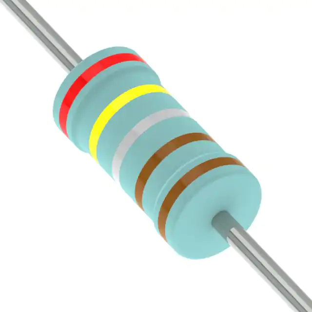

INTRODUCTION
The MF0 Series Metal Film Professional
Resistors are manufactured using a vacuum
sputtering system to deposit multiple layers of
mixed metal alloys and passivative materials
onto a carefully treated high grade ceramic
substrate. After a helical groove has been cut
in the resistive layer, tinned connecting leads of
electrolytic copper are welded to the end-caps.
The resistors are coated with layers of blue
color lacquer.
